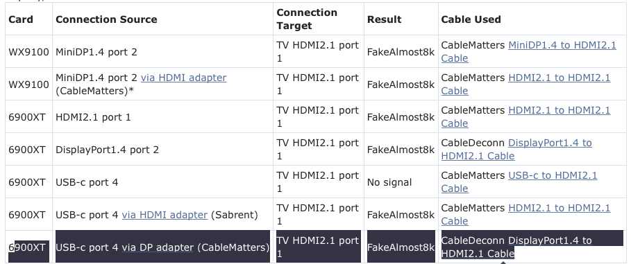

Question about the last test in that post:
this one: "6900XT | USB-c port 4 via DP adapter | TVHDMI2.1 port 1 | FakeAlmost8k | MiniDP1.4 to HDMI2.1 Cable"
How did you connect Mini DP to the USB-C to DP adapter?
You'll need a DisplayPort (male) to Mini-DisplayPort (female) adapter to test your Mini DP adapters and cables with the 6900XT
or a USB-C to Mini-DisplayPort (female) adapter.
So what you quoted there was, I think, a typo that I corrected a while back, not sure why it's still showing you that. But this is what I corrected it to:
With that last one, the adapter has a male USBc that plugs into the female USBc port of the 6900. It has a female HDMI port. So then a regular male to male HDMI cable plugs one end into the USBc/hdmi adapter, and the other end into the TV.

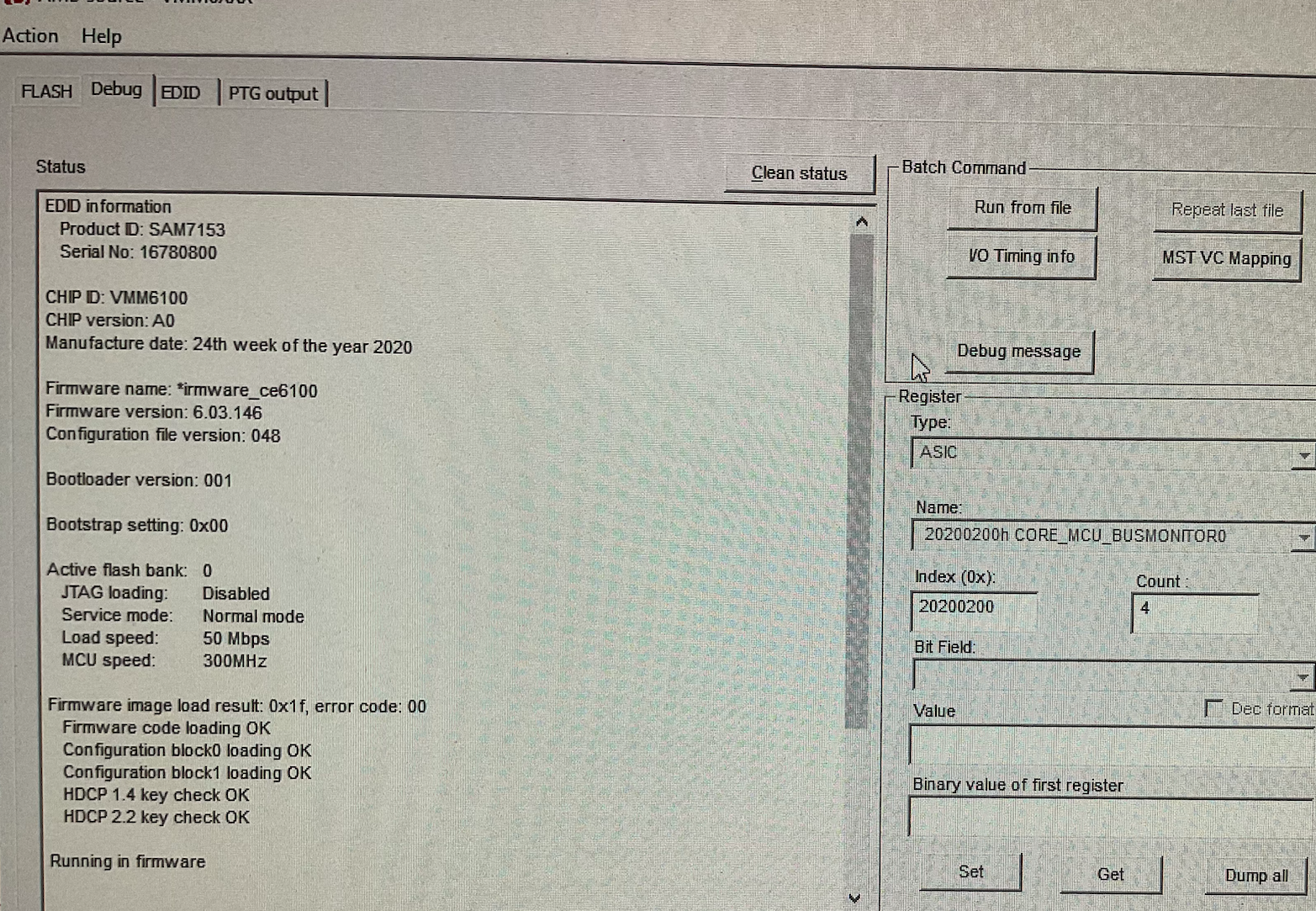

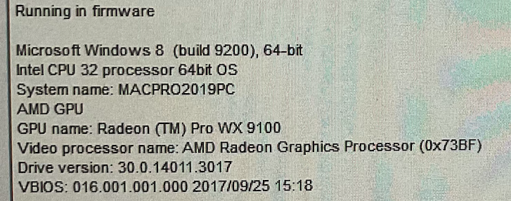

I would like you to run the utility to get the firmware version from the cable and extract the firmware. You don't need to modify the firmware if you don't want to. I am wondering why the cable doesn't show support for DSC in the AGDCDiagnose output.
Ok, I got it and this is what it returns:

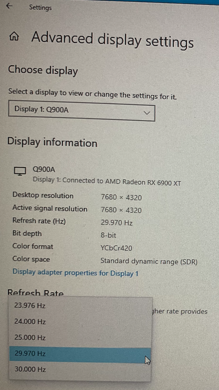

And this is what windows shows is the mode. Interestingly windows maxes out at 30hz with that cable whereas macOS uses 60hz setting. I imagine the cable might be pumping out less color information to make the 60hz work on macOS.
Except in your picture of the table, you show the last row is USB-C male to DisplayPort female and the cable is the Deconn DisplayPort 1.4 to HDMI2.1 Cable.
Instead of a screenshot, click the "Dump all" button to get all the info. I am looking for what it says about the connection between the HDMI port and the display.
I've attached some examples for other adapters.
Another interesting button is "Debug message". It saves a log of messages from the adapter. I guess try running it just after the display is registered and running at the desired resolution and refresh rate?
You can get a slightly newer version of the VmmDpTool from the Microsoft Store. Some of the attached examples came from VmmUpdater which is also from the Microsoft Store.
Remember that the Deconn cable removes the 8K50 and 8K60 modes. You'll need to re-add them. Download Custom Resolution Utility (CRU) from https://www.monitortests.com/forum/Thread-Custom-Resolution-Utility-CRU

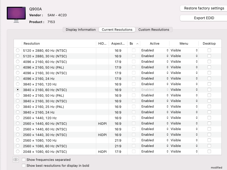

Get the EDID for the TV using a connection from the HDMI port of the 6900XT using CRU and save it to a file and/or copy.
Then, with the connection using the Deconn cable, override the EDID with the EDID from the HDMI port by clicking paste. You can change the name of the display in the EDID to something like "Q900port1" or whatever port you connect the display to so you can know when the EDID is working (click "Edit..." and enter up to 13 characters for the name). You can do the same for the EDID of the HDMI port. EDID overrides in Windows are per <GPU port & display vendor & display product>. On macOS, the EDID overrides are <per display vendor & display product> or <display vendor & display week of manufacture>. So in Windows, you need to override the EDID for all the ports that you're going to connect the adapter to (or just remember to use the same port all the time).

I used it in one of the earlier tests and will run the diagnostic report on it for you. But the cable that I'm using currently that works with 8k is not that adapter, it is this CableDeconn one:
That Cable Matters 201388 one should have DSC support. You'll want to use the firmware updater to verify the firmware version. And maybe update it. Get an AGDCDiagnose before and after update. Try and see if Windows will use DSC to get 8K60.
The firmware utility I ran was on the CableDeconn cable and if I understand and read it correctly, it showed version 6.03.146
That is a newer firmware than I've seen for the Cable Matters 201388 adapter, but it doesn't have DSC enabled so it's not useful for further testing until you try updating its firmware.

I got an 8K Samsung TV too and linking an HDMI 2.1 cable from HDMI 2.1 GPU port straight to TV's HDMI port doesn't seem to work as per your method, maybe I need to pass from a DP port to trick it? I also experience dithering even with Game Mode on. On Windows I got 8K 60Hz RGB 10 bit with the same linking and the only thing which makes dithering to disappear is switching to Game Mode, precisely... it's the Freesync VRR which does the dithering trick since if I disable it then dither comes back. Should I buy that Cabledeconn DP 1.4 ---> HDMI 2.1 cable?
Please note that I'm on an hackintosh, so I'm pretty familiar with whatevergreen and related. Feel free to use me as a test guy. MacPro7,1 SMBIOS !

Yes, so should I buy the Sabrent adapter? Didn't @ZombiePhysicist already bought and tried it? I'm asking since it's the only one showing off a DSC compatibility.
@ZombiePhysicist did try it #89 but did not do all the tests that he did with the Deconn cable/adapter so we have next to no info about it.
Buy any adapter you want to test but assume none of them will work or at least that none will do better than 8K60 8bpc 4:2:0. Then we do experiments to try to get beyond that or to get more info.

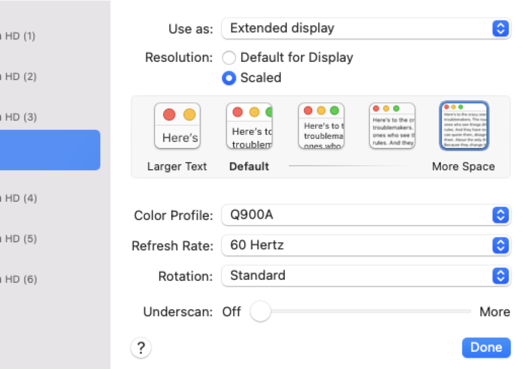

So some interesting results as I'm now testing with the Sabrent USBc adapter and a new 16.4 foot version of this cable.
So first thing that is interesting is that the regular 4k (3840x2160@60hz) does not seem to initially work with this setup, however, setting it to 4096x2160@60hz does work, and then setting back to the 3840 mode then does work. Strange.
The 8k non scaled versions of resolution do not show up at all:
Also HDR does not show up as an option, even in 4k in the displays panel. I also tried both 5k resolutions but the TV wouldn't work with them.
