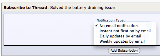

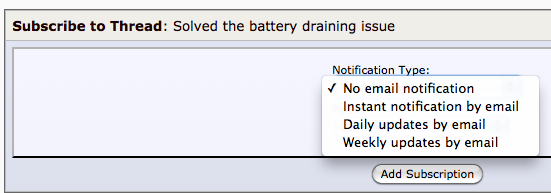

Perhaps I don't wish to receive an email for every post this thread will get, and would rather just search for my post in the future in order to find the thread.
I am exstatic to know that you feel my simple post was beneath your standards though. A little introspection on your part may thwart your future misconceptions.
Not good enough!
And you also have a Subscribed Threads section in your Control Panel.
