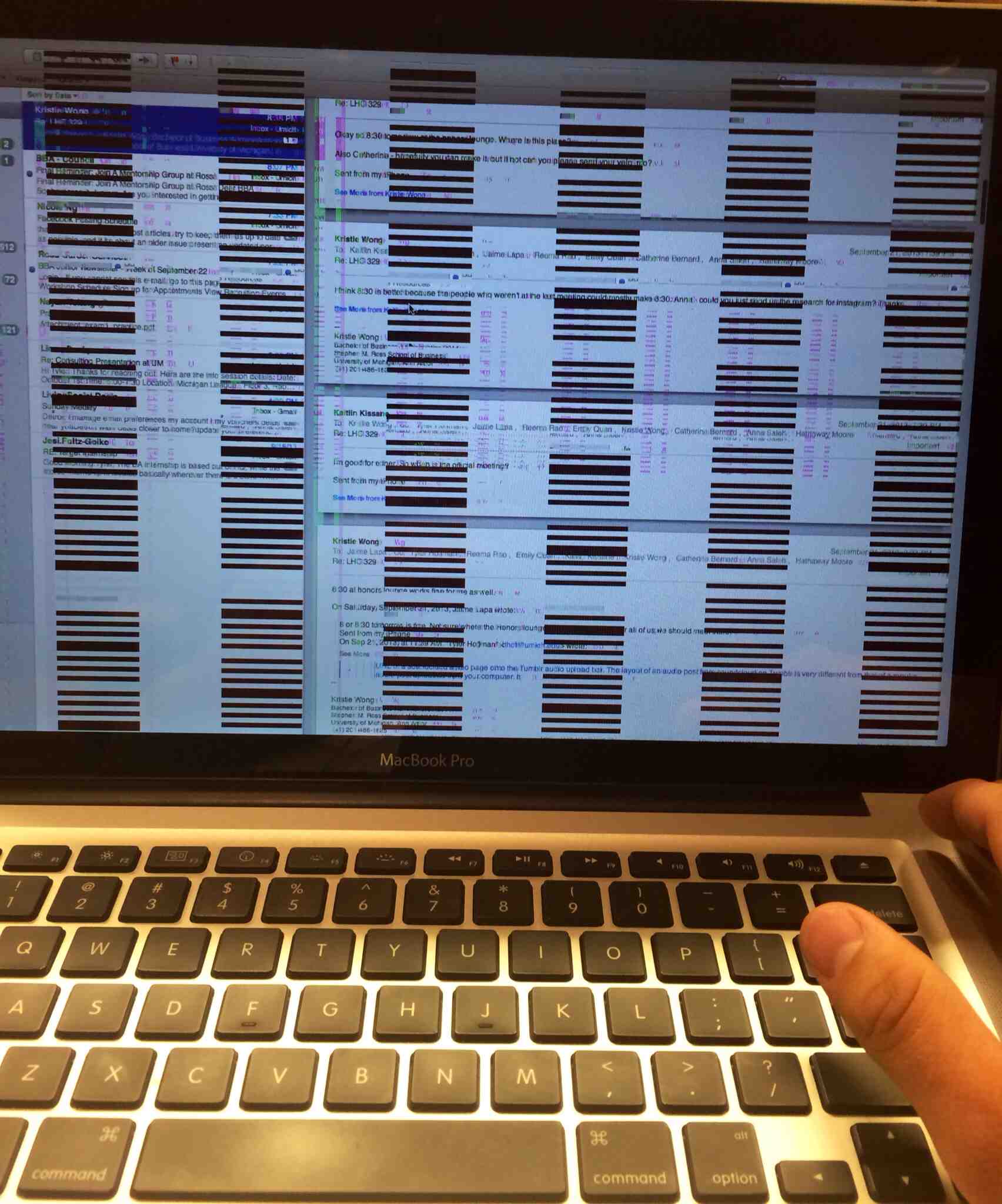

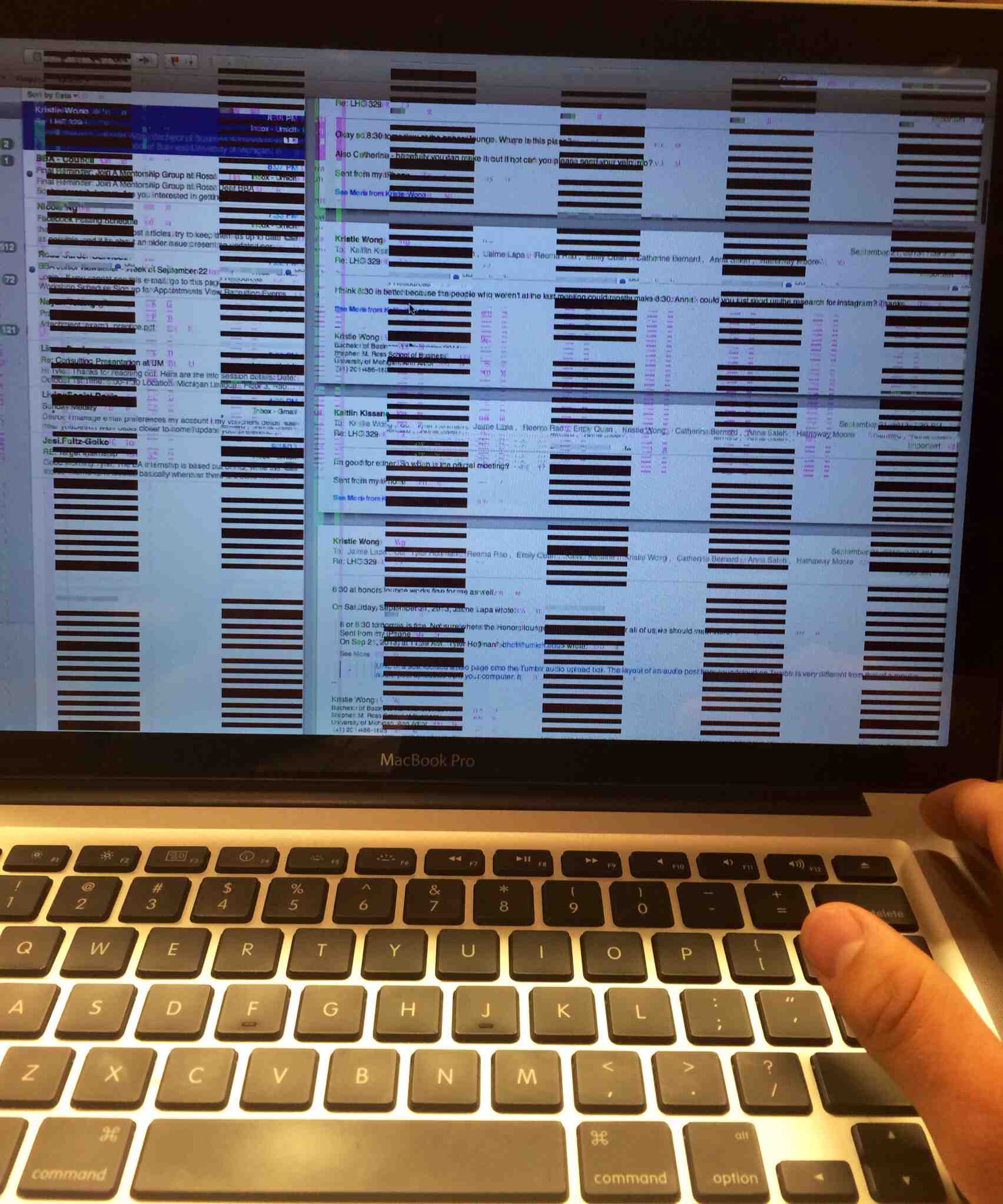

Just to add to the long list of defects:
Early 2011 MBP 17" 2.2 GHz i7 with AMD Radeon HD 6750M
I had my logic board replaced for free by a local Apple retailer in the UK, whilst I was still under warranty (Higher Education AppleCare lasted 3 years) by the end of February this year.
Less than 48 hours into using my 17" again, I have a shifting desktop picture again, which is how it started with the original logic board just after Christmas last year. I switched to internal graphics only i.e. no external display possible, and it is stable for the time being. I will take it back and due to the 90 days warranty am still covered and will probably get a new logic board as in the first case.
