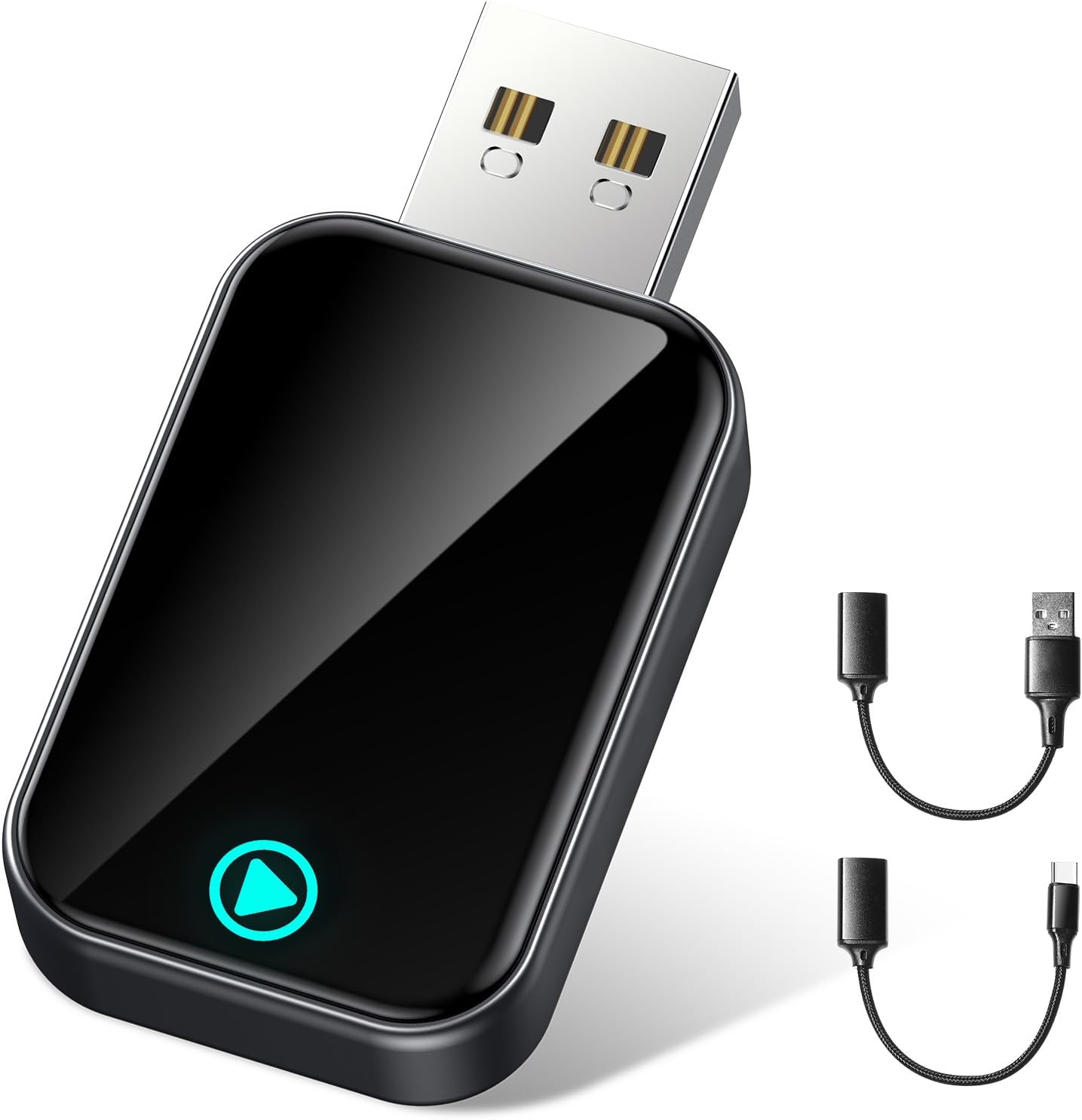

I bought an Alltotive S2 Mini Wireless Carplay adapter from Amazon and so far it’s playing beautifully with my 17 PM. Before that, on my Pioneer headunit with native wireless Carplay, it would disconnect constantly every 30 seconds to 2 minutes, same for my Carplay2air adapter.
But this Alltotive S2 Mini Wireless one is working flawlessly for now. I have no idea what channel the other two use, whether it's 2.4 GHz or 5 GHz, but this adapter is definitely on the 5 GHz band. Whether that’s also a factor in this buggy mess, I have no idea. It was only £18, so it’s worth a go.

I can confirm that adapter is still working for me, I've driven for over an hour in total with this adaptor, using Waze and streaming lossless music at the same time, still wearing my Ultra 3 unlocked and this adapter hasn't disconnected once.
I'm using it with an aftermarket Pioneer SPH-360DAB headunit and my 17 PM seems very happy with this combo so far. I can't say for 100% certainty this adapter would work for everyone but for me it's been perfect.
I bought this one. It's one of those devices that might show up in many different names, but as long as it looks the identical, it's most likley the same one.

Thanks, appreciate the follow up. Looks like that brand is for UK Amazon - hopefully the one that is identical works for me in the US. I’ll find out tomorrow!
I can confirm that the S2 from GATGOODS on Amazon is solid and my wireless CarPlay disconnection issues are not present with this device as they were with cplay2air with my AT&T iPhone 17 pro max 2tb.

Which GATGOODS unit did you have success with?

For me in the UK Amazon, this adapter was under the name Alltotive, GATGOODS in the US Amazon. No idea how many names it may be under, but as long as it looks like this, it seems the 17 likes it.

Here’s the link. I wasn’t sure if links are allowed. https://a.co/d/eLAqr7t
