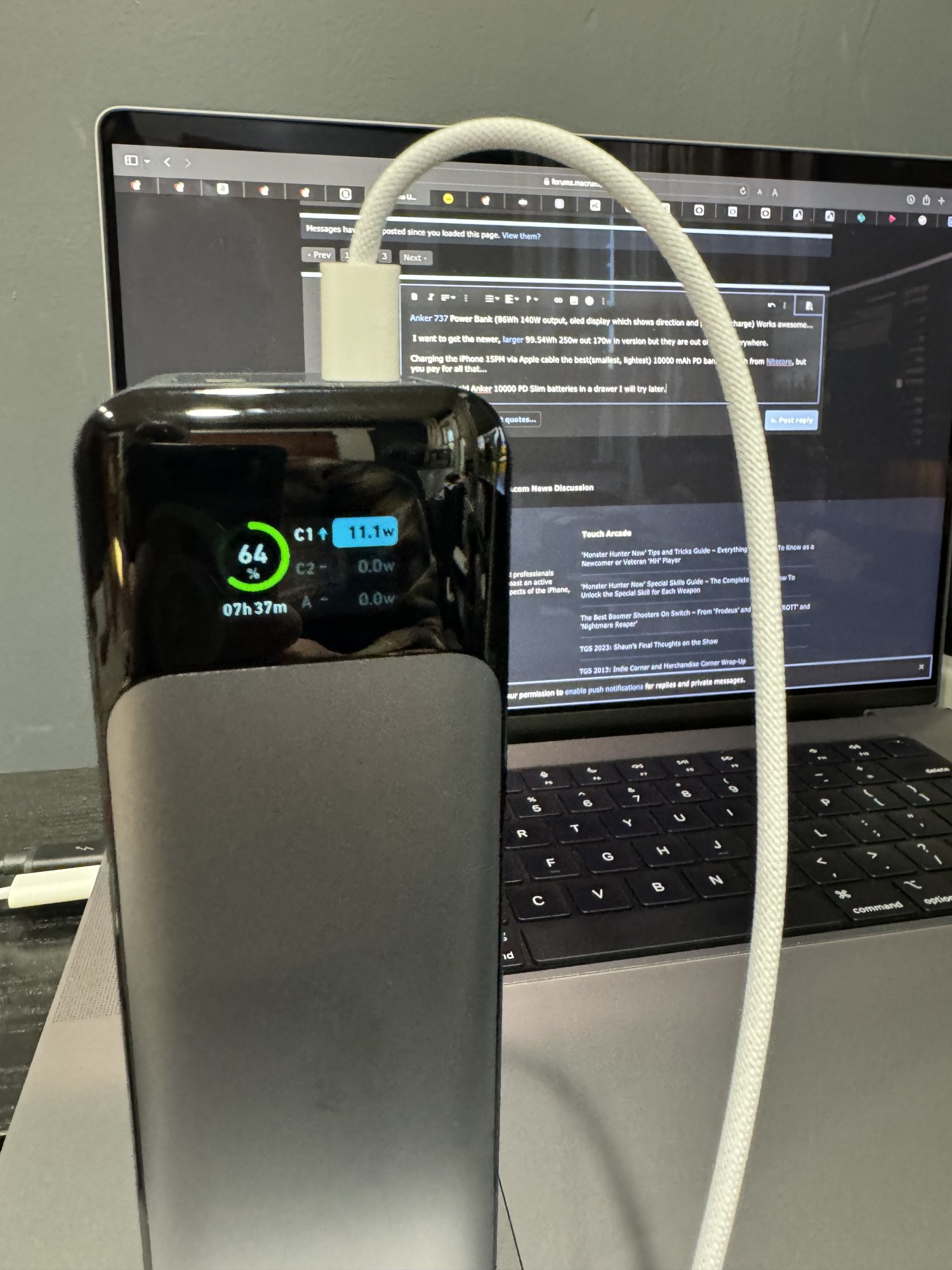

Anker 737 Power Bank (86Wh 140W output, oled display which shows direction and power of charge) Works awesome...
I want to get the newer, larger 99.54Wh 250w out 170w in version but they are out of stock everywhere.

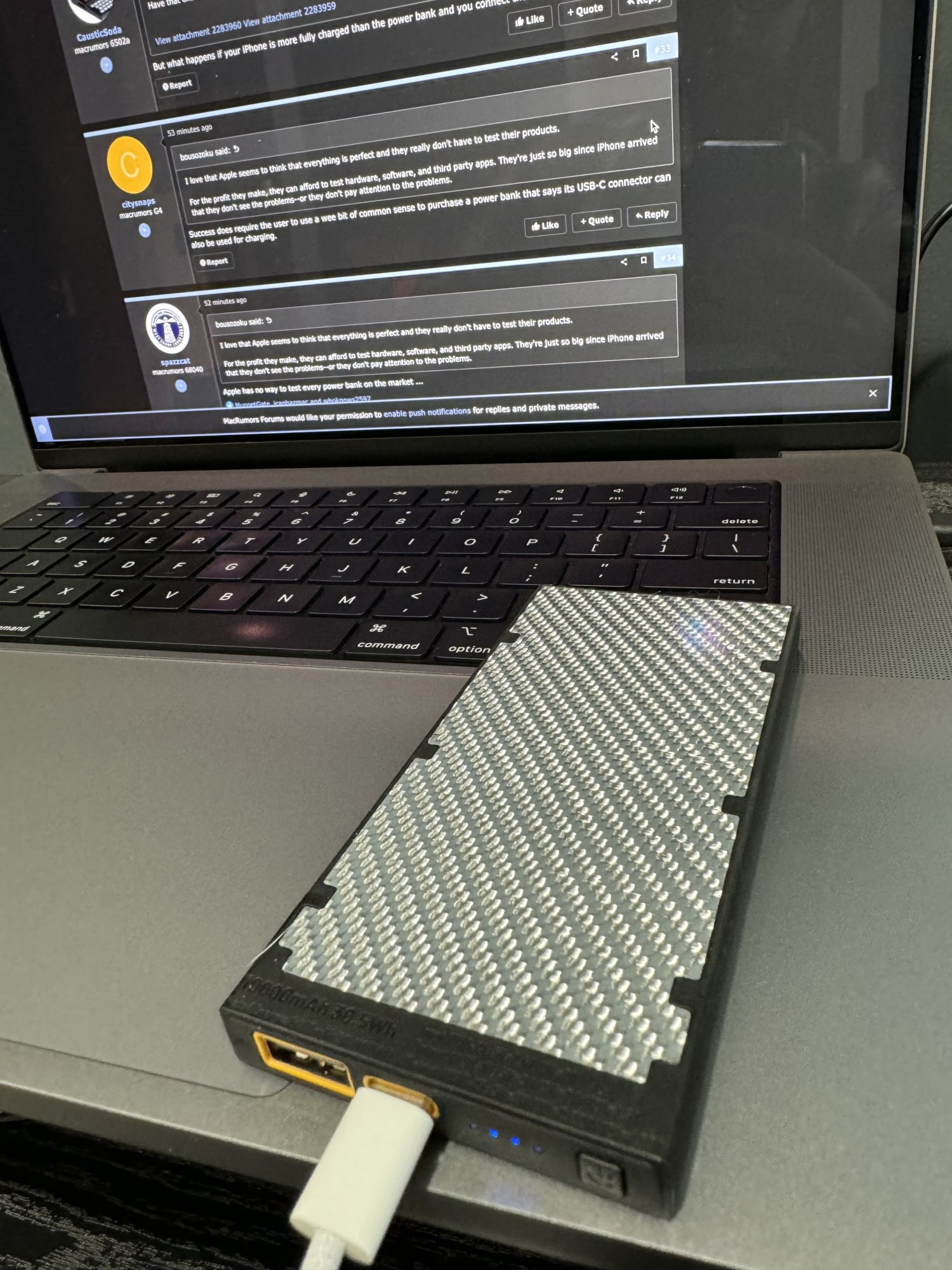

Charging the iPhone 15PM perfectly(iPhone from 73%-81%) via Apple cable the best(smallest, lightest) 10000 mAh PD bank on earth from Nitecore, but you pay for all that...

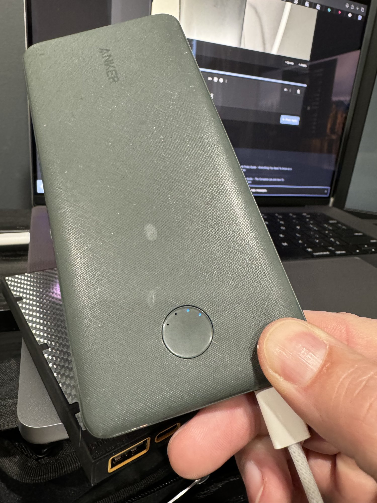

Update.... the Anker PowerCore Slim 10000 PD from my 11 Pro days works fine. just pulled it out of a drawer, 2 dots of 4 and the iPhone is 83% charged now…

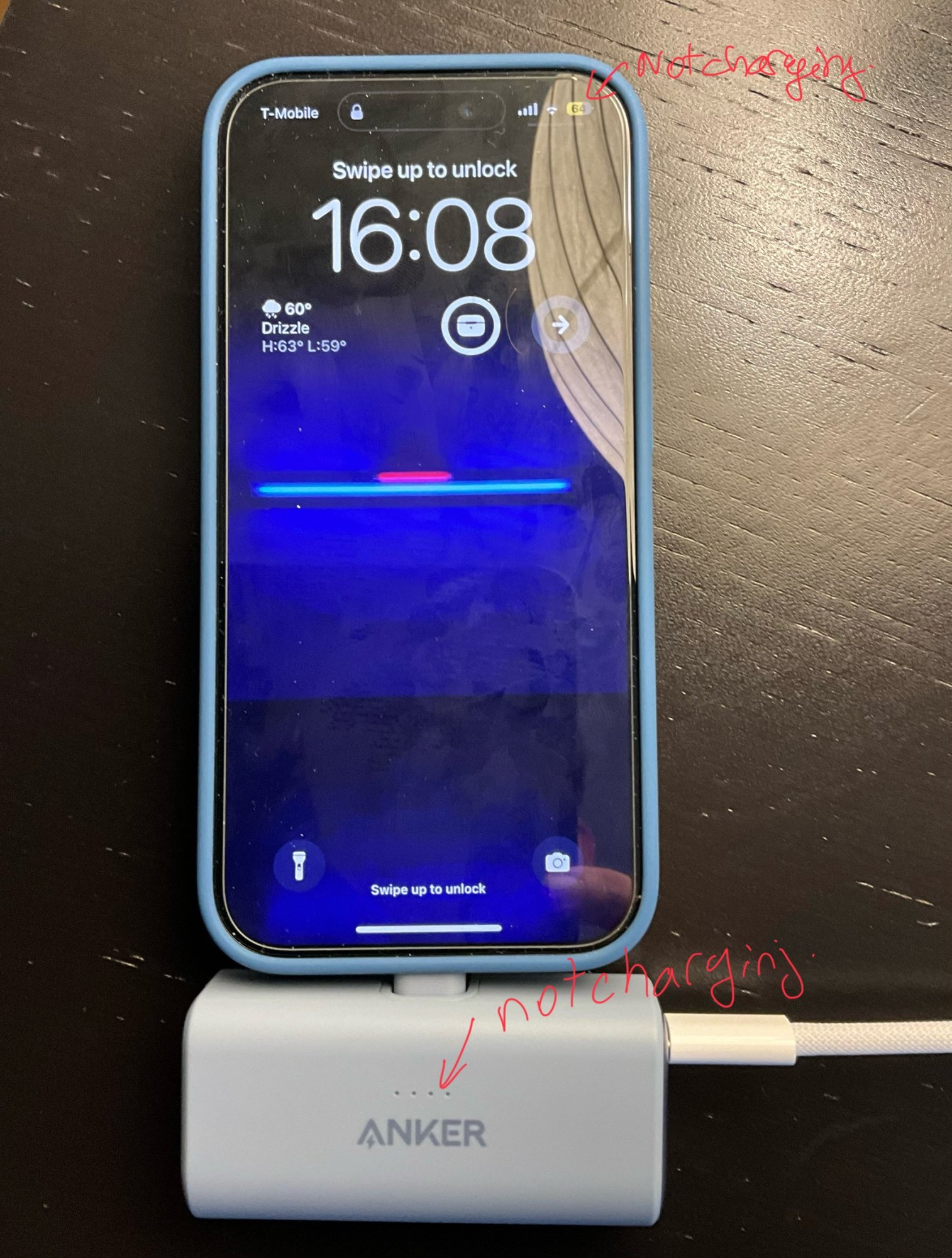

On my 15P it's also working fine however the Anker Nano 22.5W is not working, nor charging when trying to do passthrough charging. Same issue with the iPad Pro as well.
However on small device like airpods its works. I guess it's the PD part.....
