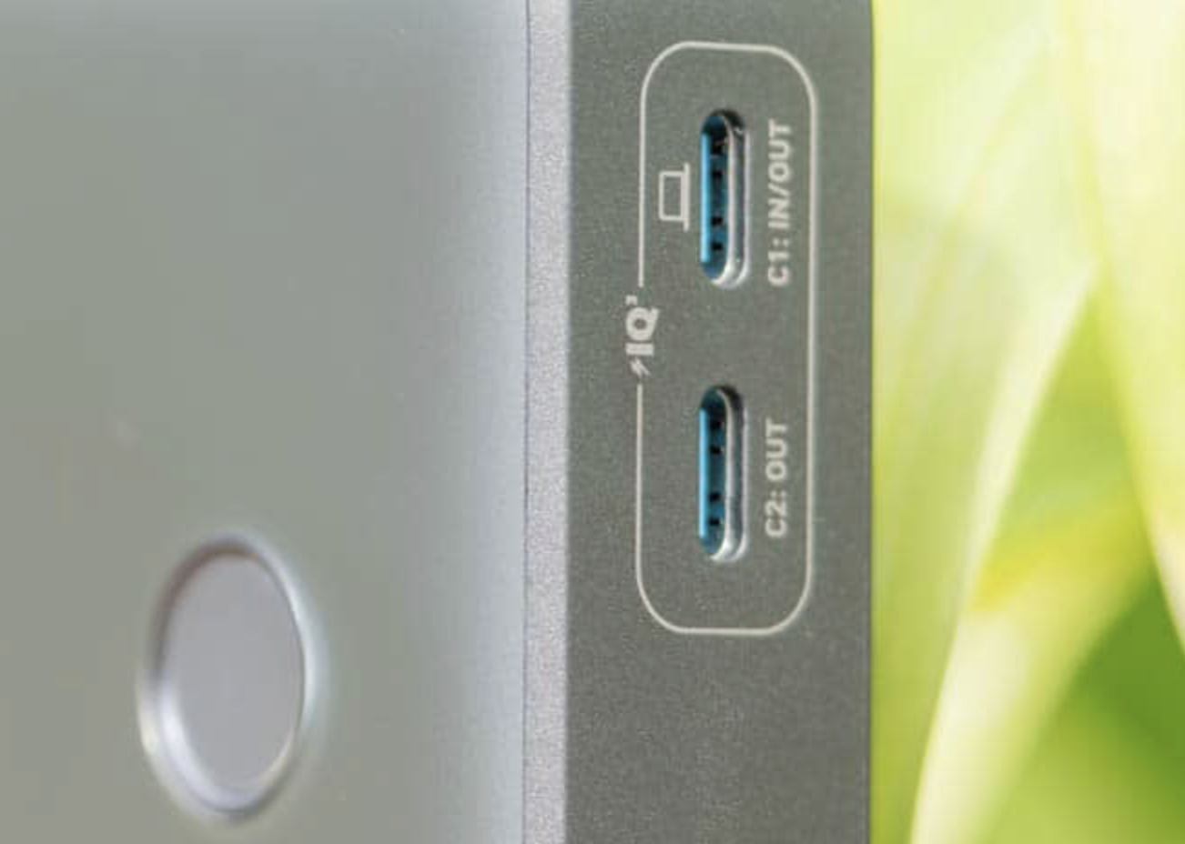

Where is the "output" USB-C port?
Anker does know how to do it properly, as seen on some of their devices...
They only have to test the power banks with type-C connections, and only from the major brands. They didn't do that, apparently.
This is not Apple's problem - Anker is the one you need to be concerned with...
And they do know how to implement PD properly, as they do on some of their more expensive power banks...
Reactions: ApplesAreSweet&Sour
