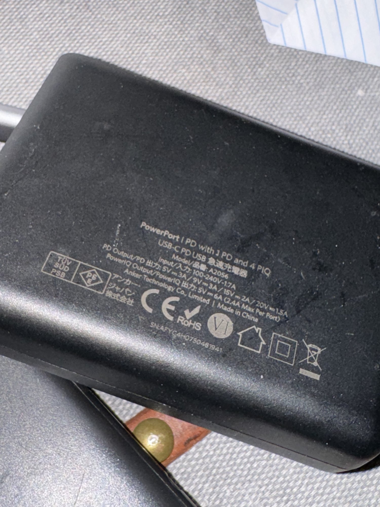

I wonder if this effects some chargers, too. I have an Anker 525 (the thing that is a small power strip with 3 AC plugs on the back and 2 usba 2 usbc on the front) and my 15pro would keep chiming through the night when plugged into it via usbc, as if it kept disconnecting and reconnecting. I had to switch to something else. The phone hasn't had issues with any other charger.
In my experience (without an iPhone 15) these types of Anker power strips tend to provide inconsistent power through the USB ports. My Apple Watch would randomly stop charging in the middle of the night when plugged directly into the USB ports, and I tried to plug a clock into the USB-A and it would lose power and reset every time a device plugged directly into the USB ports was taken on or off charge

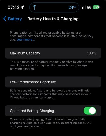

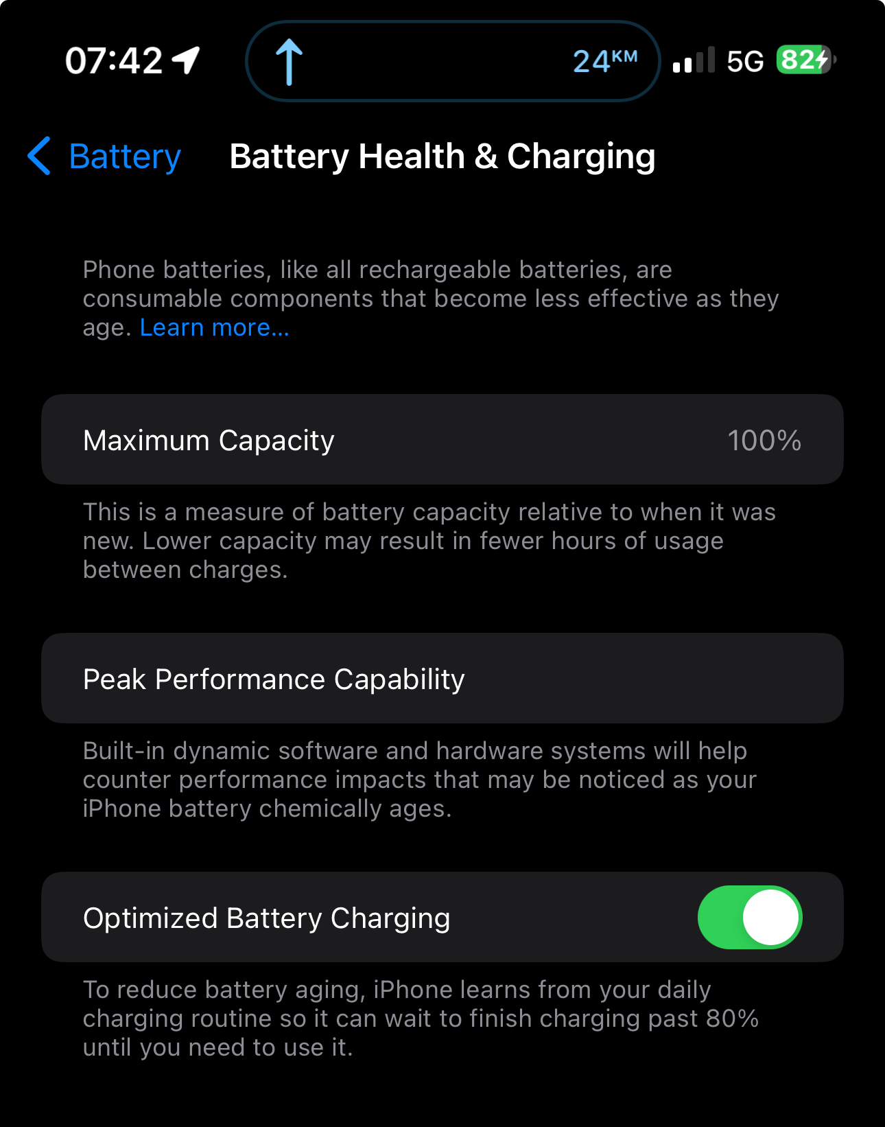

My battery is still 100% health with max fast charging, my trick is , the old classic laptop way, stay between 20-80% , calbirate once in the 3 months the battery, many people just use their devices wrong and then blame the devices ,

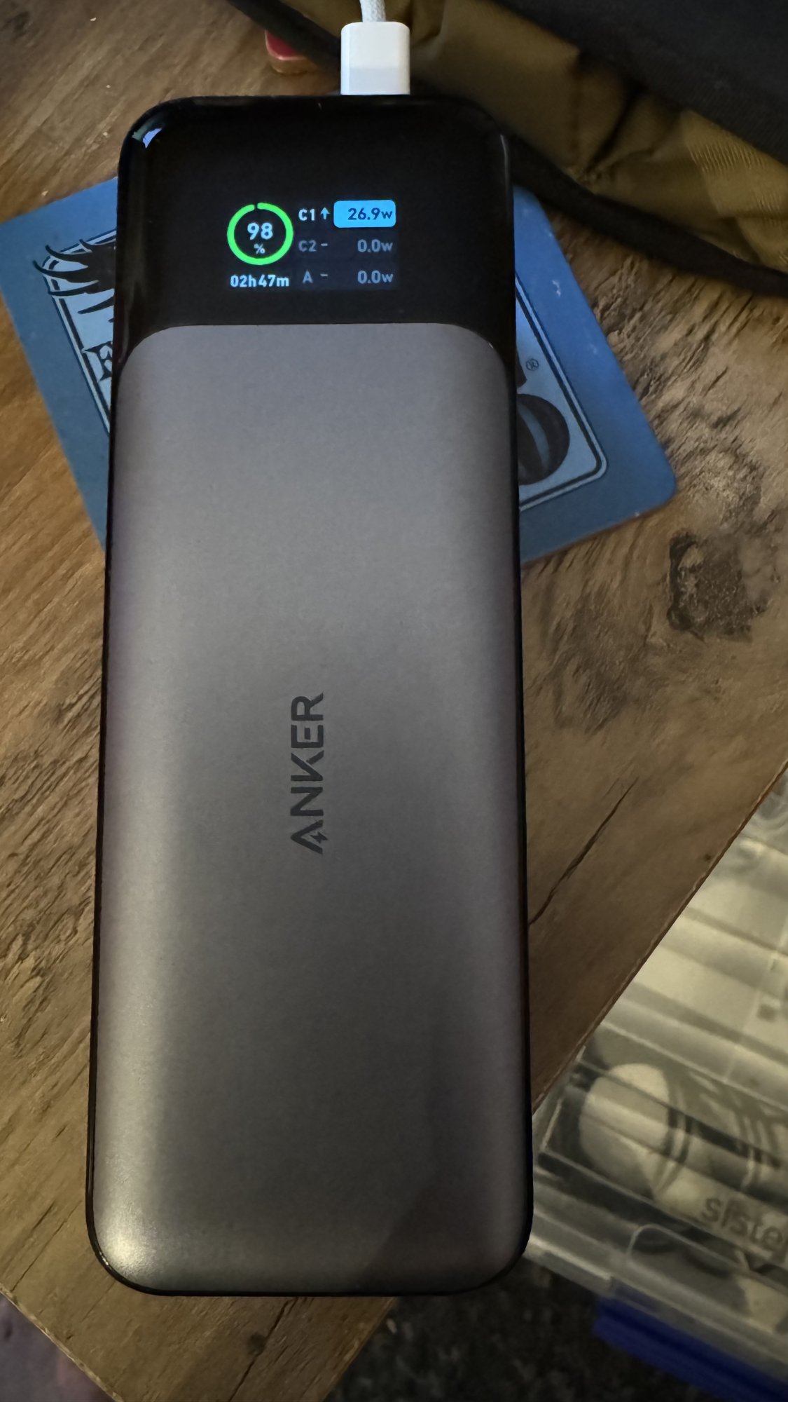

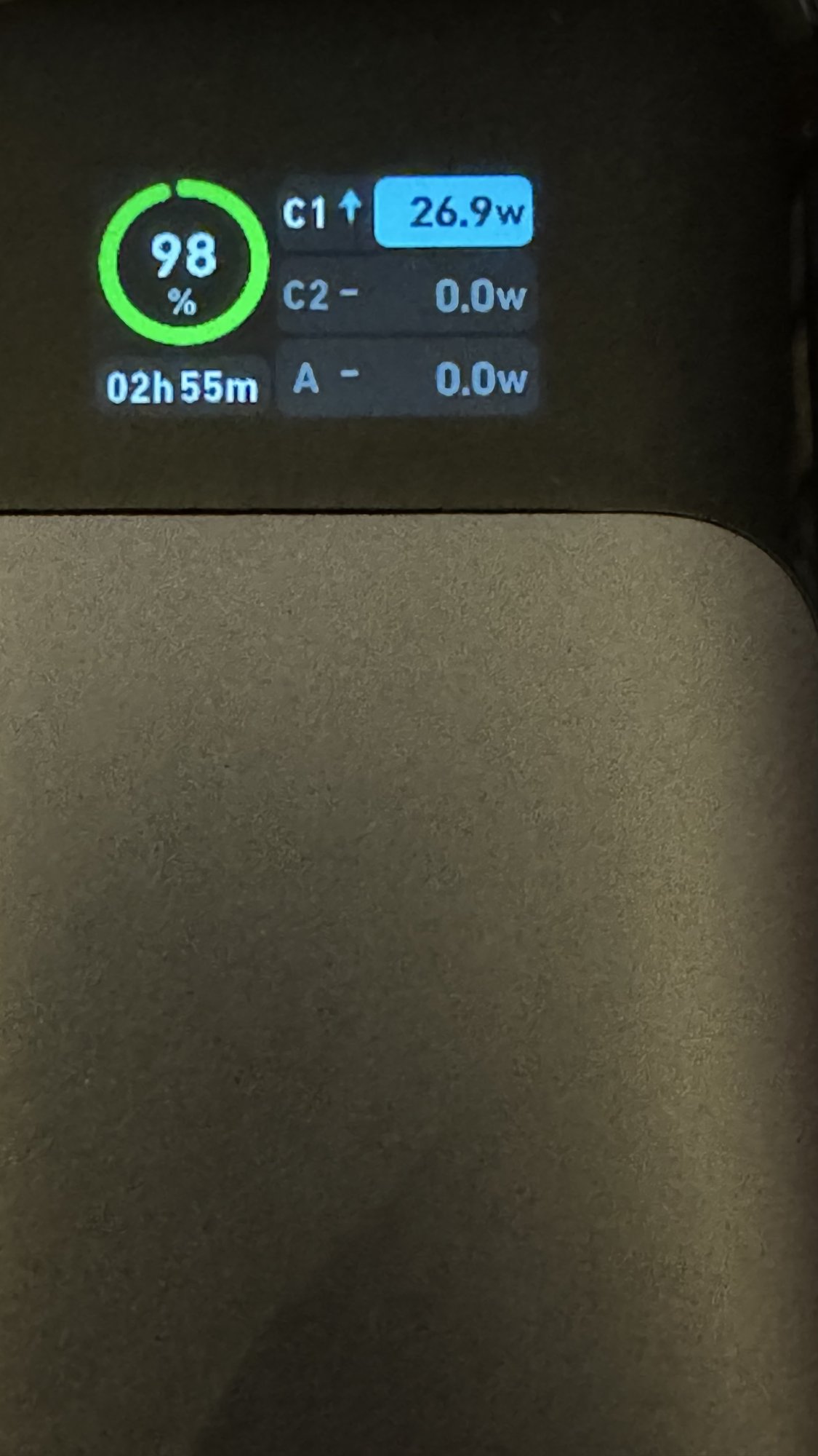

Nice to know but dont use 100w port use the 65w one that is smarter for iphones , you can use the 100w for charger like what i do i use it as ups, this is ip14 pro max i use it on

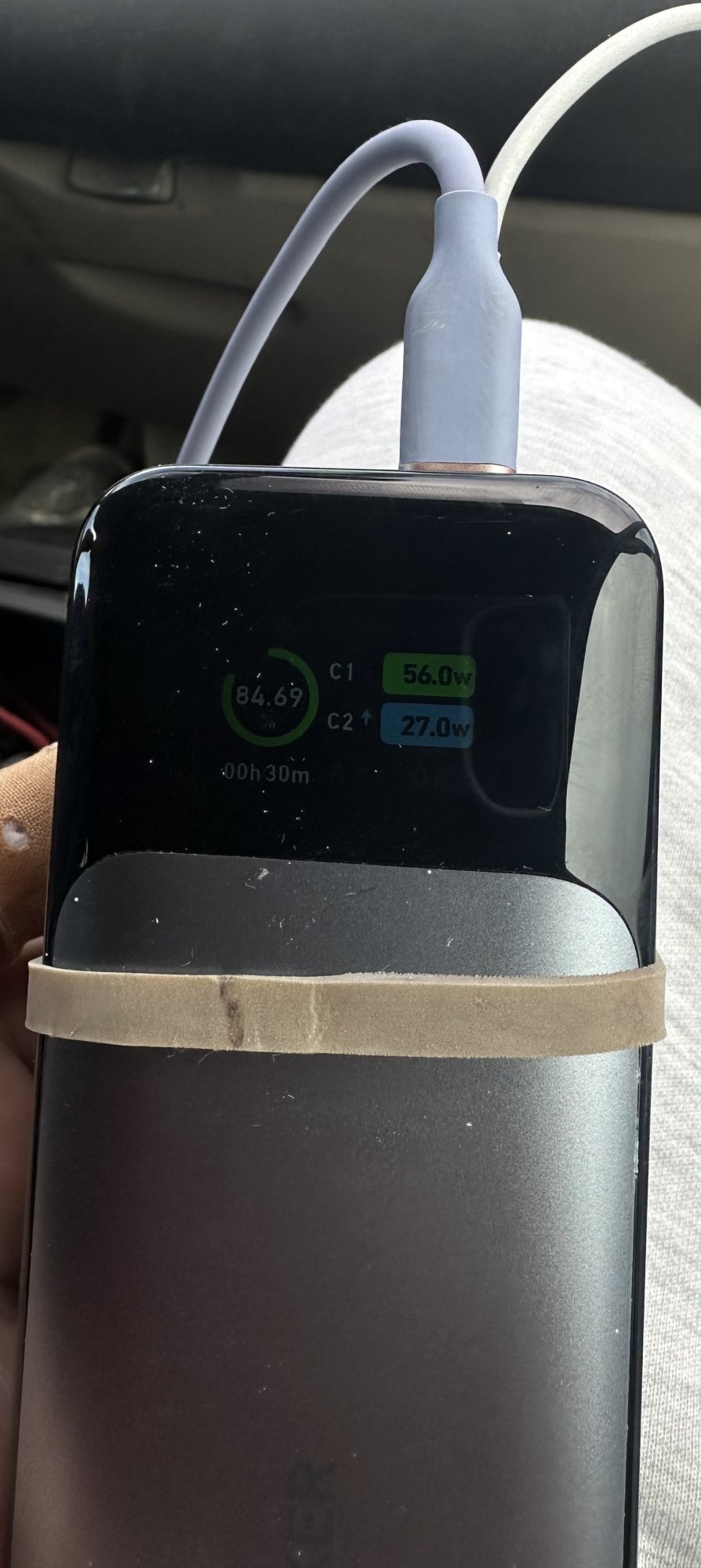

The 737 will smart charge on both usb-c ports. I’ve tried them both with a phone that is at 7% battery life. 15ProMax
It will max at 20w when battery is below around 30-40% and there on out it will max at about 10w.
