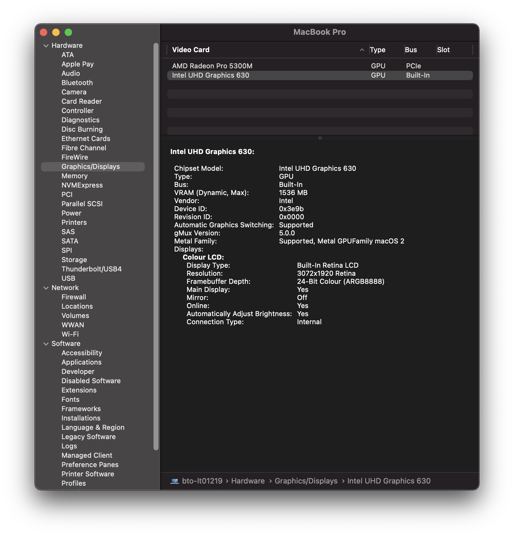

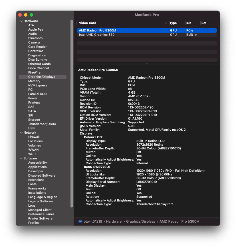

I have been experimenting with plugging and unplugging the power adapter cable and the display cable (both attached to the right hand side of my MacBook Pro (16-inch, 2019). The external display is a BenQ EW3270U capable of 4K.
I work from home for 1 year now, and my machine remains "permanently" attached to the power cable and the external display (USB-C cable) at the right-hand side of the MBP.
I have the impression that sometimes the OS fails at recognising the external display, reverting to a "safe" mode (often 1080p @ 30Hz but sometimes even a much lower resolution). Looking at the display preferences was not very helpful so I decided to look at the system report to detect changes while experimenting with the cabling and powering.
Today my MBP had a free boot-up from powered-down, but still attached to the power adapter and the external display (as usual when working from home). It booted up and showed 1080p resolution @ 30Hz instead the expected 4K @ 60Hz:
Then I removed the power cable. No changes were reported.
Then I detached the external display cable. This triggered a switch to the Intel graphics adapter:

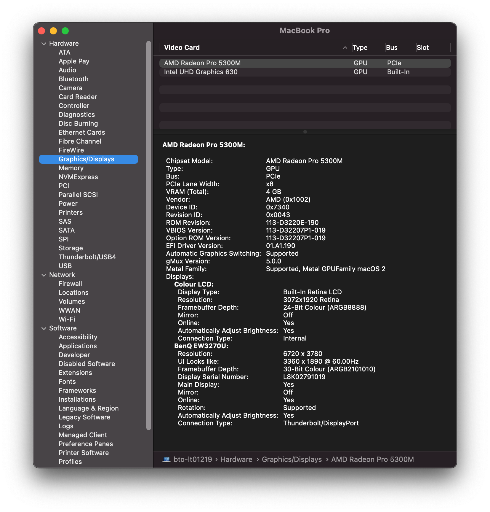

Then, while still unpowered, I reattached the external display. The resolution remained unchanged at 1080p but the refresh rate doubled from 30Hz to 60Hz:
I decided to reboot (with display cable attached, but not connected to power), but I still only got 1080p resolution.
Then I reset PRAM and rebooted (still unpowered) and the display resolution of the external display was again correctly identified. I hd of course to reconfigure the display settings, but at least I again had a 4K monitor:
I suspect that there's something wrong with a redesigned driver in Big Sur that fails to correctly detect all graphics and power events. I provided this info to Apple through the Feedback Assistant, and hopefully we'll see a fix soon.
