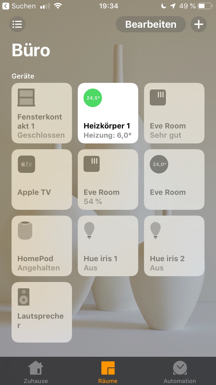

I see my stereo paired Sonos One‘s as one speaker in the home App, but it is definitely stereo sound that is playing on it. Just tried it out with „Every you and every me“ by Placebo.Can you pair 2 sonos speakers as a stereo pair in the home up?

I see my stereo paired Sonos One‘s as one speaker in the home App, but it is definetly stereo sound that is playing on it. Just tried it out with „Every you and every me“ by Placebo.
That is true, but you can use Siri to start playing Music on the Sonos devices. Just tried it with my HomePod.You can’t use voice controls everything has to be done in an external device
Or when airplaying to 2 sonos ones gets you 2 times mono sound?
