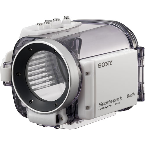

2. Sony can go underwater and be operated from outside an inexpensive $199 underwater housing. Canon cannot.

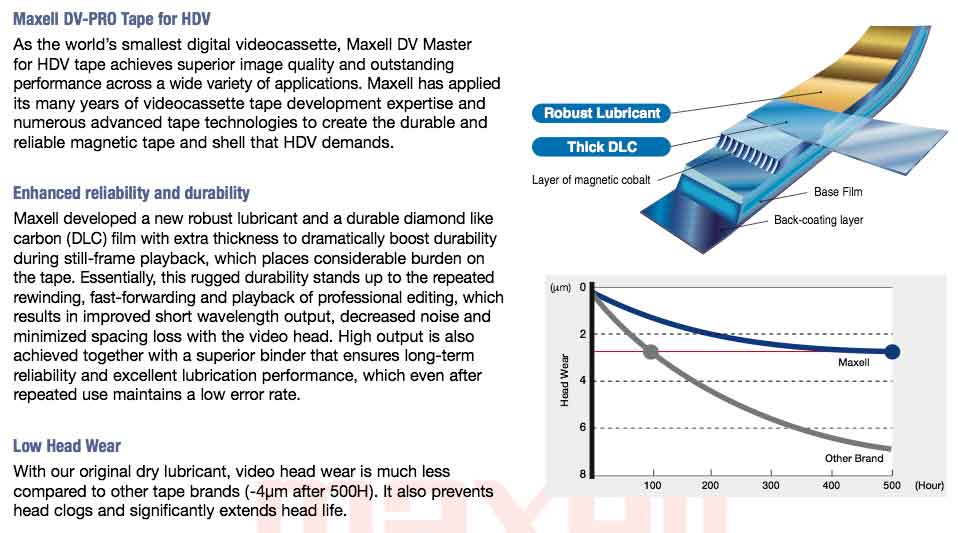

Maxell HDV Tape Is A Superior Formula 4 Min Drop-Outs, Longevity On The Tape @ $4.50

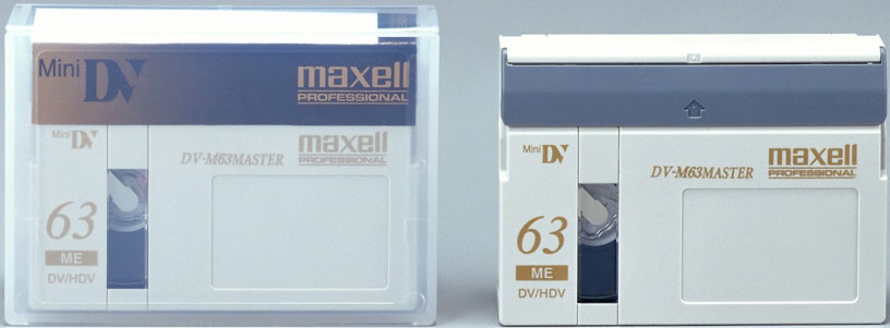

Either cassette will work the same way. BUT, The Professional HDV miniDV cassettes are made of a much higher quality Metal Evaporated formula instead of the cheap consumer DV Metal Particle formula that guarantees maximum quality recordings - i.e. almost never any dropouts with maximum signal to ratio - and much lower head wear.
I WAS planning on buying the more expensive Sony HDV miniDV cassettes for those reasons. I want to make sure I'm recording on the best tape I can buy. I know if I'm recordding on the best professional Metal Evaporated formula and not cheesy Metal Partical tape, then the recording barrel (it's a fast spinning head that the tape passes over) will last longer and the recordings will last longer on the tape as well. The HD tape is much smoother with a better lubricant on it so it will definitely help the heads last longer. Maxell DVM63PRO @ $4.50/reel is the way to go. Details below.
Also, you can get the Sony HDV DVM-85HD tape in 85 minute rolls @ $13.95 (pictured below) in addition to the 63 minute rolls. Maxell is not promising longer reels in future at this time. I shoot presentations and sessions at trade shows that might take longer than 60 minutes so this is great for certian long recording sessions. Another might be a long time underwater. Weddings would be another where you want to get the first 85 minutes without missing a moment. But they cost about $14 each so there's a cost benefit trade off for that length. Amazon is now selling the 63 minutes reels in two packs for just over $9 which appeared to be the lowest price to date when I started this article yesterday (still revising Friday afternoon). But as a result of writing this article for ya'll I found a source where a better alternative brand and model cost less - Way Less. How about Professional Maxell HDV 63's for $4.50 a roll in 50 reel cases or $4.95 in smaller quantities? Details below.
If you want to go all the way, there's also the Sony PHDVM63DM 63 minute Digital Master Pro HD Mini DV $15.48 Professional grade HDV tape stock (pictured below) you can buy from pro video dealers. That's the world's best HDV tape you can buy today for about a 200% premium. Full description of what it is is at that link's page. I figure the consumer branded reels' formula is almost as good. My GUESS.

Does anyone know of a better price on tape? Ok I found $4.50/reel for even better NEW tape from Maxell at TapeResources in Virginia Beach VA 800.827.3462:
Tape Resources is selling the brand NEW Maxell HDV Formula DVM63PRO Professional MiniDV Tape 303140 reels for $4.95 x 5 or 50 @ $4.50/reel cases. Whew. That was close. Almost made a fatal error. OK so forget the above and buy this Maxell tape in 5 paks for $24.75 or 50 pak cases for $225 from tape resoruces. One other thing? Make sure to stay with the same tape foever. Once you choose a brand and model number, always use the same brand and model. Why? Because the heads will not like a change in tape formula rolling over them. Can cause lots of problems.
I'm placing my first case order right now. It's a new model only two months on the market. Have to buy 55 to get free shipping but all are @ $4.50 for total of $247.50 a case plus one 5 pak. I think that $4.50 is definitely worth it for peace of mind you are using really good tape in your really good camera. I've called Maxell and will be getting a not more details from them tomorrow on this product which I will post when I get them.
This tape consistently records more than 65 minutes on each roll. Longest DV tape I've ever used. Great results.
Glad you asked. This answered my tape questions as well as yours. 🙂
So I posted all those Sony tape pics and now I'm saying "forgetaboutit" and buy the new Maxell DVM63PRO from Tape Resources for $4.95 in 5 pack boxes or $4.50 in 50-at-a-time bulk purchases (or 55 to get free shipping) depending on how much shooting you do. I've added the main part of Maxell's White Paper explaining their tape's technology including a graphic of how the tape is constructed and a chart showing how their tape will give you much less head wear than if you use consumer video tape.

Actually.... seeing how cheap the SPK-HCC is could possibly sway me back to the HC7.
