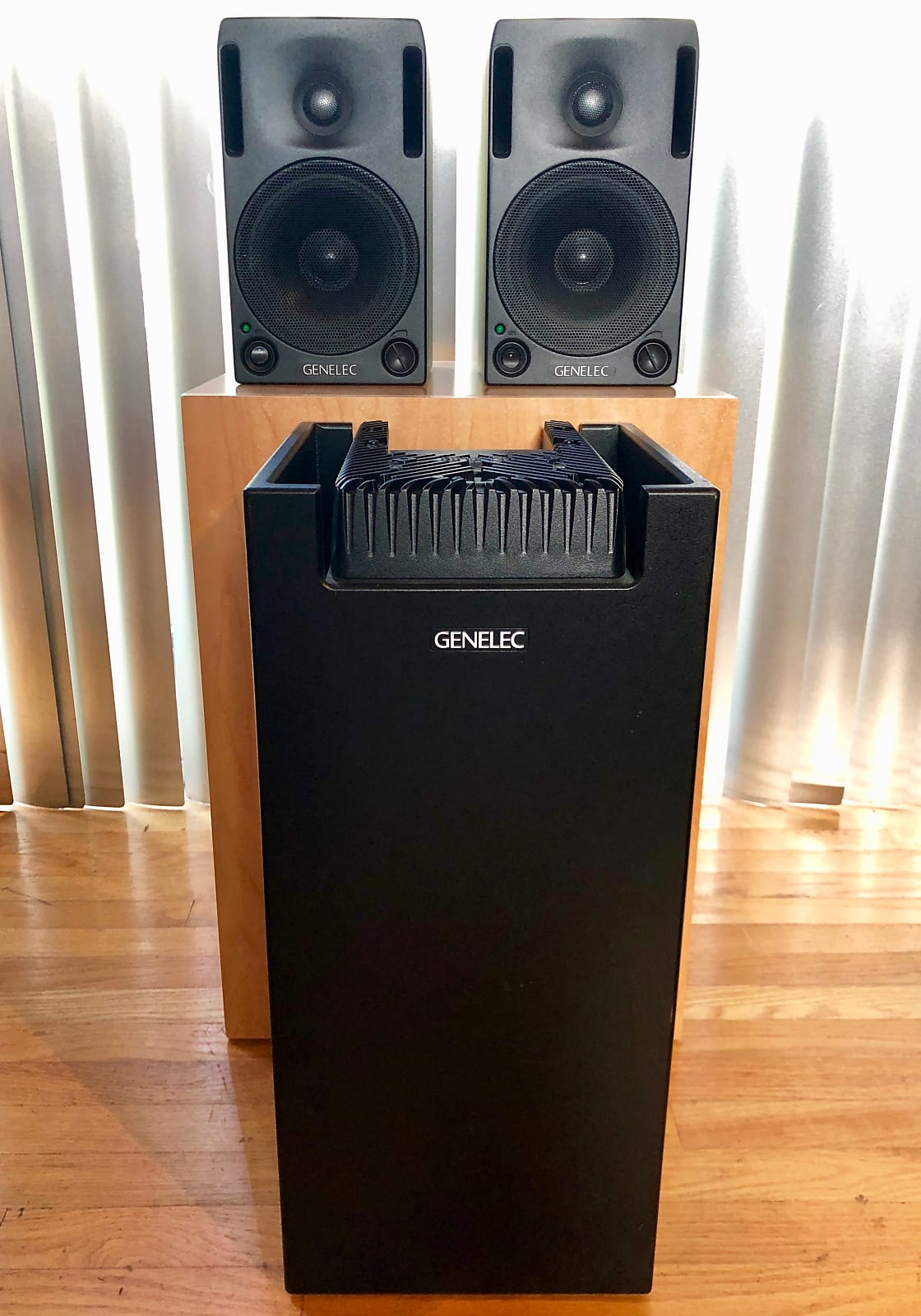

i recently purchased a setup for my living room. a pair of vintage genelec 1029a and 1091a sub. got all of it for around a thousand dollars and i'm sure i'll like them much better than any contemporary hi-fi setup i could have gotten new at that price.
That’s a nice haul for $1K.
