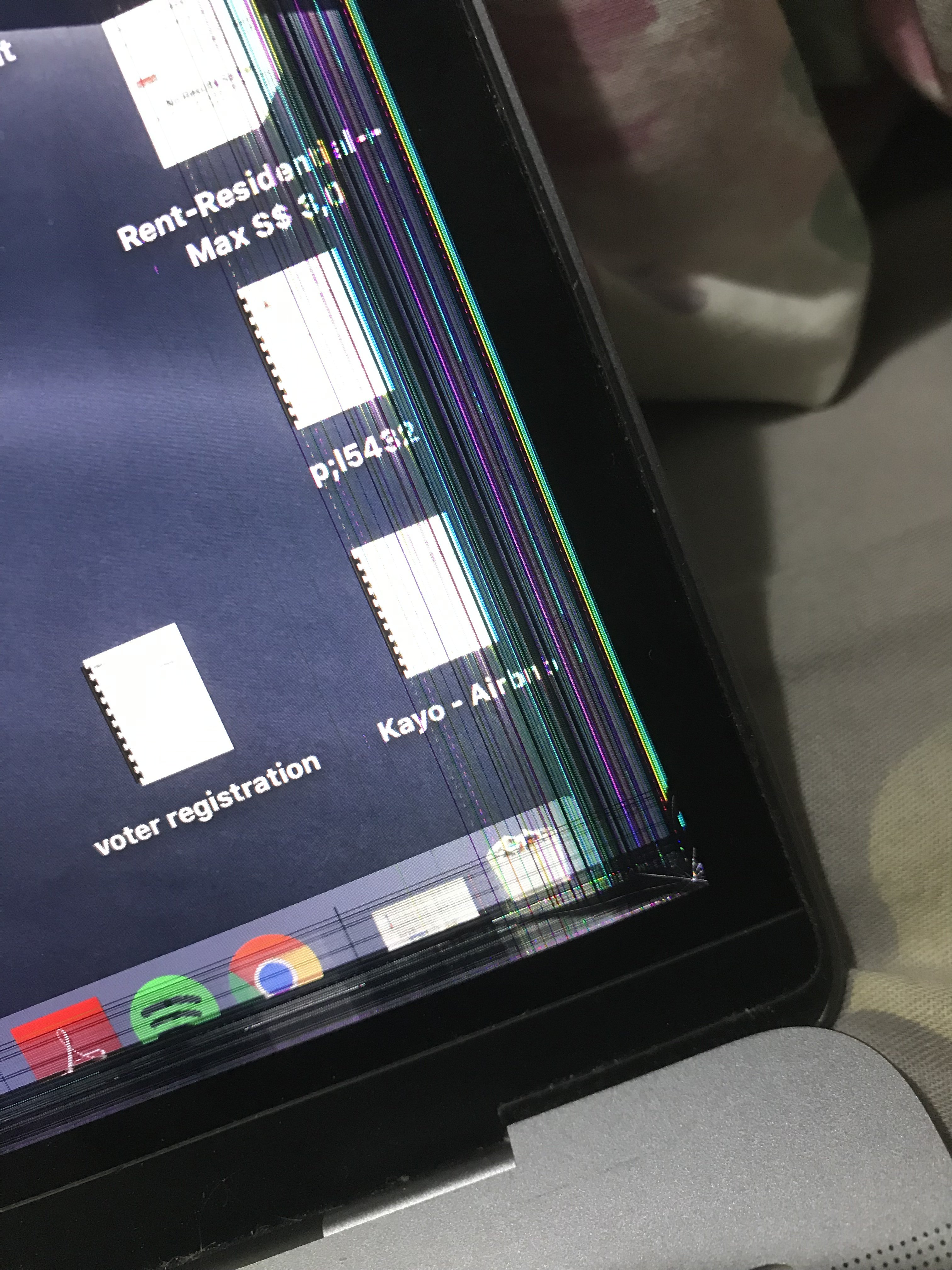

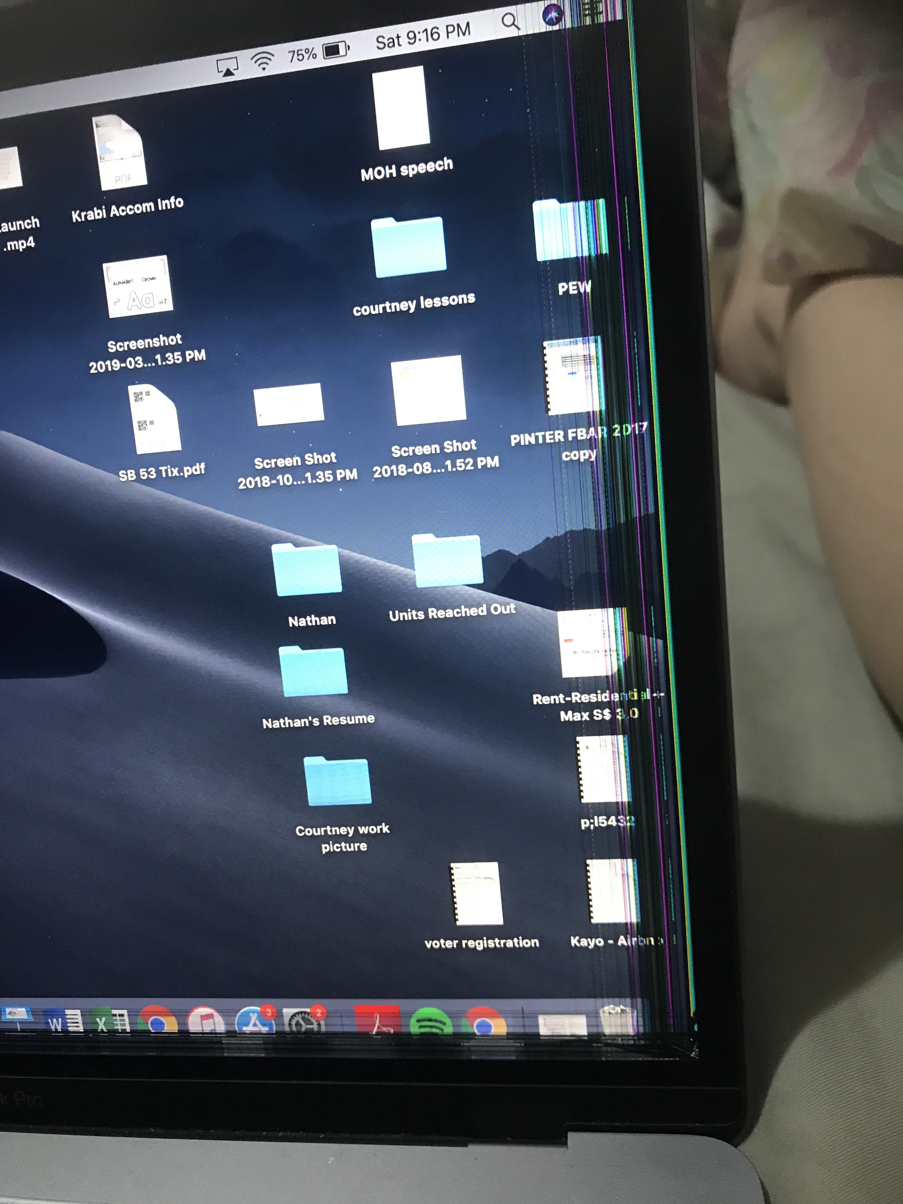

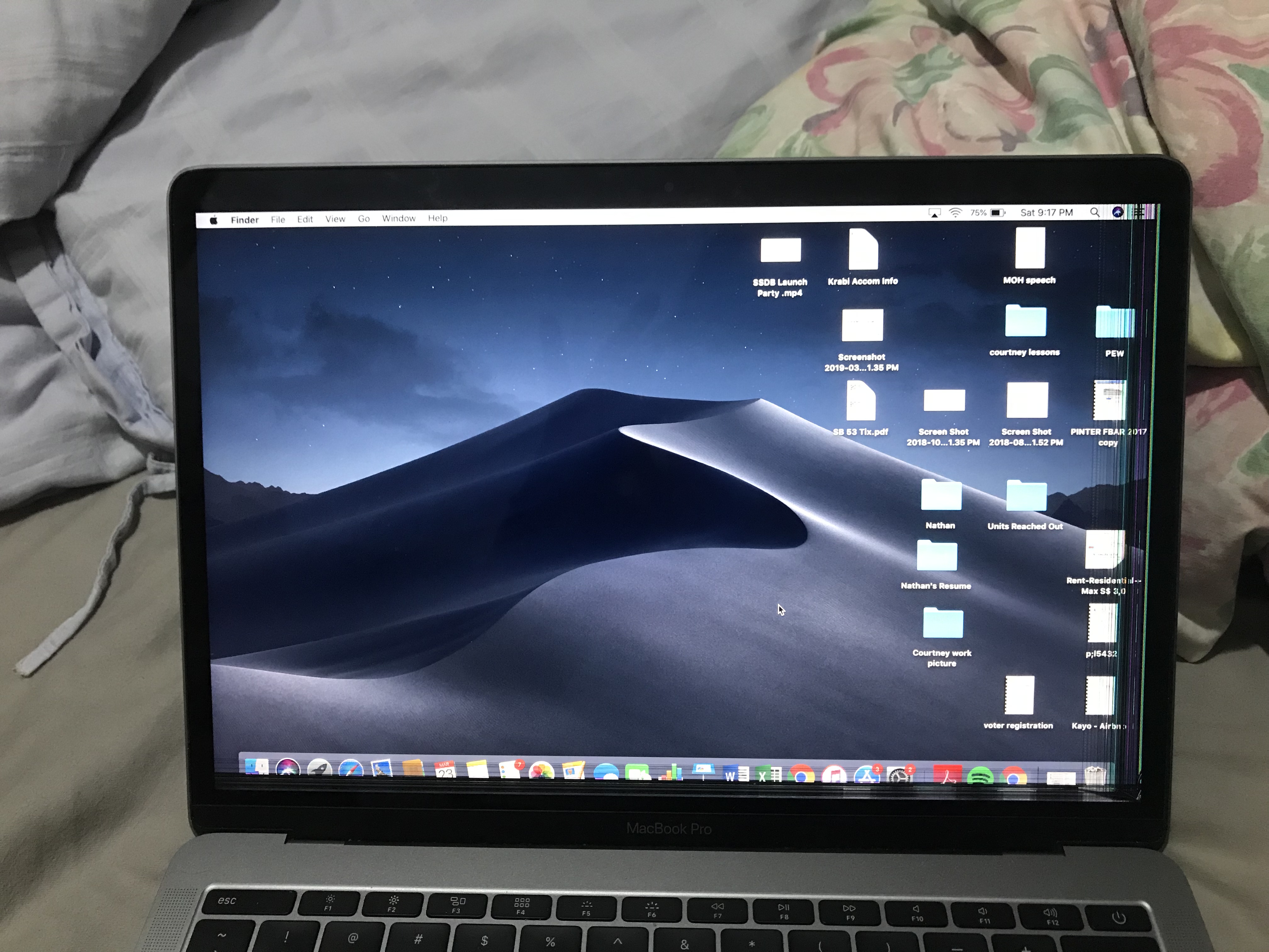

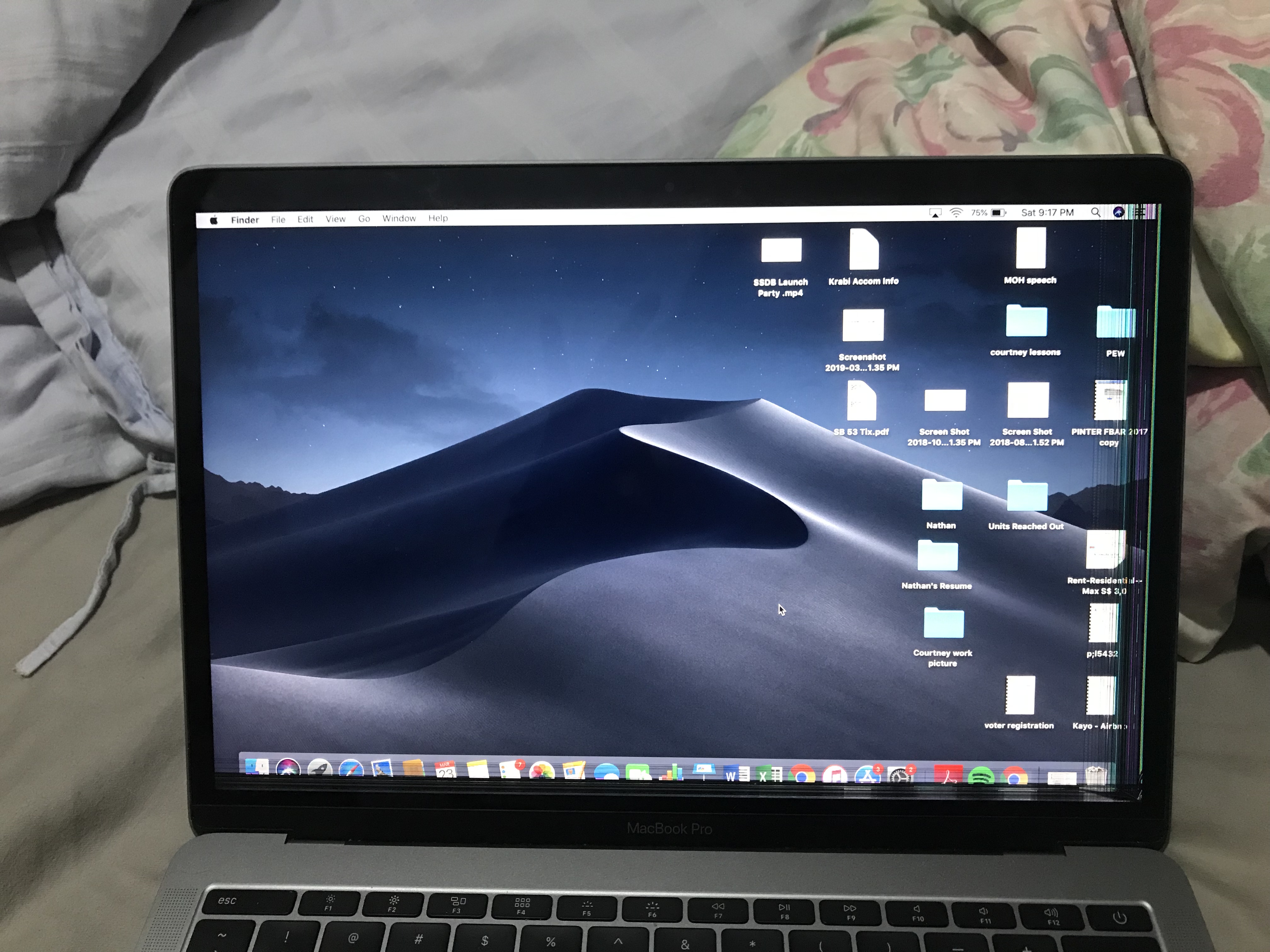

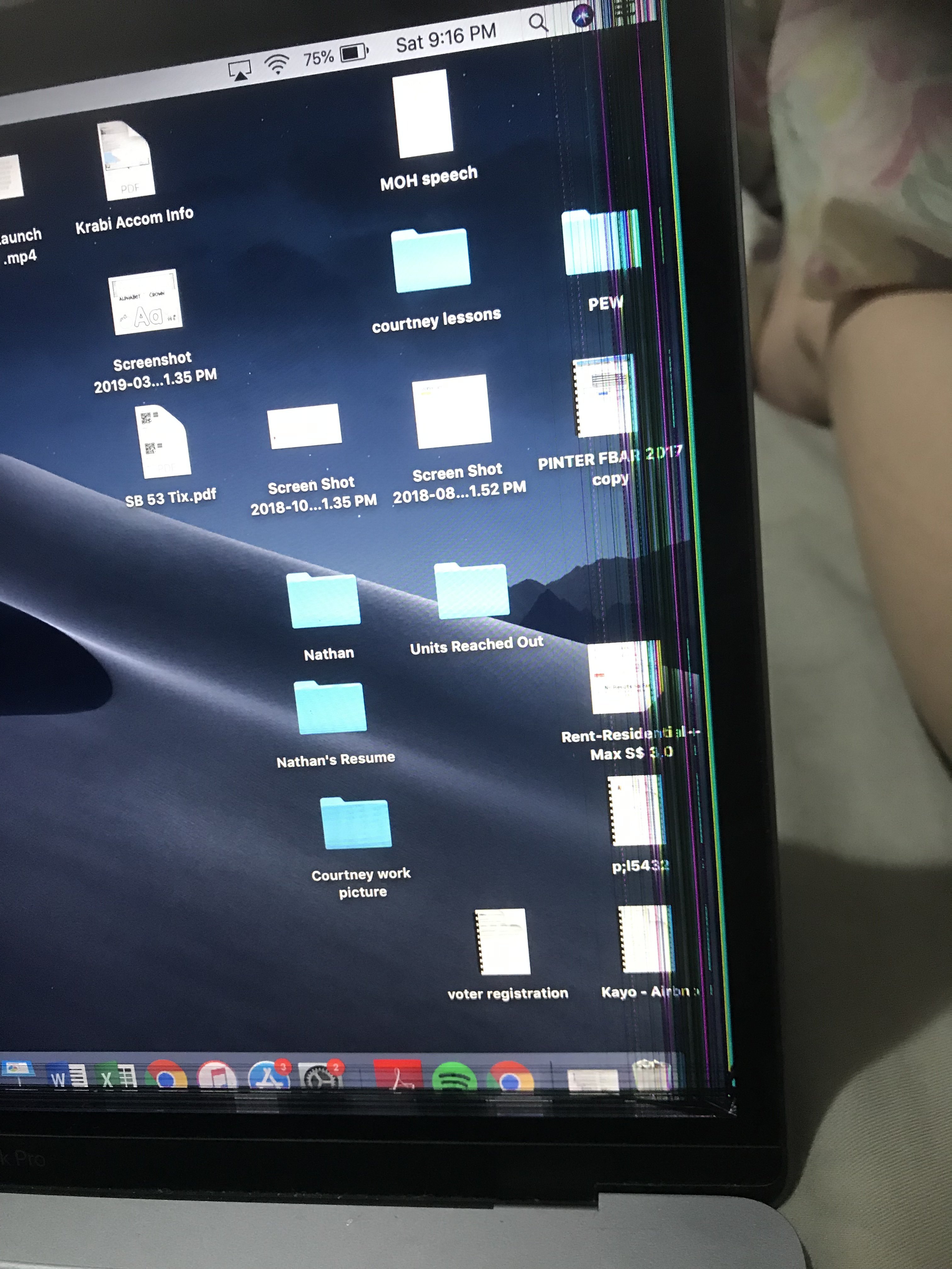

I bought my 13” MacBook Pro in February 2018 with AppleCare. Last night,I closed my laptop screen. When I opened it this morning (in the same spot I closed it last night) there were colored lines running vertically and horizontally from a black spot in the bottom right corner. After taking it to an authorised care center (not the actual Apple care center/genius bar), the tech said it was caused from force and would not be covered under AppleCare. There is no external damage, and I merely shut the screen, so I have no idea how I could have caused this, as the tech is claiming. I have made an appointment with the actual AppleCare genius for next week, but in the meantime, has anyone else had a similar problem?
View attachment 827866 View attachment 827867 View attachment 827868 I bought my 13” MacBook Pro in February 2018 with AppleCare. Last night,I closed my laptop screen. When I opened it this morning (in the same spot I closed it last night) there were colored lines running vertically and horizontally from a black spot in the bottom right corner. After taking it to an authorised care center (not the actual Apple care center/genius bar), the tech said it was caused from force and would not be covered under AppleCare. There is no external damage, and I merely shut the screen, so I have no idea how I could have caused this, as the tech is claiming. I have made an appointment with the actual AppleCare genius for next week, but in the meantime, has anyone else had a similar problem?
Do you have AppleCare or AppleCare+? If AppleCare+ it should be covered under accidental damage. Though if it was damaged like that merely from shutting the screen, baring anything being trapped between the laptop deck and the display, I would suspect maybe a hinge issue?
I just have AppleCare, so she quoted a minimum of $500 to fix.
Hopefully, you will get a more favorable result from the actual Apple Store Genious. If you are sure that nothing got trapped between the display and the laptop deck, as them to check the operation of the hinges and make sure it is closing evenly and properly without more force than should be necessary. Maybe they will find something the AASP missed and cut you some slack. Otherwise yeah, the $500 minimum is likely to be just that, a minimum.
Sometimes your credit card can have some inclusions that might help, some offer accidental insurance coverage from 14-90 days, depending on the card. It might be worthwhile checking the card you used unless you paid cash. Then that is another issue 🙂
The damage is, without a doubt, impact damage. Either you closed the screen on something, or something hit your screen with enough velocity to cause the damage. There is absolutely zero chance that the damage was spontaneous in any way.

Nope, I explained the situation above. If something hit my screen it occured in an empty house? The only possibility then would be I closed it on something, but it would have to be something quite small for me not to be aware of it. And, when I opened it the next day there was nothing between the screen and keyboard. There is no damage anywhere externally.

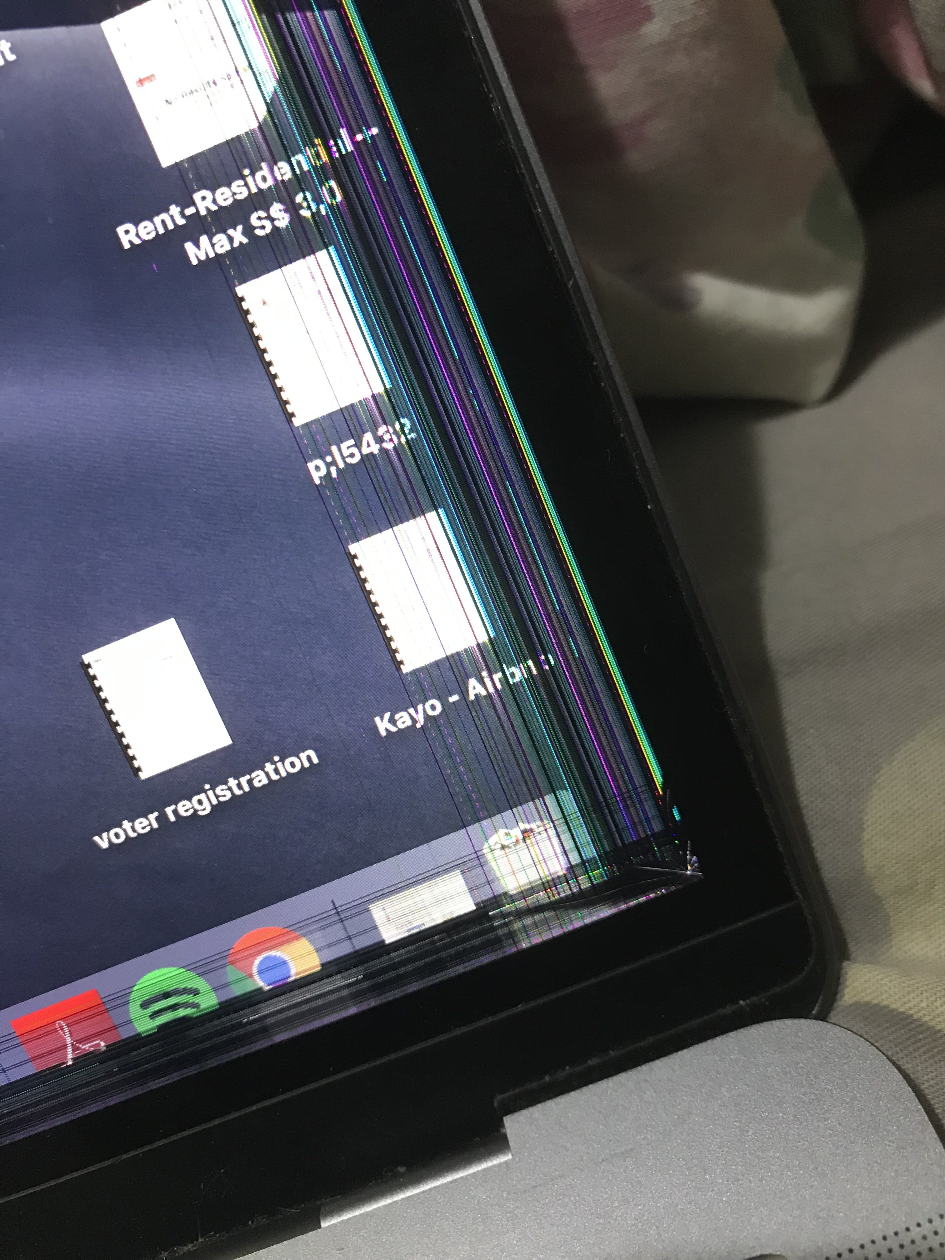

Saw this with a friend. He had a piece of paper after a meeting and put it inside his laptop and closed it. When he went to open it, he had exactly the same thing. We realized there was a staple on the corner of the paper that had messed the screen up, but it doesn’t even have to be that big.
Just a small little item likely did it for you, but unfortunately it is almost definitely that something was in between your screen and keyboard when you closed it. I’m sure you didn’t realize something was in there, but unfortunately that is probably what most repair people are going to say.

As others have stated here, either this is an impact damage (i.e. something was on the keyboard when you closed the screen) or you have an overly tight hinge on that side. Have you noticed the monitor being stiff to close at all on that side?
When double click and zoom in the image it looks to me like some sort of impact in the lower right corner. There seems to be cracking spider webbing out from that corner, especially on the last image.
Maybe at some time previously it was closed on a earphone cable or something else and over time the damage grew to the point where it caused the screen to fail. Sort of like when a rock hits your windshield and it looks like there is no damage, but a week or even a month later a visible crack forms.

Do you happen to know if it will spread? The area affected is quite small and if I am going to have to pay a significant amount to replace it, I’d rather just leave as is.
In our case, we did exactly what you did, realized how much a replacement was and he tried to just use it. A week or so after it happened, the entire display started to not turn on when it should. For instance, I could listen and hear the computer running and fan spinning, but the display wouldn't work.
Typically, after a few tries of opening and closing or restarting with the power key we could get the screen back like normal.
This behavior continued for another week or so until it continued to get worse. I don't remember the actual cracking getting much worse, but the underlying damage did continue to get worse over the couple of weeks we tried to just leave it as is.
So in short, yeah it probably will, but there isn't any harm in trying it for a week or so and possibly getting lucky that the damage is contained. If you do end up replacing it, you will probably be replacing the entire lid and display assembly so no harm in trying to get an extra couple of months out of this one until you can save up for the new parts/repair.
It will likely spread at some point. Particularly if it is a flaw with the hinge or something putting undue stress on it. But just cycles of getting warm, cooling, etc. will likely cause it to spread in the future. Probably more a question of not if, but when, unfortunately.

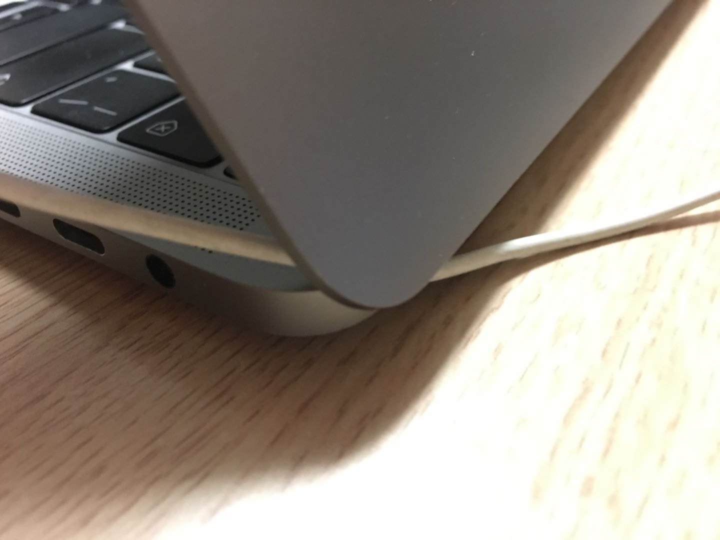

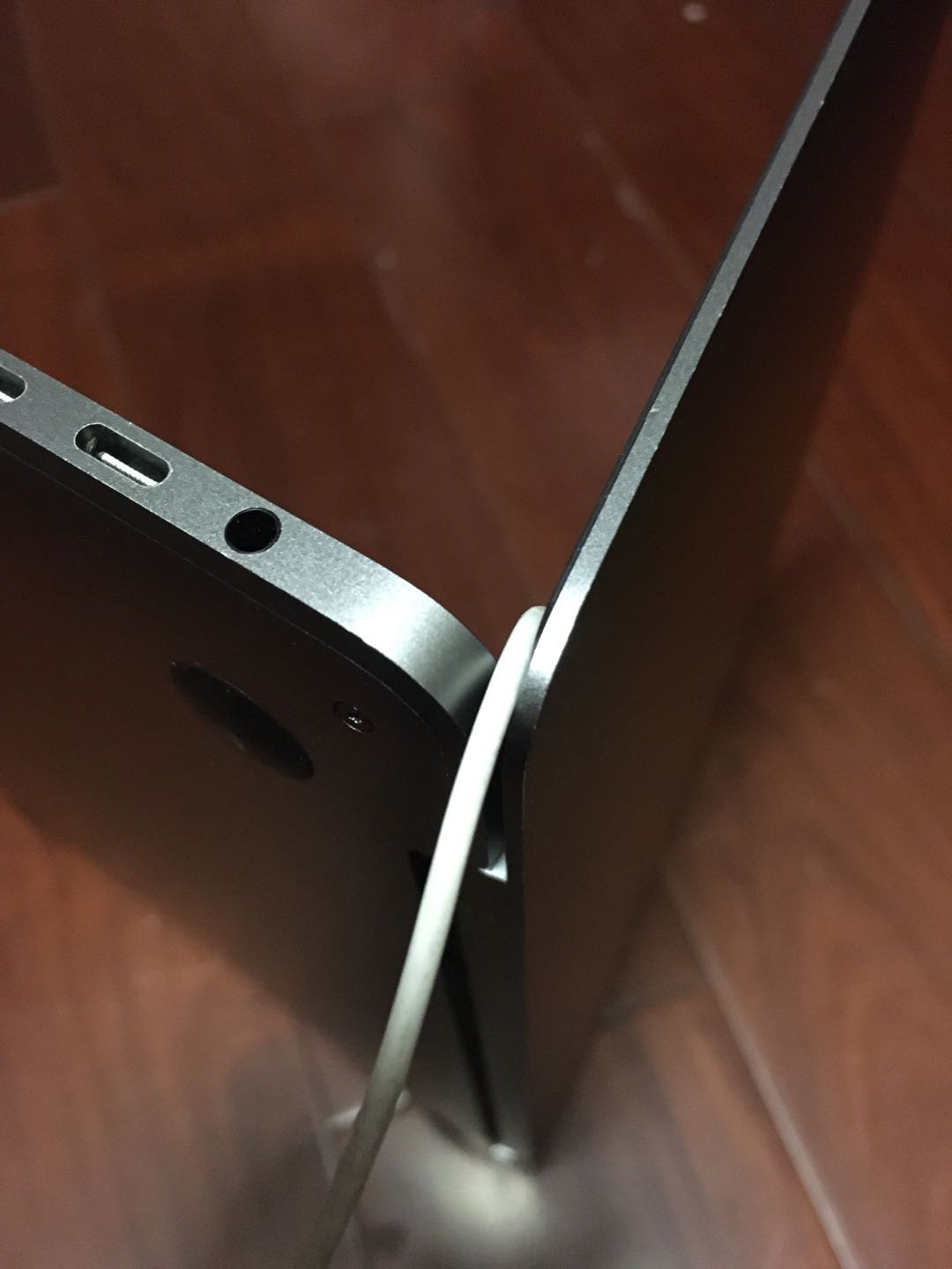

An internal crack around the lower corner of the Macbook Pro (A1989) occurred to me, as it occurred to @Courtneypinter1 and many other people. Apple refuses to cover the repair cost of it, even when the device is still under warranty. I remember how this crack developed. The fact is Apple cracked the screen with a design flaw. It should repay the cost of repair to all impacted Macbook Pro owners.

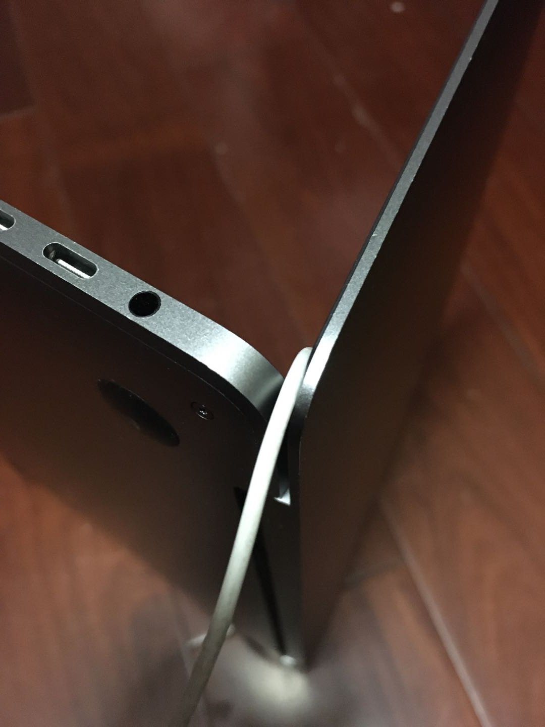

Let me explain what happened. About a week before I noticed the screen deterioration, I felt some resistance when tilting my laptop screen away from me. As I found out, the USB-C Lightning cable stuck under the screen and the bottom piece of the laptop, near the lower right-hand side of the hinge. I took the cable out and was able to tilt the screen. Nothing abnormal showed up on the display. However, a week later, I started having flickering horizontal bars near the bottom of my screen. An hour later, vertical bars started showing up on the right side. A few hours later, the screen started turning mostly dark. With a few reboots and a couple more hours, the screen will remain mostly dark. The laptop was basically useless. Nothing would not even show up even if when I connected the laptop to an external monitor.
Apple's design flaw allows for their own lightning charge cable to get stuck between the bottom of the screen and the base of the laptop. While that happens, any tilting away of the screen will potentially cause the cabel to apply pressure to one of the lower corner of the screen and cause an internal crack. Basically, Apple's design flaw cracks of the internal piece of your screen, which Apple charges $500 or more to fix!!!!!

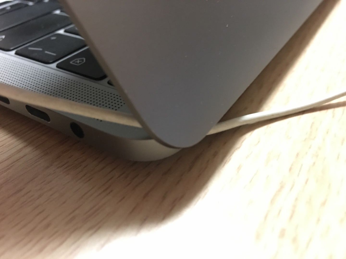

Really having a hard time visualizing how the cable/connector got stuck between the screen when merely plugged in with lid closed. My cable doesn't protrude above the bottom casing even a fraction of a mm. It is actually recessed a fraction of a mm below the case when you slide your finger across the case to the base of the cable.
I'm putting the earphone cable between the bottom corner of the screen and the base to illustrate how the cable can be stuck between the screen and the base while the lid was half way open and how it can create unexpected pressure to the corner of the screen when you try to tilt the lid further open. Hope these two pictures help to illustrate the problem.
Thanks for your reply. I've started a new thread https://forums.macrumors.com/thread...p-screen.2230192/?post=28350811#post-28350811 and uploaded two pictures to explain the situation.
An internal crack around the lower corner of the Macbook Pro (A1989) occurred to me, as it occurred to many other people. Apple Store refused to cover the repair cost of it, even though the device is still under warranty. I remember how this crack developed. The fact is Apple cracked the screen with a design flaw. It should repay the cost of repair to all impacted Macbook Pro owners.
