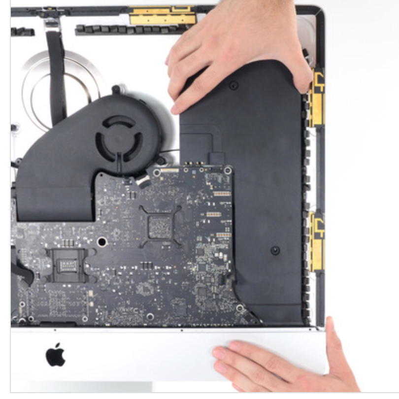

I don't understand how that would affect anything though. The speakers are incased in a plastic box like device almost all the way at the top inside of the iMac. You'd have to turn the iMac upside down and spray liquid directly into the speaker holes to have a chance of it getting to them.
