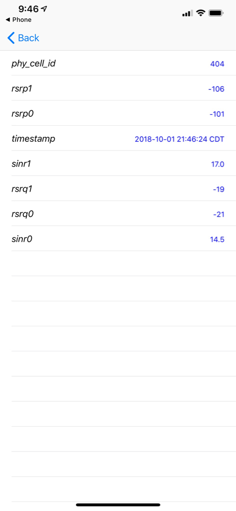

Firmware can't fix hardware is been tested and proven that in lower level signal areas the new iPhones have more trouble than others holding signal. Also bars are not an accurate representation of signal.. DB noise levels are.
If you really want to see your real signal strength do this open up the Dialer Keypad in Phone and dial this:
‭*3001#12345#*‬
Hit the call button then choose LTE from the menu that pops up. Then select serving cell meas..this will show the info your looking for. Your will be presented with this and screen:
Rsp0 is the tower you're currently connected to rsp1 is the backup tower.
Now what do the numbers mean well here are the ranges:
-90-and higher excellent
-91--105 good
-106--120 fair
-121--124 poor
-125 no signal
Software patches maybe able to help mitigate issues by increasing antenna gain but will never completely fix hardware and design flaws.
