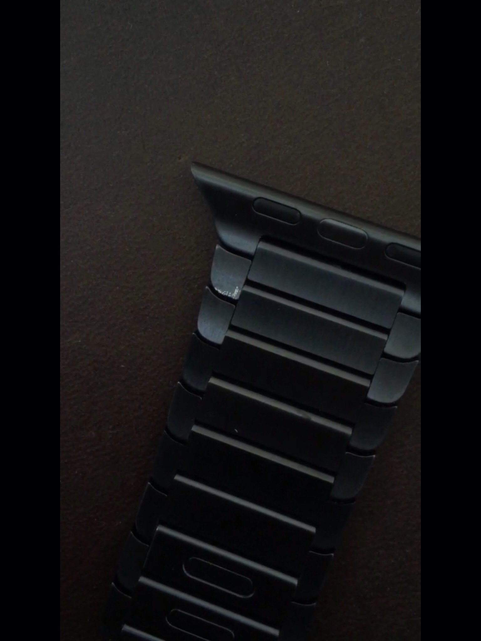

I have had my watch for about two weeks now and have noticed something interesting on the inside of the Black Link Band. I really doubt that this is normal and do you think Apple will issue me a replacement if I showed them the peeling?
It's strange that it only peels at a specific area of the link band. on both sides of the watch. I am imagining that these are stress points?
Thoughts anyone?
View attachment 558023 View attachment 558024

One thing I noticed about the link bracelet in the store was that tolerances between the links were extremely narrow. This makes for an extremely precise construction of the bracelet...no wobble between links, no loose spots.
But it also lends itself to problems when it comes to coatings. Even the tiniest metal burr between links will become larger when a coating is applied. When there's so little room for movement between the links, that newly coated larger burr will become a tiny chisel when it moves against another link.
This could be why you mostly see the chipping near the spaces between the links.
In order to facilitate mass production, Apple probably just DLC coated the same steel bracelets they use for the non-DLC version, but in reality they probably should have milled or cast the DLC version's parts several microns smaller to accommodate the DLC coating.
But what do I know? I'm no engineer.

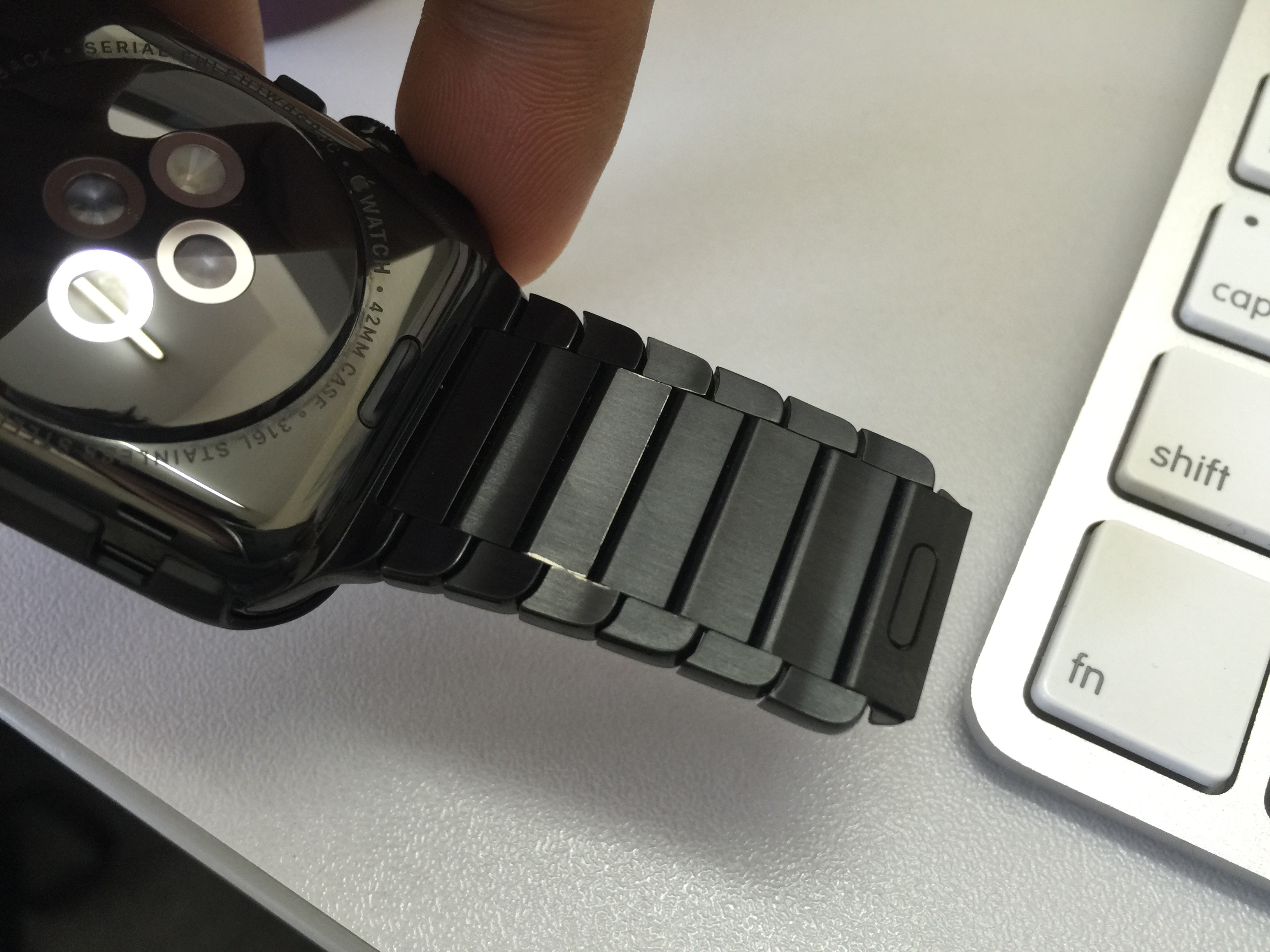

After reading this thread, I inspected the underside of my SBSS link bracelet. I'm disappointed to have noticed the same phenomenon with mine. I've been wearing it for two weeks; have not banged it up against anything. The only things the underside of the band has been exposed to has been skin, non-workout daily perspiration, and one quick rinse-off with water.
I took pictures and a video this afternoon and contacted Apple. I need to bring it into a retail store for a physical inspection and to have the defect documented by an employee. At least I now have the issue verbally documented and on file with Apple.
With the (glacial) pace this particular model has rolled out, and given that Apple is not yet up-to-speed with having pre-orders delivered, I'm not realistically expecting to have a replacement band in my possession until July, at the earliest. But, fortunately, I have Apple Care Plus with the watch, so I won't have to surrender the defective band until I have a replacement in my possession. But I do expect to get a replacement band. This -- however minor in appearance -- should not be happening with a $500 band. And it makes me apprehensive about what I might notice after two more weeks, two months, and then several months down the road with daily use.
Finally, I have to say that I'm otherwise very, very pleased with this watch. Absolutely no buyer's remorse and no regrets about being an early adopter on this. This particular watch is a real joy and a pleasure to have.

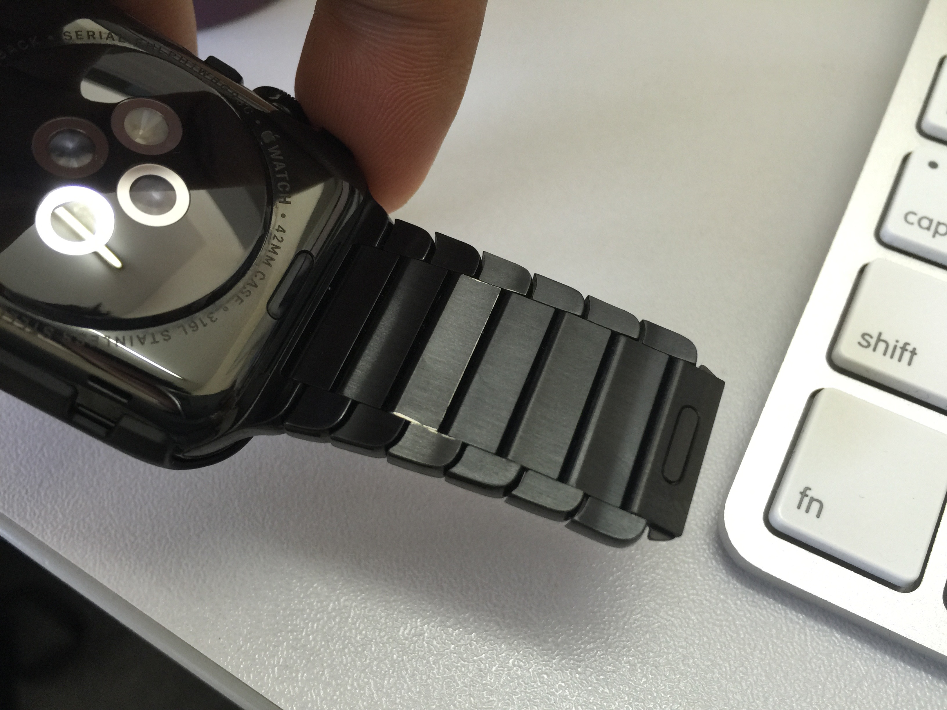

View attachment 558551 After reading this thread, I inspected the underside of my SBSS link bracelet. I'm disappointed to have noticed the same phenomenon with mine. I've been wearing it for two weeks; have not banged it up against anything. The only things the underside of the band has been exposed to has been skin, non-workout daily perspiration, and one quick rinse-off with water.
Thanks for sharing your picture. I think that it is unfortunate to hear news like this from others who have the same issue but also fortunate if we can send out these reports to Apple helping them realise that they might have an issue with their coating process and hopefully this will move them to do something about this.
I am hoping (yet also hoping not) to see a few more people take a look at their band after a week or two of use to see if there has been any rubbing off as well with the coating from the inside for us to make a case for Apple to possibly do something about this.
Do you could PM me your case number and I would be able to quote your case as well noting that I am not the only one experiencing this?
