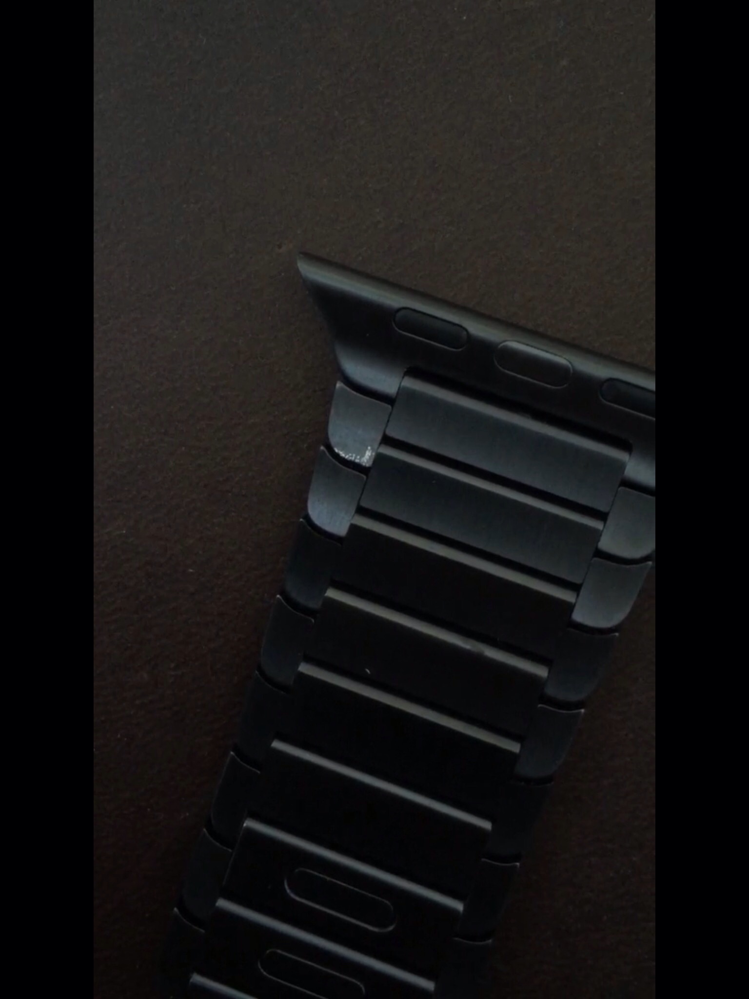

Is the problem with your band limited to a single link? It looks like it from the pictures, but I can't tell for sure.
That link may have somehow missed a cleaning step or some other surface preparation prior to DLC coating. It could be as simple as someone touching the part with bare fingers after it was cleaned. That could keep the DLC from bonding to the metal as it should.
I expect Apple will give you a replacement band eventually. If they had plenty of them available, they'd probably just swap it immediately. But they don't have them.
It's very unlikely they'd try to recoat a defective band. They'd have to disassemble all the links, strip them down to bare stainless steel, and then repeat the whole DLC application process from start to finish. DLC isn't like paint, where a second coat can hide minor imperfections in the first coat.
An ultra-thin black coating on a silvery substrate wears through in a tiny spot... And you all are surprised, disappointed, shocked?

There's no similarity between a black anodized aluminum iPhone and a black stainless steel DLC watch -- except the same name is used for the colors. Anodizing is a completely unrelated process, and experience related to an anodized aluminum product is pretty much irrelevant to discussions about a stainless steel watch.
The original poster's photos don't show wear. They show a coating that (for reasons unknown at this point) failed to bond properly when it was applied. As he pointed out, the problem area isn't a significant point of contact when he wears the watch.
Something went wrong with the coating in that particular area on a single link. That by itself isn't terribly surprising. Inspection failed and the bad link wasn't rejected, and it wound up in a customer's band. That isn't surprising either -- no inspection process is perfect. The interesting questions are how often these bad things happen, and how quickly Apple can improve the processes so that they have a steady supply of defect-free bands.

A DLC coating is not supposed to wear off like a coat of cheap paint. So yes - we're all very surprised, disappointed and shocked.
And how is "a friend who managed to dent the third link from the bottom on his two-day old link bracelet" and who is "not blaming Apple for his negligence" in any way related to the problem that's being discussed here?
Those who have reported the problem have also reported that they're not aware of having done anything to cause it - so why are you suggesting that they've been negligent?
It seems some forum members have no idea why we are disappointed/ shocked. May I make an example for this?
For those who know what DLC is, we know that DLC is not painting. Just like we know that diamond is not glass.
If we break a glass, there is no big deal. However, will you be supirsed if we break a diamond?
They looks similar, doesn't mean that they that have similar characteristics. Both the glass and diamond are transparent, but one is easy to break, the other one is almost unbreakable.
This is what's happening. A proper DLC coating may looks very similar to a black painting. However, the painting is easy to peel off, DLC doesn't.

I took pictures and a video this afternoon and contacted Apple. I need to bring it into a retail store for a physical inspection and to have the defect documented by an employee. At least I now have the issue verbally documented and on file with Apple.
With the (glacial) pace this particular model has rolled out, and given that Apple is not yet up-to-speed with having pre-orders delivered, I'm not realistically expecting to have a replacement band in my possession until July, at the earliest. But, fortunately, I have Apple Care Plus with the watch, so I won't have to surrender the defective band until I have a replacement in my possession. But I do expect to get a replacement band. This -- however minor in appearance -- should not be happening with a $500 band. And it makes me apprehensive about what I might notice after two more weeks, two months, and then several months down the road with daily use.
Finally, I have to say that I'm otherwise very, very pleased with this watch. Absolutely no buyer's remorse and no regrets about being an early adopter on this. This particular watch is a real joy and a pleasure to have.
