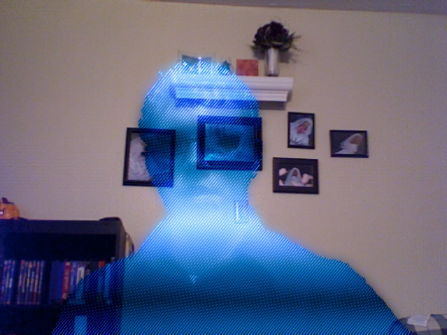

OK here it is. Like I said its not quite right yet, probably need some effects to make the image look grainy etc. And the preview is messed up and it doesnt seem to work in PhotoBooth, just iChat, but give it a try anyway.
Unzip the attached file and put HoloGit.qtz in /Library/Compositions/
Then launch iChat and it should be there somewhere in the grid of effects.
This version uses your existing background but will see about doing one with custom backgrounds.
Not sure if I got the blue or the glow right. The mixing Ive used to make you transparent isnt quite perfect yet either.
Feedback needed.
Edited Sunday to add new HoloGPack1 file which has versions of the effect in various different colours, plus a couple of other experimental effects. The Test1.qtz should work with user backdrops but its not really right yet, an early work in progress.

the "compositions directory" is localized (language dependent). on my german os installation it was /Library/Kompositionen
maybe this helps 🙂

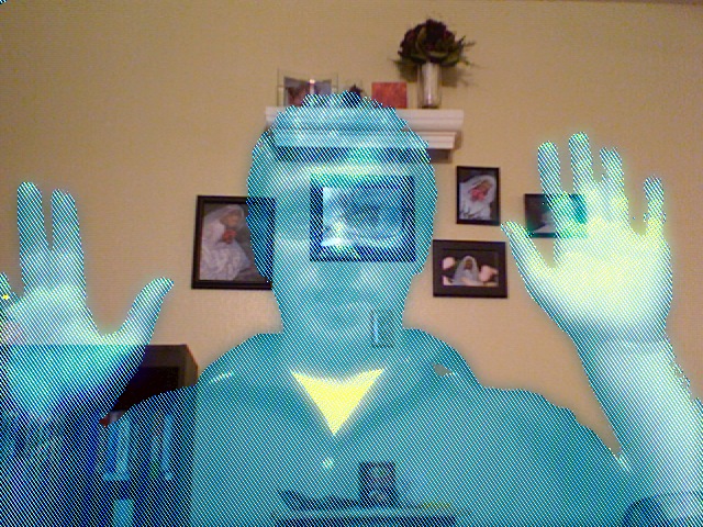

New UPGRADED Hologram effect!
I spent quite some time Joining together and heavily modifying the hologram effects that have already been made in quartz composer. All I did was bring the two great looks together, the real geniuses are "elbow" and whoever else involved. I am just a messenger! 🙂
Note: Since this file is based on "HoloGhostblue" it will actually still be called that in the iChat effects pane. I tried to change it, but didn't know how. Any ideas?
Edit: Ok here are my newest effects! Just download the HoloTruePack2! the one called HoloExperiment is the Upgraded version of my last one. The one called HoloTrue is a very early attempt at appeasing many of the macrumors members who have pointed out that a SW hologram needs the little bars of lighter color moving up and down on the image. see what you think, I think we're getting closer and closer!

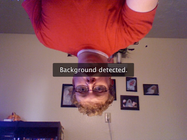

HEY I JUST CREATED THE UPSIDE DOWN EFFECT! HERE IT IS! UpsideDown4! Screenshot on the next page! HERE IS THE ULTIMATE EFFECTS PACK INCLUDING THE BEST HOLOGRAM EFFECT, THE OLD ONES, AND UPSIDE DOWN!

Can you please post a screen shot along with your file?
Screen of my MOD
Sorry, it's really hard to get a good screenshot of an effect that's in motion, but this one's decent
UPDATE! Here's the UpsideDown screenshot!
