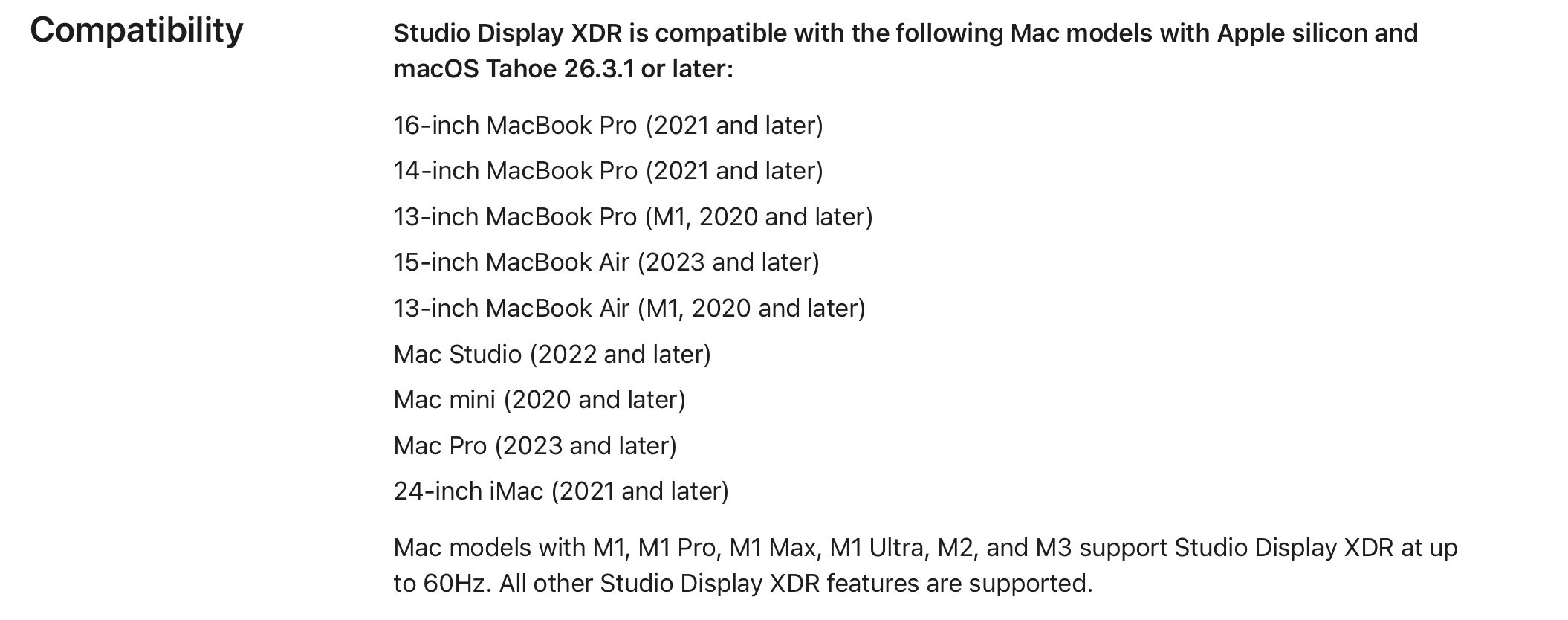

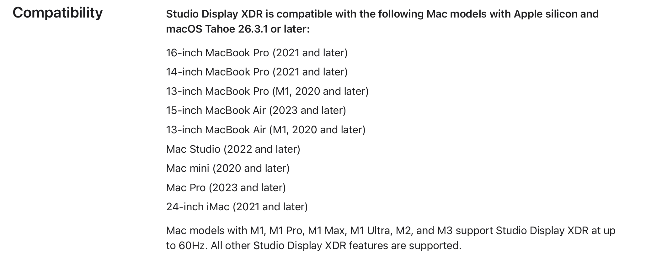

Can someone with the XDR test if Intel Macs can connect to it at 5K resolution, and if the speakers and camera work? The white paper document on the Apple website suggests it works with all Thunderbolt 3 and above Macs. I still have a 2019 Mac Pro in addition to a newer MacBook Pro from work, so I want to check if they both would work with the XDR before buying it and what limitations there would be for non Apple Silicon
It should work like it does on Windows - no fancy features but should work as plain speakers and webcam
