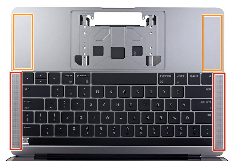

Orange boxes show where internal speakers are located.
iFixit also found that the new improved speakers are located in the lower portion of the case, while the external speaker grilles are positioned in the top half of the case and don't even go clear through to the internals, making them extremely unlikely to provide any outlet for audio. Instead, sound is thought to be projected from air vents on the sides of the case - a design feature not seen on the new 13-inch MacBook Pro with function keys.

Update: iFixit contacted MacRumors to say that it has updated the teardown with an extra image that clarifies the situation regarding the speaker grilles. While the main speakers are not located underneath the grilles, a pair of tweeters that do sit under the grilles have through-holes (80 per tweeter) to pass sound out of the case enclosure. The rest of the "holes" either side of the keyboard (over 1,100 of them) are filled in, non-functional, and apparently cosmetic.
Very strange, to my opinion the speaker grills do not make the MBP look any better or slicker.
I would have never guessed that Apple would put fake speaker grills on a Mac. What the hell is going on at Apple these days.
