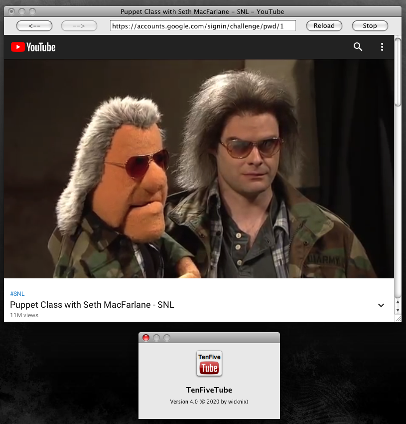

Updated TenFiveTube to v4. Decided to give it visible controls to avoid user confusion on how to operate it. Download attached to first post. Also used @TzunamiOSX 's larger icon.
The "stop" button doesn't work. The little full screen window is also missing at the right corner of the video.
The stop button is to stop loading a web page, like a normal browser. Not stop a playing video. Click on the video to stop/pause it. You will need to relink against Leopard-webkit if you want to enable full window mode as mentioned on the 1st post. Not everyone needs or wants that, so I left it optional in this build. It wasn't required anymore to play music videos, which was the reason I used LWK in v3.

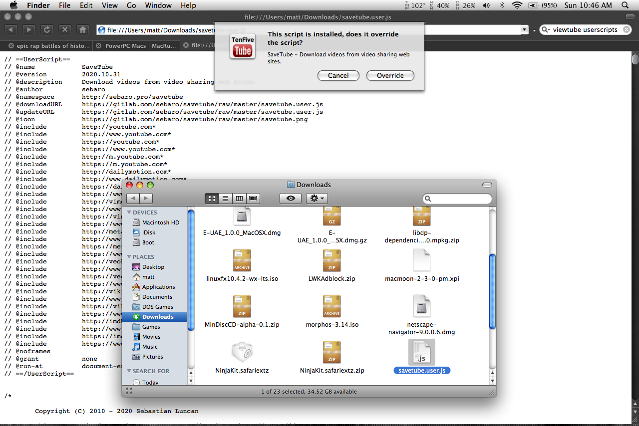

It will install them with going to the scripts website and clicking on the scripts link, or you can also download the script, open a TFT tab, and drag and drop the script on to the blank page to install. Image below shows drag and drop install.
Also make sure you enable web browser mode, as by default TFT only allows youtube and nothing else. Instructions to do so are in the original post.

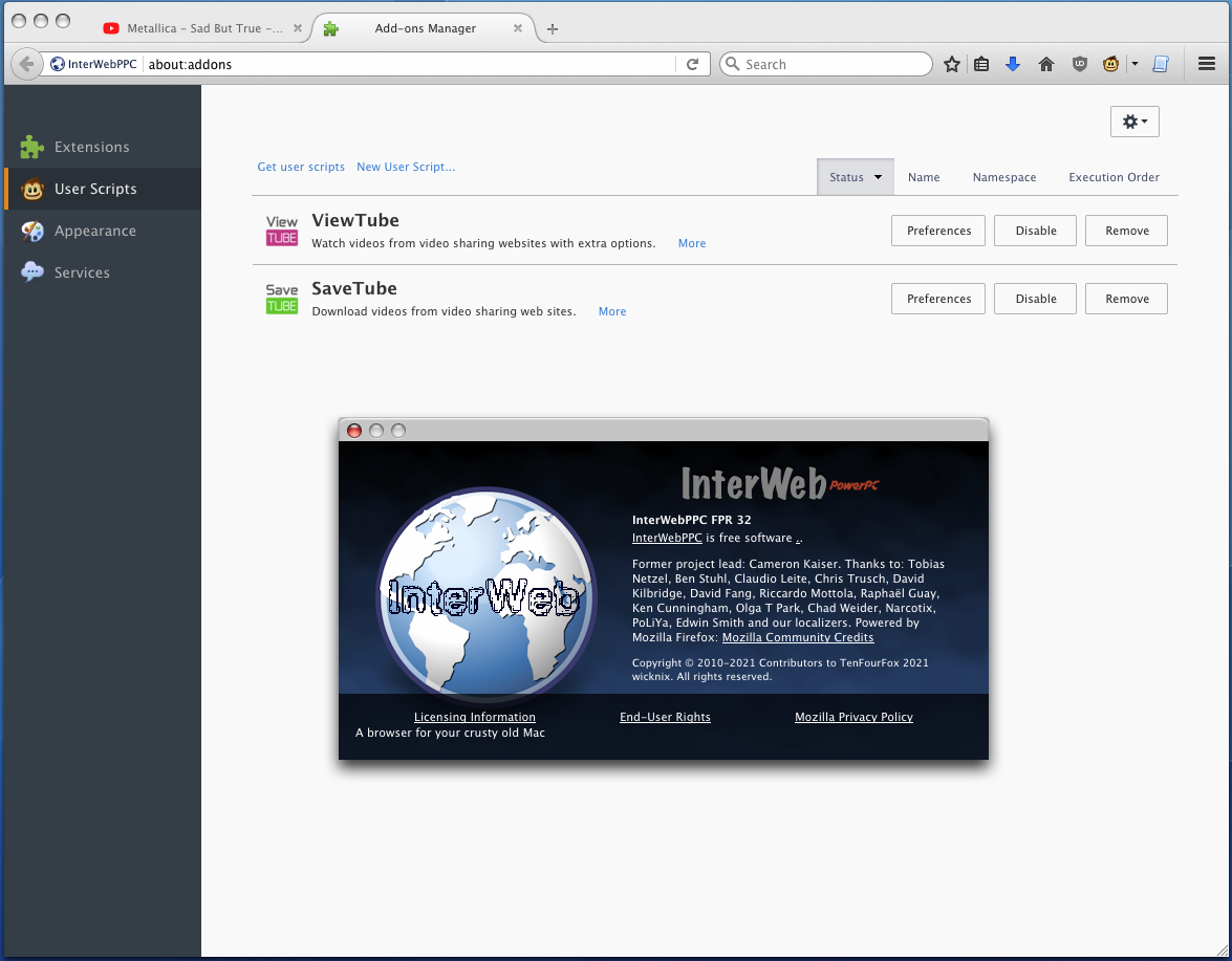

also, both the viewtube extensions in both tenfourfox and interwebppc say they are corrupted and can't be installed

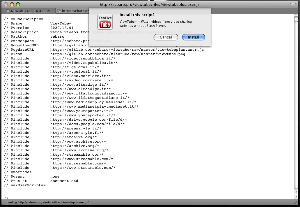

GreaseMonkey-like scripting (install viewtube and viewtube+ to enable video downloading)
Get the scripts here: http://sebaro.pro/viewtube/
You can enable / disable your scripts via the script icon on the menu bar

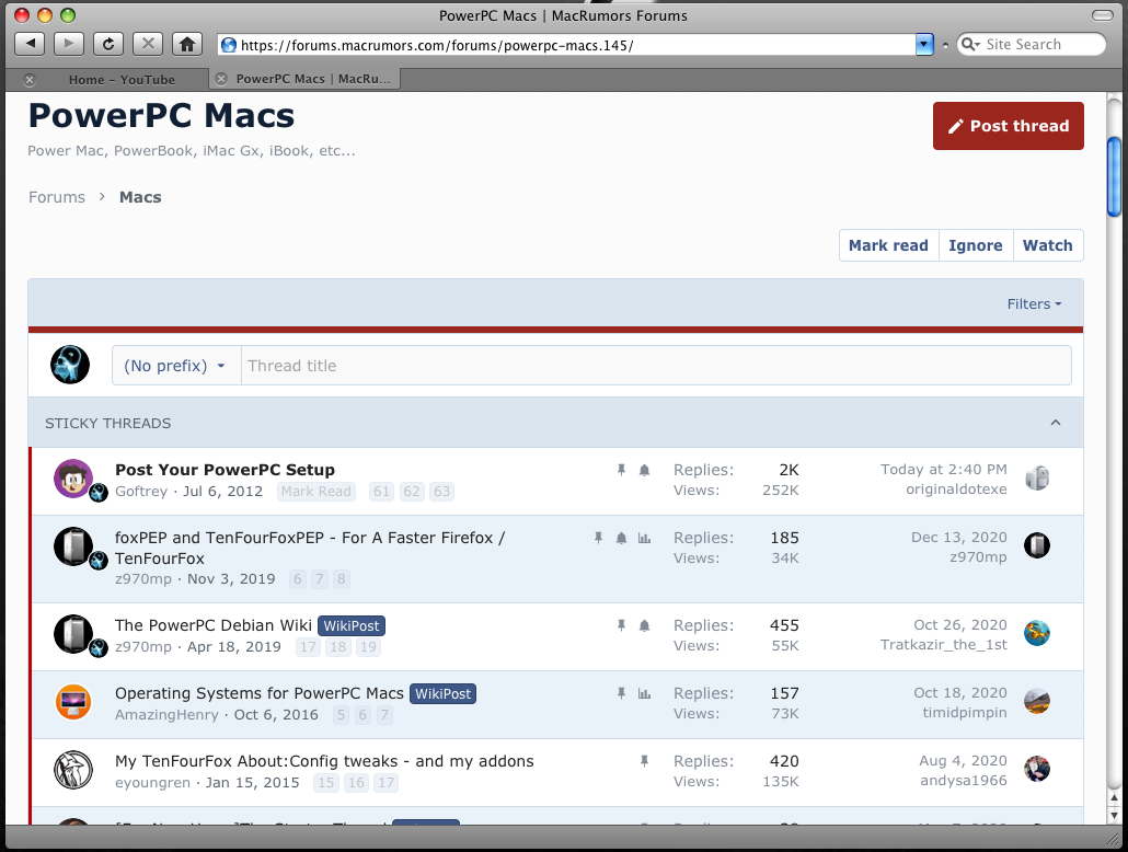

It's also a web browser. Enable the toolbar (menu -> view -> show toolbar)
Then menu -> preferences -> advanced -> allow browsing to any URL (otherwise just browses YT by default)
Type in an address and surf :)

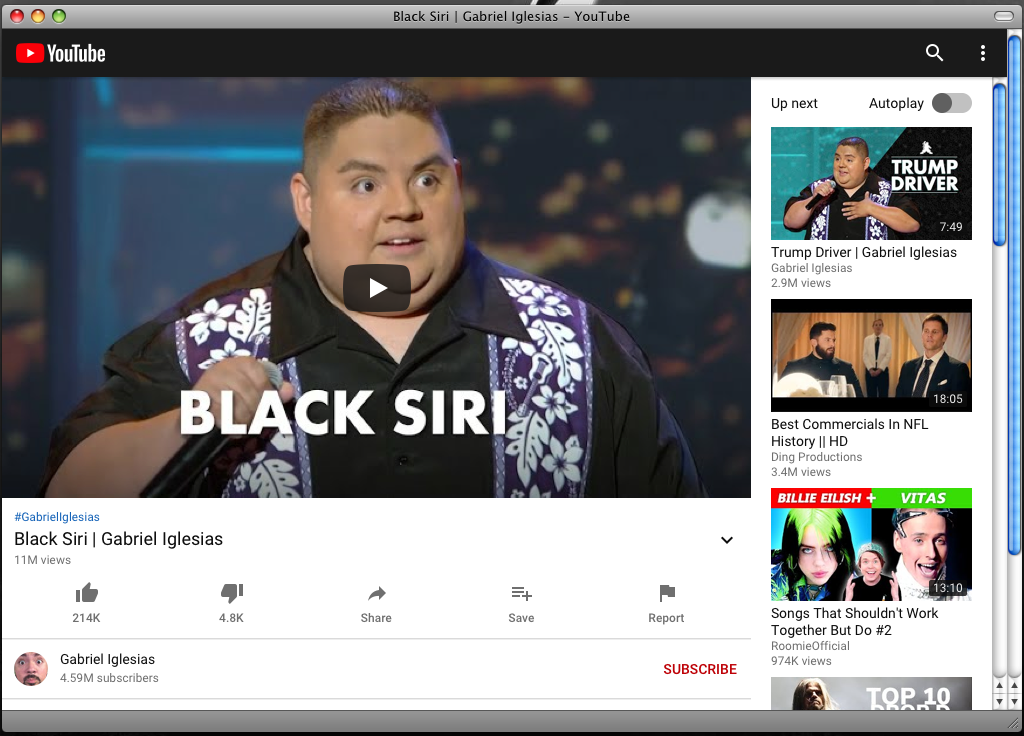

To adjust quality click on the playing video and select the gear icon
To enable full window-mode click on the playing video and click the [ ] box in lower right corner
To enable full screen, menu -> window -> toggle full screen mode

TenFiveTube main window
Installing scripts
Installed ViewTube script allows downloading of videos

Otherwise the arctic fox, interweb, firefox-legacy browsers all play YouTube fine.
