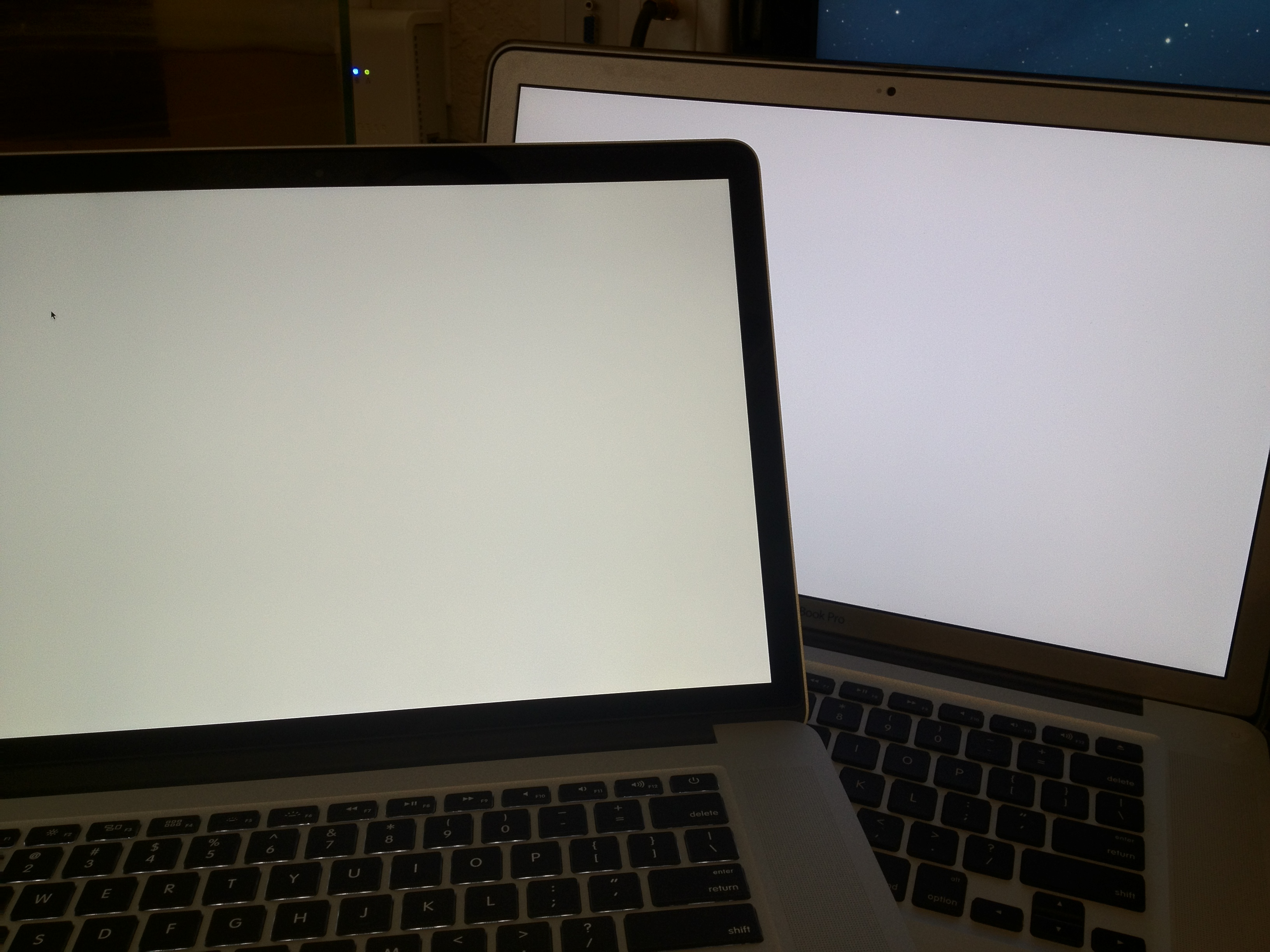

Got my replacement today. It's an LG and it's still got more of a yellow hue to the screen.
Guess I will play with it longer than the 1 day I did last time and probably return it. I haven't tested the ghosting or anything yet. But you can see in the picture I attached there is a difference for sure from my Mid 2010 MBP.

click At the end of the page is a pic-comparison of Samsung / LG screen and yours looks definitly a bit "yellowish". So I would try to calibrate and if it doesnt work... return it.

Yeah I calibrated it and still has a yellow tint compared to my iphone as well as my 2010 MBP.
I'll enjoy this for a bit more then return it. Was hoping to have a good one before my trip to asia but I guess I'll just wait till I get back.
