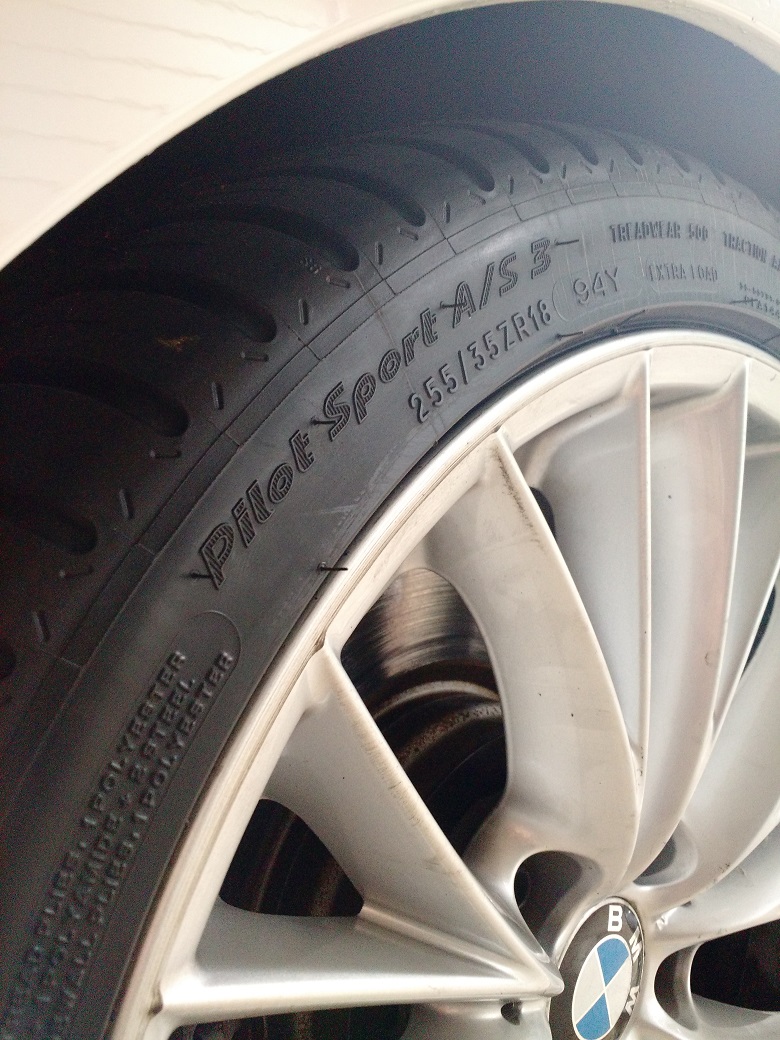

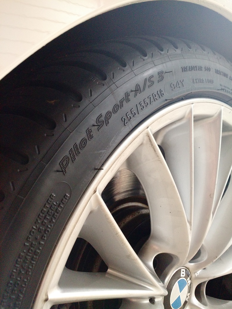

Does new rubber count as a mod?
I went through a set of Pilot Sport A/Ss on my LS a few years ago. No question-they were the best tires I've ever owned!
When they wore out, I had a hard time tracking down another set in the correct size. I ended up going with a Bridgestone Taranza, which is more of a Grand Touring type tire than an all out sport tire. I have to admit that they are quieter and ride nicer, but I miss how great the Michelins handled.

What kind of BMW is that?
Those are fantastic tires!
Car is a E92 335i (N55) 6spd with a JB4 + DP and Koni shocks. I'm loving the A/S 3's for DD activities so far and I expect they'll be good for the Oregon fall/ winter that's ahead.
They're no PSS, but they'll do until I spring for a set of new wheels and go wider (245 F/ 275 R).
Fun. Pics please 🙂
That new wheel/tire setup will be pretty hot - nothing changes the whole vibe of a car more than wheels/tires, especially if combined with a [correct amount] of lowering.
