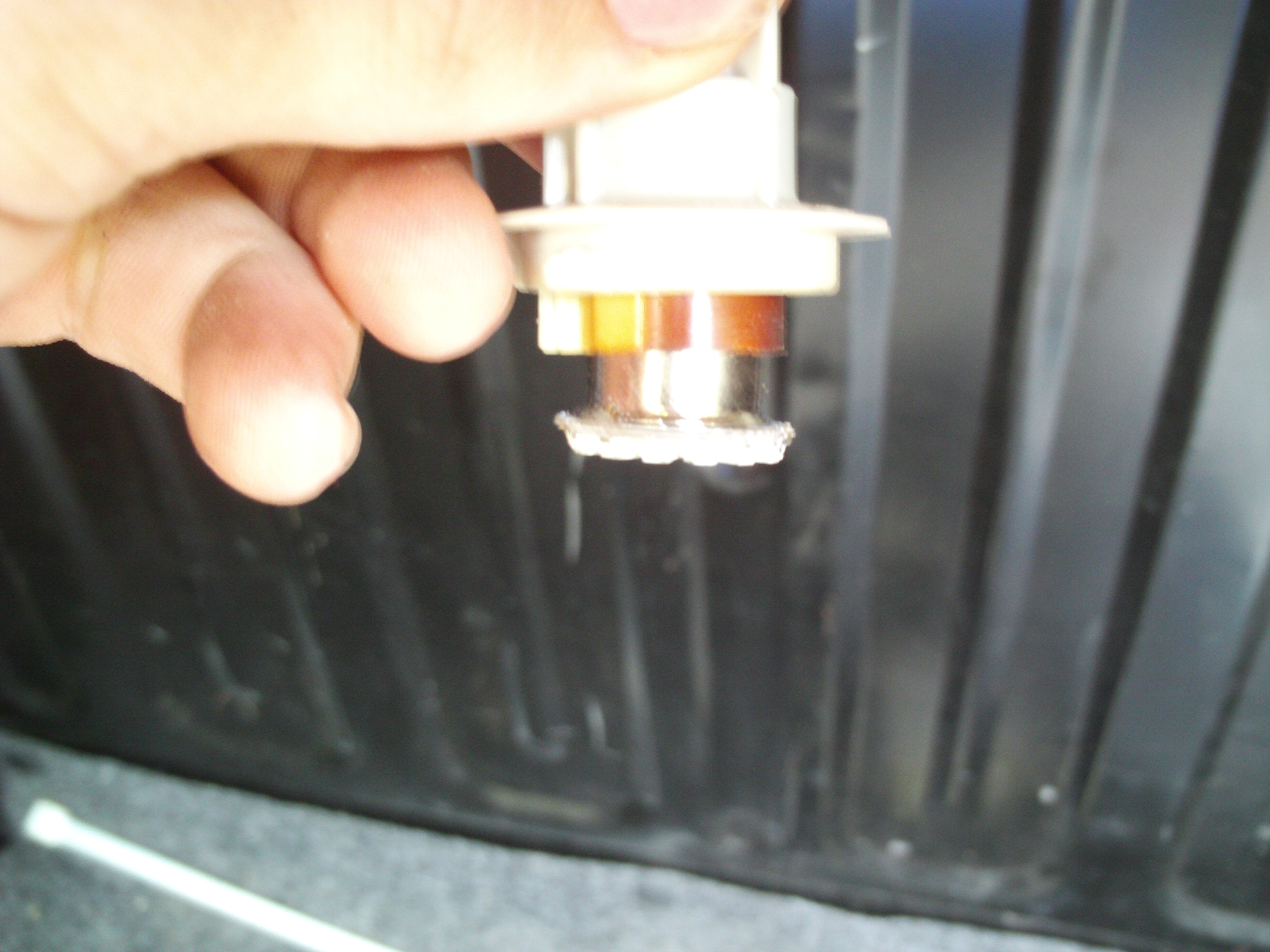

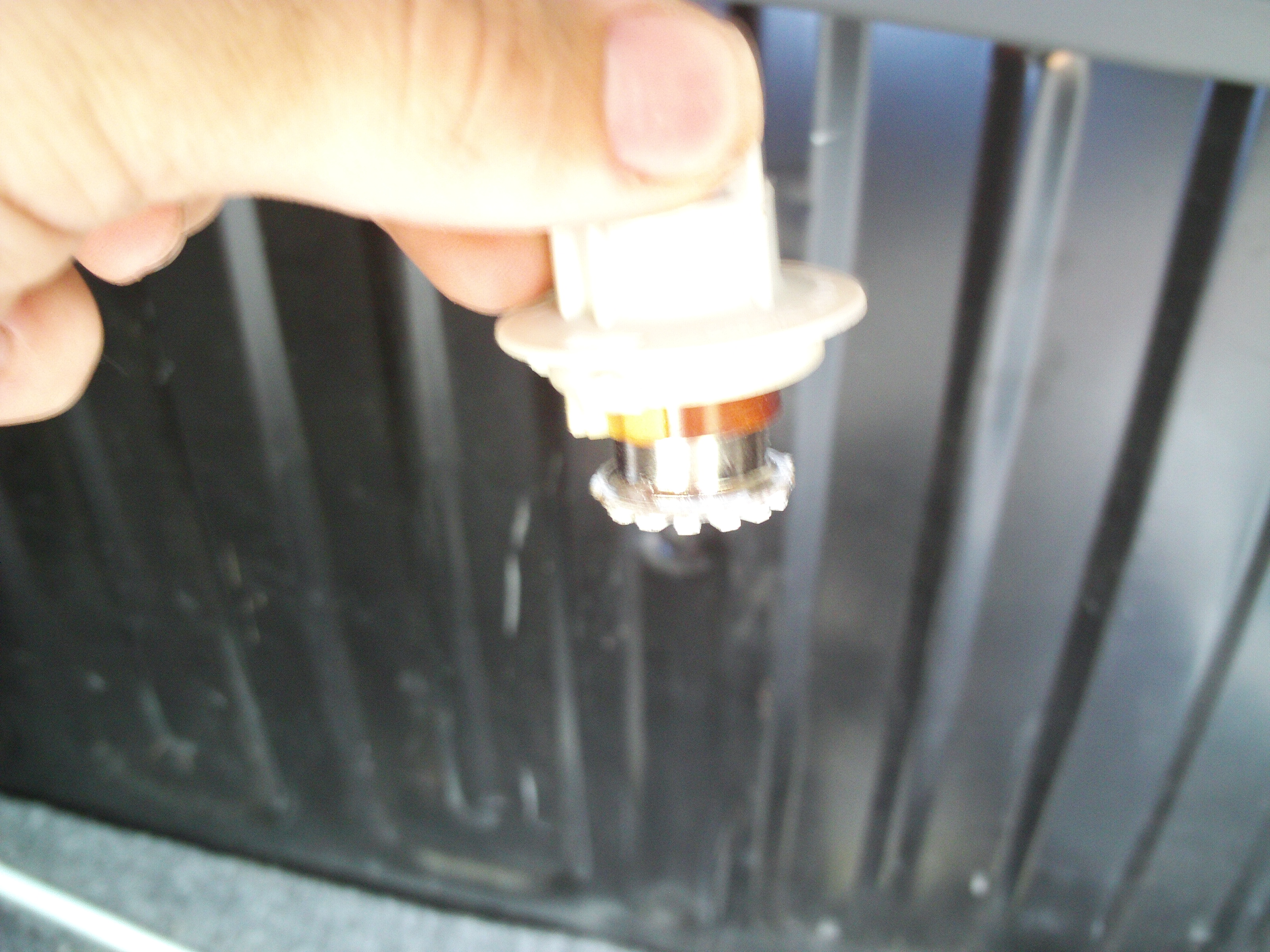

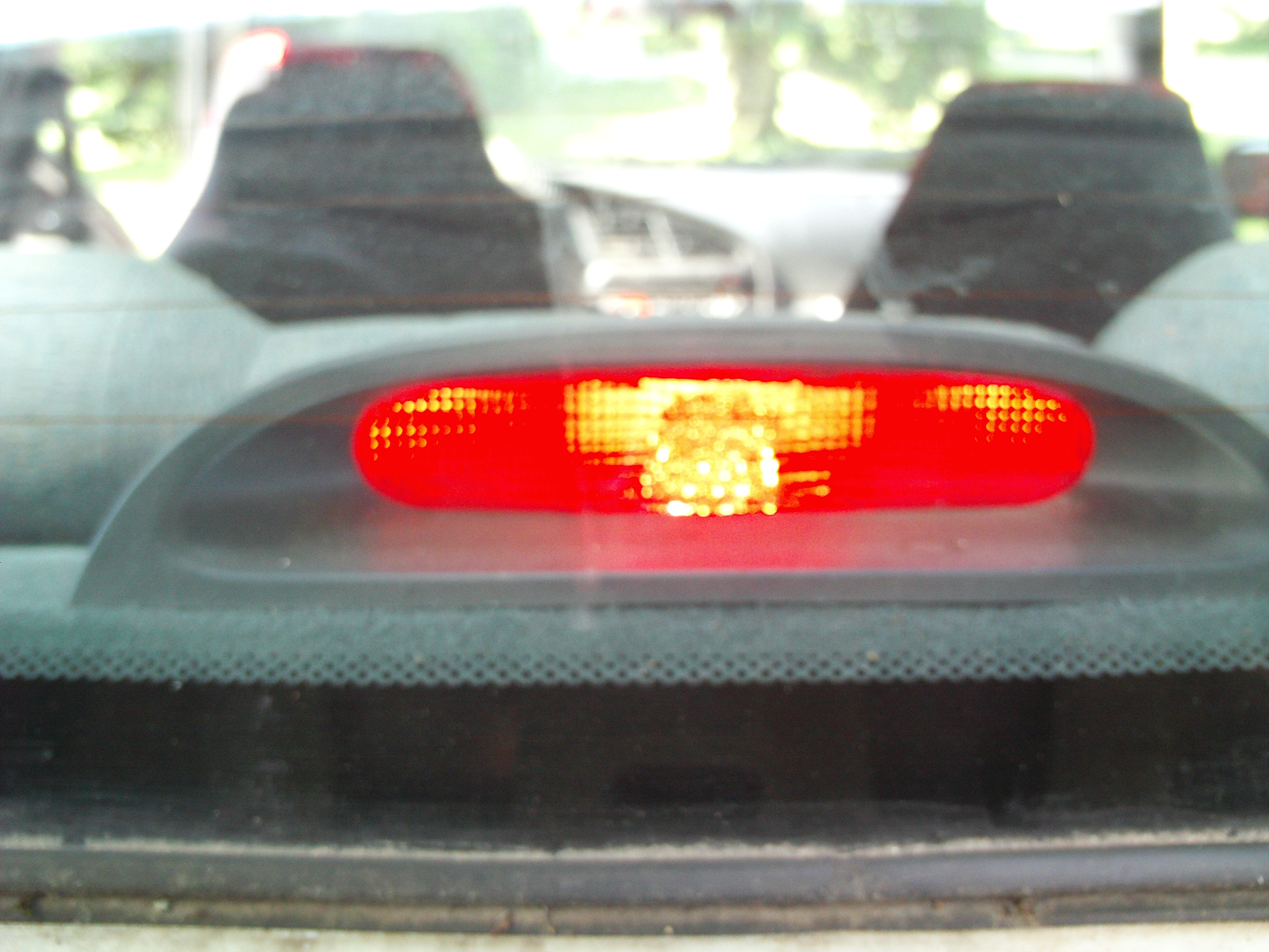

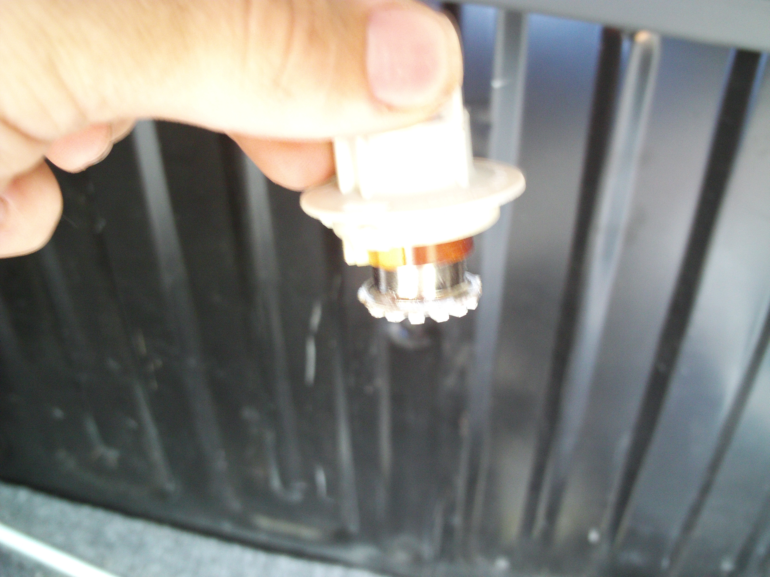

Here is a bit of modifying I did myself yesterday (and buttoned up today)

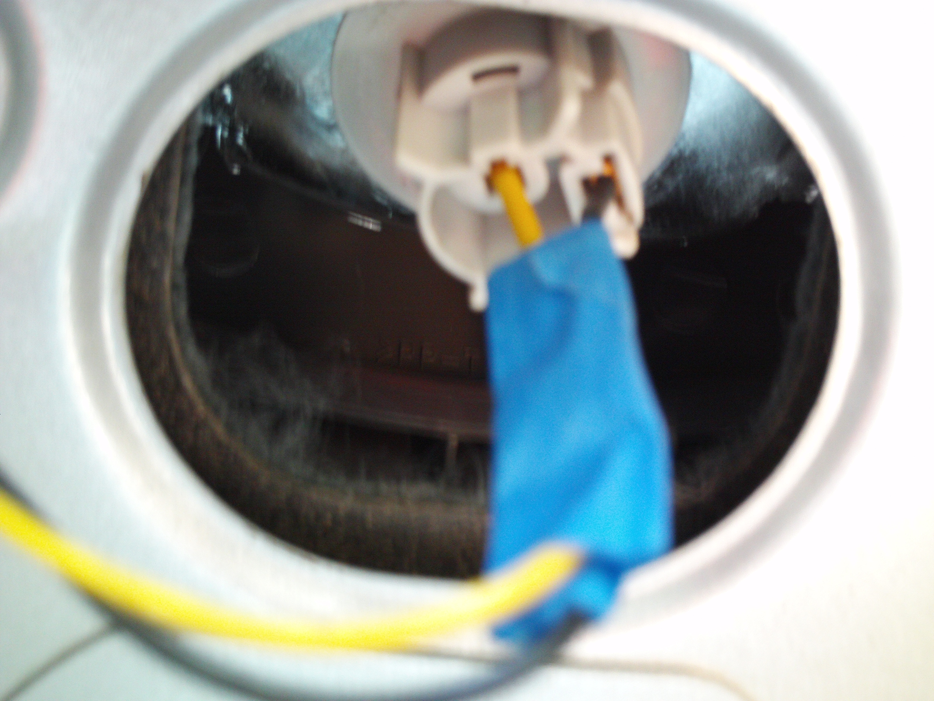

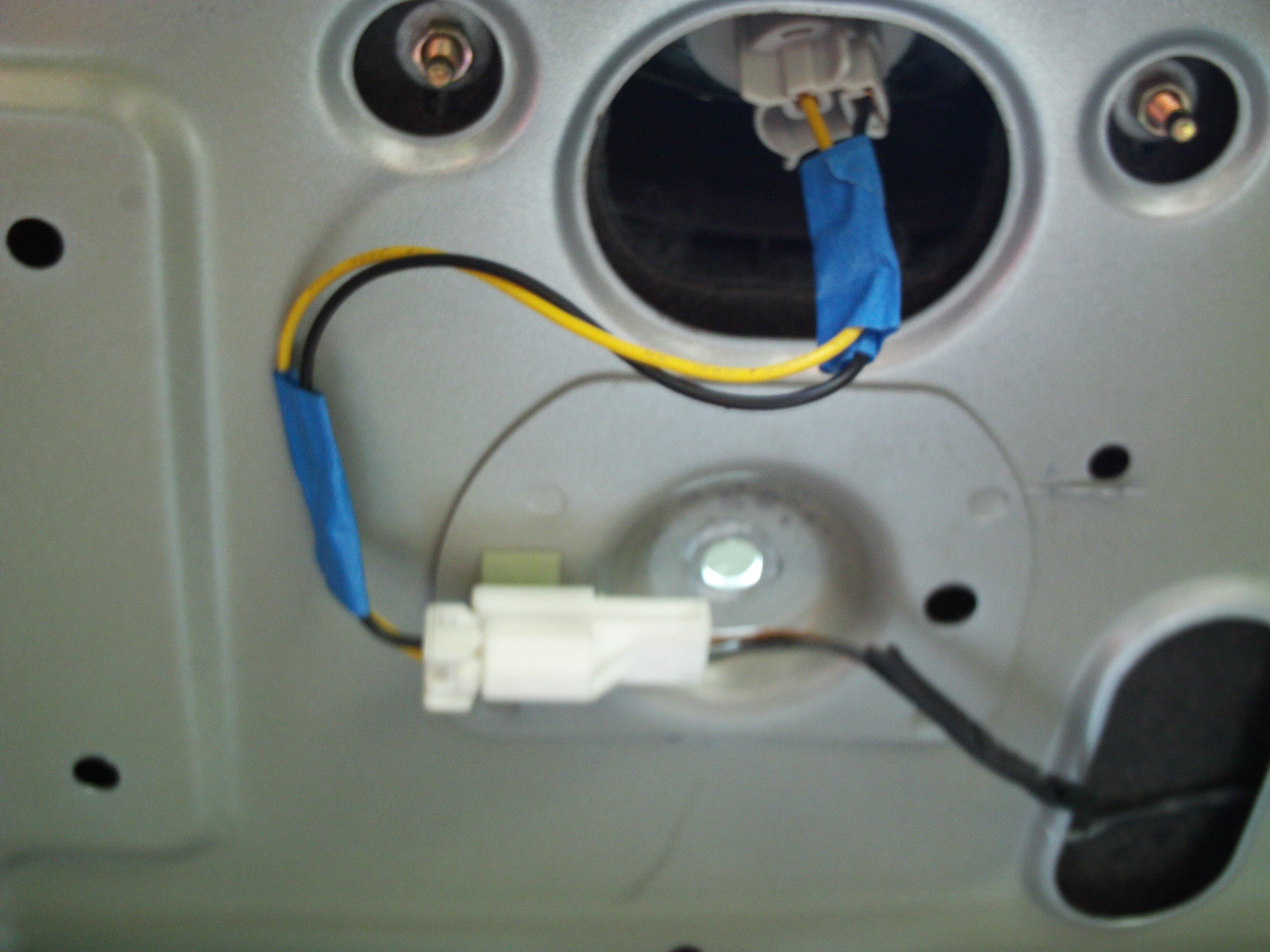

When I bought my 1st batch of LEDs (most likely have to be replaced for light output purposes), I could not get a LED working in the 3rd brake light. It worked everywhere else but. I discovered yesterday that the bulb socket for the 3rd brake light was OEM-installed backwards.
Here is the modification (pictured half-assed for testing purposes):
There is a 2 pin connector (visable from bottom) this entire bulb socket assembly was wired - to + and vice versa. I simplely chopped it in two dead center between bulb socket and the connector. As you can see i just switched the wires (The way it was SUPPOSE to be installed) from factory.
Results:
SUCCESS! Now the 3rd Brake light will work on any 1156 LED Bulb! Saves me the expense of buying a aftermarket LED 3rd brake light assembly.

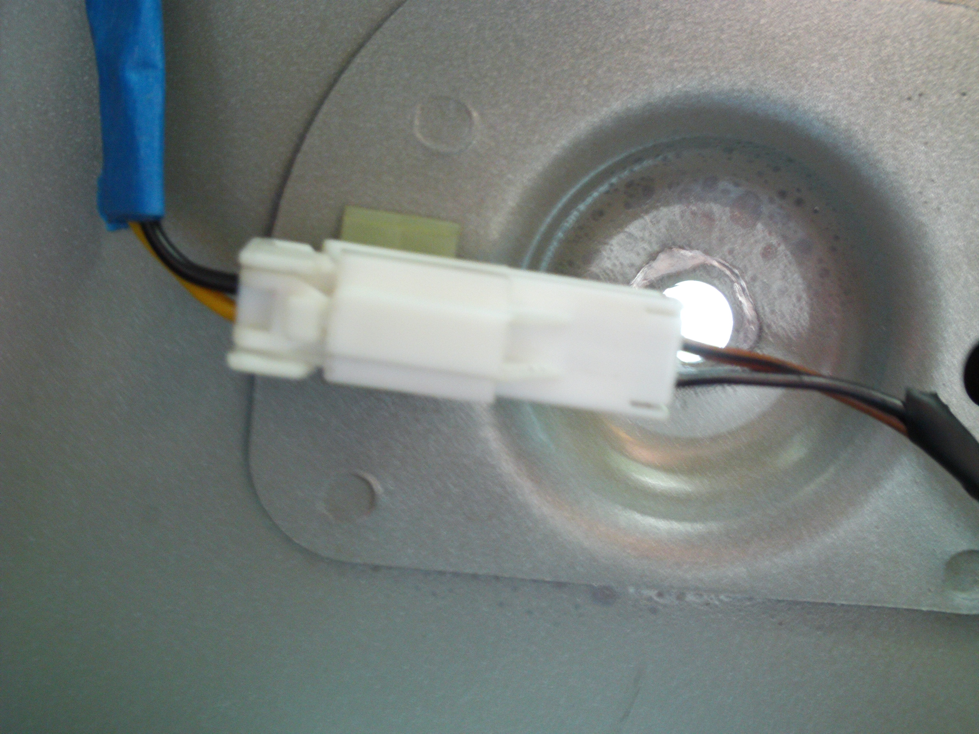

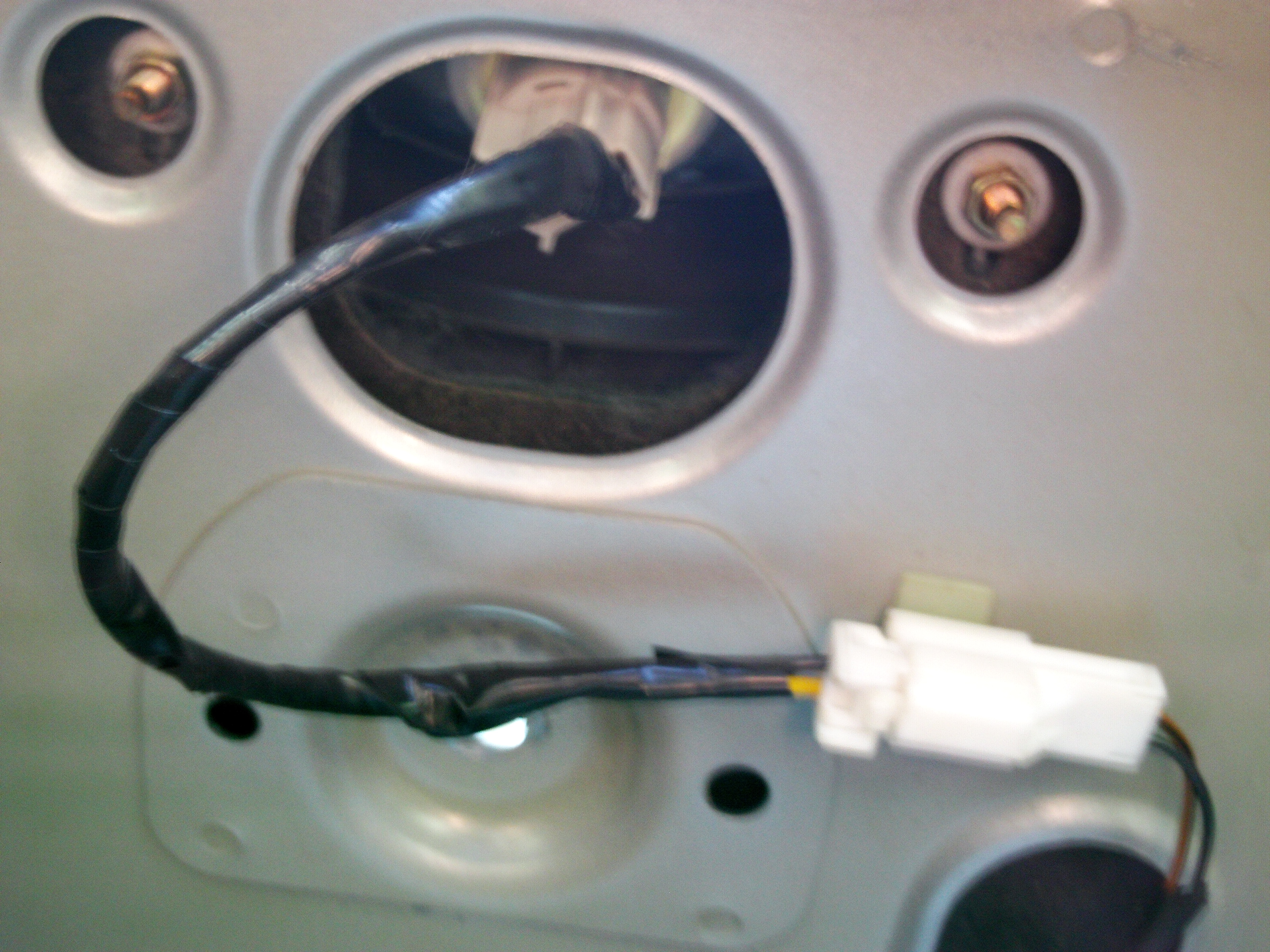

Most connectors allow you to remove pins, unless yours doesn't you could have just pulled the pins and swapped them.
Didn't look nor was I going to try. I've never been able to do that and would of ended up having to remove the connectors and spice right into the car's harness.

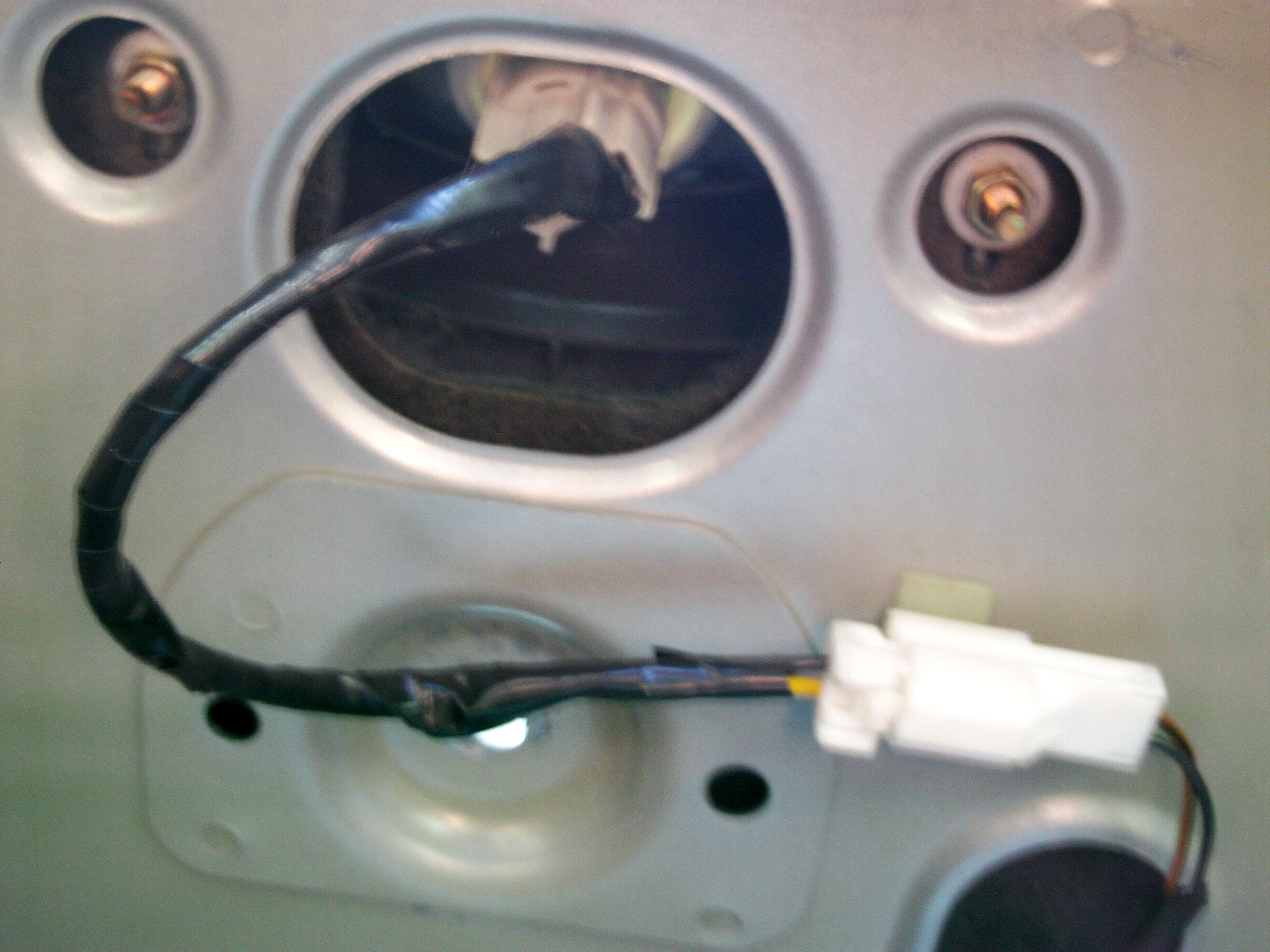

Added extra wire from an old PSU so I could have the connector fastened back up.

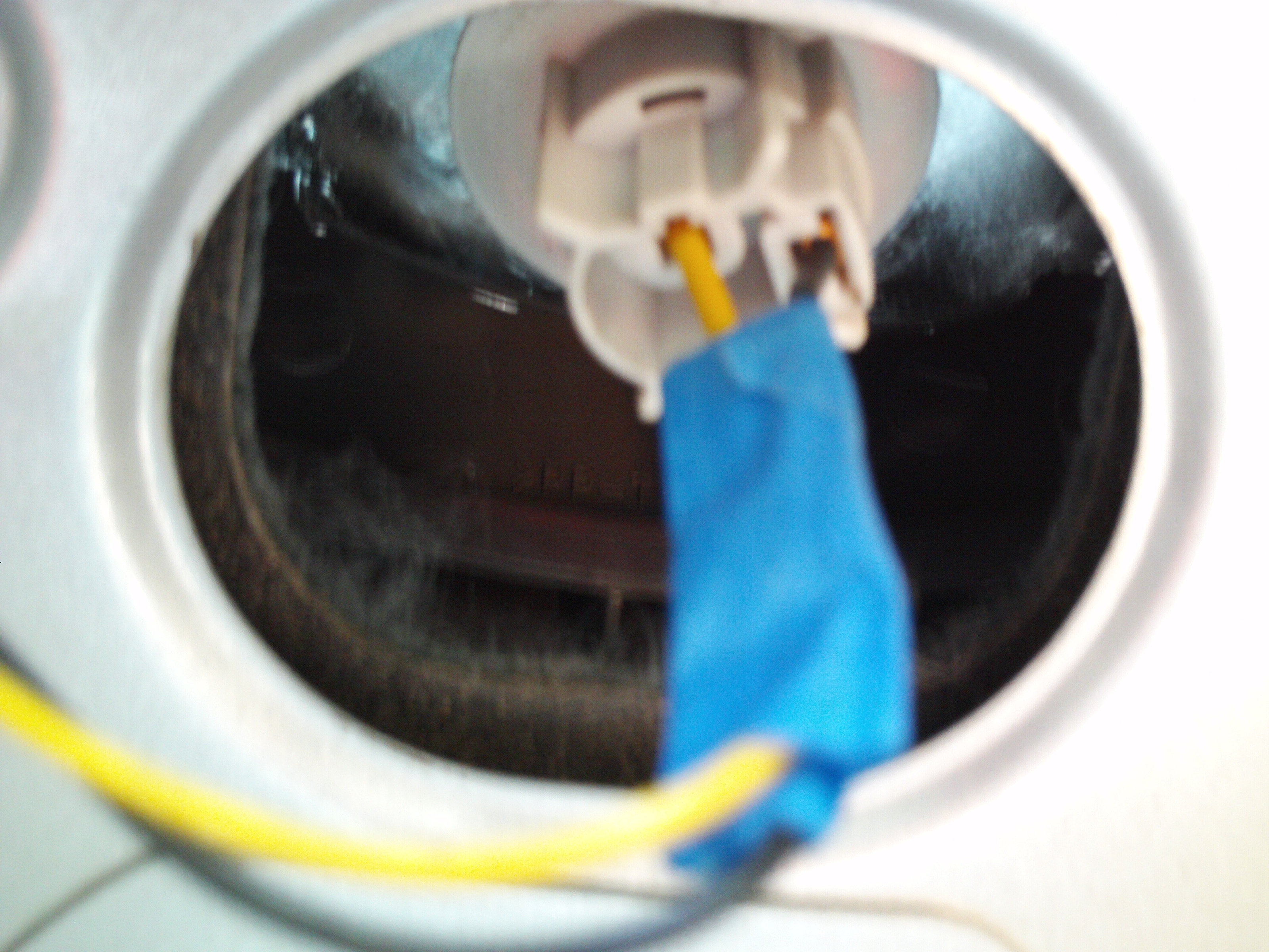

Closeup so you can see that the polarity was in fact, reversed from factory.
Socket reinstalled. The angle of this light make twist-locking the socket a PITA.
Closeups of the LED.
Added extra wire from an old PSU so I could have the connector fastened back up. View attachment 570504
Closeup so you can see that the polarity was in fact, reversed from factory. View attachment 570514

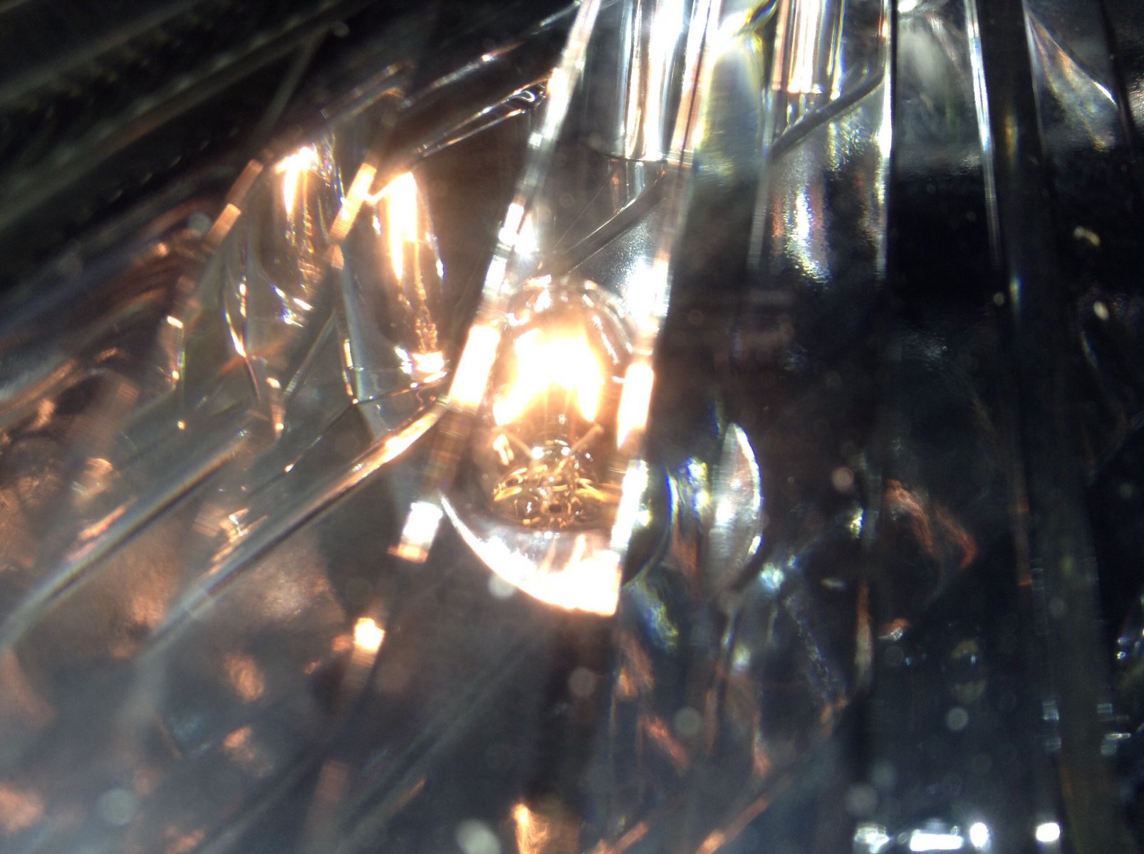

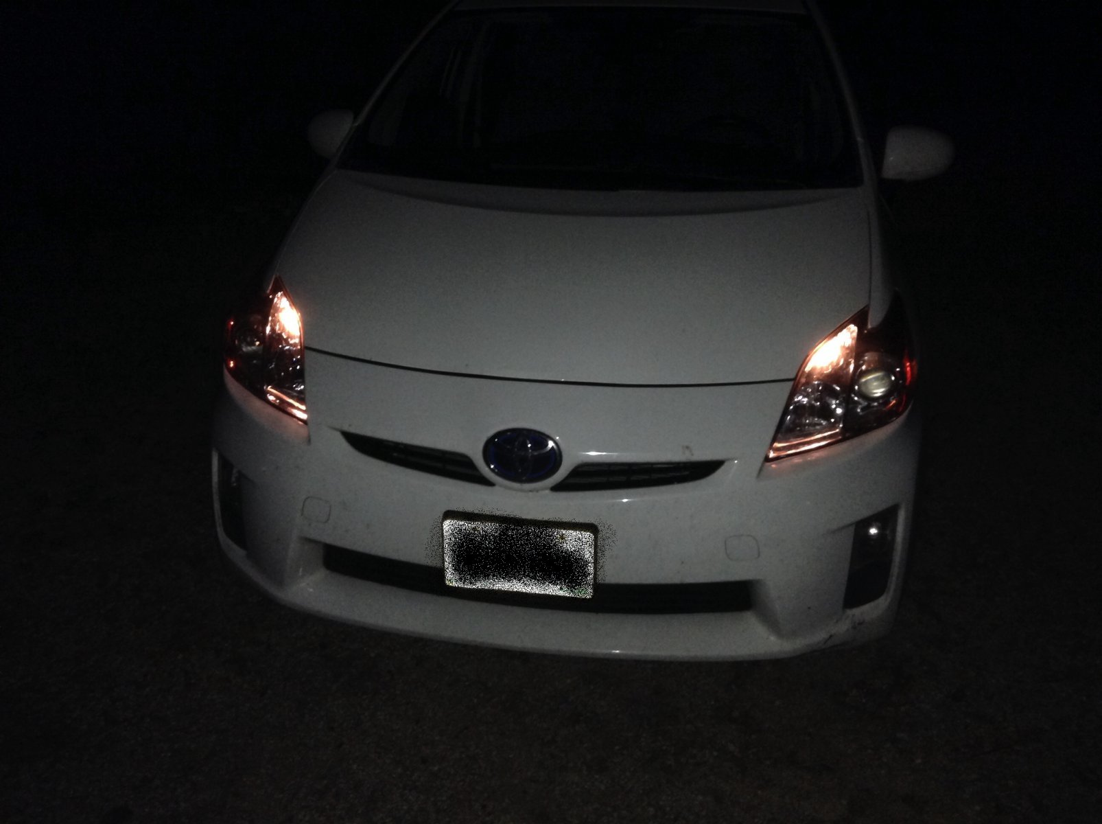

Here's a mod I did to our car.
New light bulbs.
194 aka W3W bulbs for 12.5¢ each from RadioShack liquidation sale.
Those seem awful dim bulbs. Is that a Prius? I thought Prius' had factory LED lighting.
No they don't. LED headlights is an option you can buy but the basic has halogen headlights. I don't know if the LED headlight version also has LED lighting elsewhere. I guess they don't.
The only place the basic models have LEDs are for the red brake/tail lights and the HMSL.
They are dim because they are W3W (194) instead of W5W (168). The stock ones (which all burnt out) were W5W. W5W is a 5w 12v bulb and it outputs 50 lumens. W3W is a 3w 14v bulb and outputs 25 lumens.
RadioShack only had W3W bulbs, and because they were liquidating, that's what I got and put in. 25¢ per pack; 12.5¢ each.

Why would you intentionally put in a headlight bulb with an output lower than spec-and especially one with half the specified output?
Headlights exist both so that you can see the road and so that other drivers can see you-don't screw around with them.

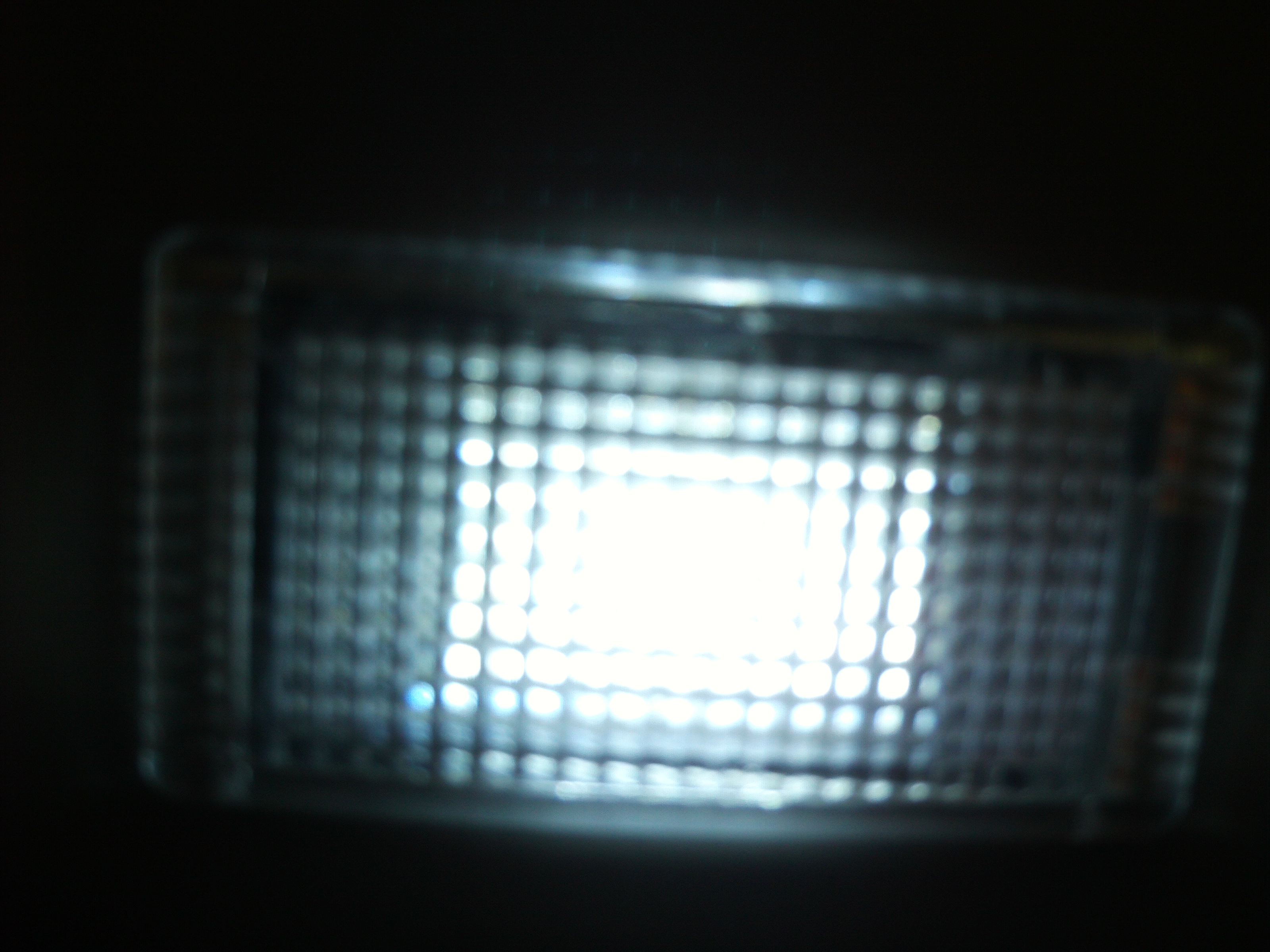

Not sure if you can call this a mod but..... Interior LED Upgrade:
Dome Light - LED is much brighter than it appears.
LED Installed into Trunk.
I have not tested these at night yet to see HOW much they actually light up.
