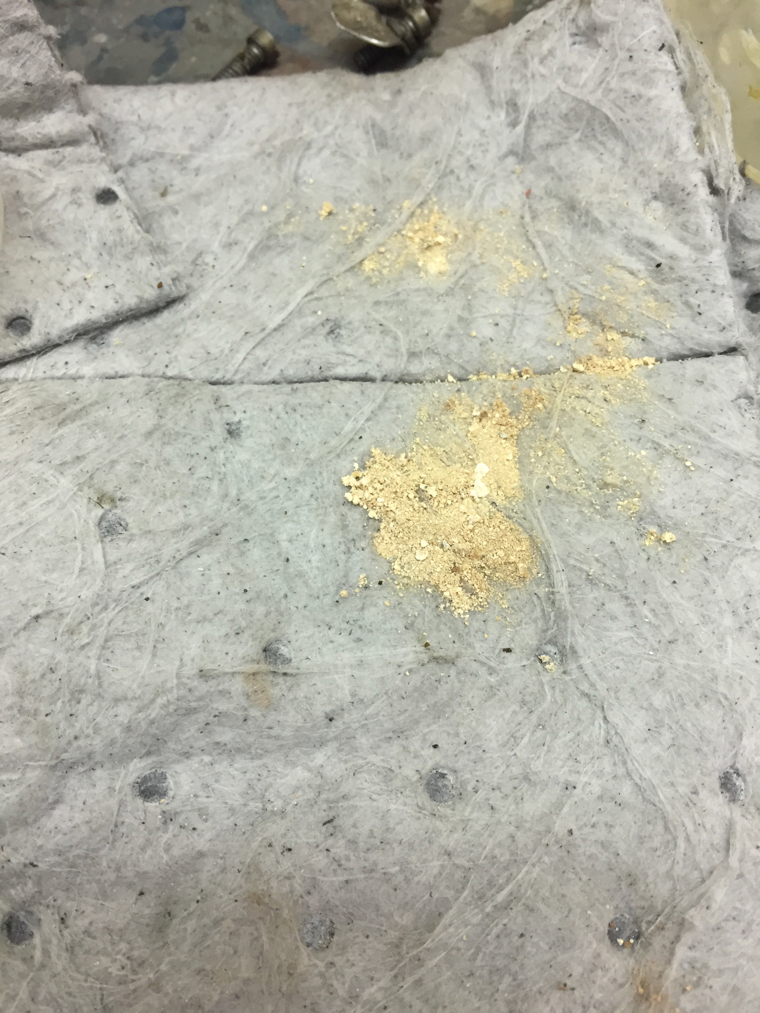

Pro-Tip: When cleaning or degreasing equipment and or tools, be hyper vigilant of what you're doing and double check if you can mix certain chemicals together because you might not be able to if the ingredients of one interact with the other chemical's.
I had a slow moment yesterday and mixed two things I shouldn't have. I didn't notice the color change as it was just a soak in the cleaner. I did notice fine bubbles and a noxious odor. Then realized what I did wrong. I began flushing the container out with running water.

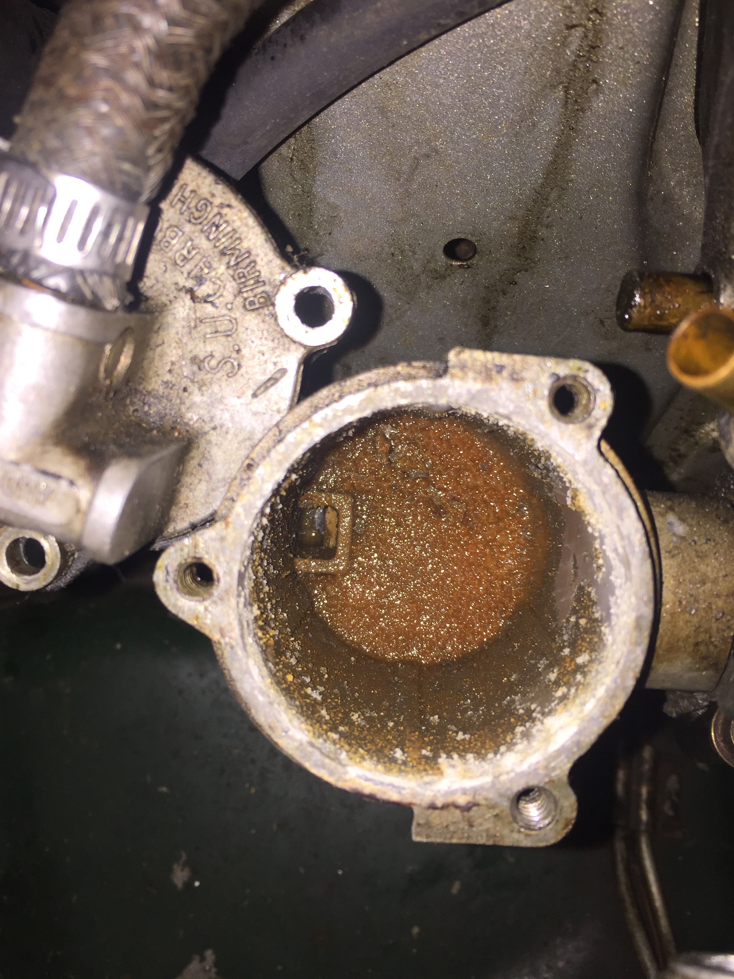

Bad gas seems to never go away...
This is what the crud in the bottom of the float bowl looked like after I shoveled it all out
Finally, though, I have a car that actually runs well(again).
Unfortunately, now the choke mechanism is STUCK. These carbs are badly in need of a rebuild, but the top rebuilder is running 3 months or better behind. A new jet assembly would fix the choke issues, but these also have bad throttle shaft wear. The rebuilders ream out the body of the carb and then fit a bushing, and I'm not set up to correctly get everything aligned for that. Fortunately, I can also get rid of the stupid poppet valves in the throttle disks, which were a 1970s emissions control measure that ultimately just caused backfires on deceleration and obstructed the intake.
The next few weeks are prime driving weather, and also when it's getting chilly enough that having a working choke actually makes a difference(I don't like having to use ether to start the car). So, to that end, a friend sold me another set of carbs that are at least in serviceable condition. The ones he's selling me he says are off of a '68 MGB, so I'll need to swap metering needles, rig up a PCV system(my '70 uses NCV), and figure out where to get ported vacuum for the vac advance can. Still, though, they'll keep me going while I wait on my originals.
Speaking of which, between E10 and my not-quite-stock engine the stock metering needles are probably not optimum. I need to spend some time figuring out an appropriate one, but I think SU catalogs a couple thousand different part numbers so it's hard to guess where to even begin.
