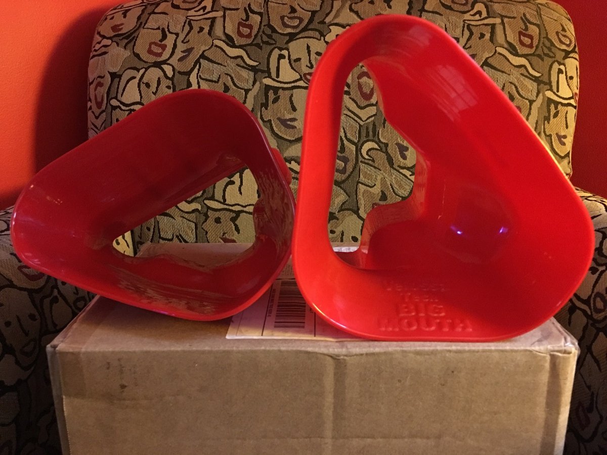

Got my intakes, very cool! Nicely made.
So to explain a little further, the air path for my car kind of looks like this:
Air -> Grill -> Empty space -> airbox snorkle (then filter -> air tube)
So the airbox get some air directed from the front grill, but that air hits turbulence in that empty area, additionally, there's a lot of heat moving around in front of the radiator/condensor.
So that this does, is to connect the inlet on the grill, directly, sealed, to the airbox snorkle - more direct airflow, less heat:
Air -> Grill -> Velossa -> airbox snorkle
The passenger side is really just for aesthetic balance, I mean, I do sometimes kind of dig on an asymmetric design element, but in this case, I wanted the sides to match, plus mine are RED, so that extra color I think will look +outstanding+
It's a pretty time consuming project, have to remove the front fascia to install, and while I have the front removed, I'm pulling out the OEM grill and completely gutting out all the honeycomb, I plan on leaving the little side triangles completely open, but will probably put some kind of screen/mesh in the center rectangle.
