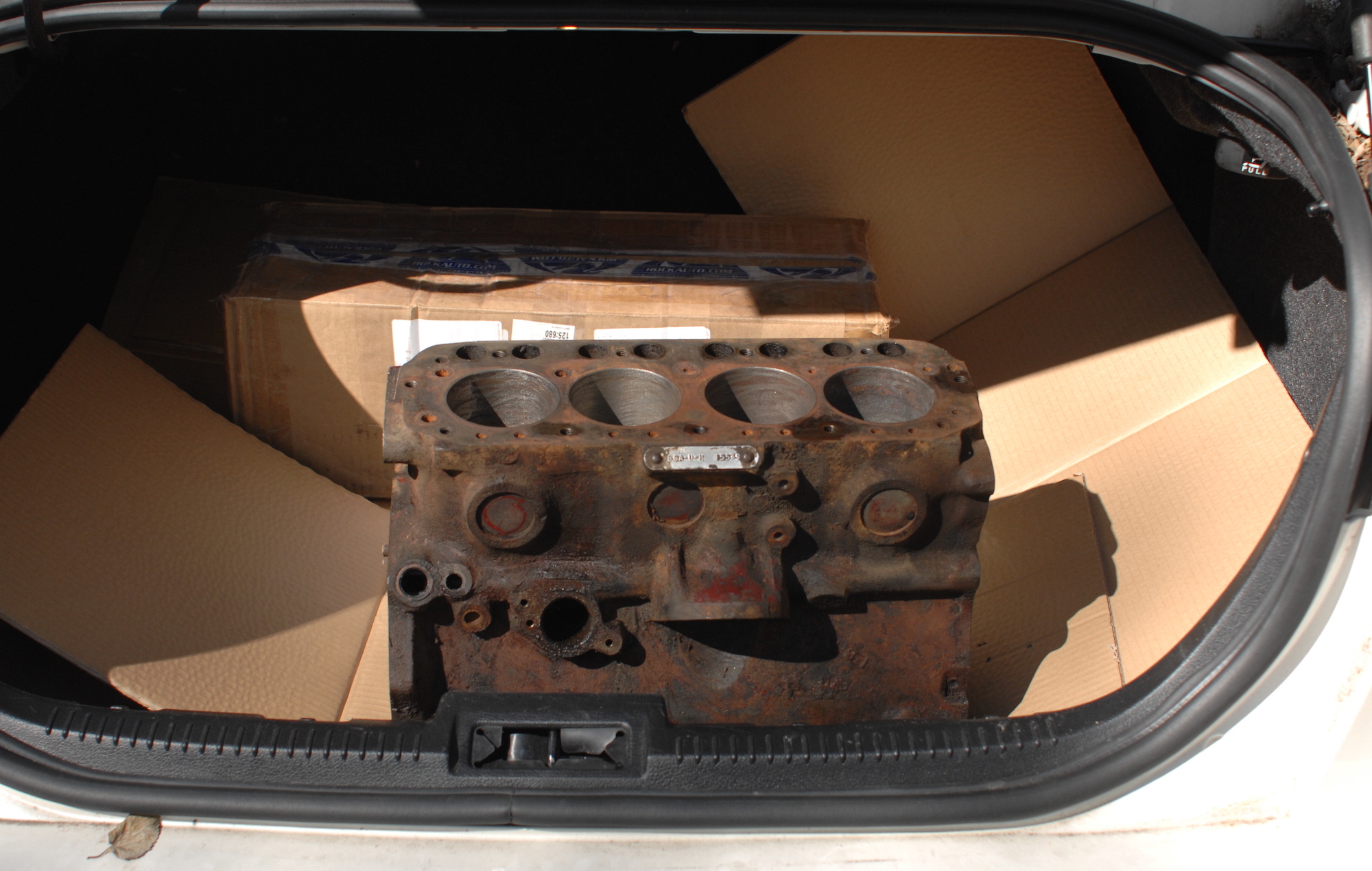

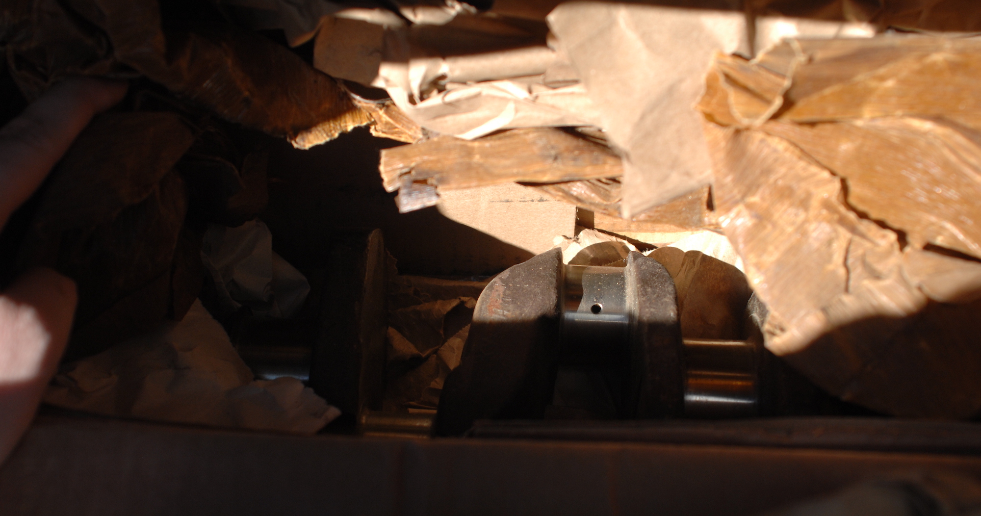

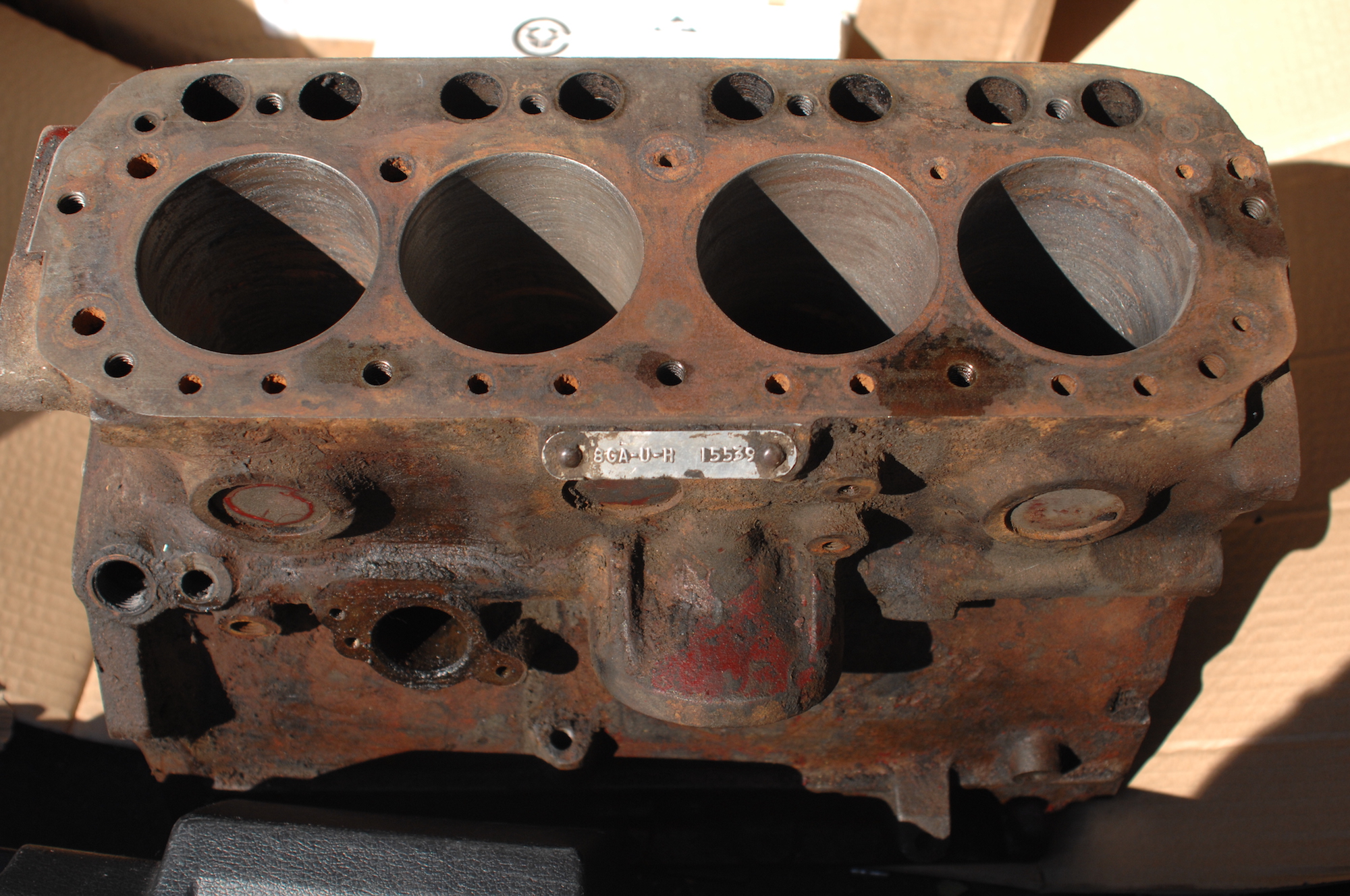

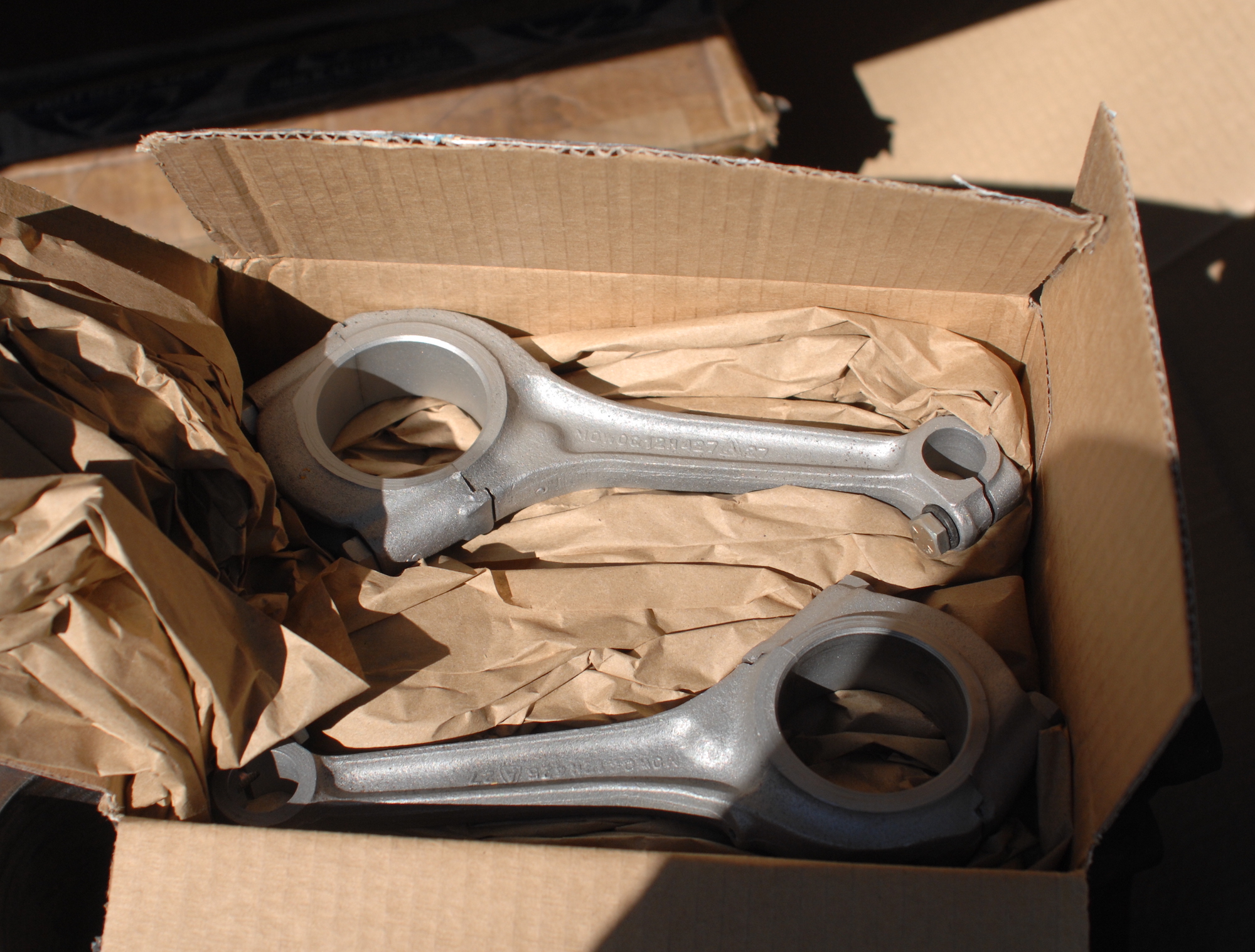

My MGA is still(mostly) a pile of parts, but I made a significant step forward on it today-I bought the "bones" of what will be the engine in it.
The car comes with a block and head, but no crank, rods, or pistons. Fortunately, there are various other parts included, including some other necessary parts(more on that in a minute).
A 1958 MGA came with a 1500cc engine that, in stock form, outputs a bit over 50 HP. With the stock short rear end that I think 4.23:1 or so, it will scoot the ~1800lb car along well enough, although the rear end comes at a cost of top end speed(I'm too lazy to do the math, but the red line is 6K rpms, of course 4th is 1:1, and the OEM tire size is 165HR15, which works out to roughly an 82 series tire-do the math if you want to know).
After some internal wrangling about how "correct" I want the car to be, I finally decided to put an MGB engine(1800cc) in it. I didn't want just ANY MGB engine, though. There were a lot of differences between various MGB engines, mostly related to emissions, but probably the most significant one came somewhere around 1964 with a change from 3 main bearings to 5 main bearings. As far as I know, all the smaller displacement B series engines had 3 main bearings, but it was decided that this "big" 1800 engine(which is getting close to the limits for the block) was better served by 5 main bearings. The early 3 main engines are prized for being more "free revving" presumably due to the lower friction offered.
In any case, I'd discussed this a bit on the MG forum, and a few months back I got a private message from an engine builder out in Colorado. He said he had a couple of 3 main engines, named a good price for one of them, and to top it all off said that he could deliver it to Kentucky if I didn't mind waiting until October.
He piddled around a bit and rather than a complete engine, he offered a good 18GA block(a bit more desirable than the first series 18G due to better metallurgy) and associated bits and pieces.
Today was the day, and we met up in Lexington for me to get the engine from him.
The nice 18GA block as promised(he told me he usually leaves them greasy and grungy for storage to prevent rust-he offered to hot tank it for me, but I declined for the same reason).
Connecting rods original to the block
This is a poor photo, but this was the real prize-a new old stock, never used, factory replacement crankshaft
The block will get wear bored(probably .040 over) and line bored, then of course will get new pistons(stock high compression) and all the various parts needed to make a complete lower block out of. The MGA engine will donate its rear plate and flywheel(needed to make the engine mate to the MGA transmission) along with the front plate, dynamo, of course all the MGA intake and exhaust bits, and the H4 carburetors. BTW, yes I am keeping the dynamo and will most likely keep it positive earth. The engine will get fitted with a ported and polished '73-76 small chamber, big valve head(casting 12H2923, the same as I'm running on my MGB) which gives an approximate C/R of 9.5:1(8.8:1 is stock with the large chamber head and shallow dish pistons). It will then get a mild street cam that's a bit more aggressive than a stock cam, but will still give power at 2K rpms and let the engine idle at well under 1K. This combination is good for something in the neighborhood of 110-120hp-again a nice boost over 53hp from a 1500cc engine and ~90hp from a stock 1800 engine.
To add to all of that, the early block with a dynamo and H4 carbs is visually almost indistinguishable from a 1500 engine, so only someone who really knows MGAs will be able to spot the swap. Aside from the behavior of the 18G/GA/GB engines, this was a big reason why I wanted that particular engine.

The engine will be entirely my baby, though. I've done my fair share of mechanical work-both top and bottom end-on these engines, but I've never taken one apart to a bare block, much less put it together. Granted I WILL have to outsource the machining, but then I don't know of that many pro engine builders(much less a guy doing it in his garage) who do their own machine work. I can/have used a Dingleberry brush to hone/cross hatch bores before, but that's as deep as I've gone into at-home machining.
BTW, the block I just bought shows cross-hatching. I need to ask the guy I bought it from if he did that in the course of cleaning it up-if it's factory cross hatching this is definitely a low mileage block.
