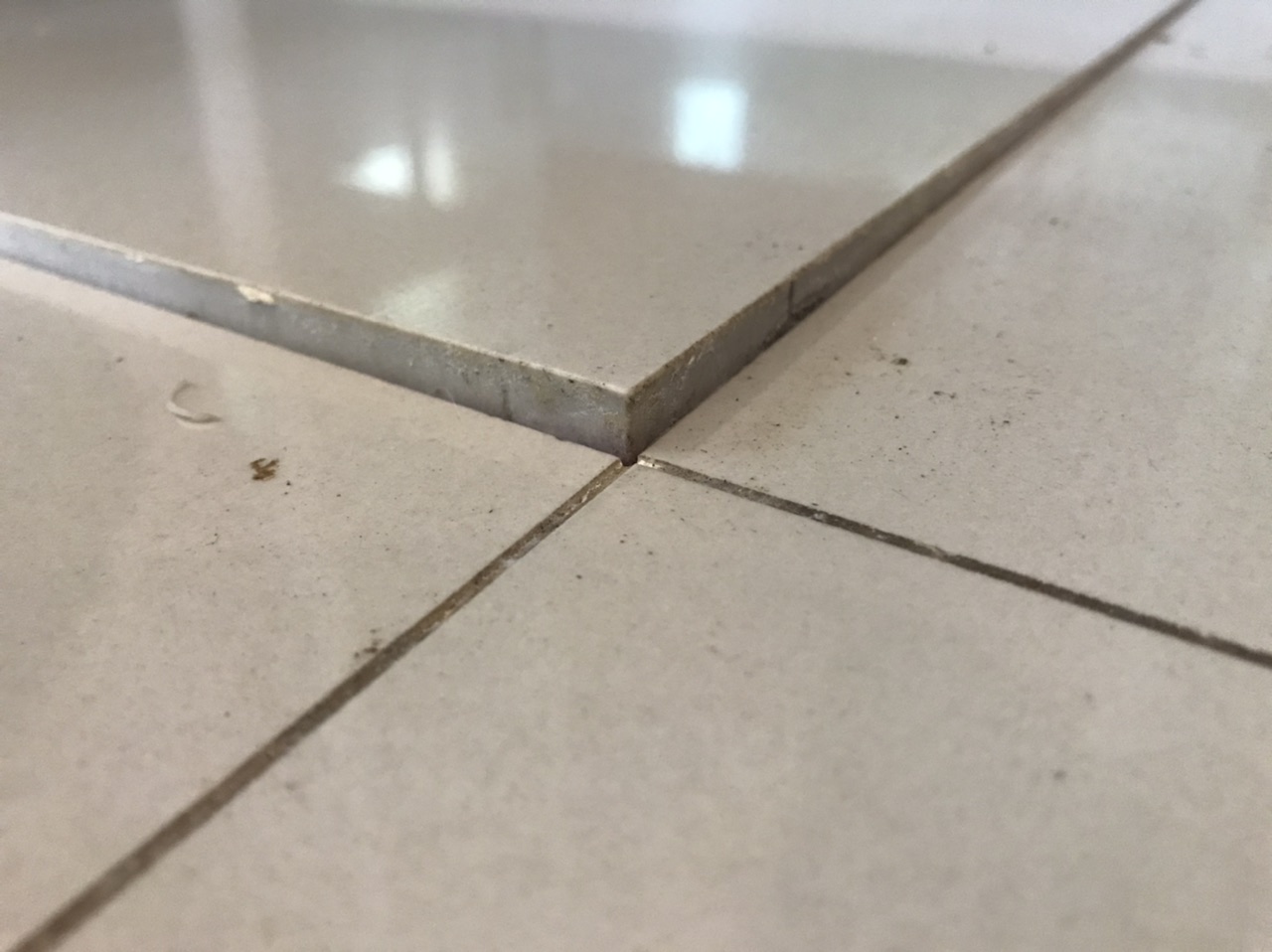

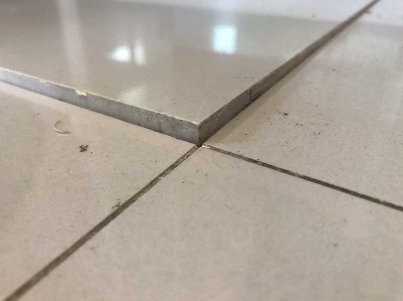

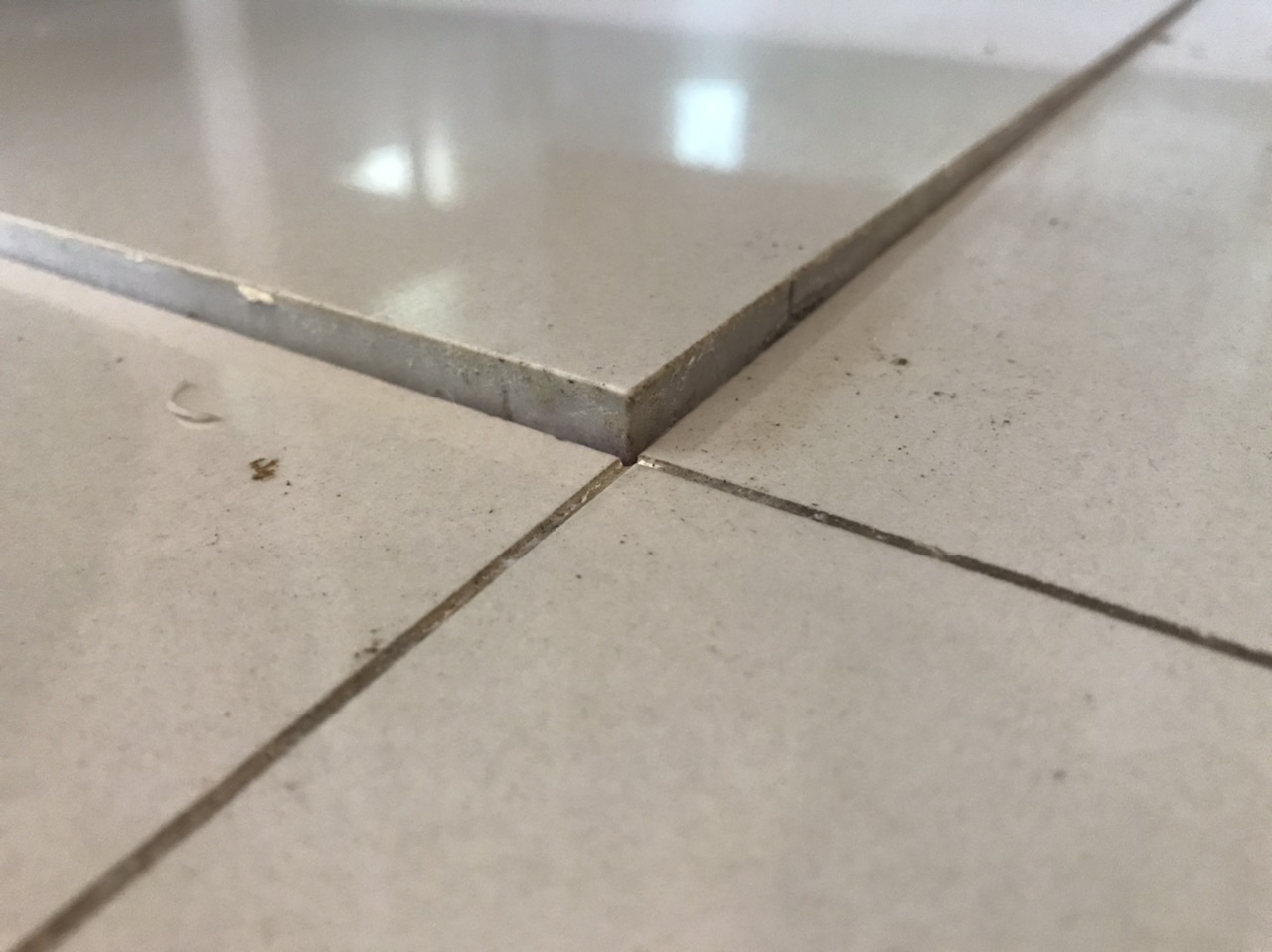

Wow I never knew this thread existed before.
I basically fell into DIYing when we couldn’t find reliable electricians (read: at least doesn’t turn up and ask what the third wire is for).
Anyway - there’s a loose tile that has one edge under a sliding glass door.
I’ve got a leftover bag of tile adhesive powder from a job some builders did here a while ago (I -so far- draw the line at laying bricks or anything but basic concreting). My plan is to try to lift the tile out (it moves vertically about the thickness of the tile itself on the side away from the door), ensure there’s nothing crazy in the concrete floor below it, and then attempt to re-lay it using the tile adhesive.
Am I missing any thing? Is there a simpler method to fix this? Any gotchas about trying to re-lay a tile?

Just remove it carefully. Thoroughly remove all the old mortar and grout. You'll need a chisel and grout saw. Basically you don't want any bumps making laying difficult or dust making adhesion difficult.
Lay the tile with pressure and a slight twisting motion. Remove any excess adhesive from the surface. Let it set. Saw out adhesive from the grout line until it's a bit below the surface. Apply new grout. Clean the surface again. Seal the grout.
Besides breaking the tile. The other risk is popping up more tiles when removing the old mortar. So work slowly with the chisel and saw down the old grout.
I prefer a tile mortar you mix to a prepared adhesive.
The new grout won't match the old perfectly.
Based on the amount it moves, and previous history with the tiling in this house (an entire wall of tiles in the kitchen had to be re-done by the builders after they just started peeling), I'm somewhat expecting it's not held in place by anything besides the weight of the door on one end (the picture above is what it looks like "normally". Applying pressure will push it back down level with the others with almost no effort). However I'll keep this in mind, thanks.
grout saw
Thanks, didn't even know that was a thing.
Right - it is a powder, but it says in English (no idea what the Thai says) "tile adhesive", and it looks pretty much exactly like Portland cement to my eye, so it sounds like it is just tile mortar and the translation isn't quite right.
Thanks for the detailed steps/tips, much appreciated. I've still got a new shed to wire and a bunch of external lights to reconnect, but once I've picked up that grout saw I'll give it a go and report back!

Sounds good to me. You’ll have to gouge out the old adhesive which can be a pain depending on the tools you have. A wide chisel and a hammer will work, but a rotary hammer with a chisel bit would make quick work if it, avoid digging holes in the concrete. 😉
Use care removing the one piece if there are no spares, and not damaging adjoining tiles. You can measure how high the tiles sit above the concrete to gage how much adhesive and use a 1/4-1/2” notch trowel to spread the adhesive on the concrete, but it’s also recommended to back butter the tile itself with a thin coat of adhesive, to get a good bond. The concern is applying too much or not enough.
The notched trowel application gives you the abilty to adjust the height of the tile so it matches the other tiles. If there is too much and you press down you may fill the space between the tile with adhesive as it squirts out from under the tile. You’d want to scoop out enough in the space between the tiles, so you can apply grout in the space. And do you have matching grout? 🙂
Now I am guessing, but does the old grout line still exist between the loose tile and the tiles surrounding it? I suppose if it is difficult to find a matching grout and that grout line still exists, you might be able to get away with just slipping the loose tile back in after adhesive is applied, but that would not be preferred because it might get messy or you might notice a gap between the tile and the existing grout, and if adhesive squirts out, you’ll end up smearing it on the existing grout which maybe noticeable.
I figured I'd use the cold chisel for that, but I'll have to see how much there is first I guess.
Right.. gotta goldilocks it.
I seriously doubt that. I believe there is some leftover grout in a bag next to the aforementioned tile adhesive/mortar, but quite honestly so long as it's not bright pink (pretty sure it's white) I doubt I'm going to care. With the quality of the original builders workmanship on this place, I would bet you a months salary you'd have given up pointing out small inconsistencies and defects before you noticed the colour of the grout, even if I had you stand on the tile in question.
Thanks for the tips though!
