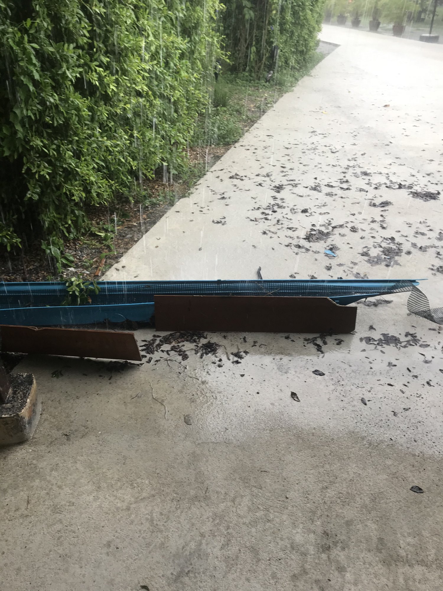

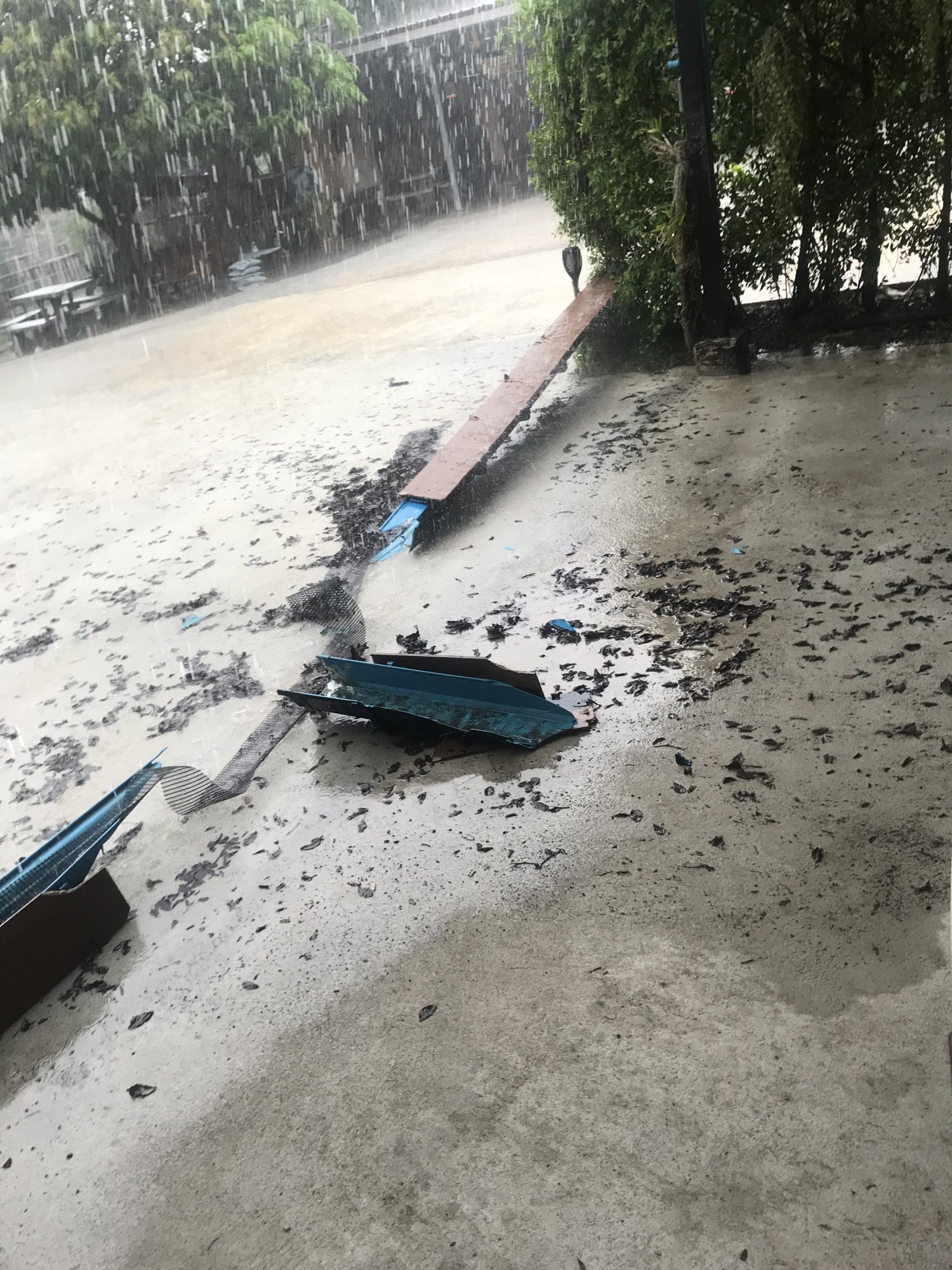

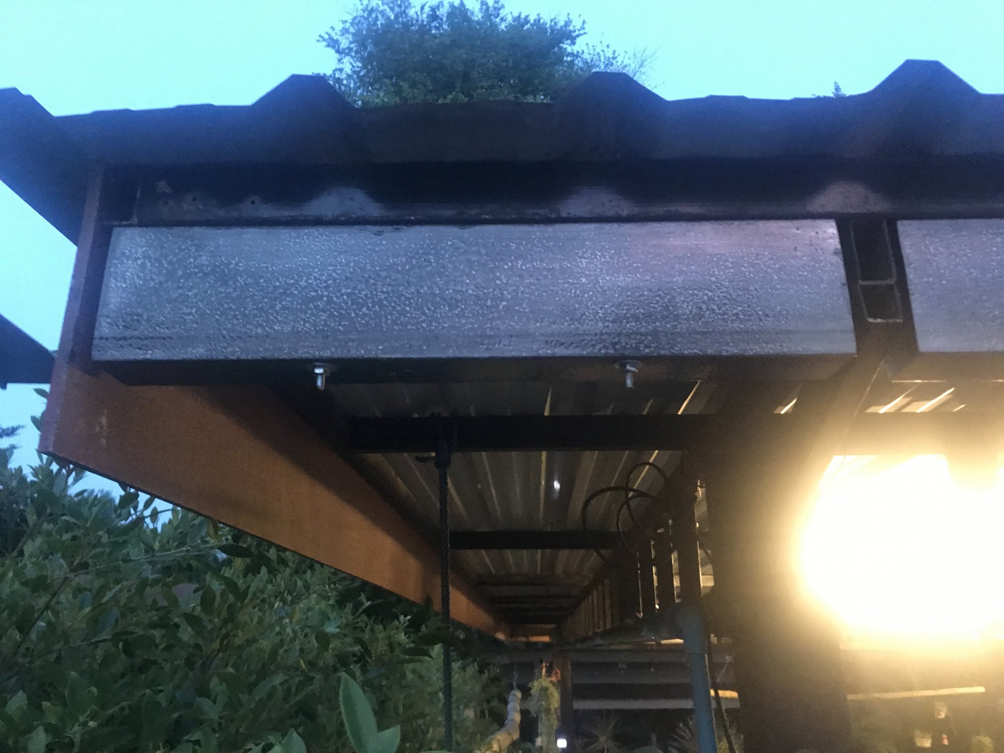

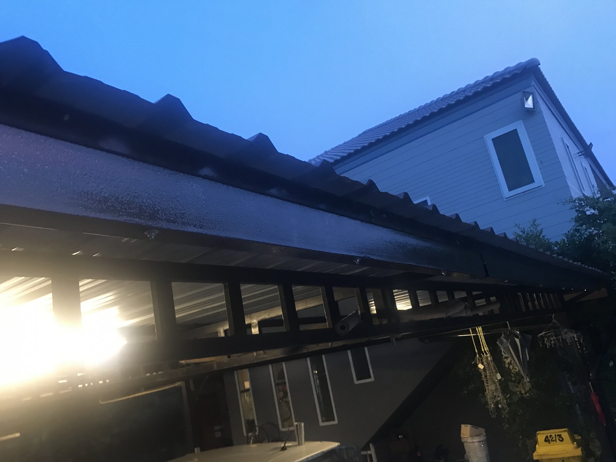

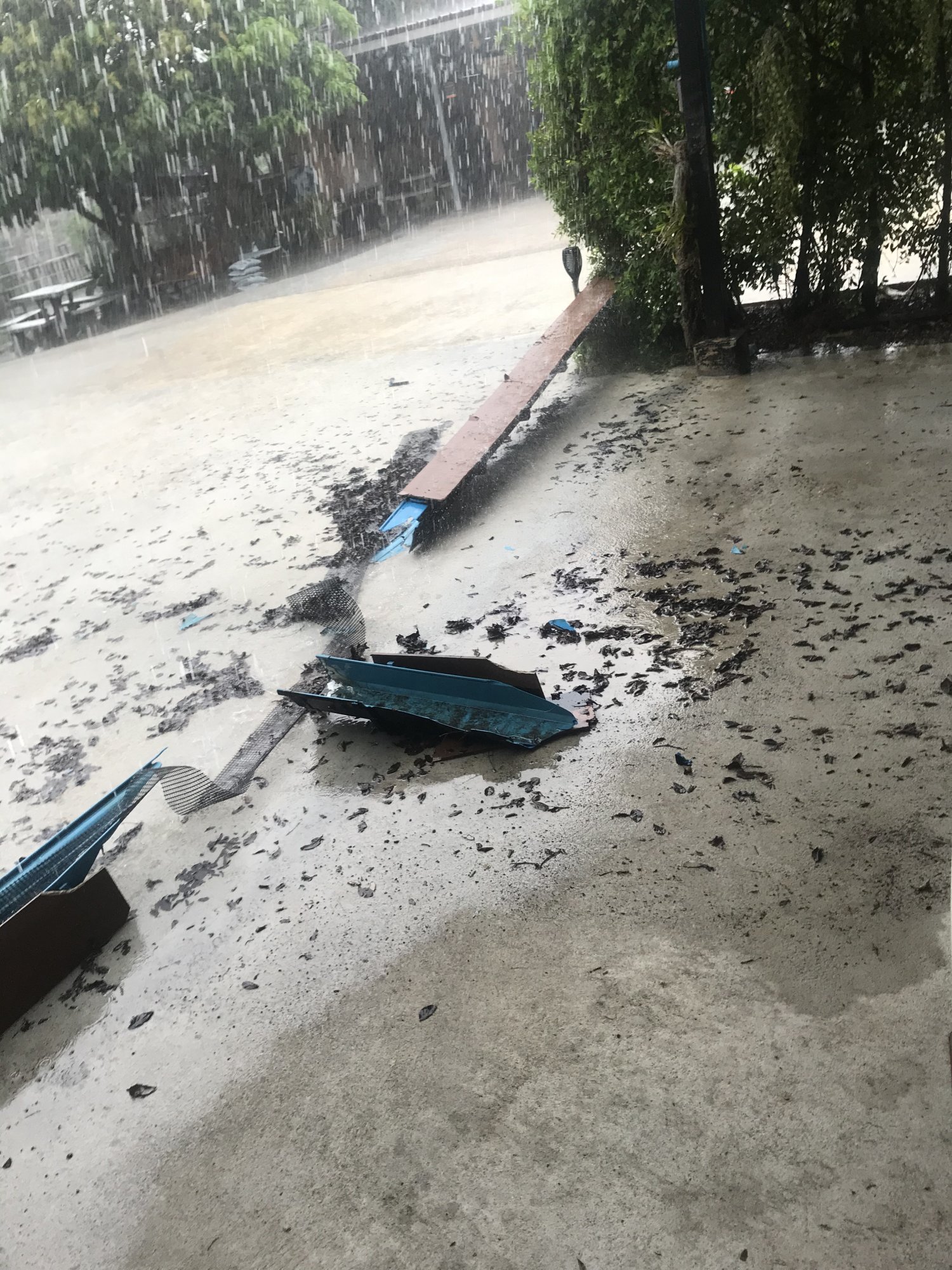

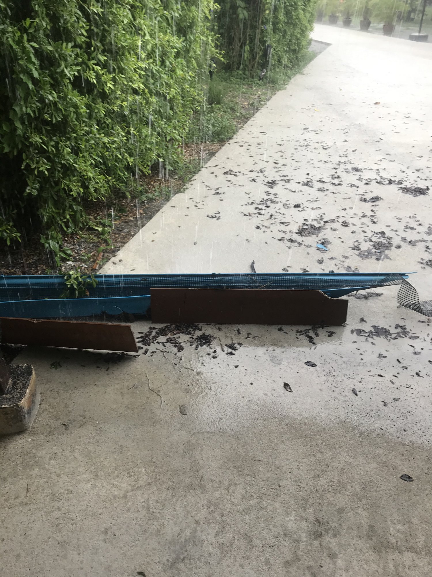

Nice job.It's one week later. Coincidentally I was woken up at ~6am for about 3 hours of rain probably as hard as what brought down the original gutter.
This afternoon I (mostly) finished putting up the replacement.

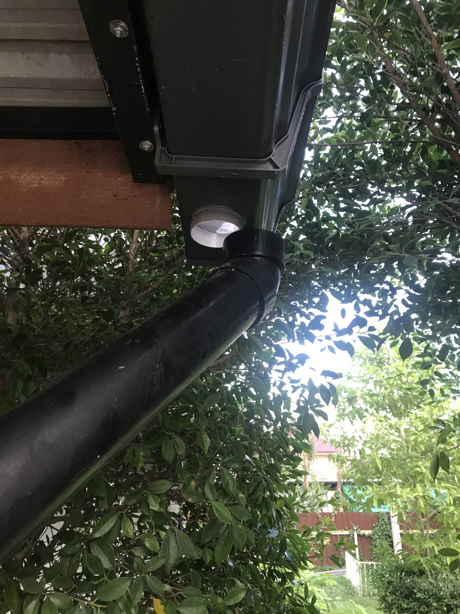

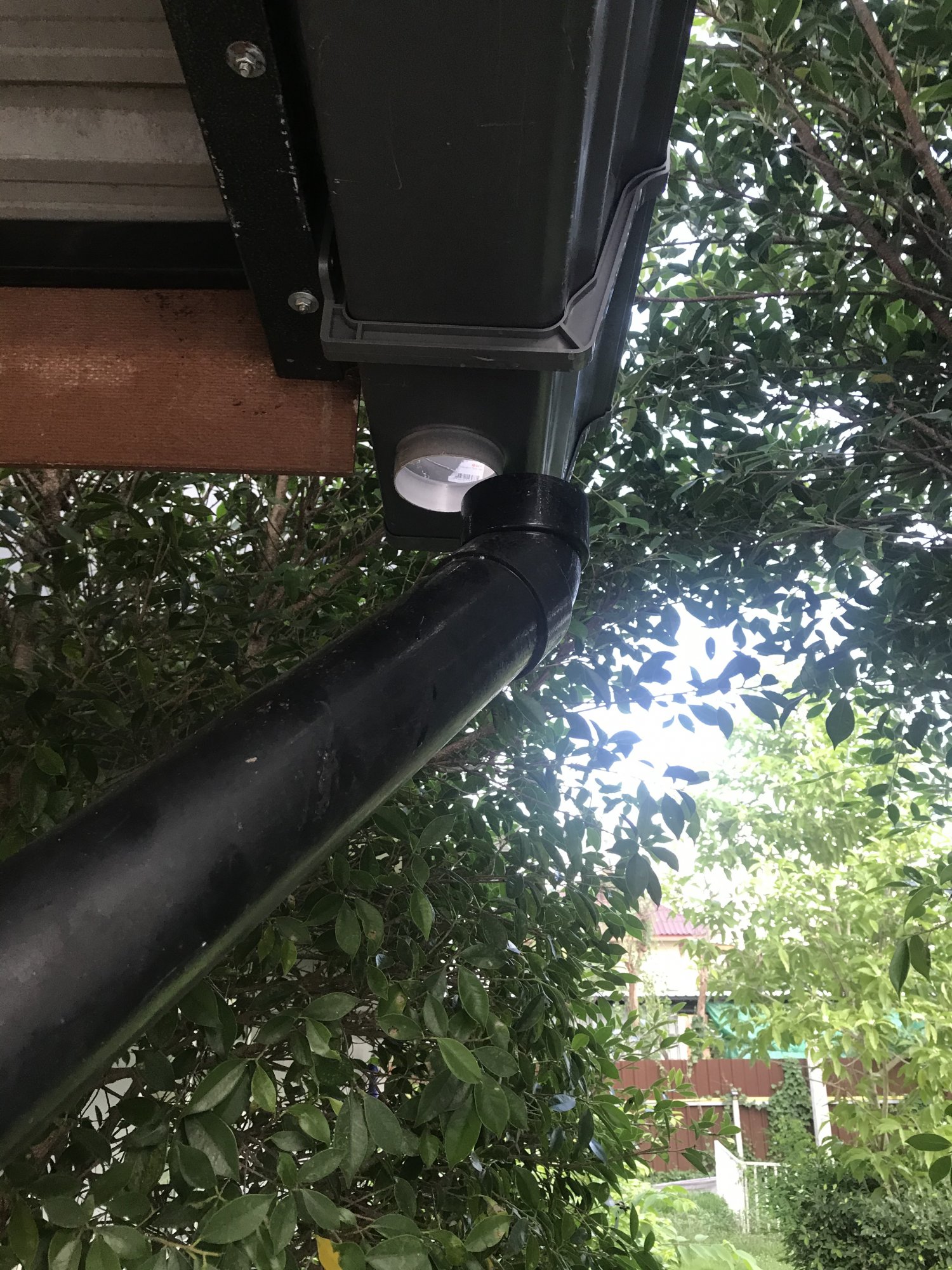

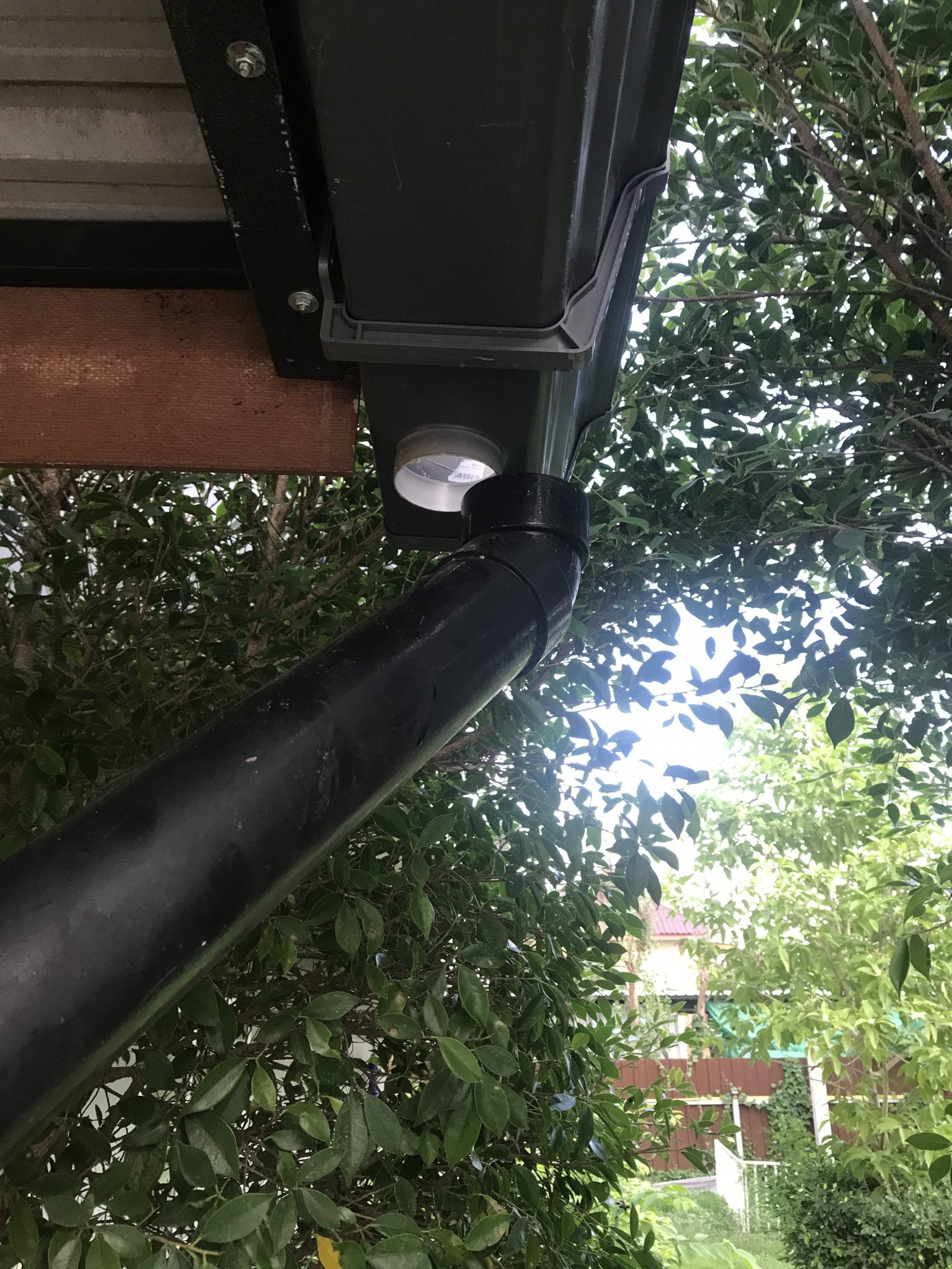

I say "mostly", because despite the new and old gutter being exactly the same size/shape, the downspout is way out of alignment.
Due to the old one being attached to the fascia boards, that were simply screwed to the metal frame at the top, and have the structural capabilities of cardboard, the entire gutter at least at the end with the downspout, was twisted out, away from the structure (i.e. so the normally-vertical fascia board was pushed out at the bottom), and thus the ~3" pipe has about 1" of overlap with the corresponding hole in the gutter above it.

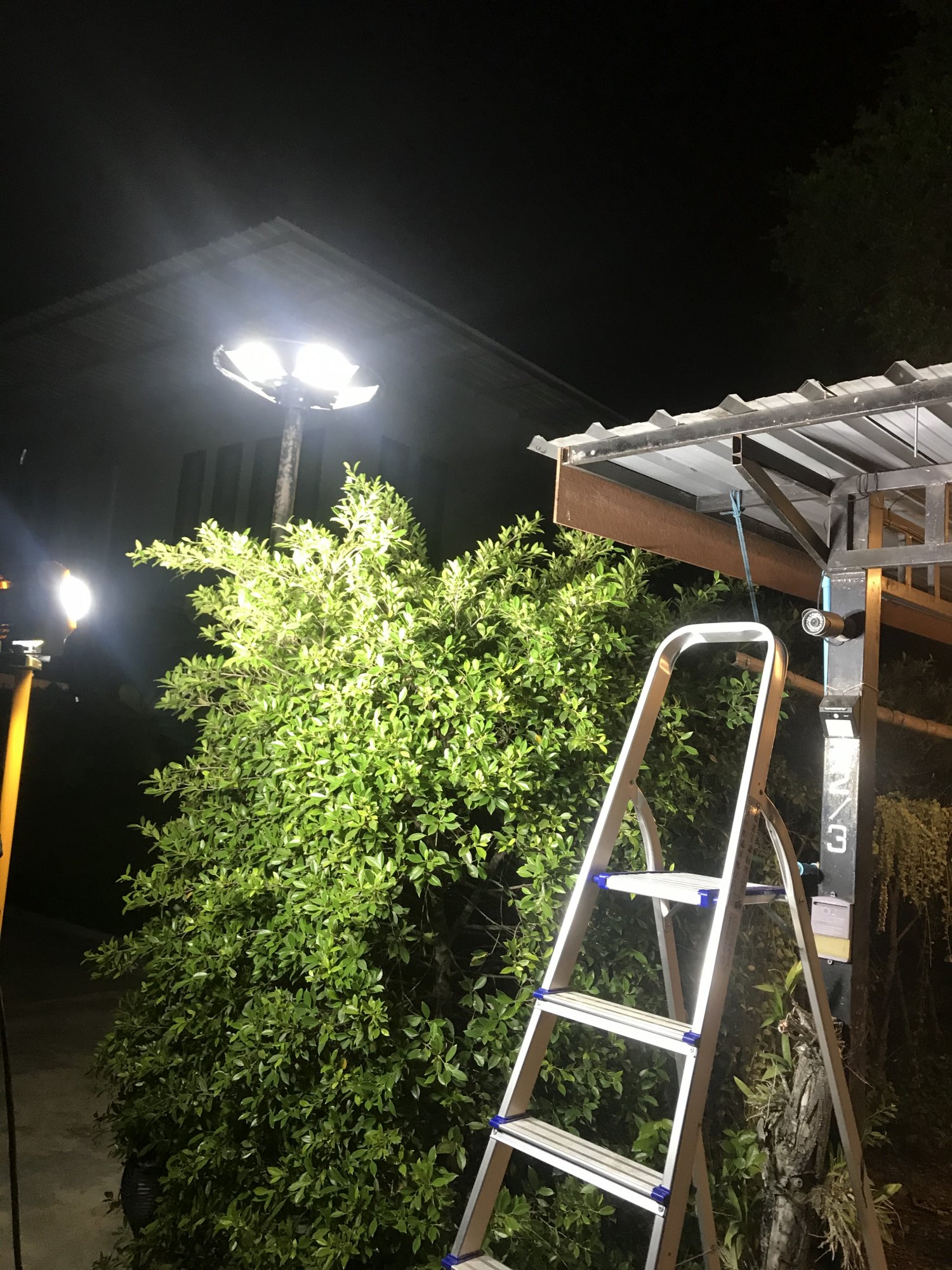

Anyway. So as promised:

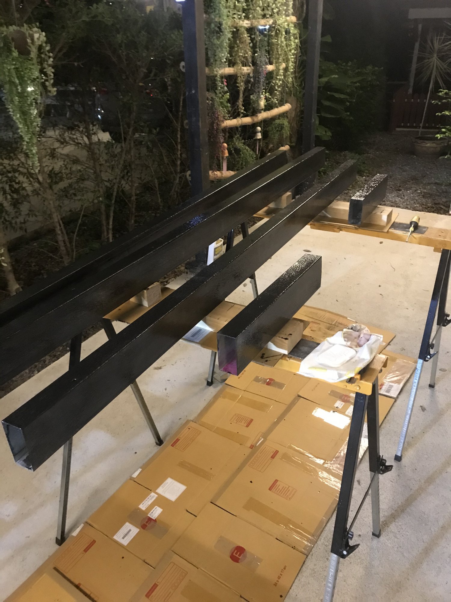

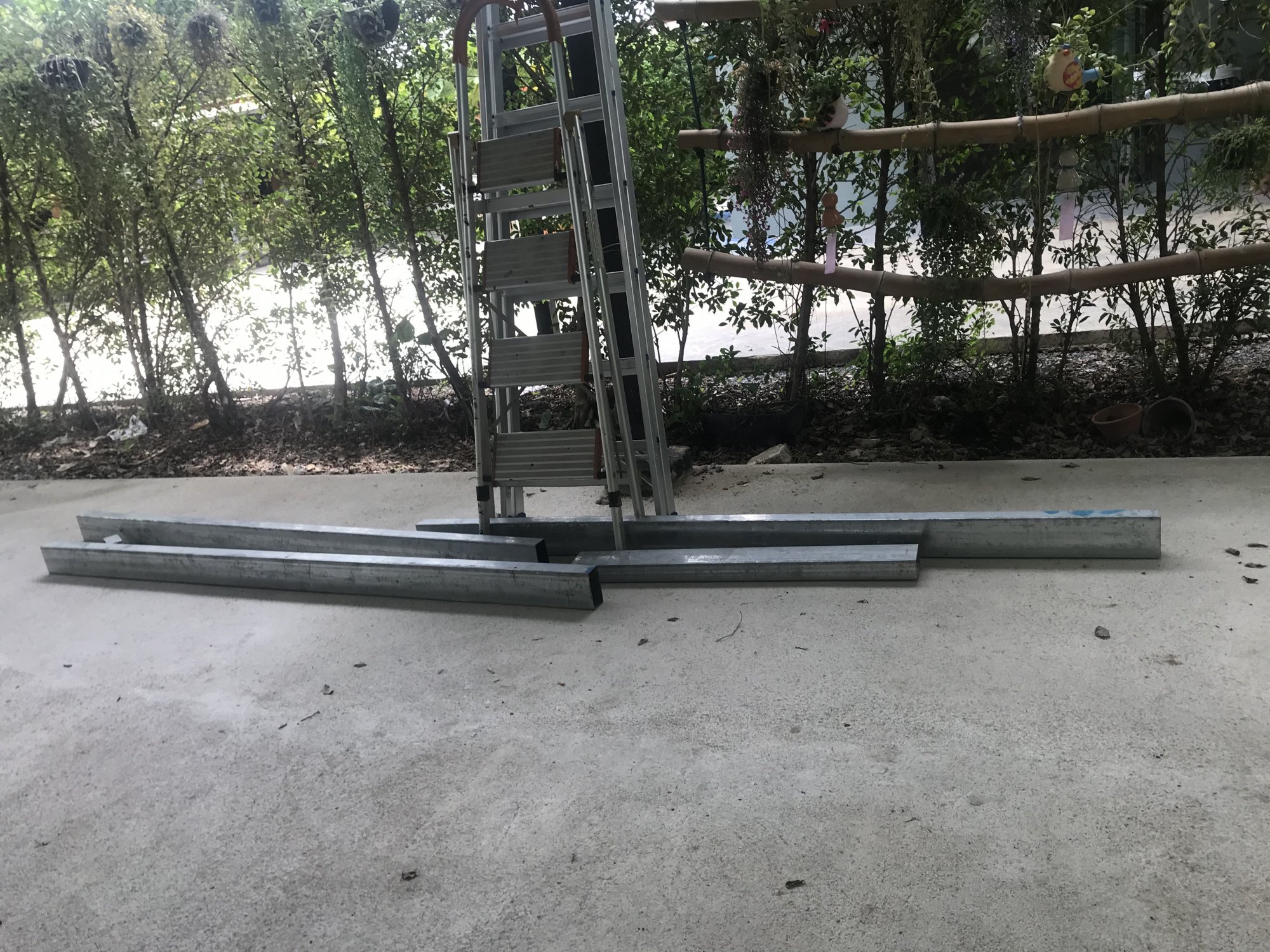

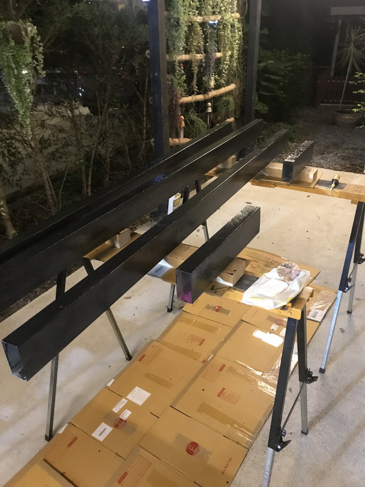

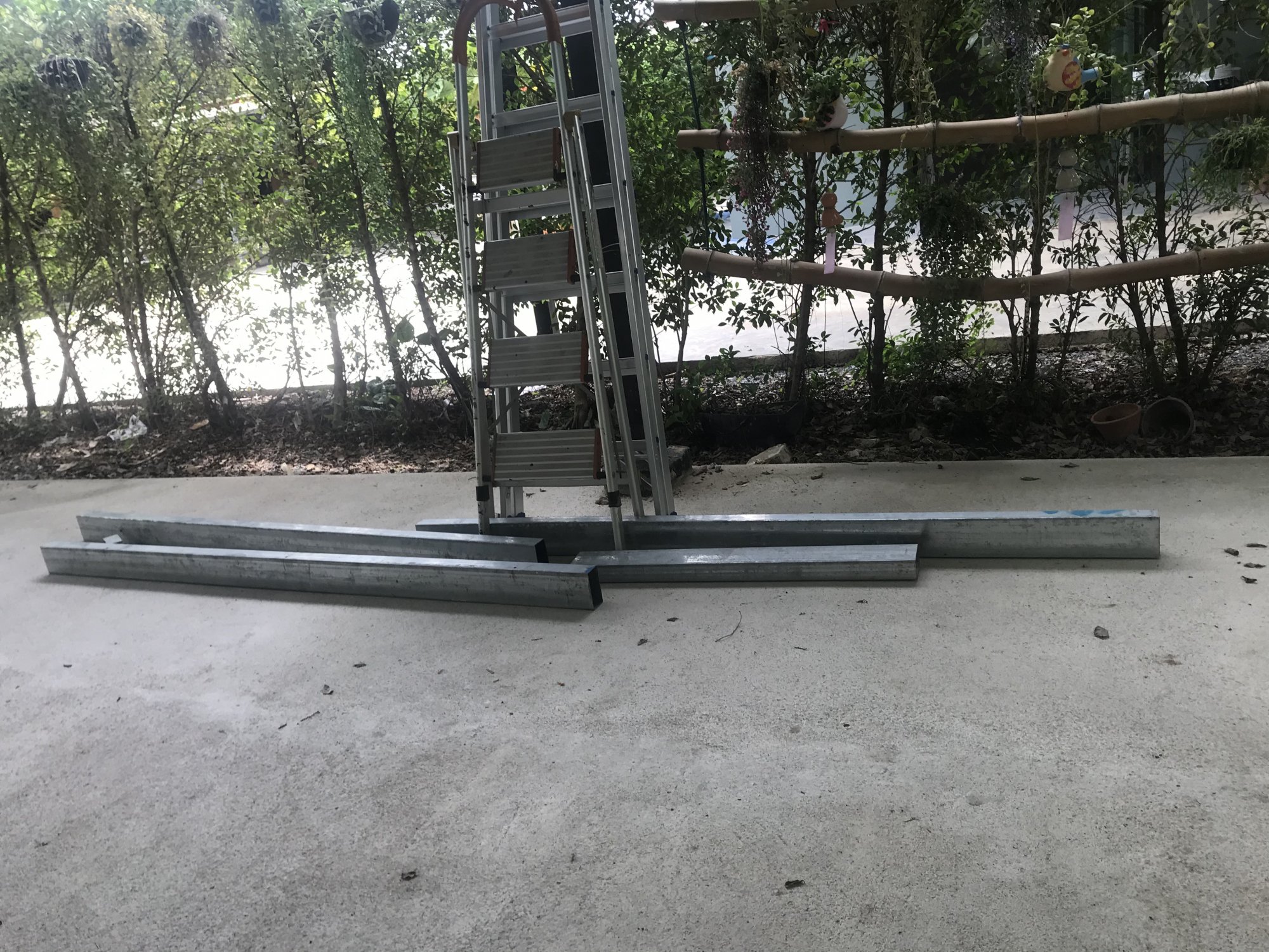

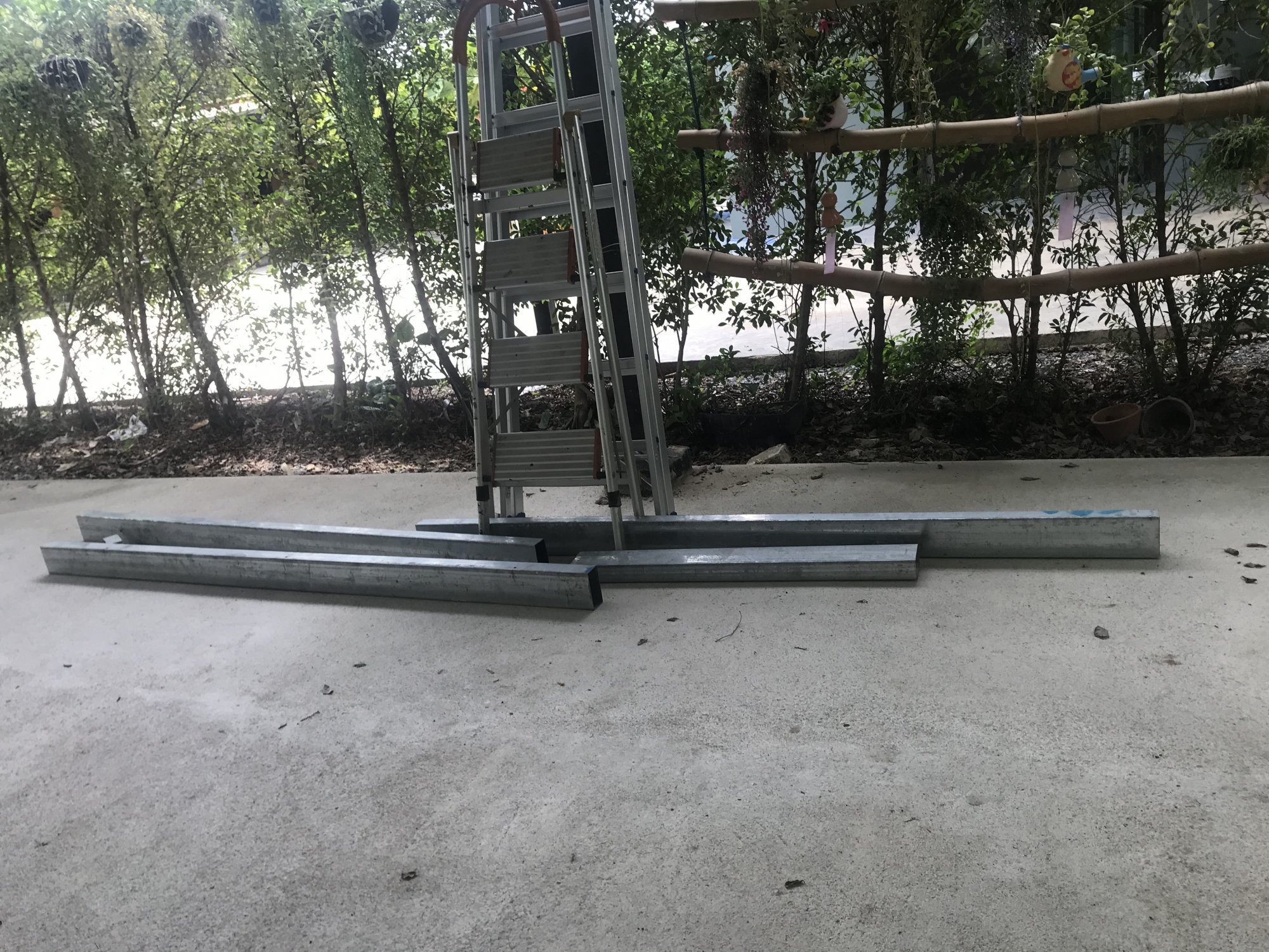

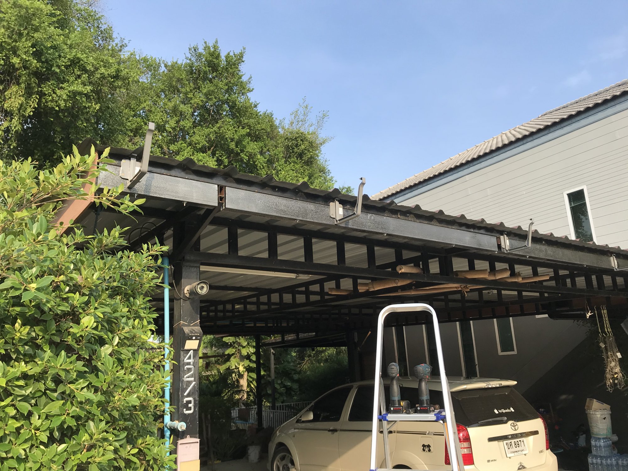

6m box section cut down to fit the spaces.

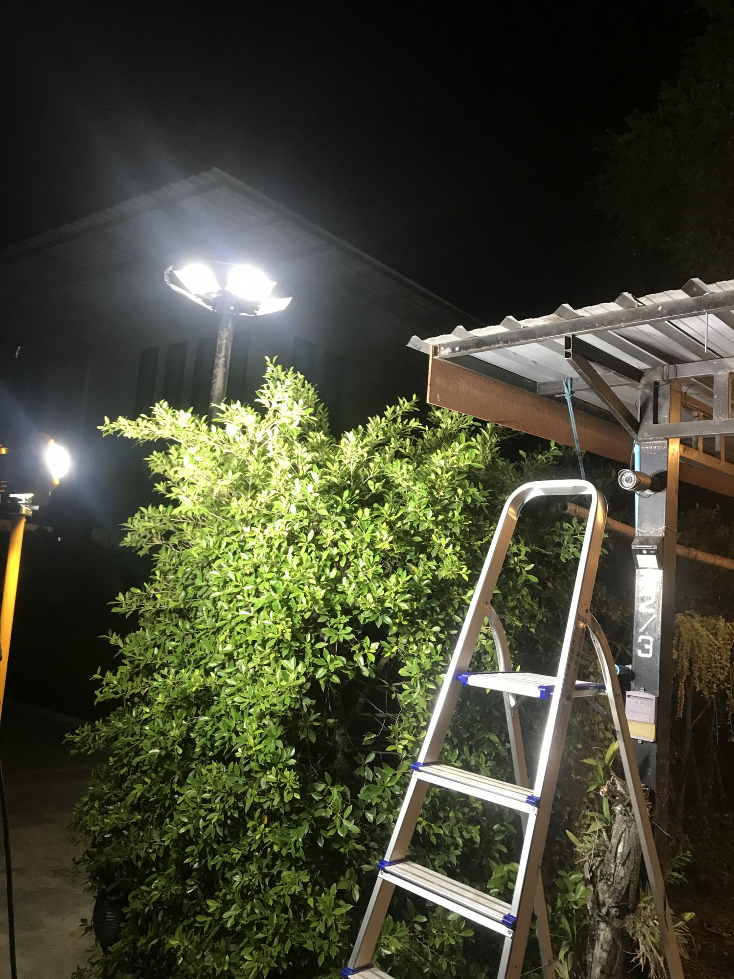

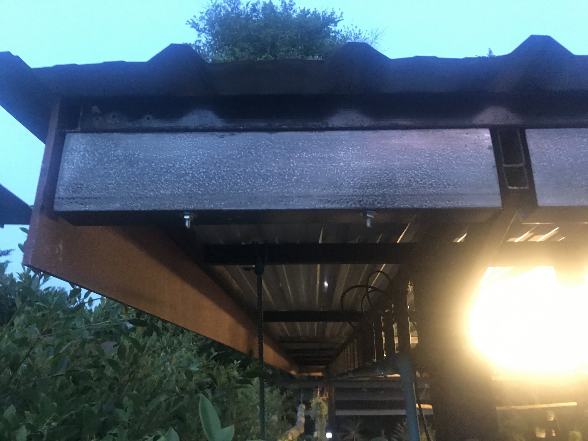

Drilling holes in the existing steel rail that the pieces of box section will be attached to. Smother-in-Law made her usual "just saying" comment to Wifey earlier in the day when I was out there in the sun... turns out it's no more pleasant at 9pm - it's just as humid and hot (really!), and it's either too dark or you're blinded by work lights.

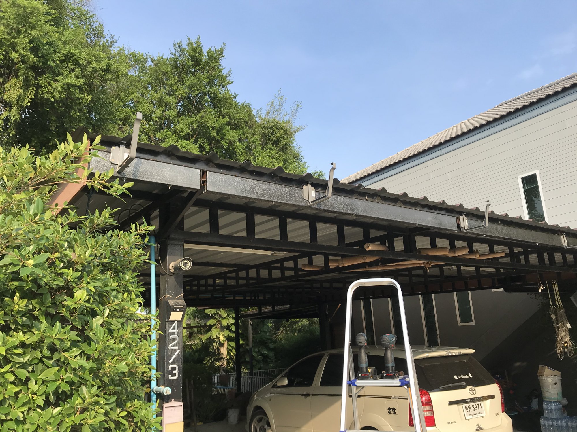

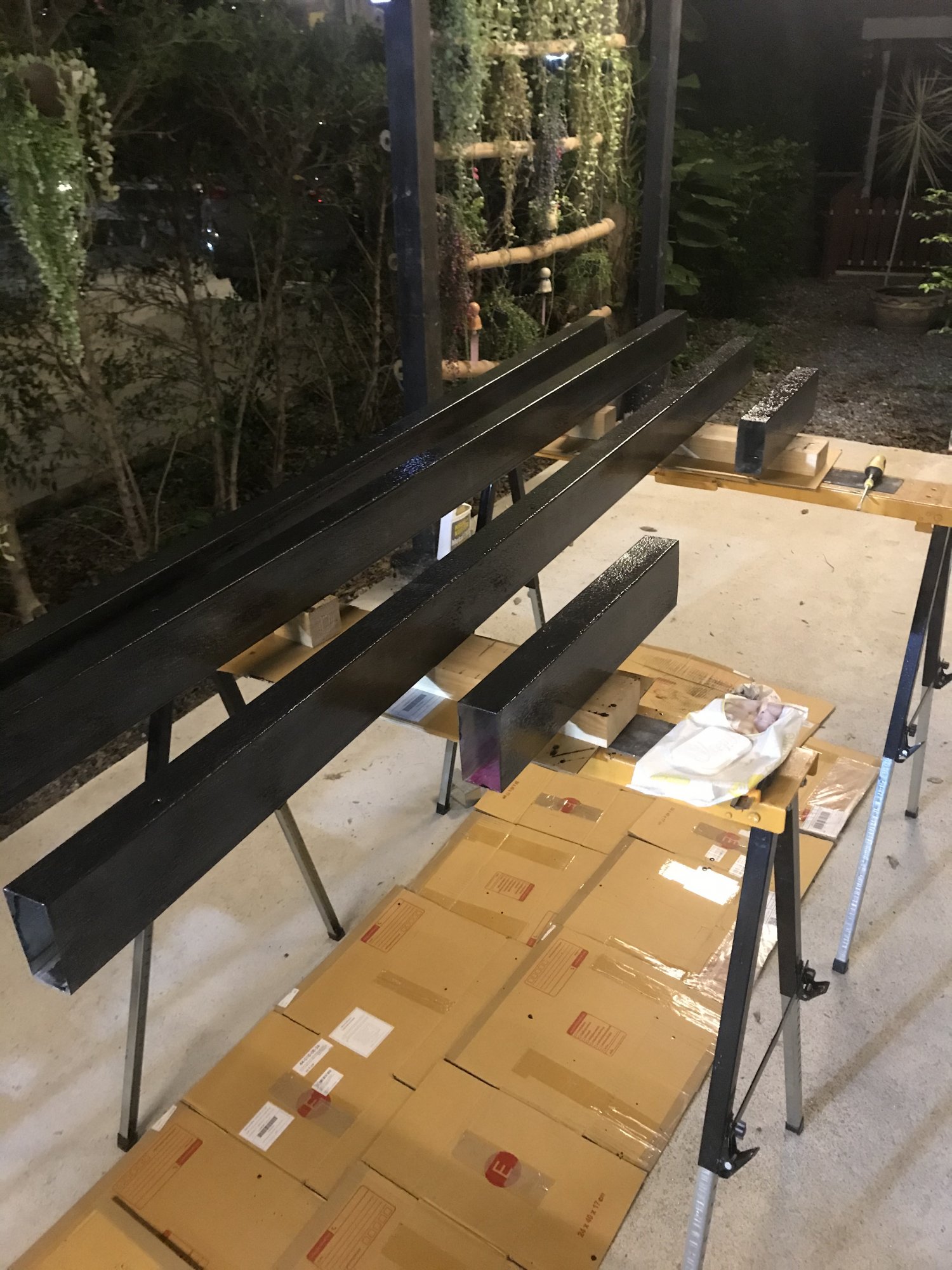

Cut sections after painting. It was already coated in _something_ (it doesn't look like regular galvanising, but it also doesn't rust - I don't speak enough Thai to know what the coating actually is) but 'shiny' steel was never going to get approval from Wifey. Hard to tell from this pic but the paint is 'black' hammer finish, originally bought to re-do the uprights of that same carport, before they rust away, so it seemed logical to use it for this too.

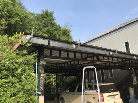

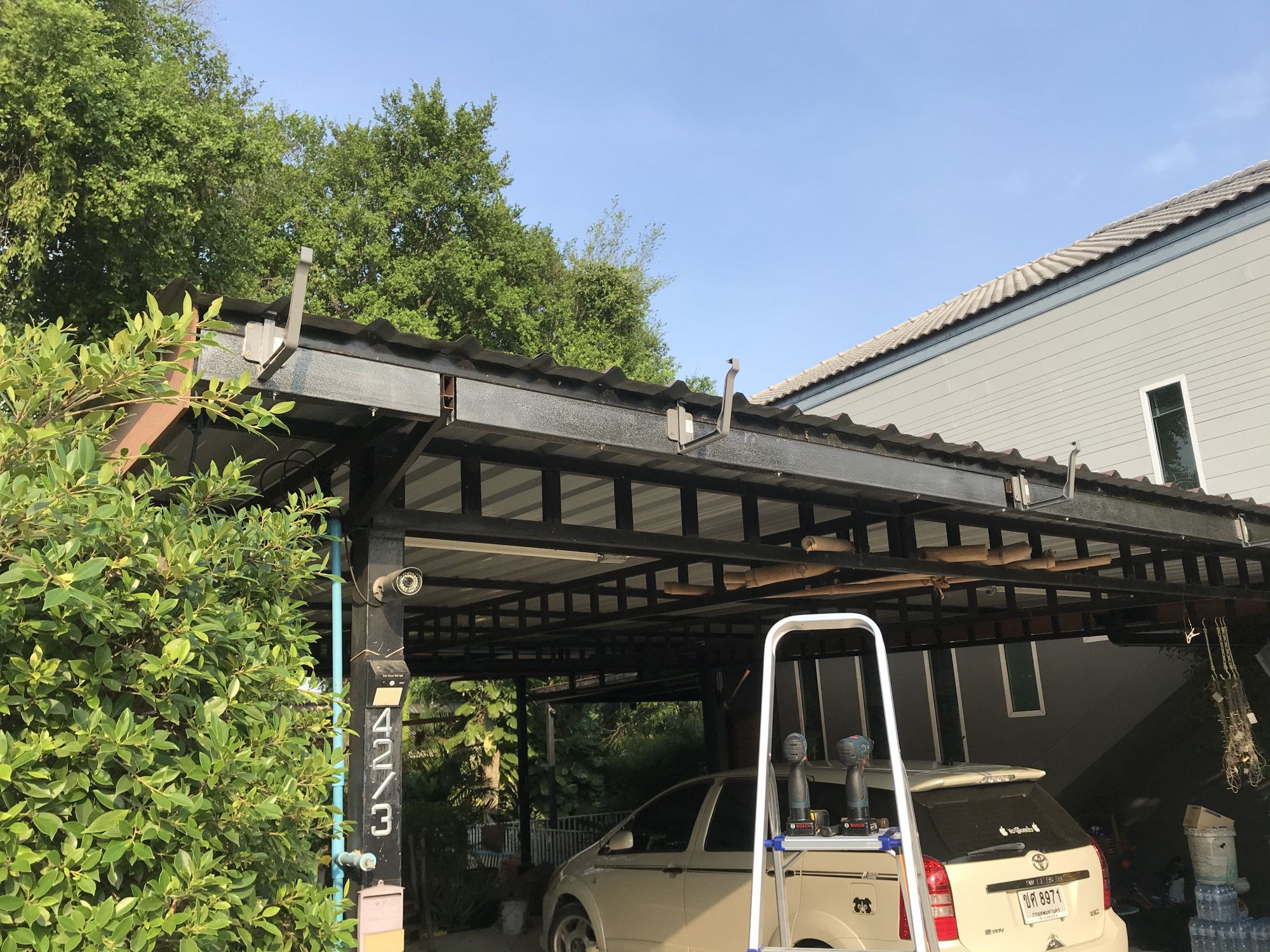

Box section pieces all attached, using cut lengths of threaded rod.
View attachment 1770765View attachment 1770764

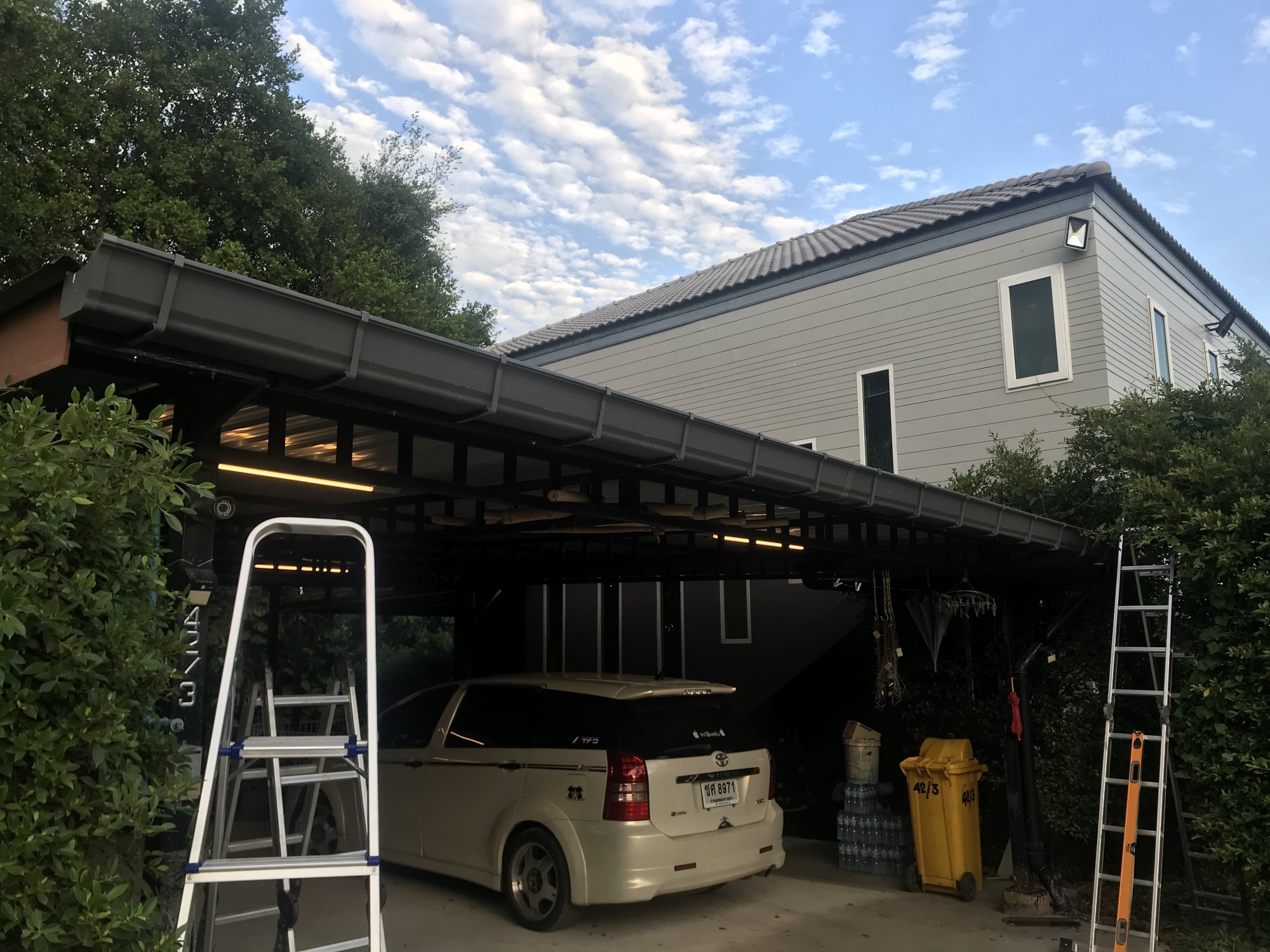

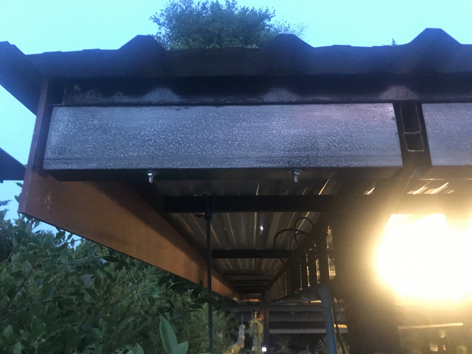

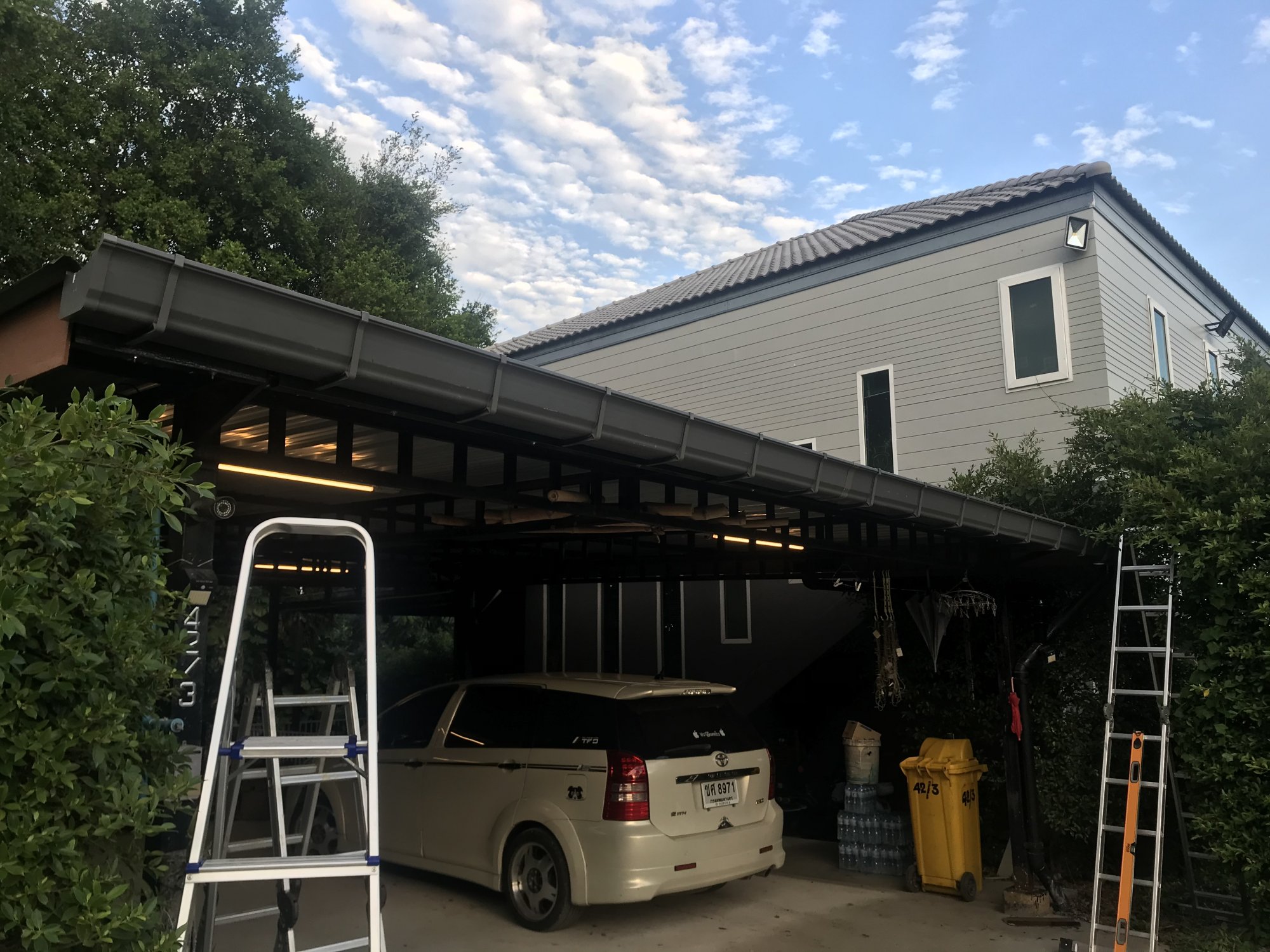

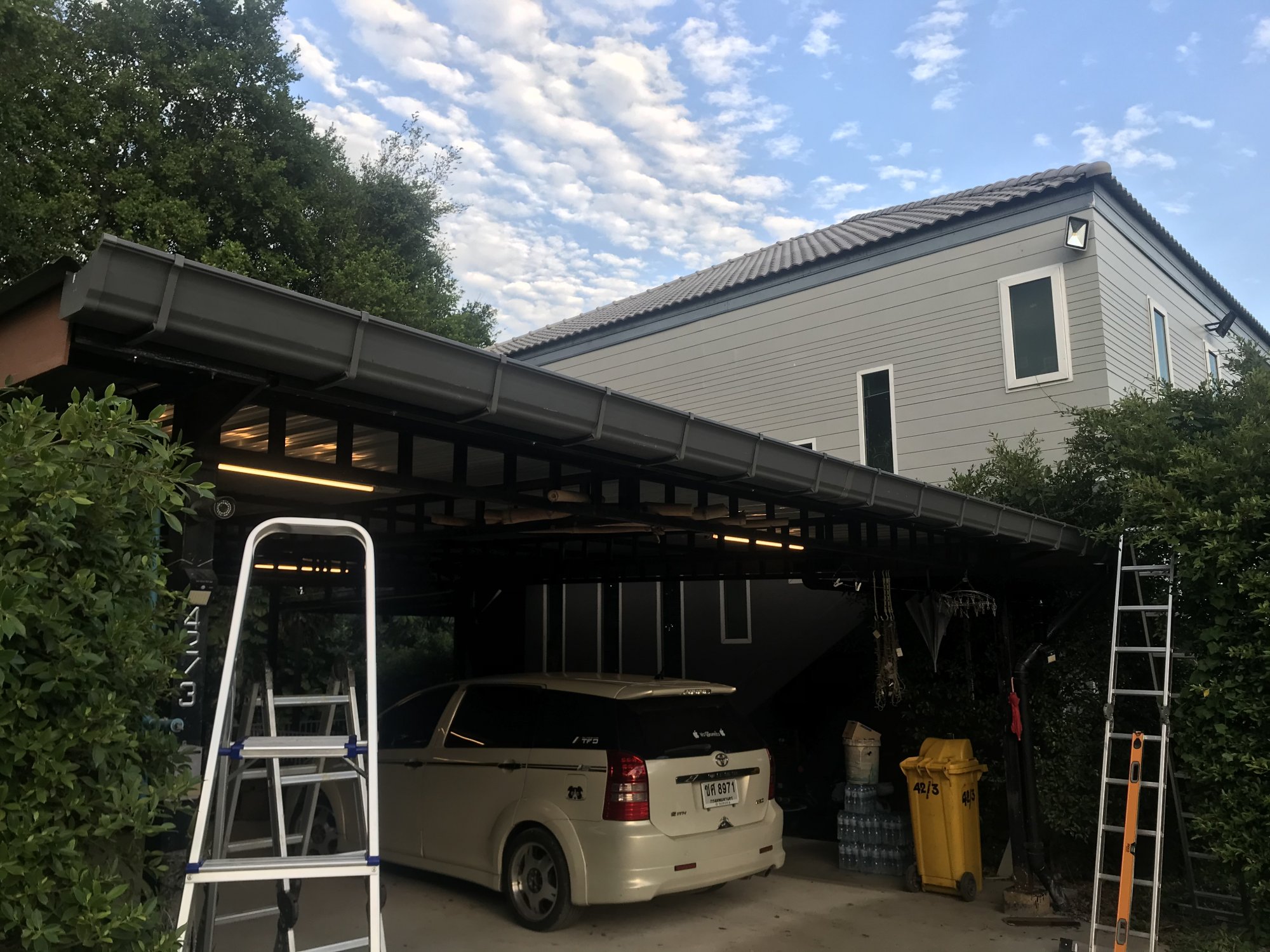

Initial hangers attached, at 1.5m spacing. Somehow I didn't get a photo after this with all the intermediate hangers attached. Ended up being 15 hangers, over ~6.9m.

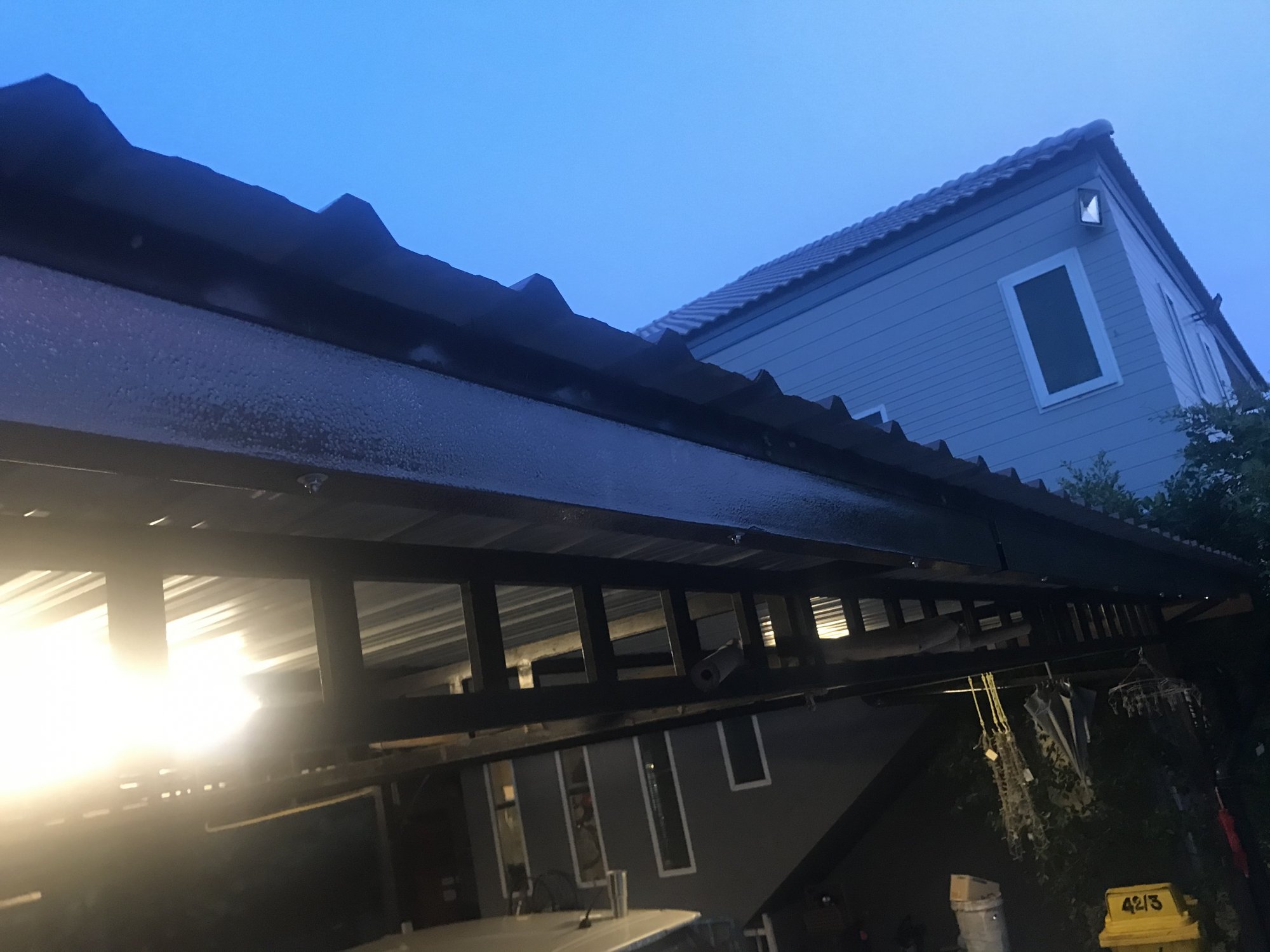

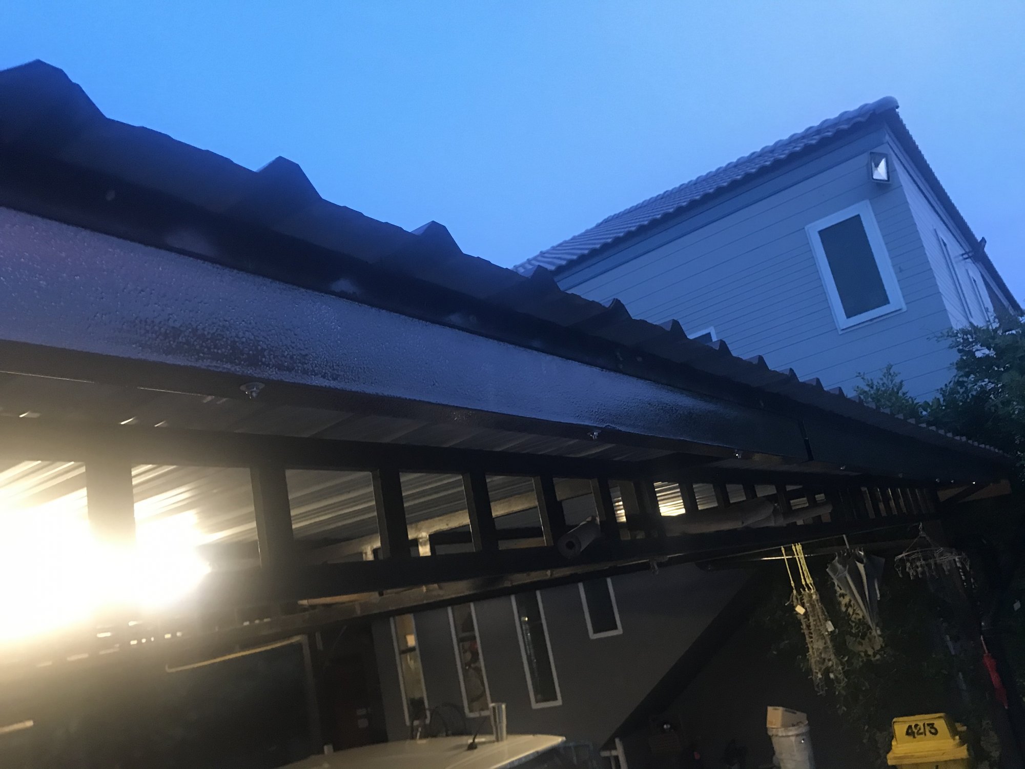

It's finally up! I guess I forgot to take any pics last night when joining the two pieces together. 7m of gutter is heavier than you'd think, even for PVC.
That gap tho! Will have to cut and adjust the down pipe in the next day or two. Also visible to the left: the same fascia material that the previous one had been attached to.
