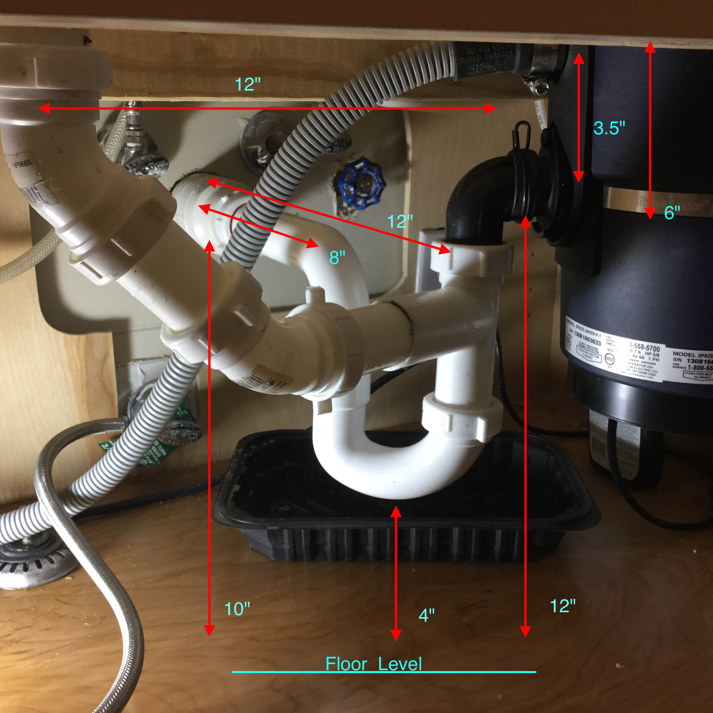

i am not an expert so would not have guessed the design as is would not work.
the drain from the sink half w/o the disposal looks low. Maybe just have it come in at more a 45 degree angle.
cut into the wall and and adjust so the trap is sitting on the cabinet floor. would make clean out difficult.

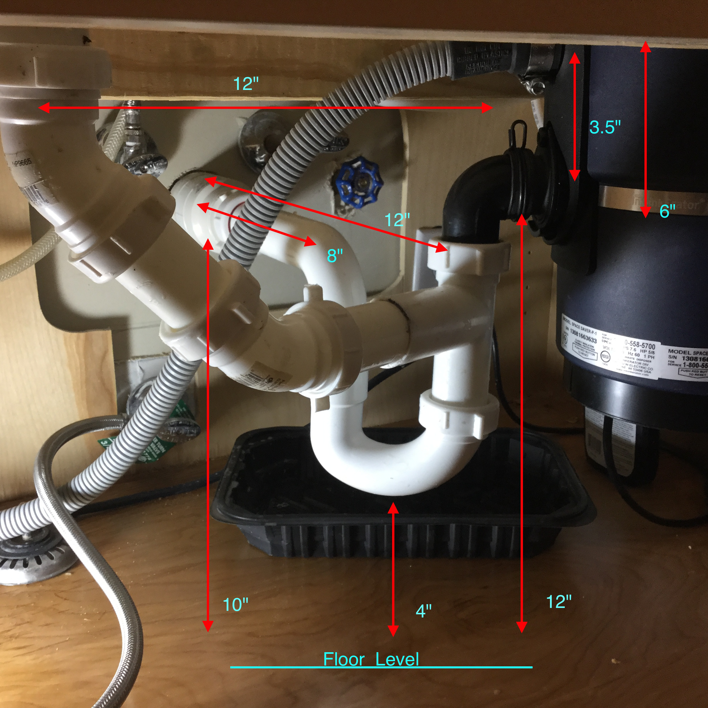

Problem with my kitchen sink drainage.
Before I renovated my kitchen, I had a normal surface mount sink. I replaced it with a double deep farm style sink. It projects significantly lower into the cabinet, and what I notice is the over time the drain gets clogged, mostly the branch of the pipe that drains the adjoining sink, not the one where the garbage disposal is located.
It was not problem with the old sink and here is what I think is going on. The clearance from the drain of the garbage disposal is 12” above the bottom of the cabinet. The height of the drain coming out the wall in the back of the cabinet is 10” above the bottom of the cabinet, so there is only a 2” difference in height for drain action through the trap. Therefore, I think the hydraulic action of water draining, by virtue of a only 2” difference in height, makes this action weak. There are two sinks draining into one trap, and those are designed so there are some constructions which makes it easier for food to get caught...however the food has to be blow back from the garbage disposal. The other sink has a dish drainer in it, where handwashed dishes get placed to drip dry. In addition, the drain traverses out of the back of the cabinet (coming forward) 8” level before starting down to connect to the trap that connects both sinks.
  • Possible solution, start the drain that comes out of the back wall (currently 8" level), down sooner.
  • I can lower the trap about 4 inches, but the differential between the disposal drain, and the height of the drain going into the wall will remain the same.
  • I’m not sure if 2 traps would be better, one for each sink would work with a single drain out.
  • Look for a shorter garbage disposal, but the disposal part above the motor is 6" tall. Overall shorter I don't think this would help me if the drain height remains 6" below the bottom of the sink.
So, I’m soliticiting opinions on how to minimize these clogs. So far, I’ve had to take the drain apart 4 times to clean it out. Thanks in advance for the anticipated help!! 😉

You will not like this, but you need to lower the drain where it comes out the wall. It looks a little higher than where the other sink merges with the disposer. It is clogging up because water is always in the short horizontal section before the merge. A separate p-trap might fix it.

Thanks for this input. This is what I think currently happens, the water fills the trap and food coming out of the garbage disposal, instead of all of it going into the trap and out the horizontal section to the wall, gets diverted into the pipe coming from the other half of the sink at the top of the trap.
At this point, I’m not prepared to lower the pipe coming out of the wall, it would require extensive under sink work, and I’m not even sure how accessible it would be if I ripped the wall out. I was thinking a separate second trap might be a possible solution to avoid this backup. Thanks for the help! I’ll report back. 🙂

If you do have to tear into the wall, remember the connection coming out the wall most likely isn't an elbow going down, but a T fitting for the vent pipe going through the roof.

Directly above the sink is a large window, so I’m thinking not, but I’ll look outside. Plan A after the holidays is try a new drain configuration leaving the wall alone. I don’t currently have the motivation to rip out the wall. 🙂
... I don’t currently have the motivation to rip out the wall. 🙂

Actually it’s cut out the back of the cabinet, then drywall. I’m going to try the easy way first. 🙂
I’m not an expert by any stretch, but it looks to me as if you need to put in another trap and have it drain at a 45degree out the back, after the drain from the disposal.plumbing is not my forte though...

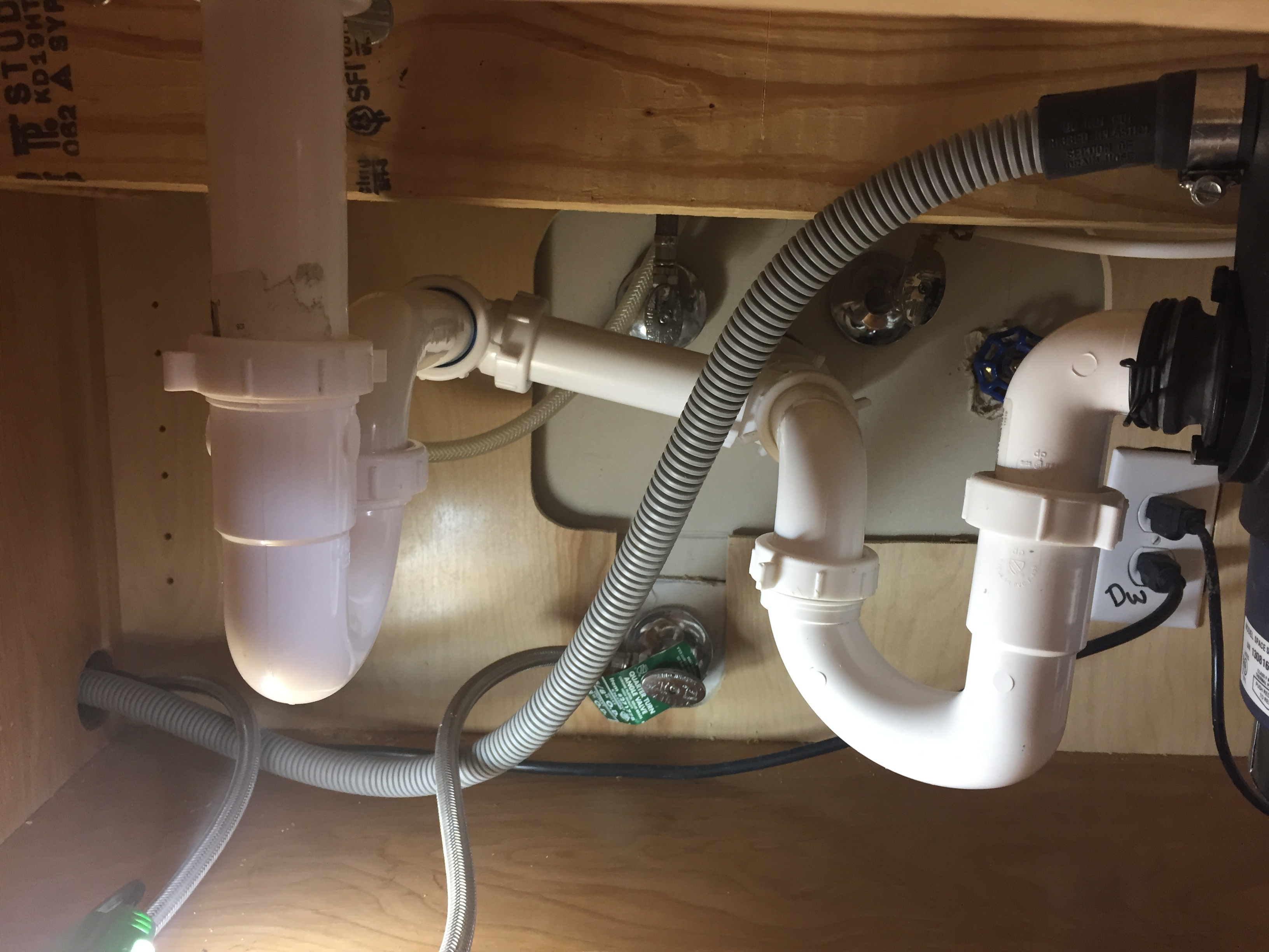

Regarding redoing the plumbing under my kitchen sink, got some parts today. I'll have to get under there tomorrow and start experimenting with what works, with a probable trip back to the Lowes or hardware store.
If you haven't done it yet. This is what I did to cure my drain woes. One trap for each side and then straight out the back like you are planning.
I also put hair salon style traps in the bathrooms. They have a large filter for debris and unscrew easily for cleaning.

Regarding the kitchen sink, I am doing dual traps with 1 1/2” pvc pipe. I was thinking that there would be a split pipe fitting like a Y, to join them together to drain out, but what I found at the store was a T which I think I can make that work.

Yea, I used the T-fitting for the dual traps too.
This is what I used for the salon hair trap. It goes on 1 1/2" pipe so you may need to use an adapter for 1 1/4. Which is just a thicker compression ring/gasket.
https://www.amazon.com/gp/product/B00JKU9VEC/ref=oh_aui_search_detailpage?ie=UTF8&psc=1

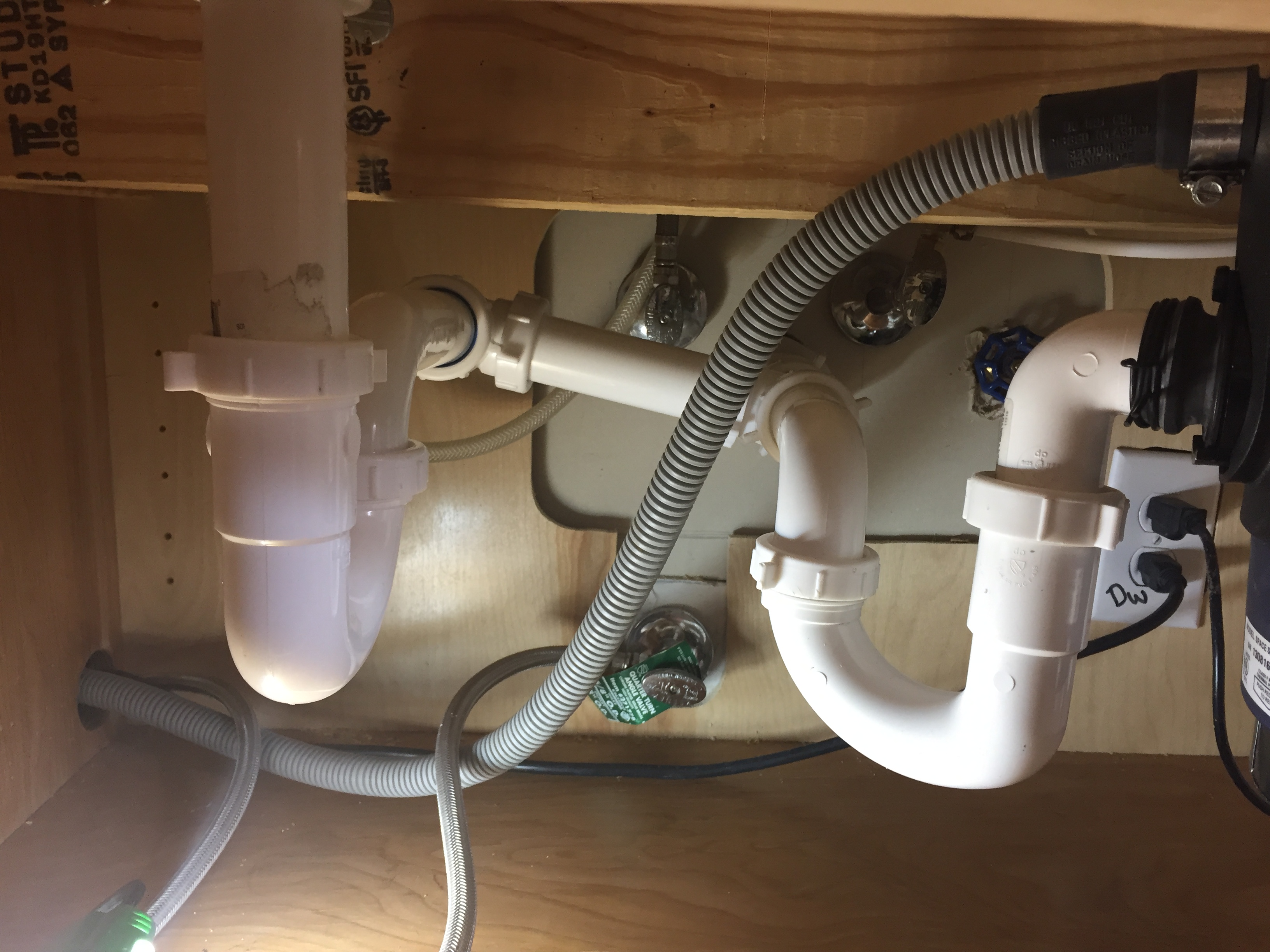

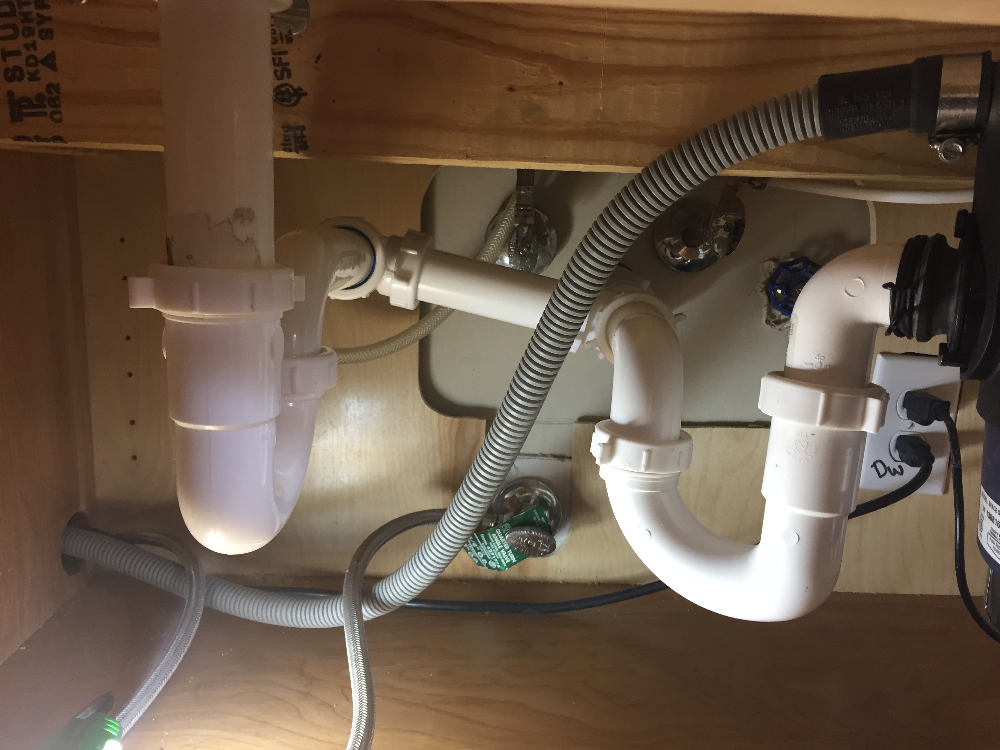

Ok, I think i'm done with my redo of my kitchen sink plumbing. It only took 4 trips to the store. 😳
If you have a plumbing supply place close by, be sure to compare prices. I went in there this morning out of desperation as none of my usual stores (Lowes, Home Depot, Ace Hardware) had what I needed. The prices at the plumbing supply place for similar parts were 1/3 of what they were at the previous three I mentioned. The attraction to the big box stores, is that you can walk in browse the shelves and pick what you need, if you can find it. At the Supply House, there is a counter and you have to stand in line, describe what you want, and wait for the guy to go in the back and fetch it, but at 1/3 the price, I should of done this first. 😛
From the photo, it looks like things are crooked, but the only pipe that is slanted slightly is the cross piece that goes from one sink over to the drain pipe, behind the dish washer drain. The drain goes straight out the back of the cabinet. The T that comes out the back has a baffle to keep the two drains from backing up into each other. I tested the new layout for about 5 minutes to check for leaks. I think I'm good to go and hope I won't have the same issue with one of these pipes clogging up with food debris.
