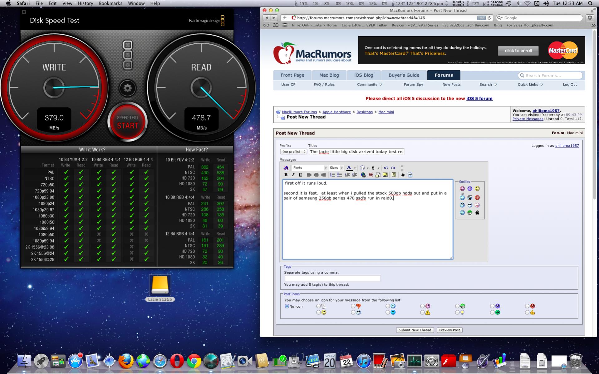

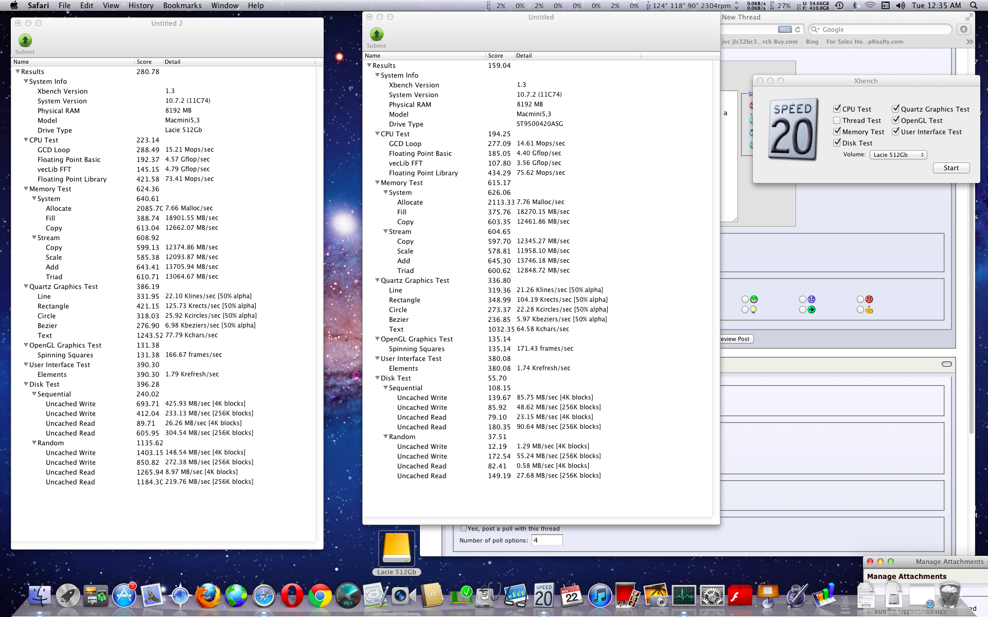

first off it runs loud.
second it is fast. at least when i pulled the stock 500gb hdds out and put in a pair of samsung 256gb series 470 ssd's run in raid0.
actually those scores are pretty good and I am sure a pro could use that speed and large storage size in a small space.

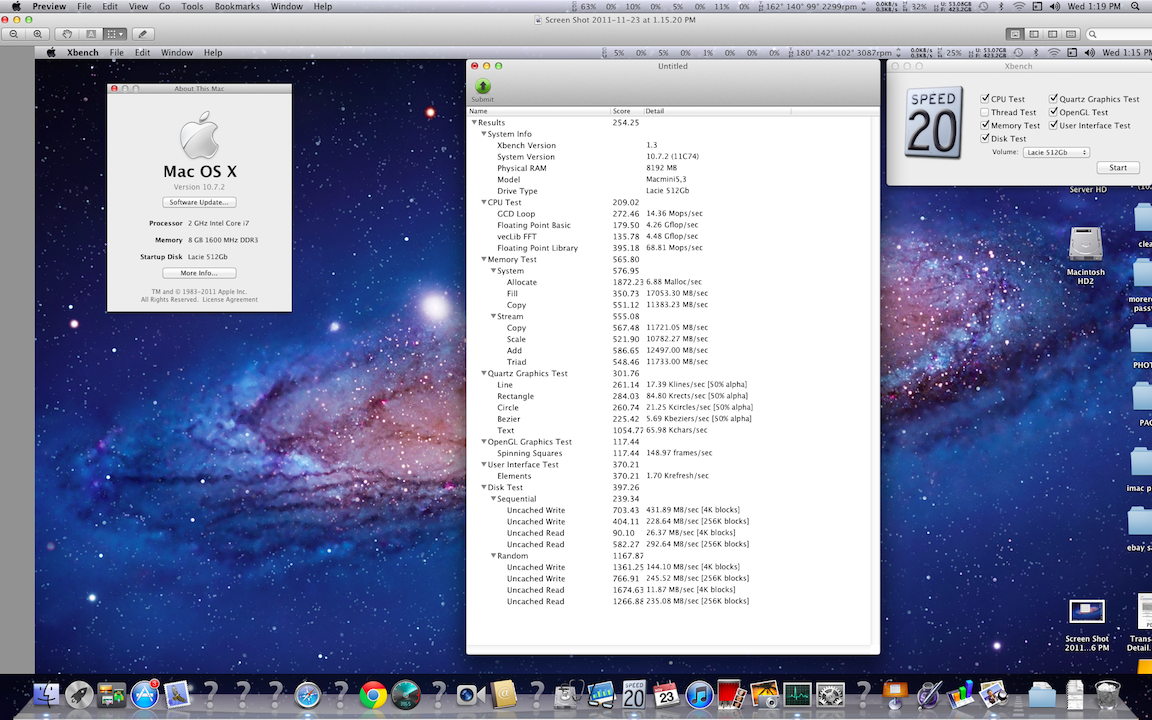

To theSeb you are welcome. I have results for it using a pair of samsung 830 64gb ssds the first thumbnail
the second thumbnail shows a pair of 64gb kingston ssds they were pretty fast to read and okay to write. they pulled far more power 8 watts at idle and 11 watts for a zero over write
last shot is the oem hdds they were hitachi 500gb 7200 rpm they were Advanced Format and i suspect they were setup wrong by lacie. the scores are poor 189 read and 119 write. I am of the opinion that they need to be aligned based on the scores they give me. I even wonder if they don't belong in this machine and due to the hdd shortage were pressed into duty. I mention this because anandtech gets much better results for write on his hdd model 200 not 120.

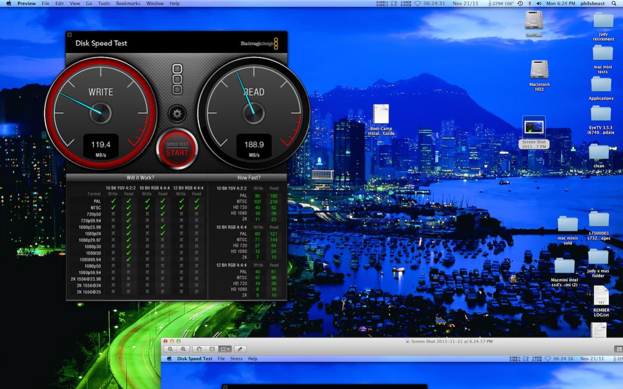

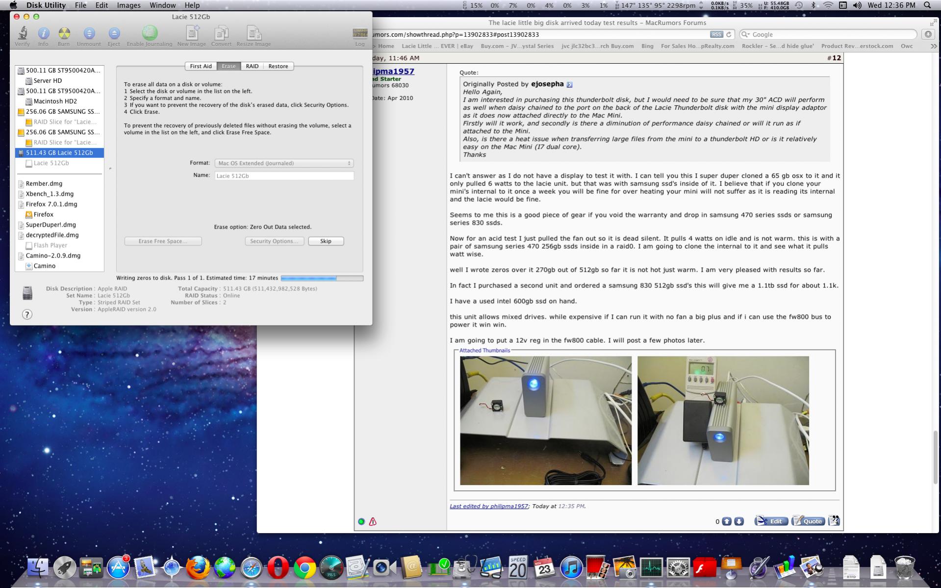

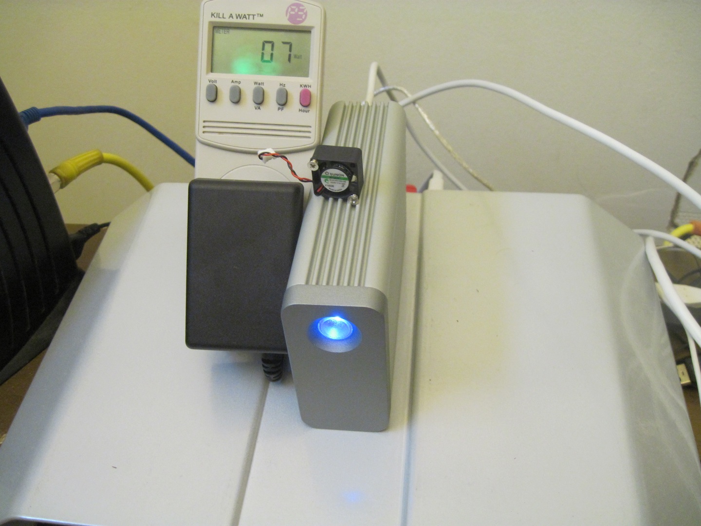

Now for an acid test I just pulled the fan out so it is dead silent. It pulls 4 watts on idle and is not warm. this is with a pair of samsung series 470 256gb ssds inside in a raid0. I am going to clone the internal to it and see what it pulls watt wise.
well I wrote zeros over it 270gb out of 512gb so far it is not hot just warm. I am very pleased with results so far.
In fact I purchased a second unit and ordered a samsung 830 512gb ssd's this will give me a 1.1tb ssd for about 1.1k.
I have a used intel 600gb ssd on hand.
this unit allows mixed drives.
while expensive if I can run it with no fan a big plus and if i can use the fw800 bus to power it win win.
I am going to put a 12v reg in the fw800 cable.
I will post a few photos later.

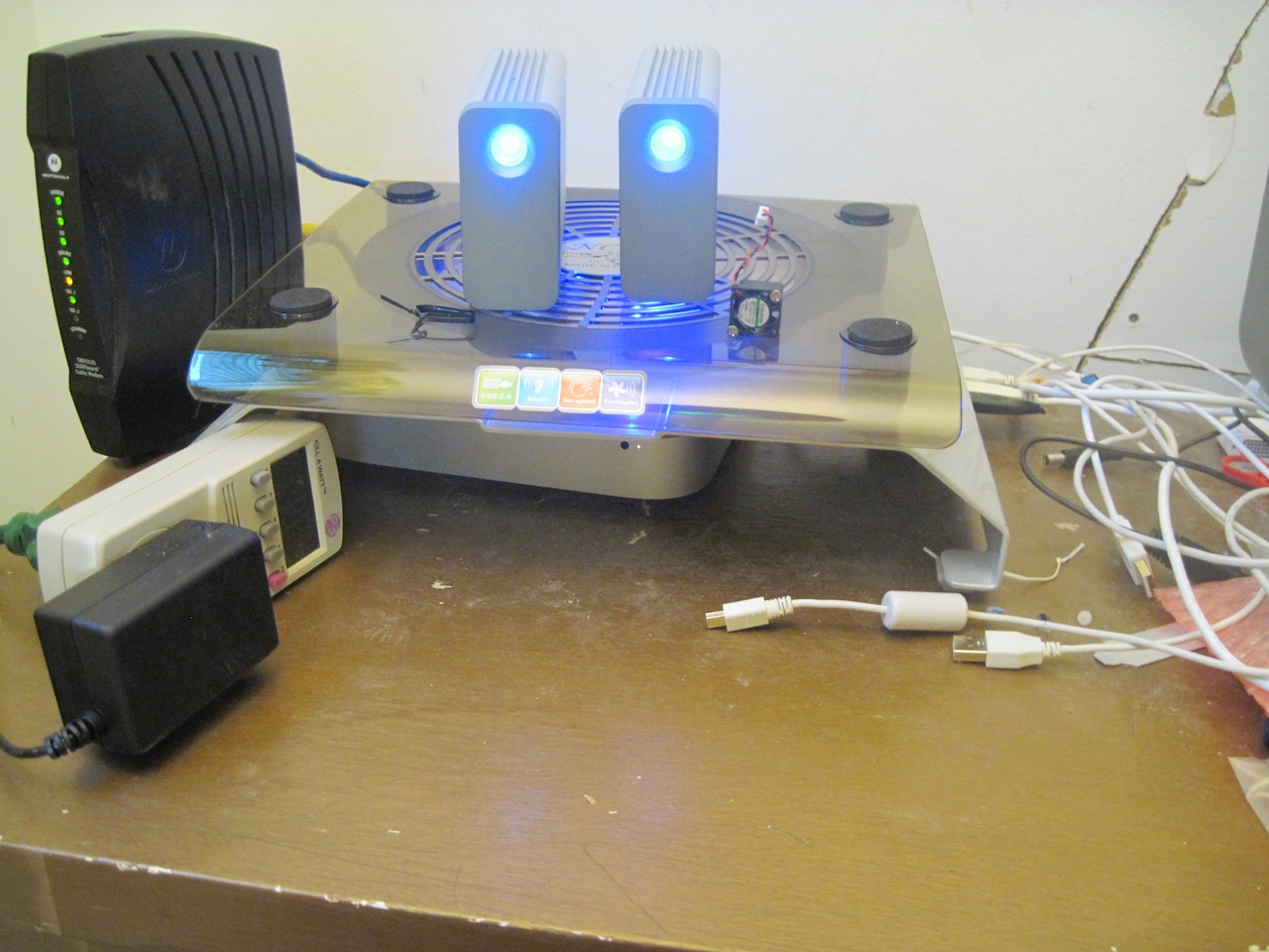

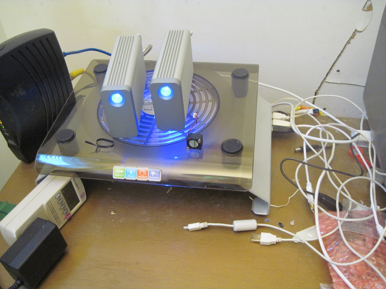

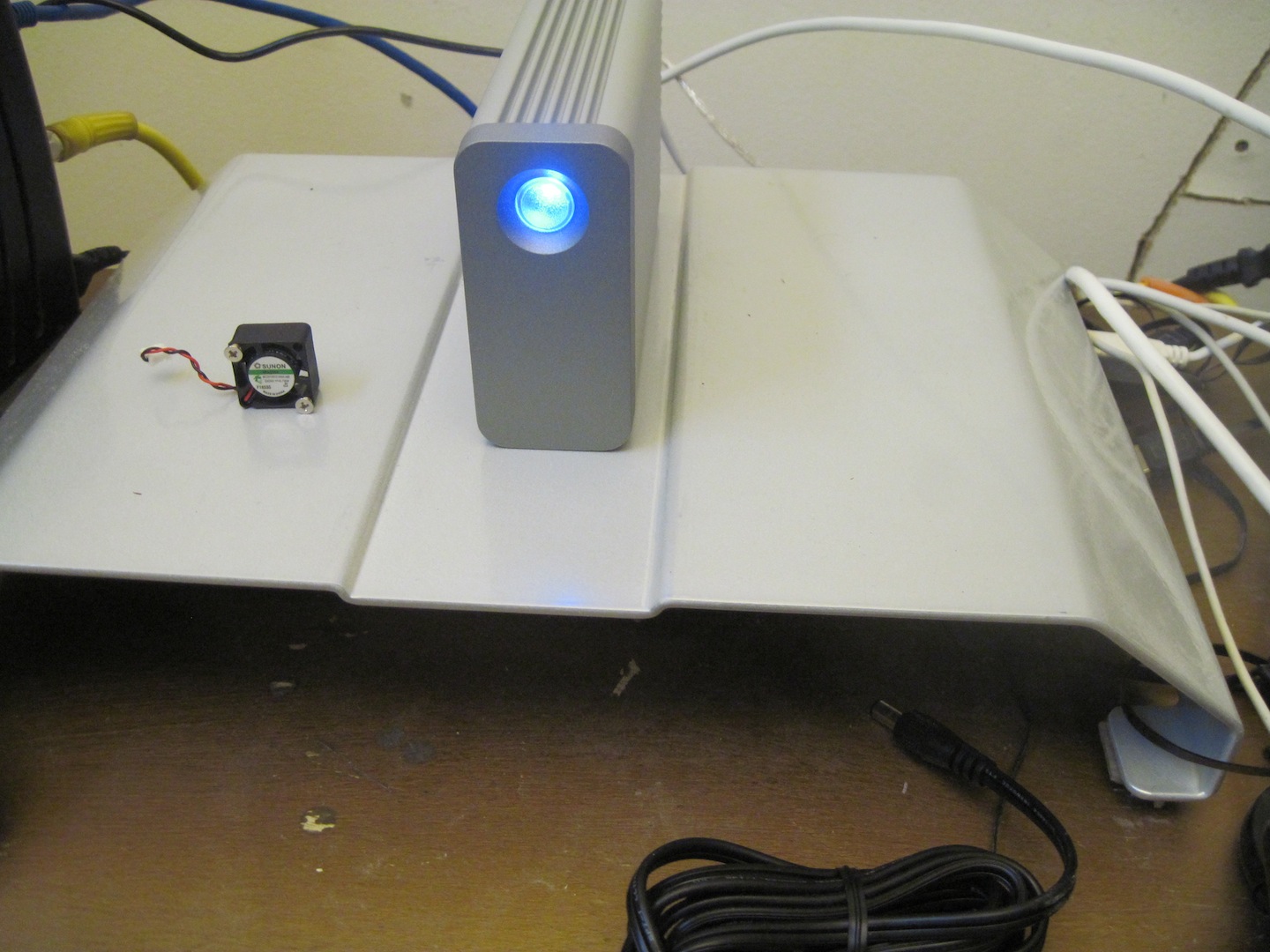

1st photo shows the small fan pulled
2nd photo shows the power deep into a zero over write
screen shot shows the overwrite
now mind you pulling the fan voids warranty.
putting in ssds voids the warranty.

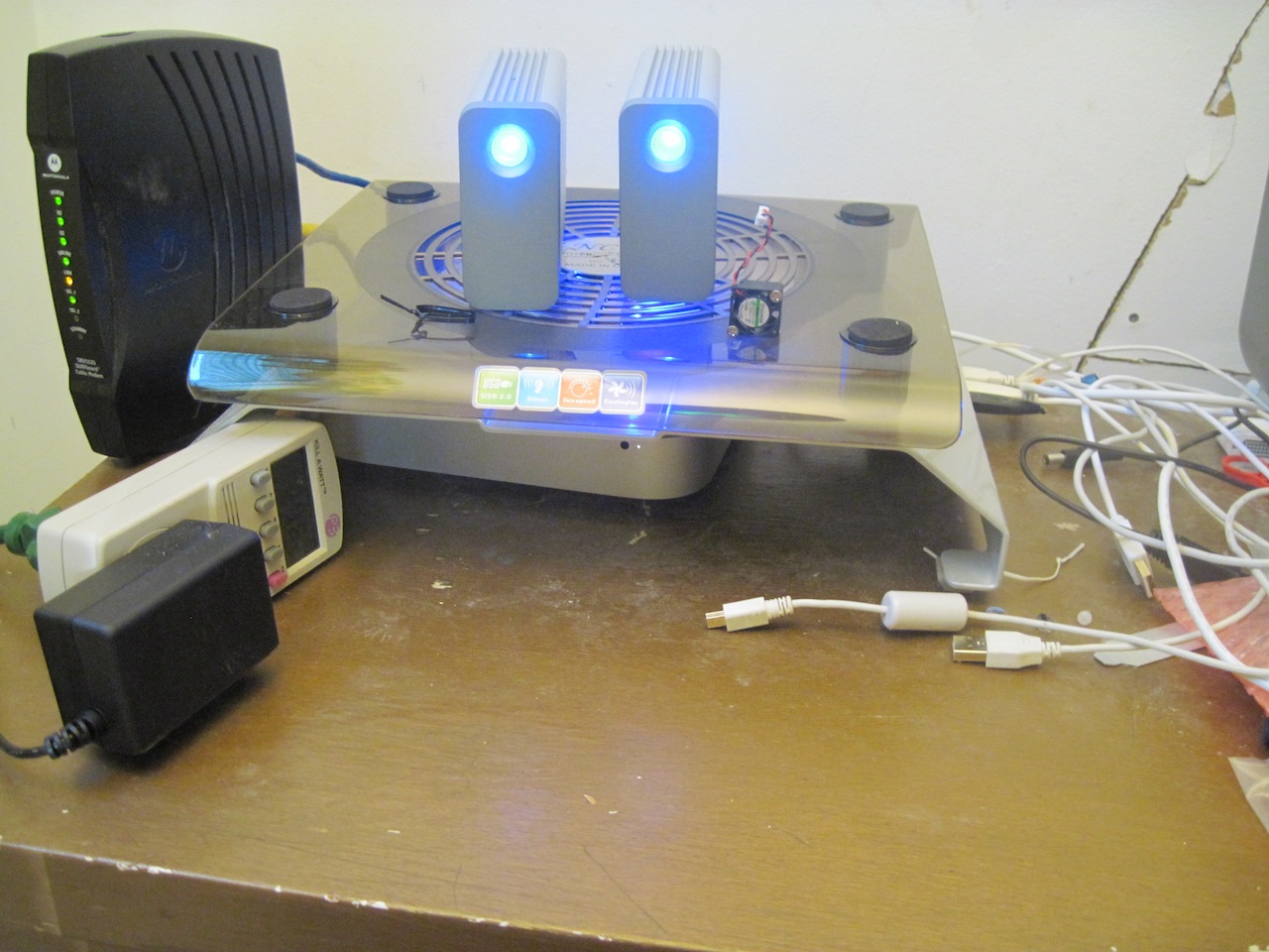

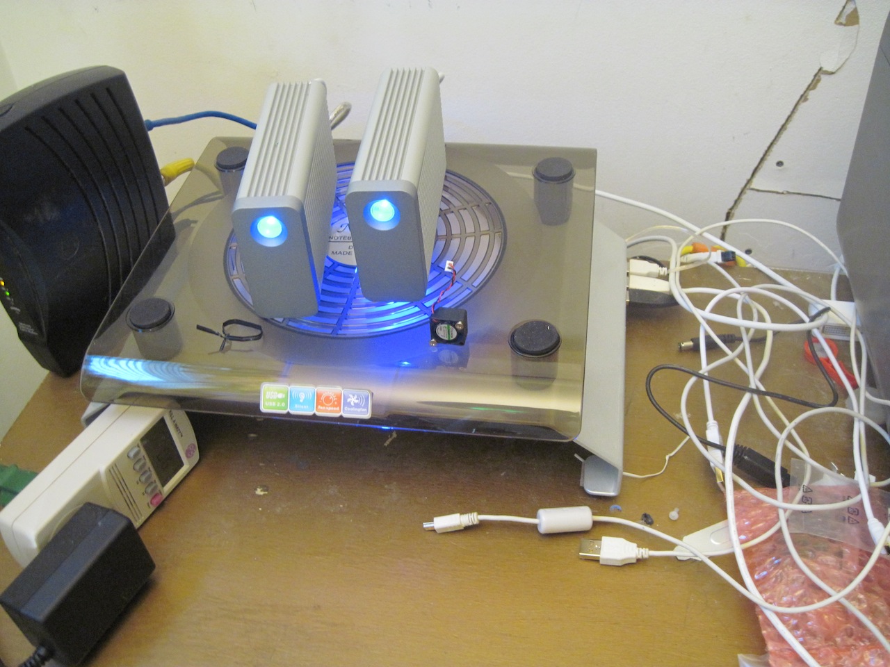

okay second machine came today .
the second one can boot through the first. right now I have one with 2 64gb samsung series 830 ssds and one with 2 256gb samsung series 470 ssds. I will do some more tests. I have found this much out the 512gb raid0 is stable and runs with no fan since the 22nd of nov. as a precaution I set up a laptop cooler underneath but it is not needed.

these are osx software raids so I am pretty sure yes. I am also pretty sure max speed is 550MB/s I will test more.
Wirelessly posted (Mozilla/5.0 (iPhone; CPU iPhone OS 5_0_1 like Mac OS X) AppleWebKit/534.46 (KHTML, like Gecko) Version/5.1 Mobile/9A405 Safari/7534.48.3)
Is the 550MB/s limit because Apple doesn't have drivers for the controller or is it simply one channel?
I know the achi from intel is 550MB/s on mac pros if you do osx software raid. most often you get to 470-480 MB/s
the limit on the mini may be better since mac pros are Sata II and Minis are Sata III.
So far with osx raid I maxxed at 480MB/s
there is also some software that comes with it but it is not raid software.
on the good end the raid osx lets you do JBOD raid0 and raid1 even 1 hdd and one ssd. but I am thinking this unit will max out at roughly 500MB/s with the current osx. I have to do more tests with the 2 units. I have 4 identical kingston ssds so I can do a 4 ssd raid0 and see what i get.
If I get past the 500 MB/s mark then the limit is in the bridge inside the lacie unit. It will take an hour or two to set it up maybe tomorrow.
