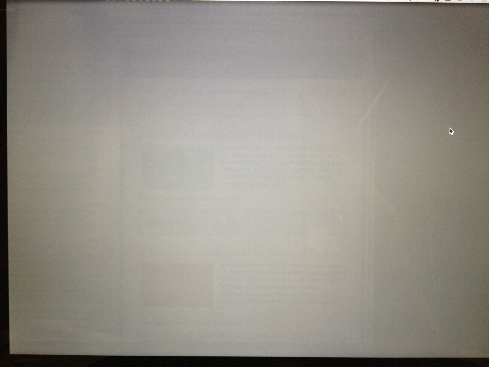

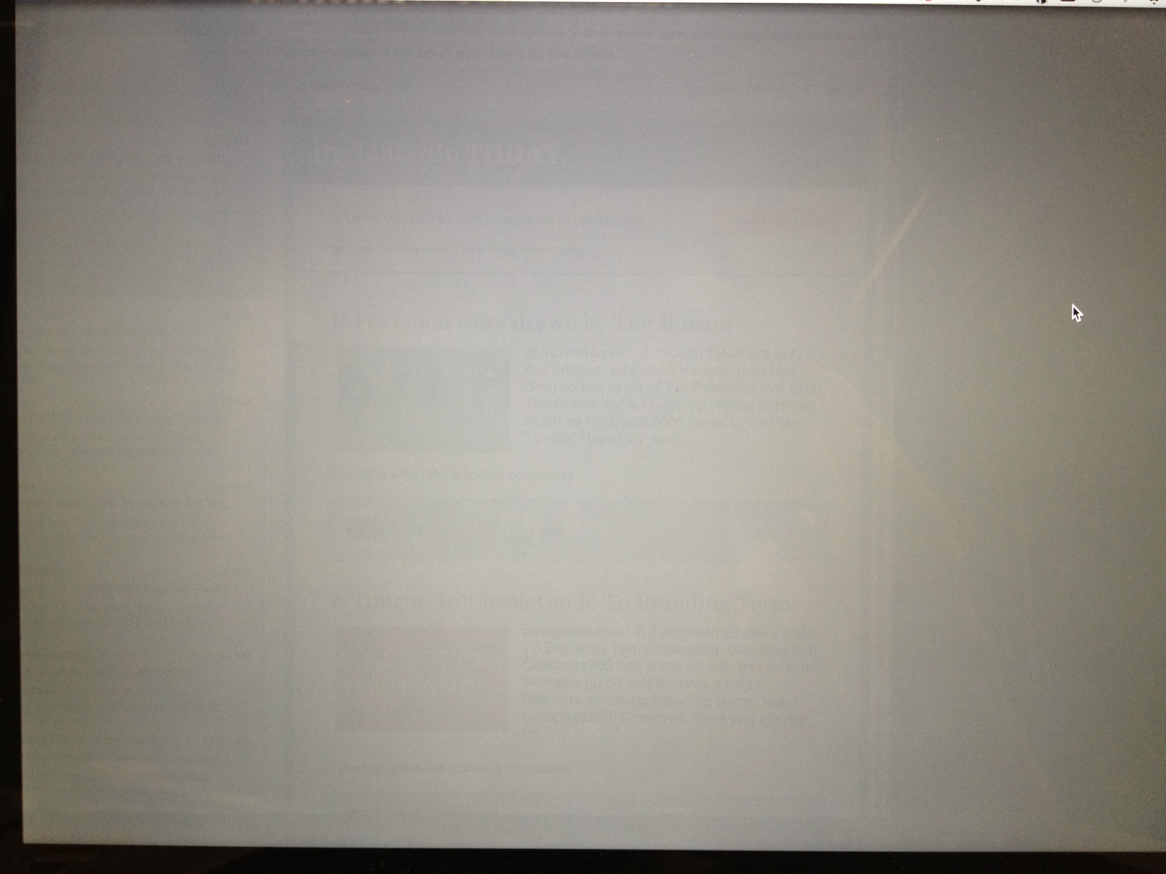

My replacement for my original (both LG) was originally perfect, but has degraded very quickly - this is what it looks like now.
Will be taking it in tonight - very peeved to have to be dealing with this issue a second time.
That's horrendous!! 😱 I hope they swap it out, and you get a Sammy screen!!
