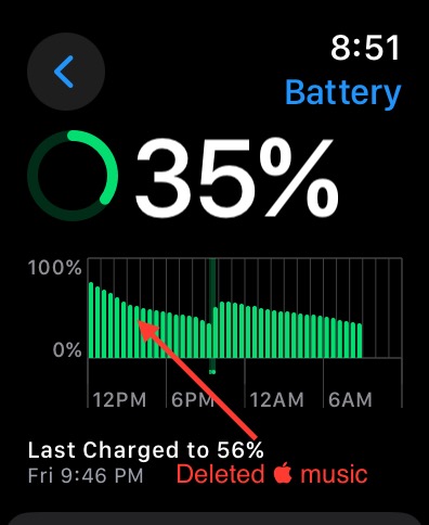

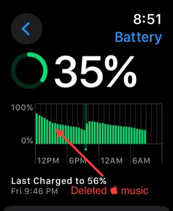

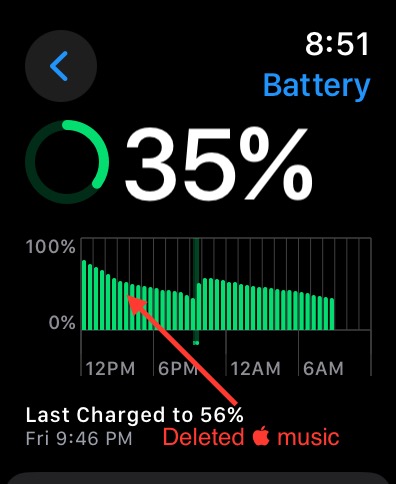

I’ve been quite disappointed with battery life since the update. However, I seem to have found which app for me is the culprit.
I do not have Apple Music, and instead rely on the old school music sync through iTunes. I have over 6k songs, however obviously I do not need that much on my watch. I had a Smart Playlist on my phone that was basically top 1000 most played songs. In my watch Music app settings, this is what I selected as the only music I wanted synced to my watch. This has worked fine since I got my series 8.
After I upgraded my watch to WatchOS 10 I noticed I was getting a third of the battery life I used to get. Like in 10 hours I would go from 100->10% without using the watch at all. No fitness, music, nothing.
Well digging around trying to troubleshoot, I looked in my watch settings -> general -> about. It showed my watch as having over 3k songs on it. Now mind you nothing changed in my music settings. The ONLY playlist I was syncing was 1000 songs long, and Recent Music was disabled. I also noticed that that song number would sometimes go up or down depending on when I opened the About menu. Something was definitely wrong there.
I reset my watch from scratch (no backup) and reset everything back to where it was. Seemed to work fine for 24 hours, however shortly, I’d see the battery issues return.
I tried syncing different playlists, loading less music onto my phone, etc. I verified that the playlist was fully synced while it was on the charger (according to the Settings -> Music) to make sure it wasn’t needing to sync in the background. I even disabled Music background activity. Setting it up multiple times as new didn’t work either. Every time I’d load songs onto my phone my watch would start to poorly perform.
The only thing that has worked so far is to remove the Music app from my phone (since you can’t keep it uninstalled from the watch separately)

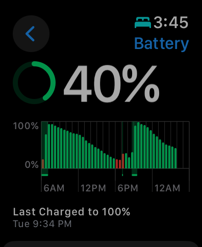

While this seems extreme, I give you the below screenshots from my watch battery timeline. The first shows how bad this was. Every day the drain would be horrible. The second shows what it looked like after deleting Music. You can totally see the inflection change. (The screenshots overlap a bit in time) Ever since I’ve deleted music, no more battery problems.
I’m sure there’s some stuck music service that’s doing this, but there’s nothing I can tell that I’m able to do to stop it.
