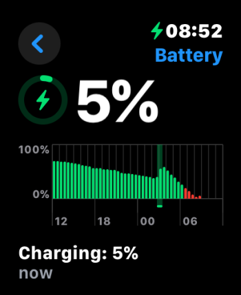

The below post is a copy of reply I've just added to the news forum post on this issue and the update to 10.1.1

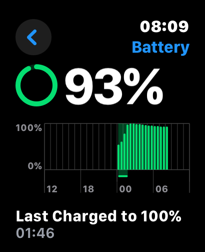

I can confirm that, for me at least, this update has fixed the issue.
I have last year's Apple Watch Ultra and I was getting between 1.5 to 2 days battery life, which was the main reason why I bought the watch.
After the update to 10.1, I instantly went from this to having to charge the watch three times a day, so a six times increase in charging!
Not only that, but the charging itself was pausing without warning as the battery was overheating - which is something that had also never happened before.
This made the watch completely impractical to use and it happened from the moment I updated on the 26th of October until the release of 10.1.1
I actually stopped using the watch, because I was concerned about damaging my battery as I had looked after it and prior to 10.1, it was showing 100% battery health.
So for those who had been affected by this, it was a very serious bug and I'm glad to see the back of it.

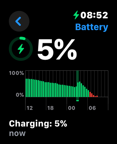

EDIT:
I've added two photos to the post – these are screenshots from my Apple Watch battery section.
The one that shows 5% illustrates the slow discharge of my battery on watchOS 10, followed by the rapid decline immediately upon update to watchOS 10.1.
The one at 93% shows the problem appearing to be fixed after the update to 10.1.1, as you will see the discharge has slowed significantly.
