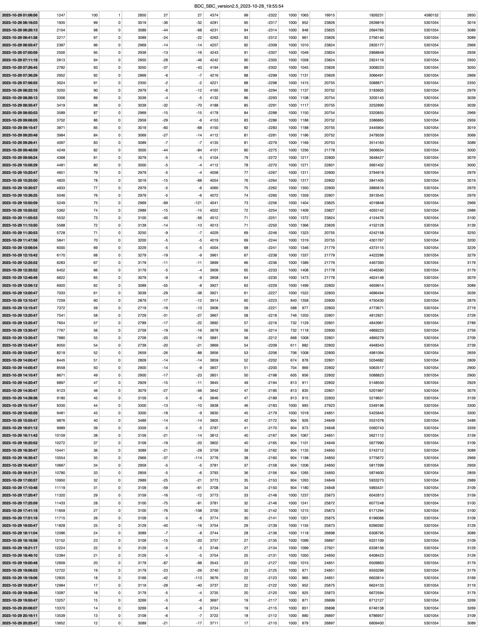

After reporting the bug multiple times to Apple (through the feedback app) they finally responded and requested additional information. I had to install a profile to run a sys diagnosis and upload the file.
I looked though the files by myself and you can clearly see the battery drain. I hope Apple can fix the issues.
