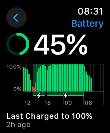

Series 4. With 10.3, at 66% 2.5 hours after a full charge. Didn’t have such drain previously; usage habits unchanged.
Series 4, Updated to 10.3, at 45% 2h after a full charge.
Reset, Repair, didn't work.

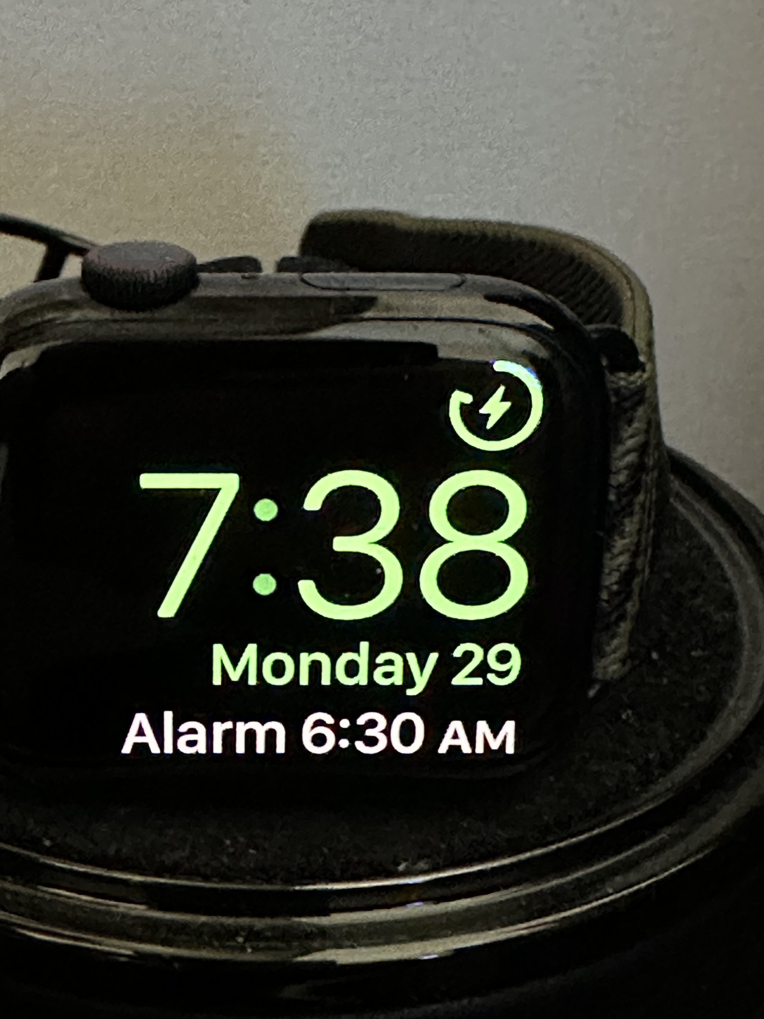

Ohhh wow look at the surprise I got this evening when I placed my Watch on the charger!!!
Finally after months of it disappearing the max charge limit activated again.
Question is will it be a one off now???

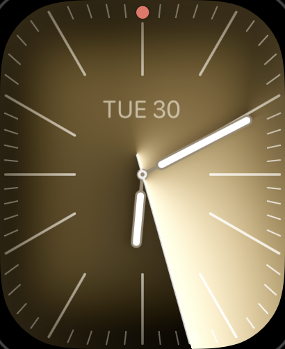

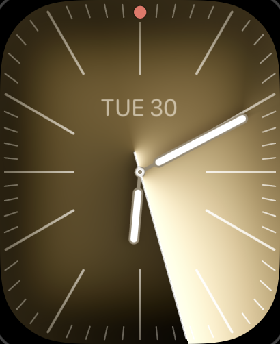

You are a genius! Apple Watch 9, 1 month old, not lasting a full day. Changed the Solar face and now I’m 73% after a full day.
Reactions: usmaak
I love the solar face and use it on my Ultra outside of working hours. I may try another face and see if there’s a difference in battery life, thanks.
Edit: this one right?
Correct. That face drains my battery more than any other.
I have a S9 that I bought late fall. Came with 10.1; I was using 1-2% battery per hour (while not working out). When 10.2 came out, I installed it...and went to 5-8% per hour or more.
Figured it might just be a quirk, so did the usual stuff. But my other watches on 10.2, using this face, drained the battery more as well.
FYI, 10.3 does it as well. I like the face, and maybe they will fix the drain with it down the road. Alas.
