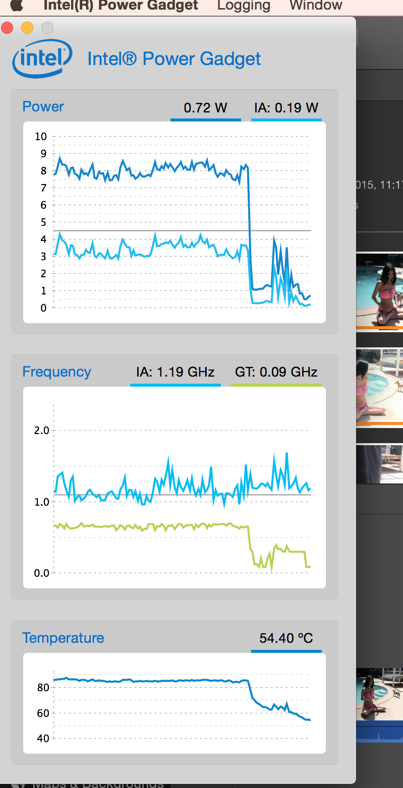

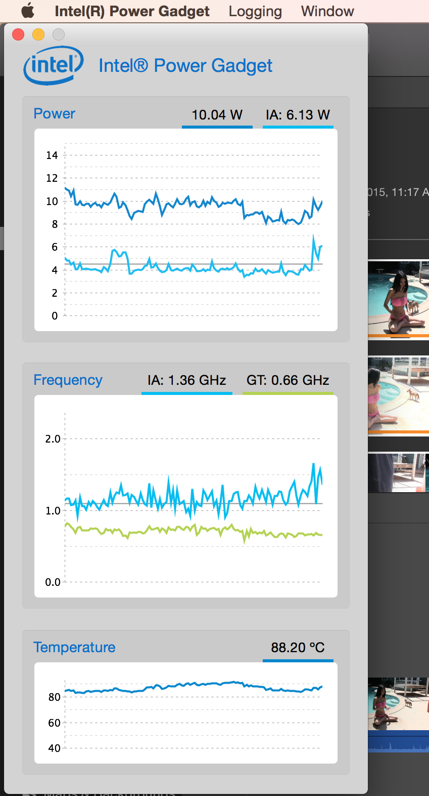

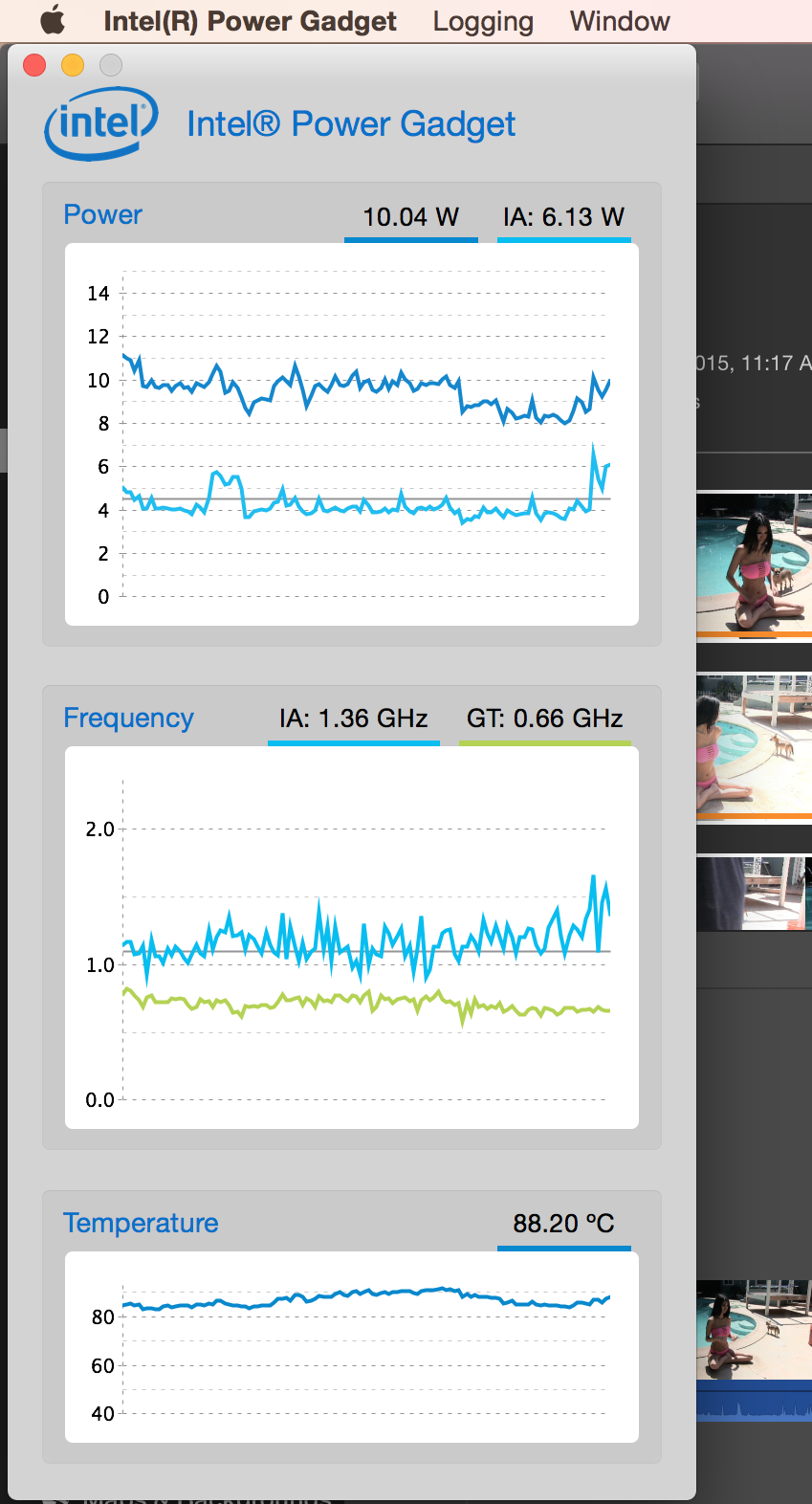

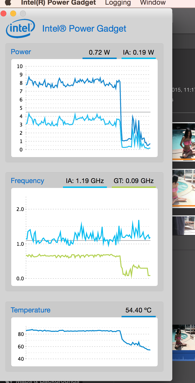

Ok so ran another 5 minute video export in iMovie at the default medium 1920x1080 setting, 510MB file. Display at max brightness and I forced it to stay on the entire time rather than sleeping. The temp ran between 84-87 C the entire time with a max of 88.20 that I got a screenshot of here. The next screenshot is from about 10 seconds after it finished exporting. As you can see, temps come back down very quickly. Now the question is how much heat can the internals sustain without causing problems? Can it run at those max temps for hours at a time without doing damage?
