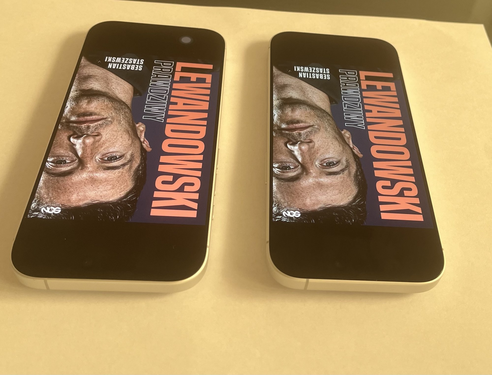

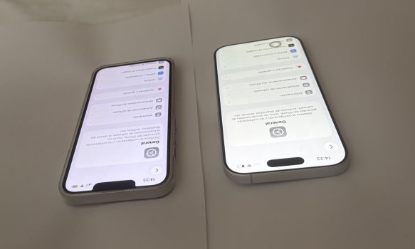

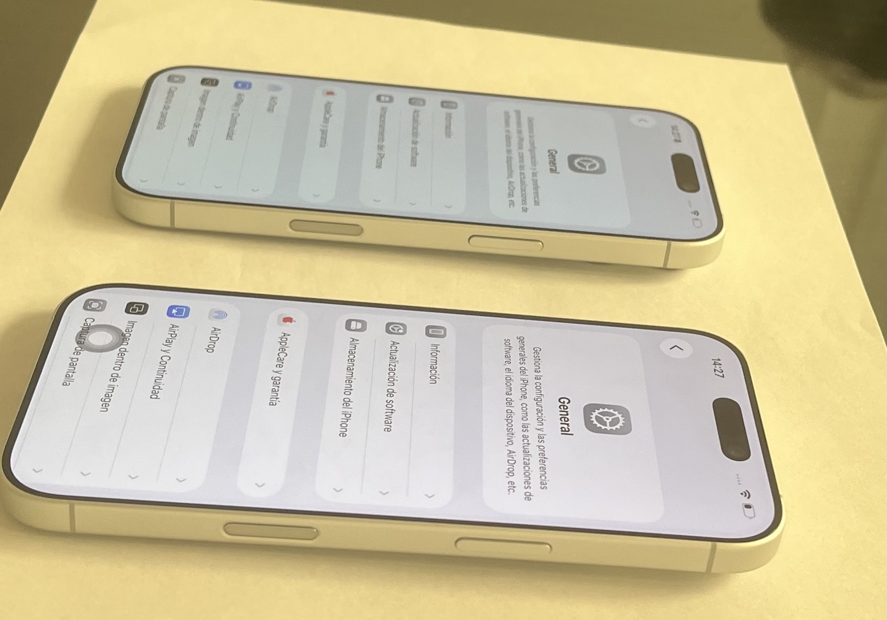

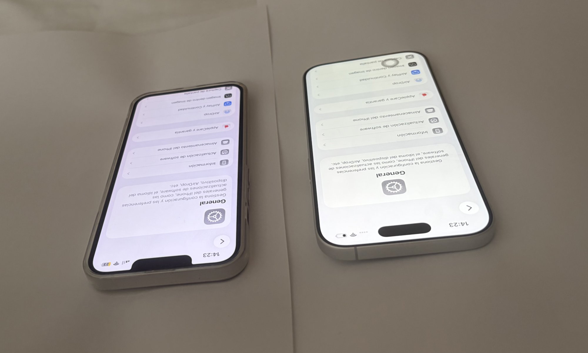

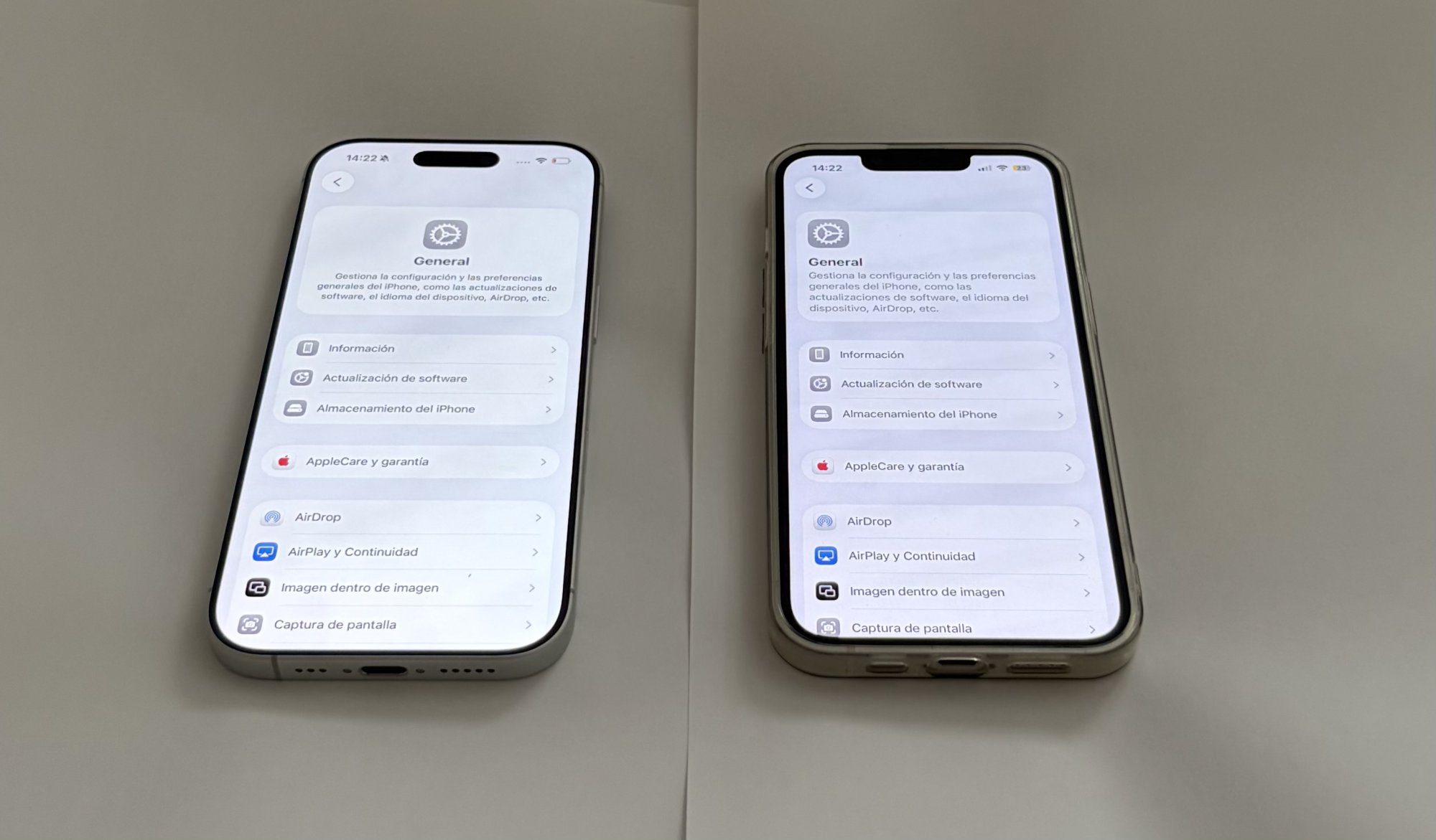

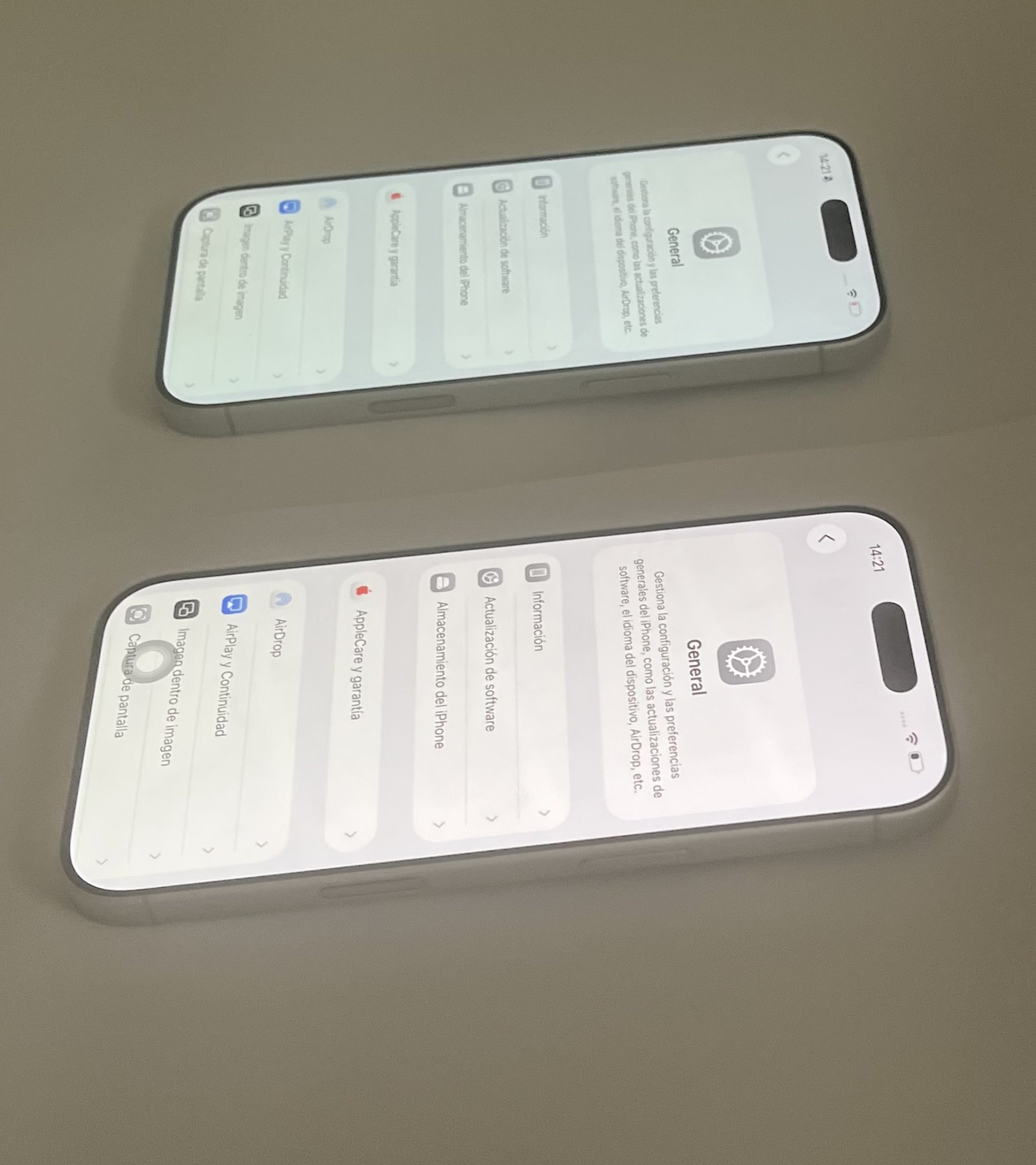

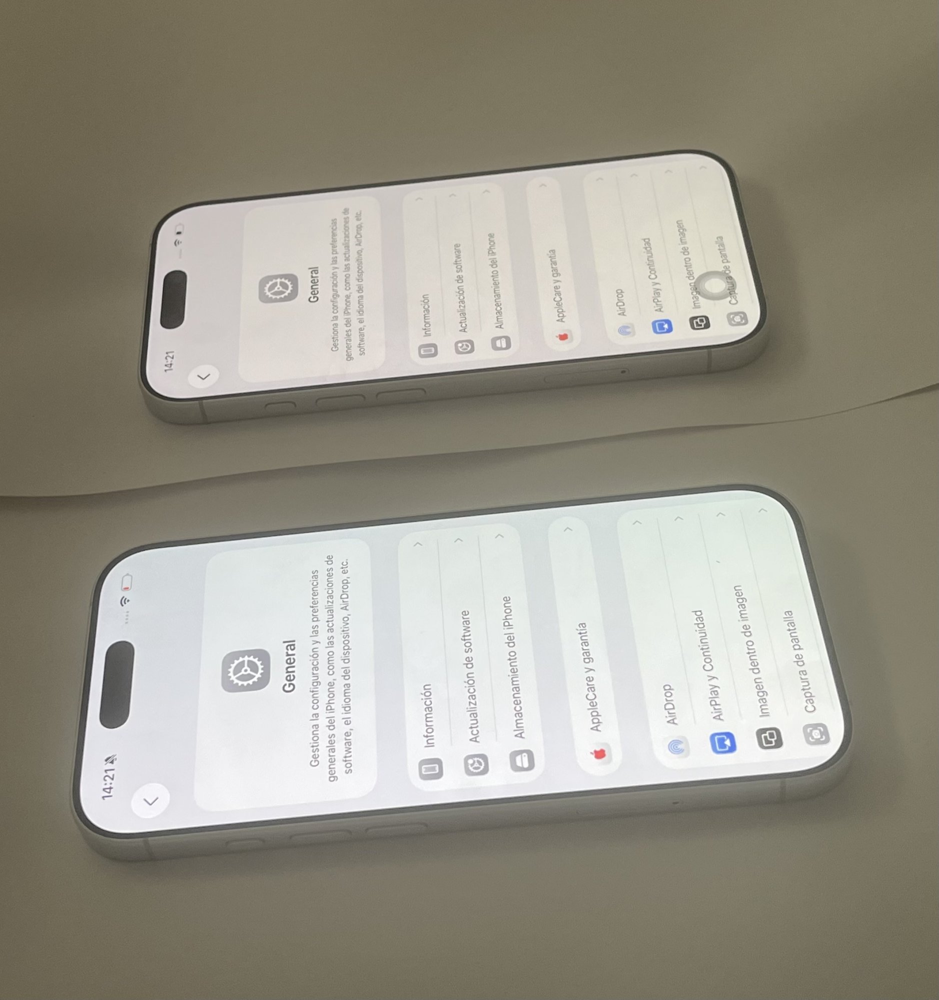

UPDATE:

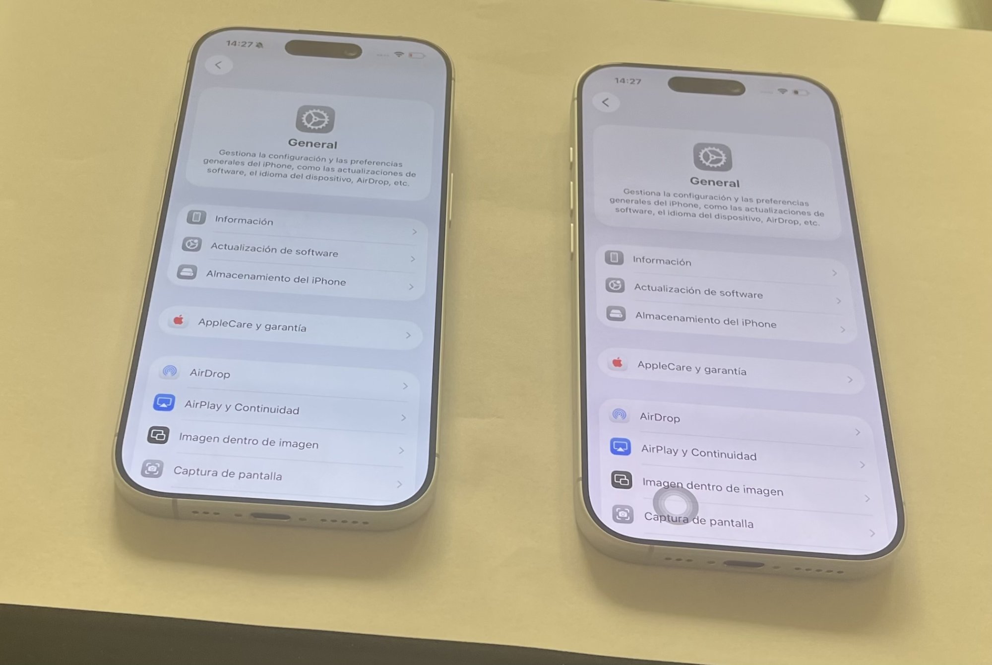

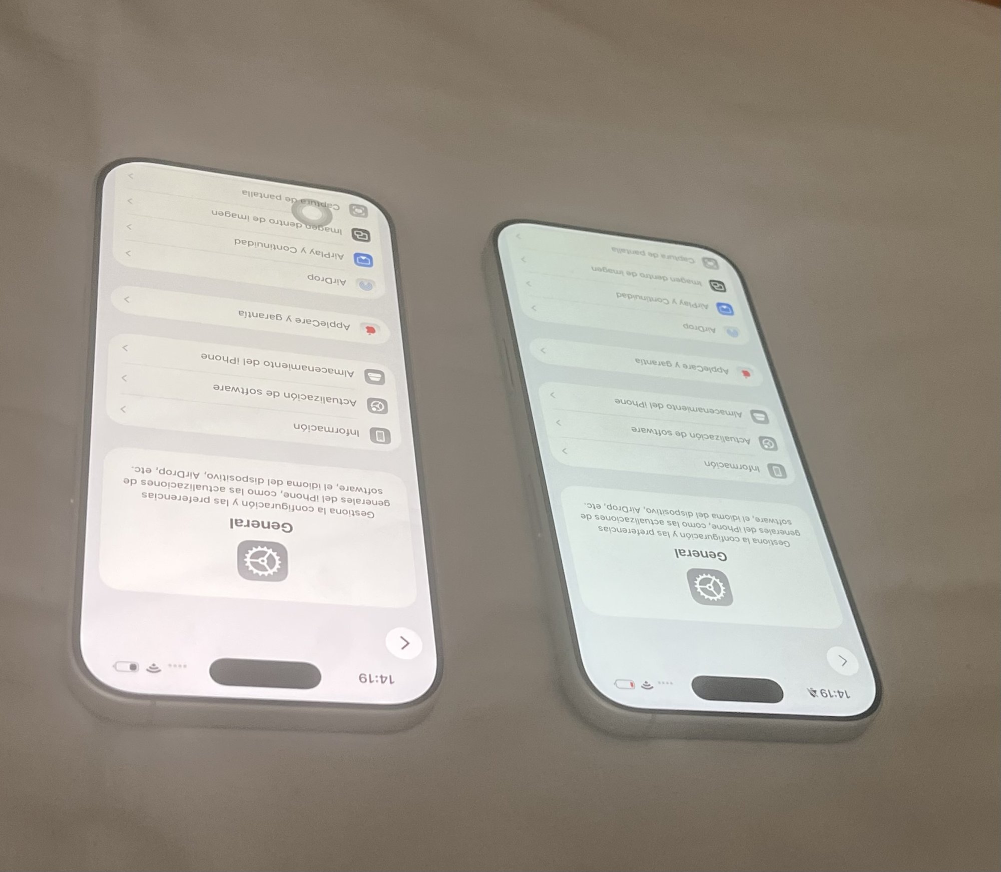

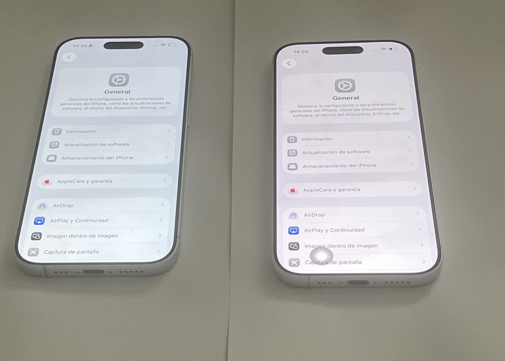

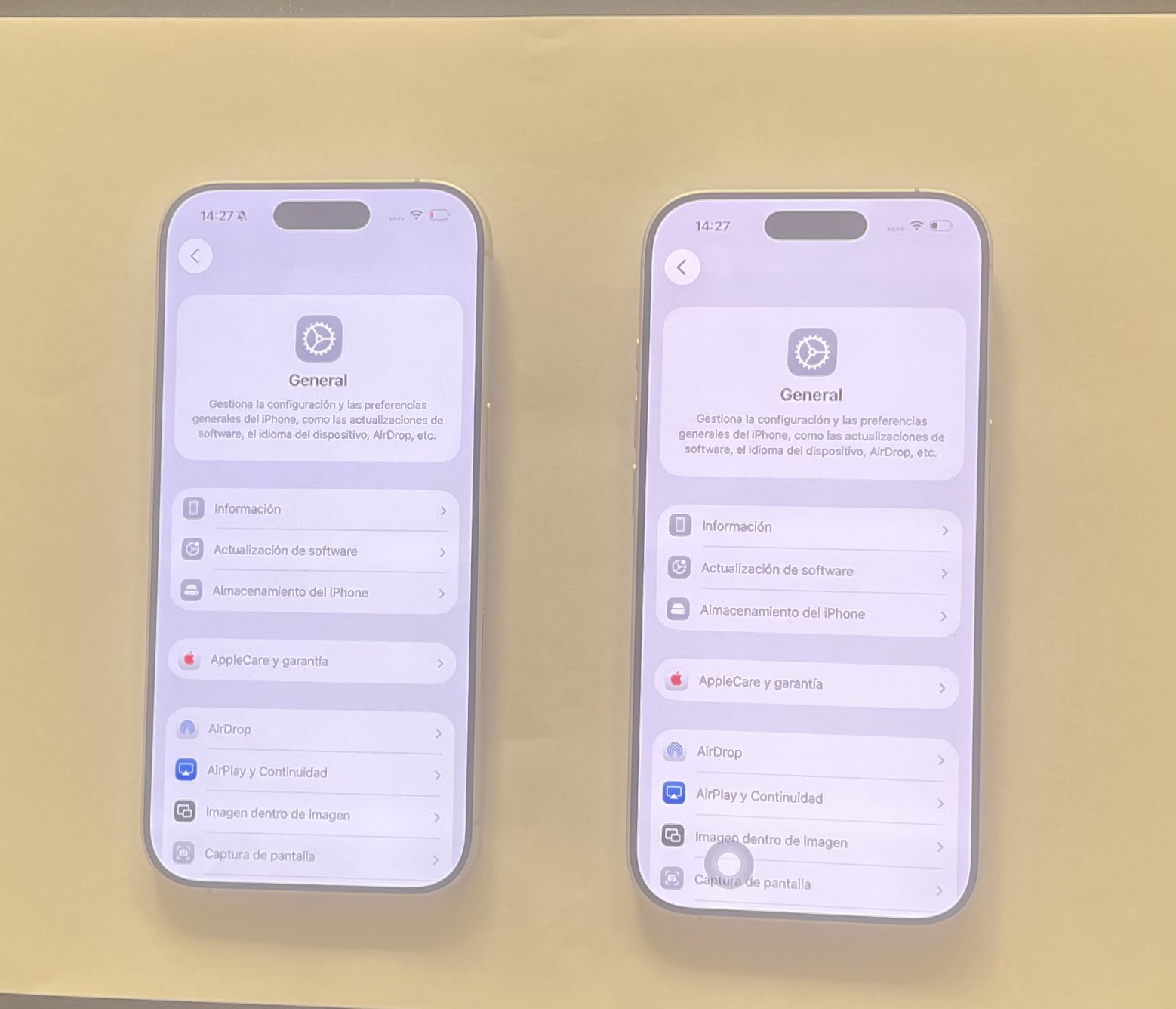

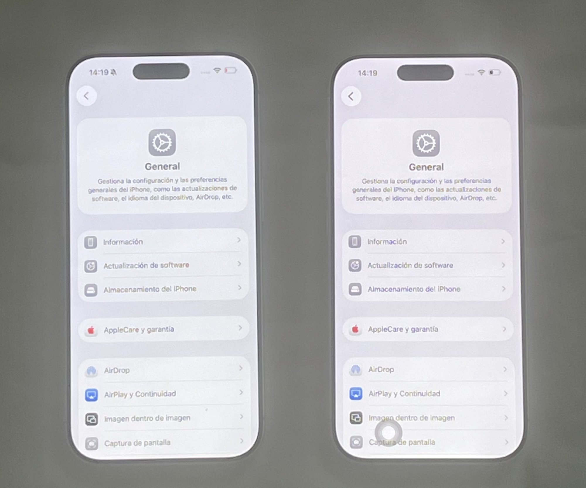

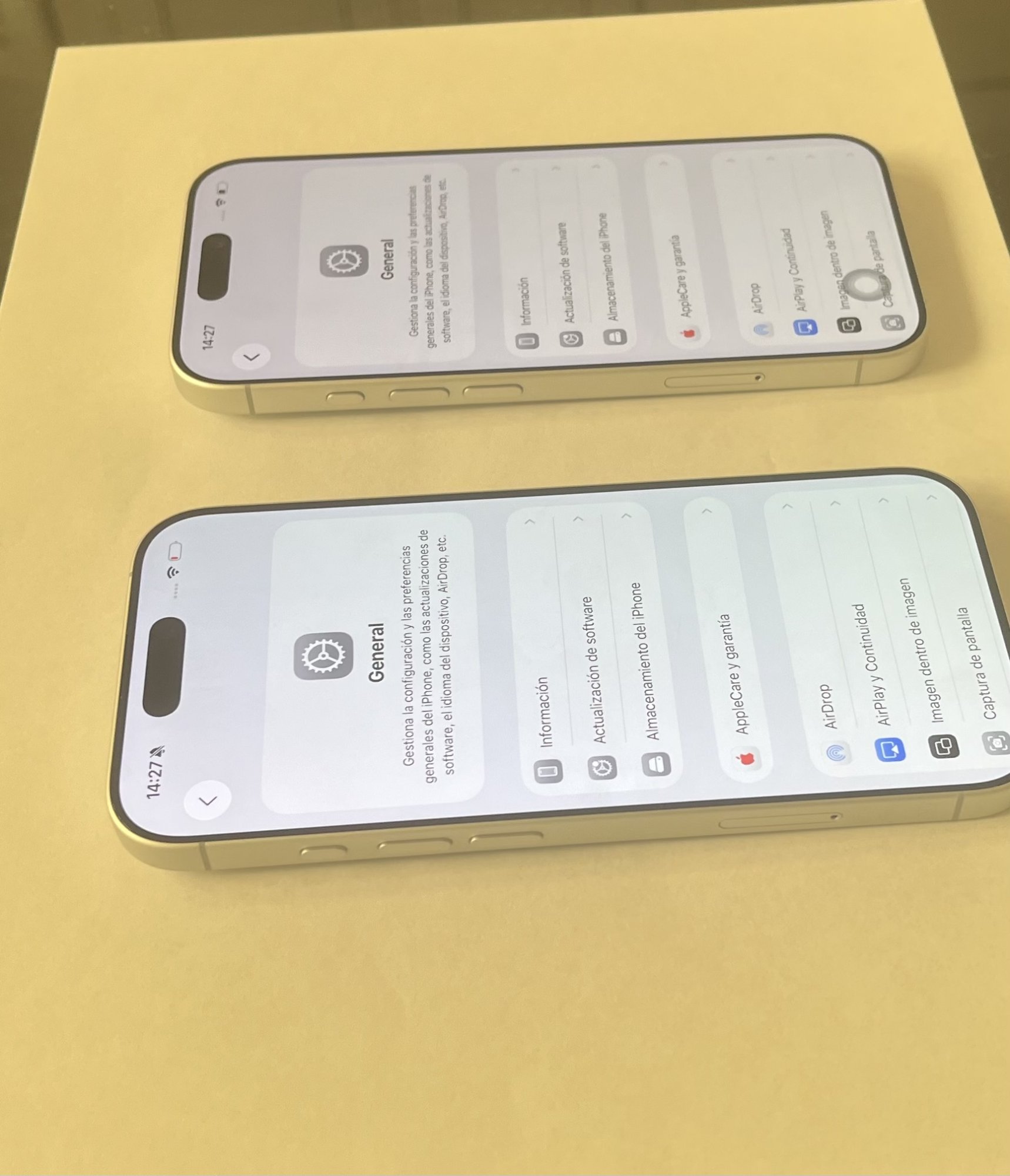

So.. now I have 2 iPhone 17 base, both GVC panels. It’s incredible how different screens are, even coming from the same manufacturer.
I have to choose between them 2. One has bad green tint but better resolution (no assistive touch), the other one has pink tint and bit worse resolution(assistive touch). Which one would you choose based on your experience?
** Bonus track: both compared to my iPhone 13 which has the best screen ever to my eyes. Whitetest white and no tints when tilting.
PS: Thank you all. I have never felt so understood in my life.
PS2: sorry for the photo dump. I’m very indecisive. Hope this helps other people too.

UPDATE:
For me the right one is really bad, because it has this ugly gradient from yellow at the bottom to a reddish tint at the top. The left one is warmer but it seems to be more uniform.

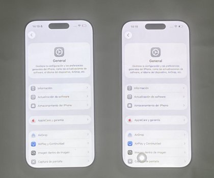

I find the iPhone with the red tint really awful. I've noticed that I still find such a red tint bothersome even after weeks (I once had an iPad with a red tint for a while). The other device looks okay at first glance. Warmer and more uniform.

13 it’s not perfect either, mine looks the same, but never realized it has a pinkish tone until I got this 17 pro. Yes, screen on the 13 pro is whiter, but if you look closer that white is pinkish compared with the 17 pro from picture 7/13. No screen is perfect at this point, we have to choose the one we like, that’s all.
Between the 2 iPhones you posted I prefer the left one, the right one is red. Also, do you have True Tone on?

No True Tone, no Night Shift.
