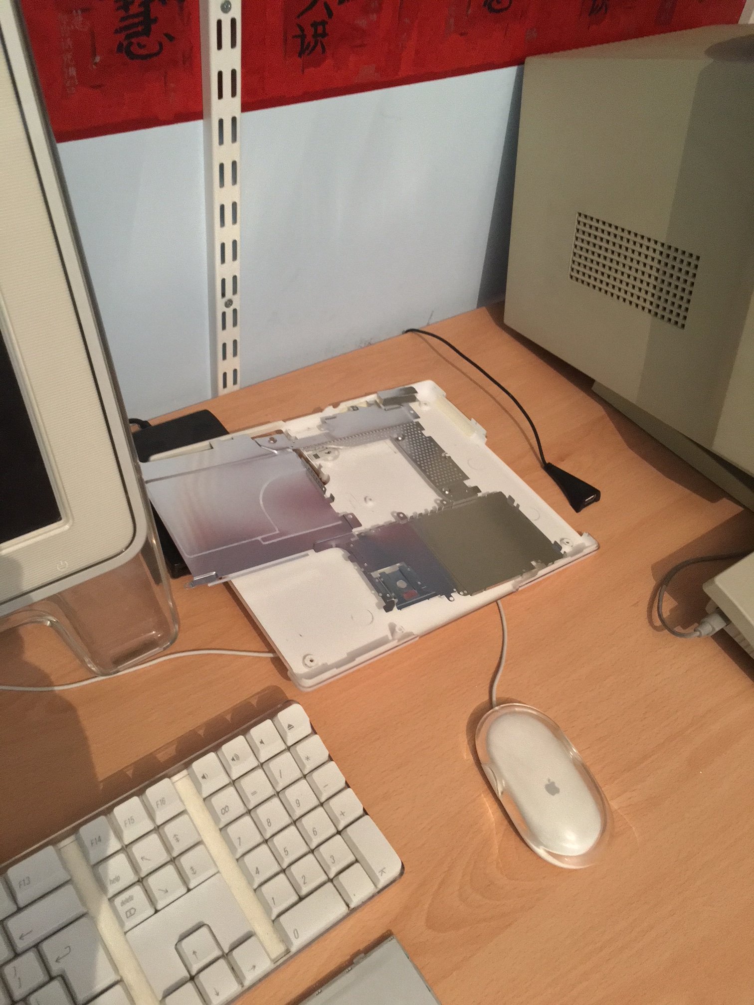

A while back the hard drive in my iBook G3 (700MHz) finally gave up the ghost. One day it just started clicking loudly and I got nothing but the flashing folder on boot.
I'd put off sorting it out but one day I spotted a compatible 2nd hand 60GB IDE HDD drive in CEX for €1 so I got it with the intent to replace. A while later again when I eventually go round to doing the job I was aghast to discover it wasn't as straightforward as I expected! I imagined it would be as simple as a 2011 MBP, just screw off the bottom plate and you're in. Boy was I wrong!
For anyone wanting to get an idea of how much of a pain in the *** it is to get to get this machine open you should take a quick look at the 😱 44 step guide on iFixit.

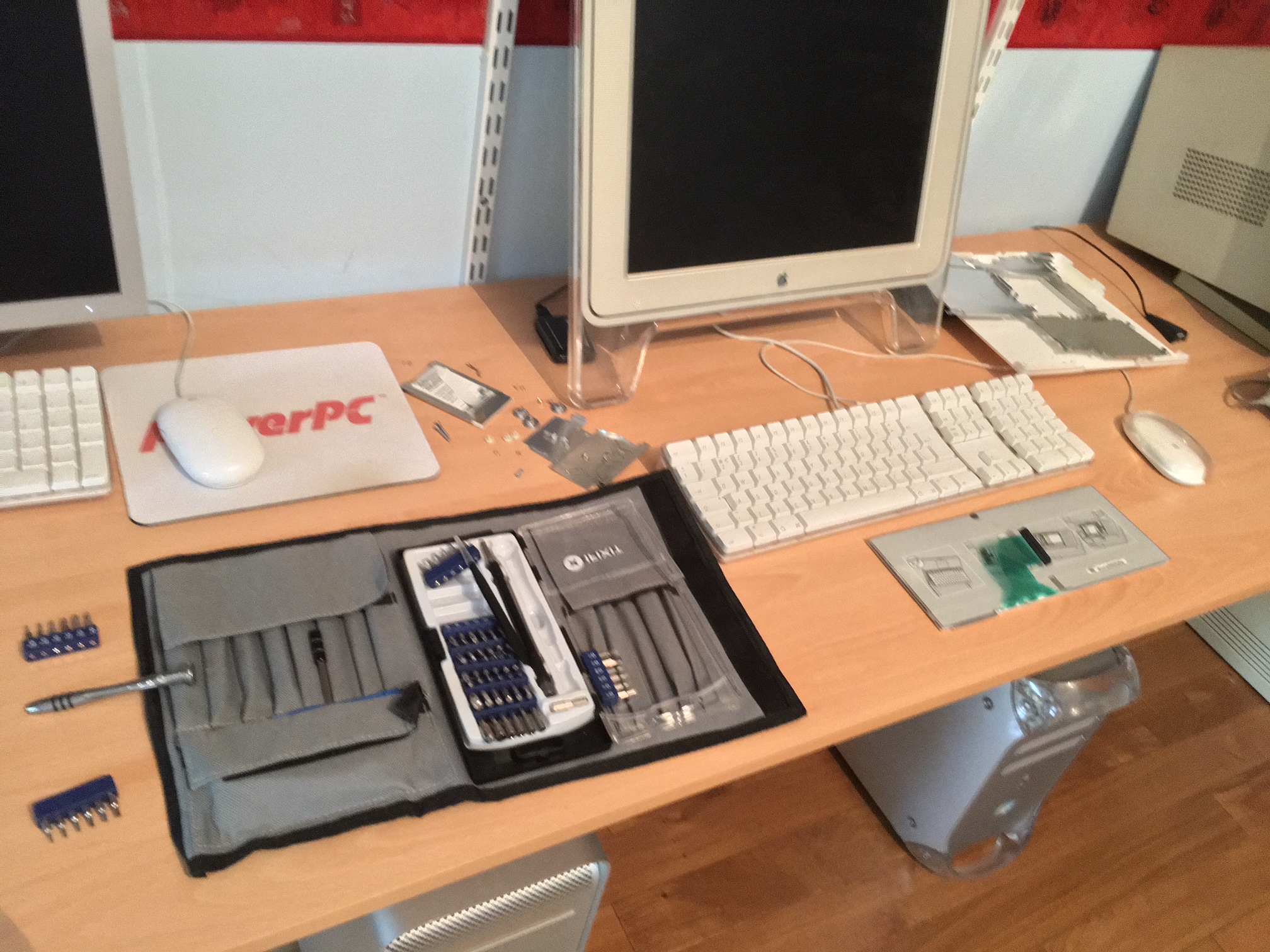

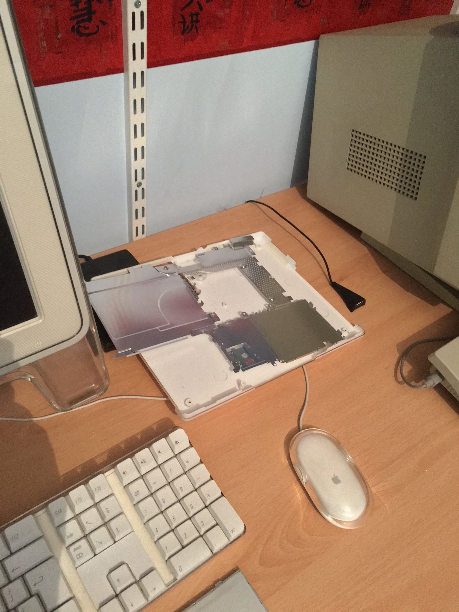

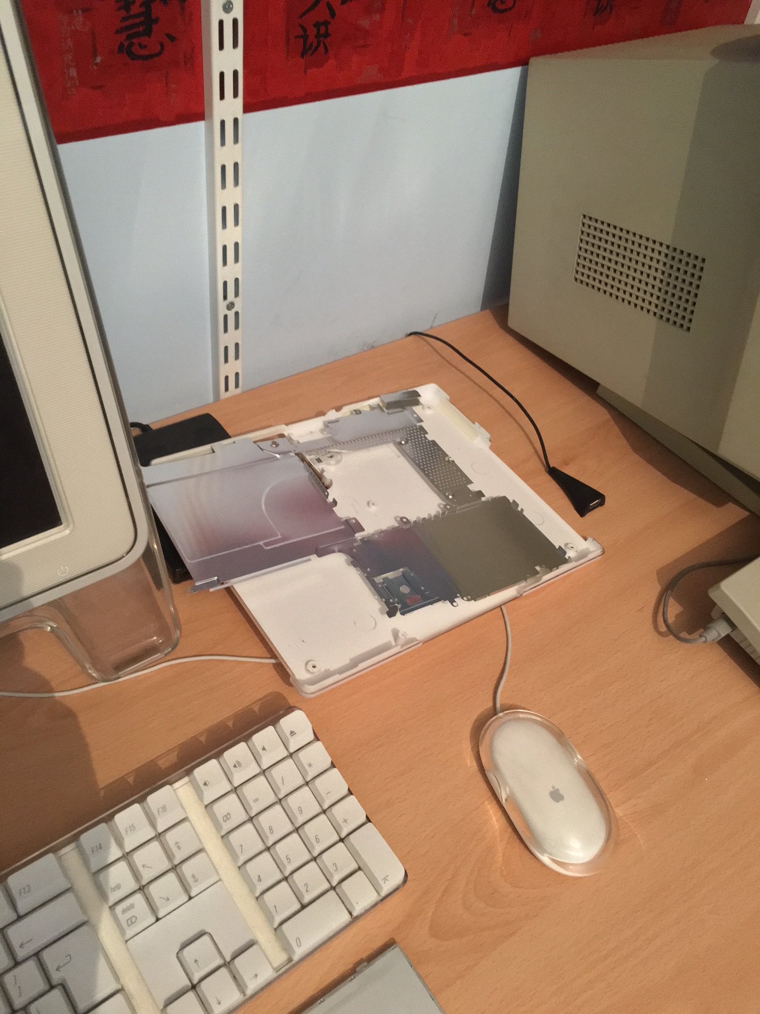

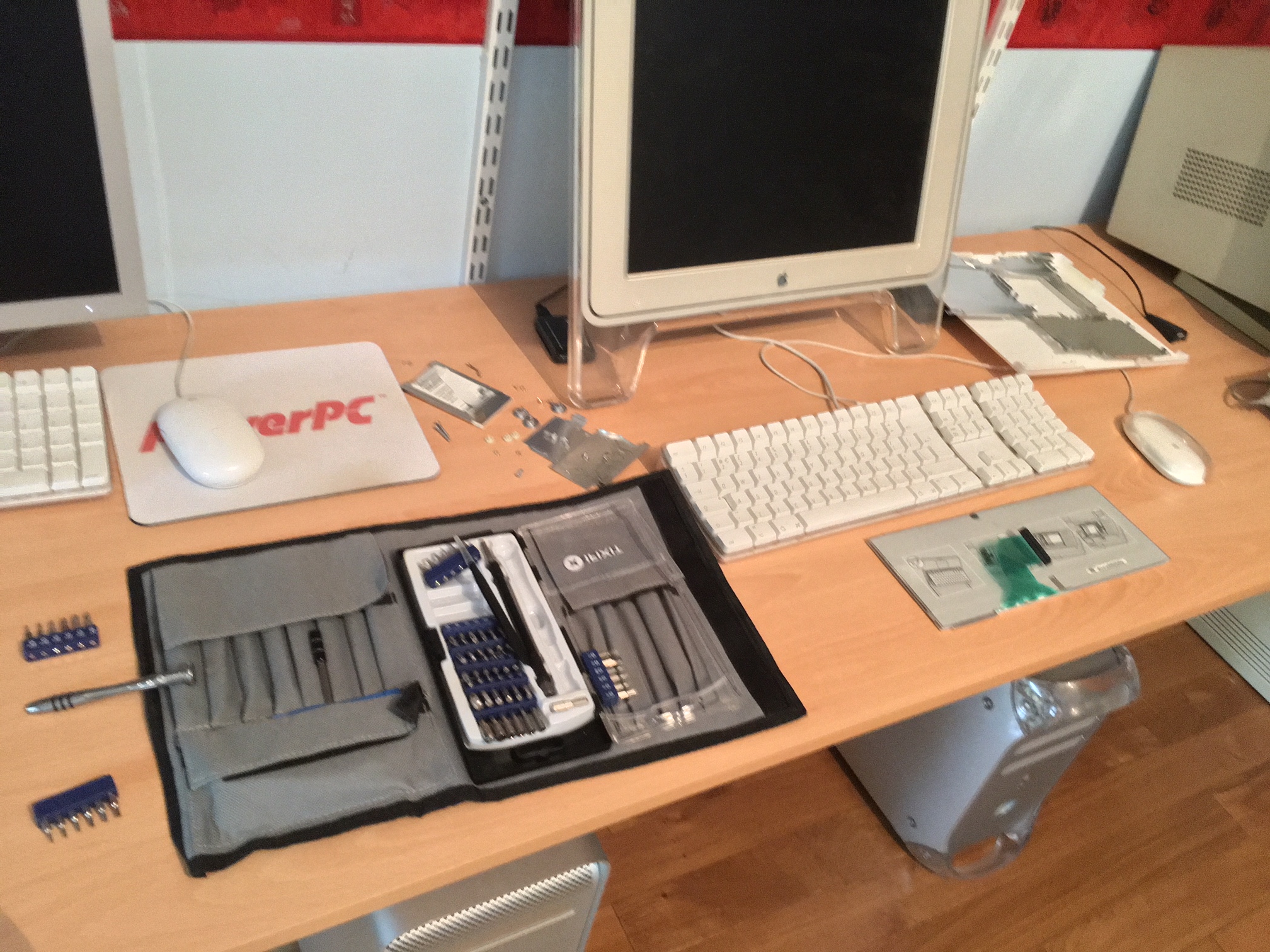

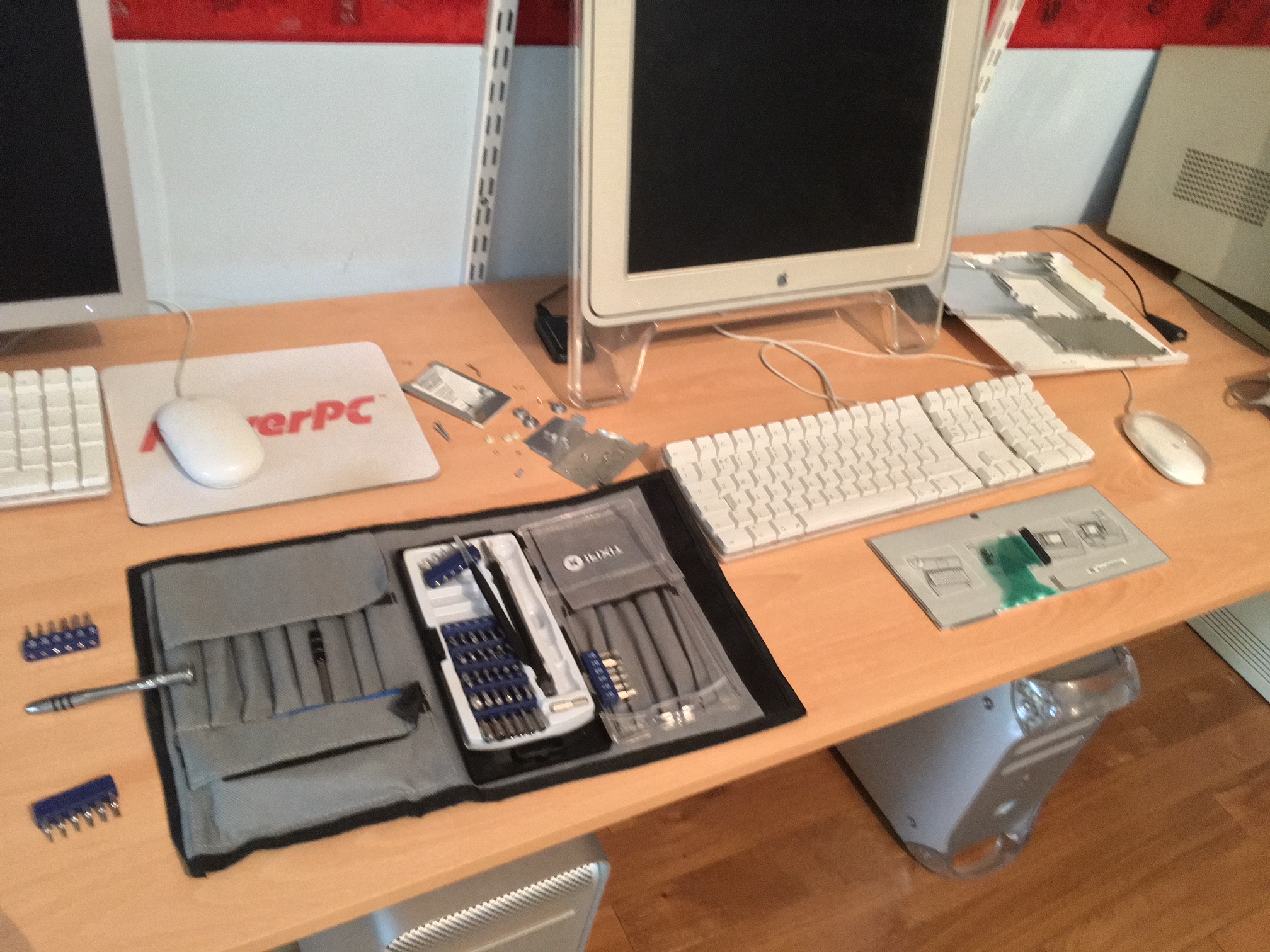

After a few hours of carefully slogging through far too many screws and scary plastic spudging without causing any permanent case damage, I got it all off.

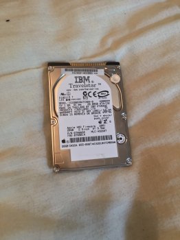

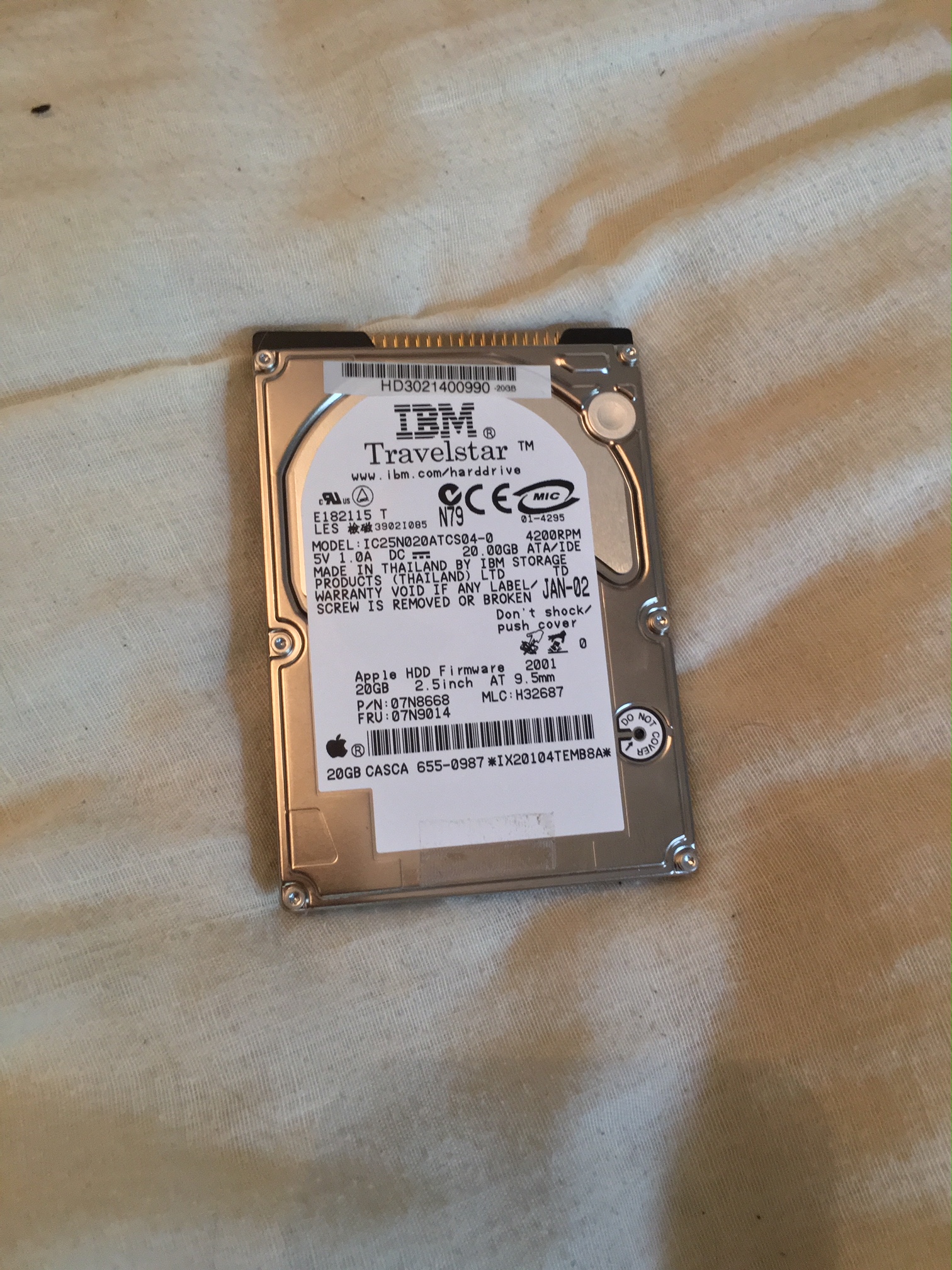

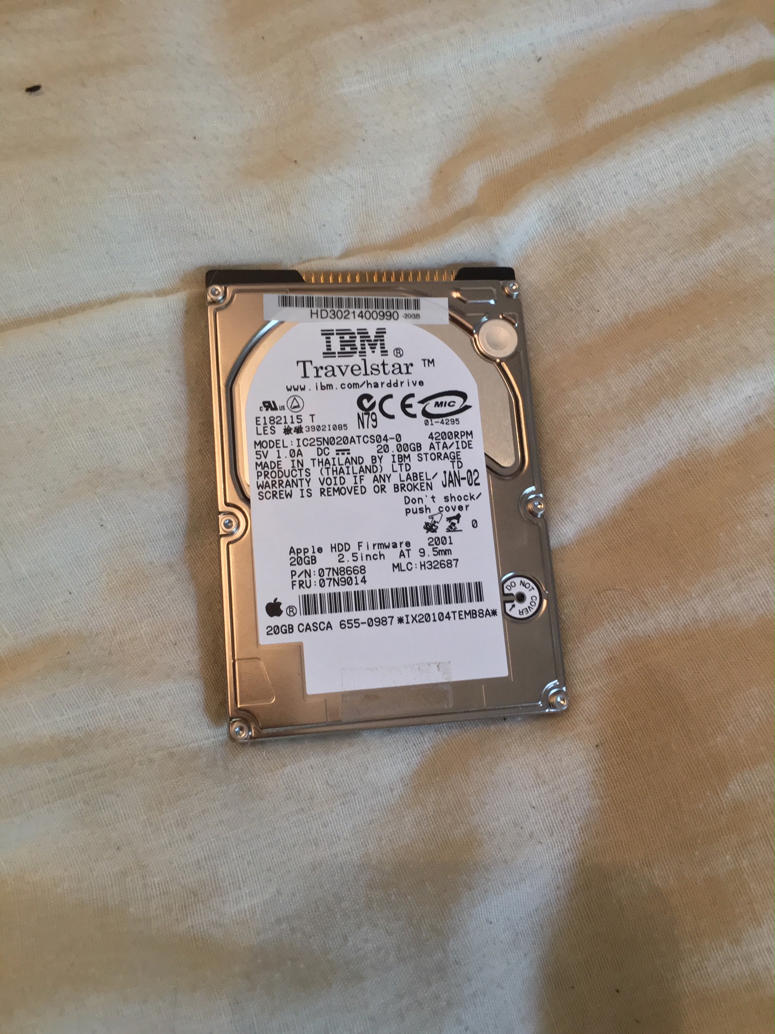

I managed to get all the way to the end and remove the culprit ageing original IBM drive. It did well to last this long in fairness.

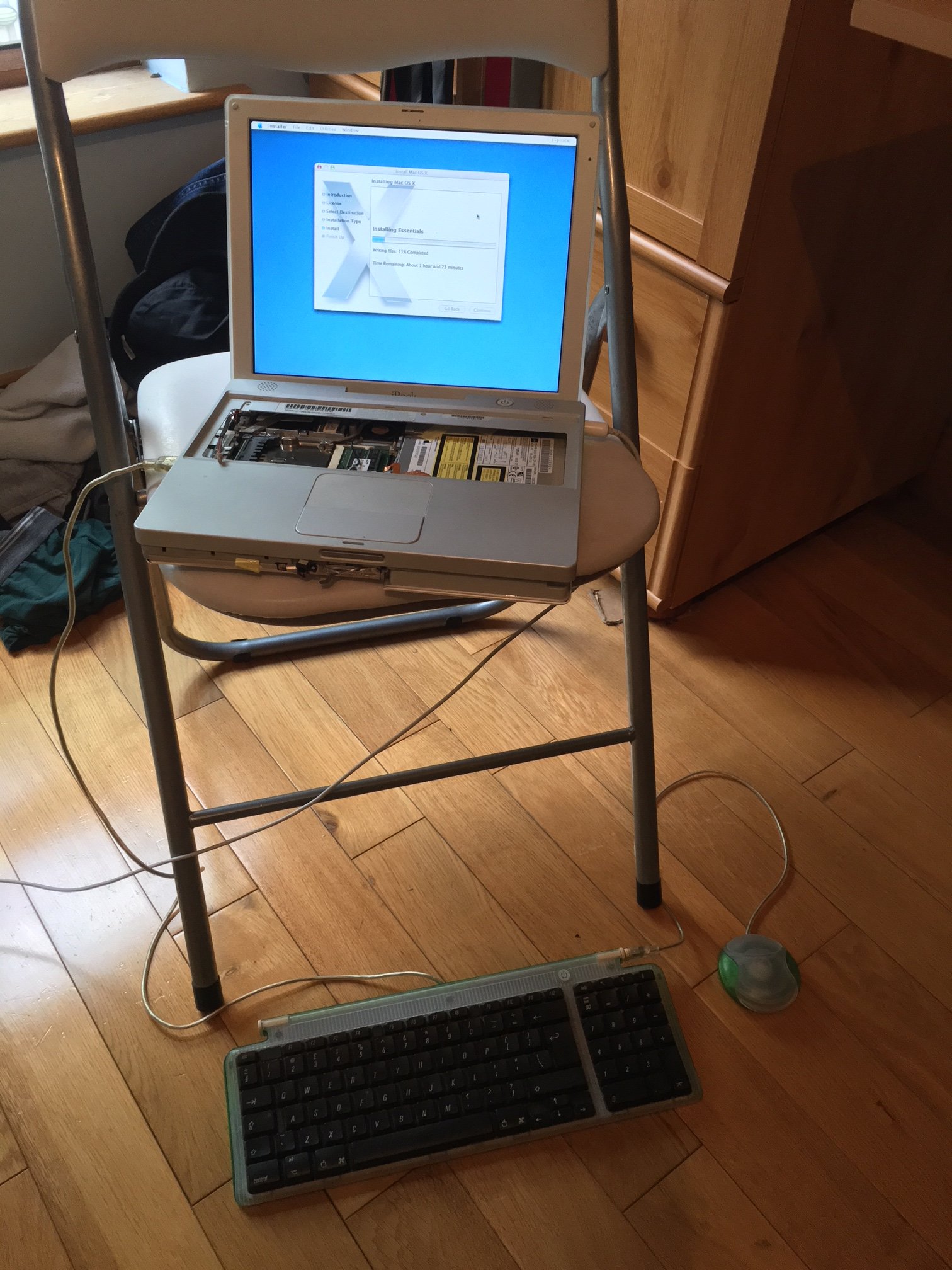

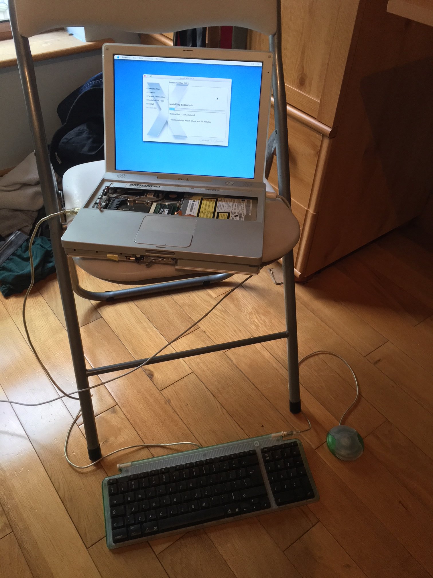

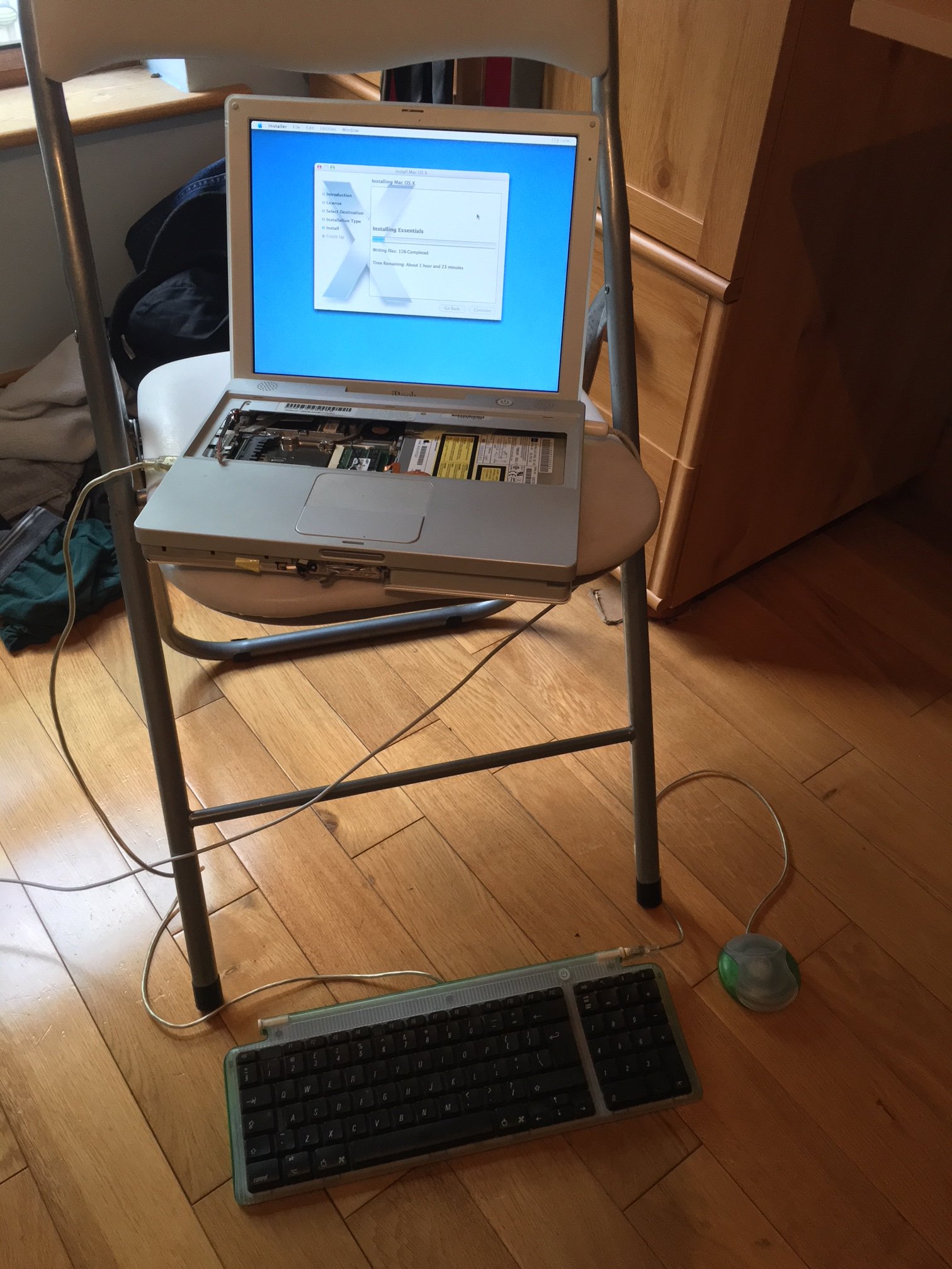

I then carefully slotted in the new Hitachi 60GB drive. I wasn't going to go reassembling it all to find out there was some problem so I left it dangling with the bear minimum needed to get it running. Didn't bother reconnecting the trackpad or keyboard so I just hooked up an iMac G3 hockey puck mouse and keyboard to see if the Tiger install would recognise the new drive.
And success it did! I then set about doing the 4 CD Tiger install to make sure it was definitely all working fine. I wanted to be 101% certain before locking up Jony Ive's best attempt at Fort Knox once again. I can't believe this level of design awkwardness was necessary. Did they has an arrangement with a steel company to fit in as many screws as possible?

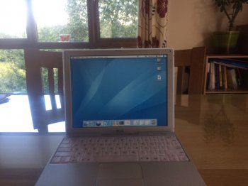

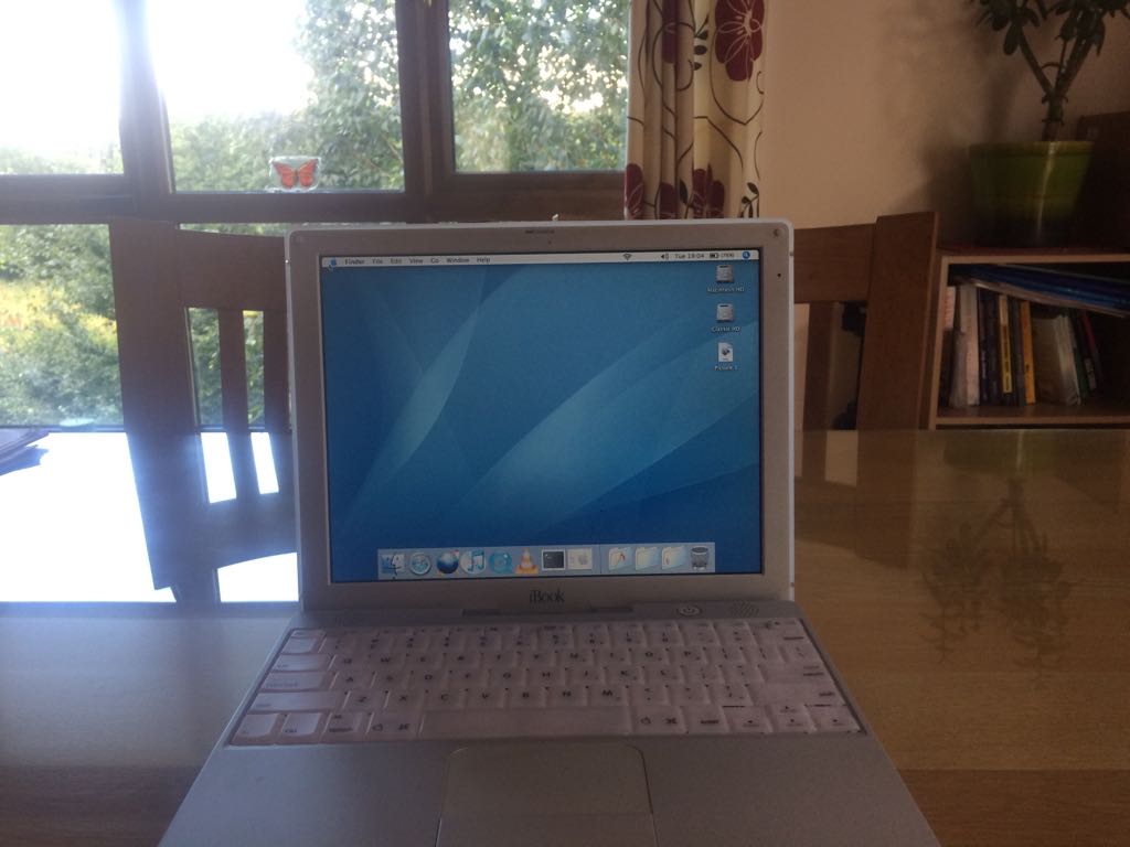

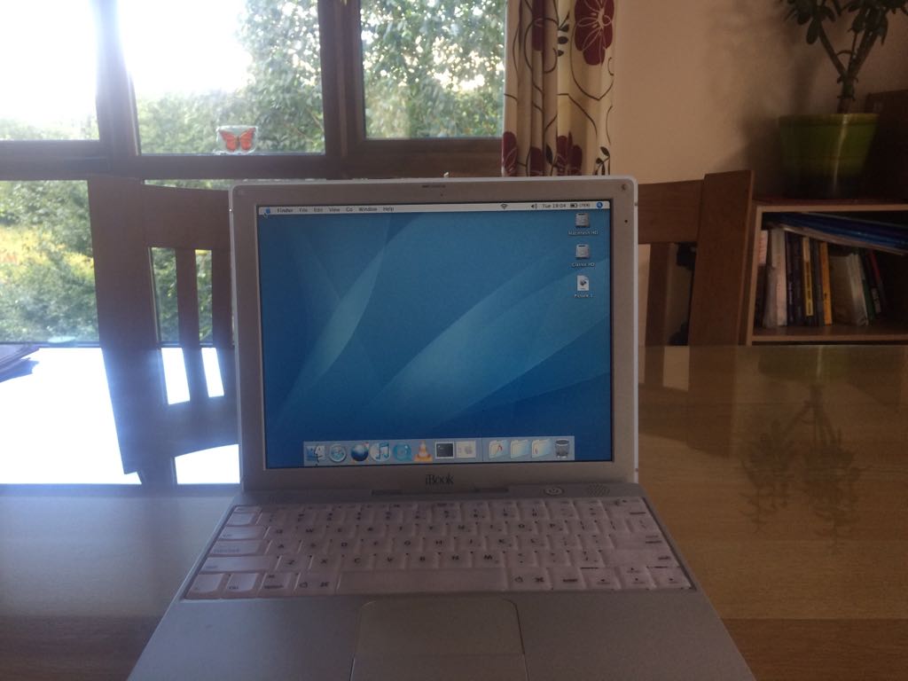

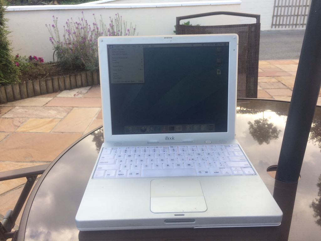

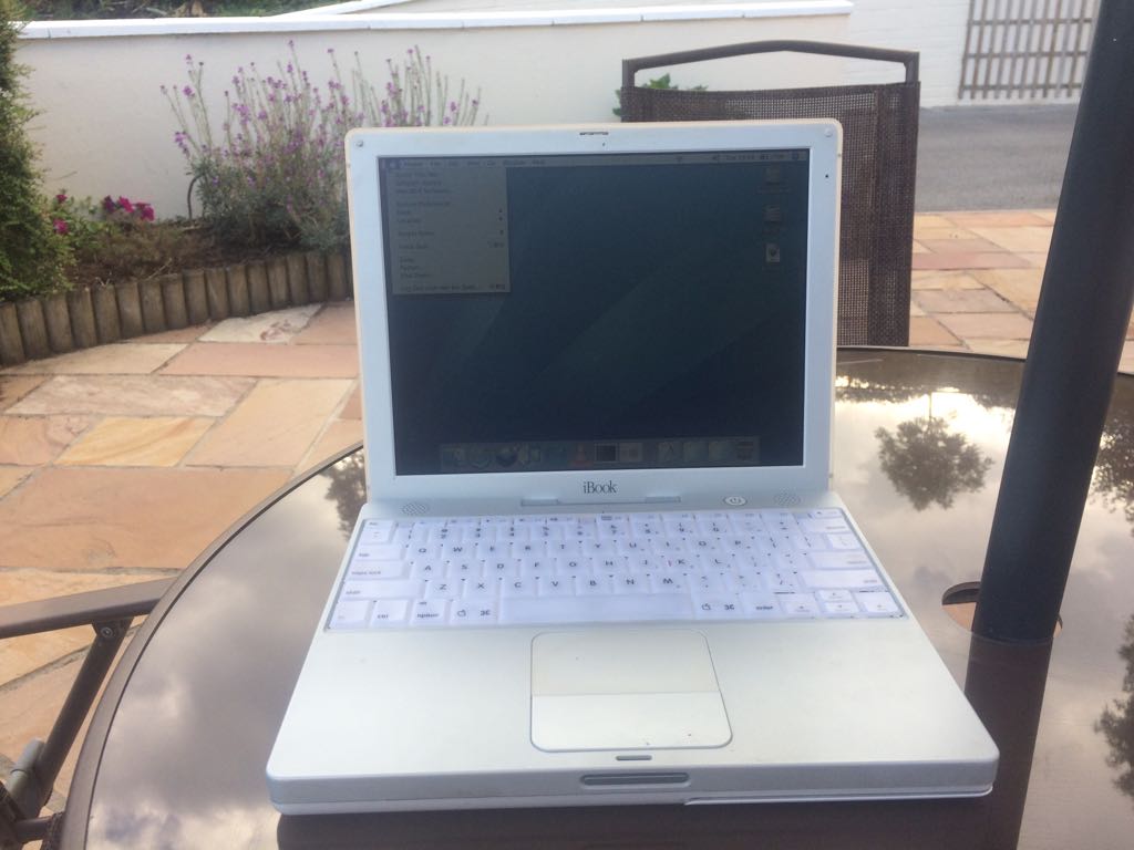

After several reboots for Tiger and Java updates the thing was back to mint condition. I gave 40GB to OS X and the remaining 15GB or so to Mac OS 9. Might install some old games like AOE II on it. Might seem funny to put all this effort into restoring a laptop I got on eBay for €1 with a "new" HDD for the same price, but with these old things it ain't about the bottom dollar!
