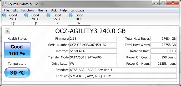

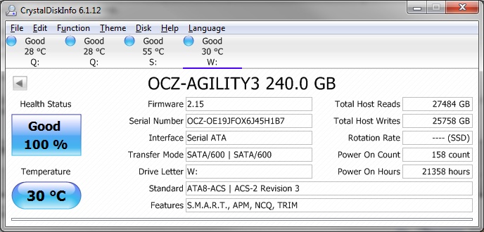

I have commented on the Angelbird SSD before:
While I don’t know for certain, I am pretty sure that these SSD’s are fooling the Apple Trim driver by identifying themselves as APPLE SSD’s. If so, it is quite a bold move by Angelbird, seeing as Apple could change this mechanism, essentially leaving Angelbird’s customers with a product that does not work as advertised.
I would imagine and am surprised that Apple haven't took countermeasures yet either legally or via software updates - iirc didn't Blackberry try to mimic an iPhone device to fool iTunes into thinking it was an Apple device ages ago?

LOL, and only coincidentally does it prevent a very useful feature from working on SSDs that weren't purchased from Cupertino.
Other modern operating systems which support TRIM simply check to see if the drive reports that is supports TRIM. If the drive says "yes", the OS enables TRIM support on the drive. End of story - no special drivers, no security issues, you have TRIM if the drive says that it can handle it.
Only Apple restricts TRIM support to drives purchased from Apple.
....though if Apple do not relent by sticking third party strings in the AHCI stack I would love to have Samsung and Crucial utilities to change mine...
In other OSs it's not done by having a list of drives that support TRIM - the drive reports that it supports TRIM in a "get drive features" API..
