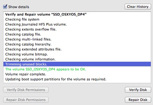

In other words, how is this verified?
Boot to Mavericks with Trim enabled.
Mount the Yosemite file system
Open disk utility and select the Yosemite partition
Click the repair disk function
Watch the progress on the log window
Notice at the end of the log, it reports "Trimming unused blocks"
Realize that trim is working, otherwise it couldn't "Trim Unusd Blocks"

MactheFork, I think one way to look at it is that when you boot 10.9, and mount the 10.10 volume... 10.9 owns it as long as it's mounted (the fact that it's also bootable is irrelevant) and 10.9 will TRIM the 10.10 volume if you delete anything significant from it or Repair it. :)
crjackson2134
macrumors 601
Mar 6, 2013
4,823
1,948
Charlotte, NC
Exactly correct, and well put.
