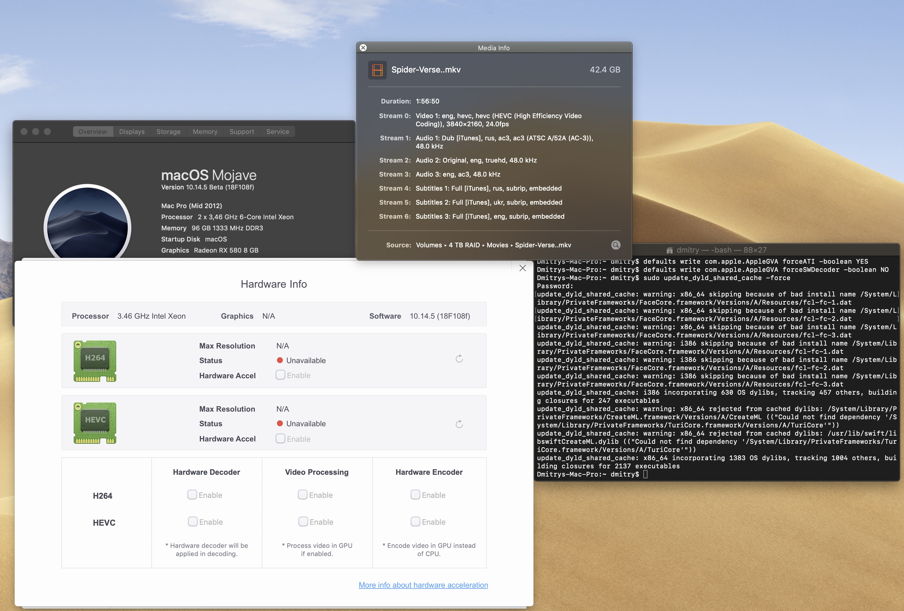

For me it does not work — VideoProc doesn't detect anything new. 4k HEVC movie playback is still super laggy.
defaults write com.apple.AppleGVA forceATI -boolean YES
defaults write com.apple.AppleGVA forceSWDecoder -boolean NO
sudo update_dyld_shared_cache -force
REBOOT
It doesn't change anything for me.
Airplay mirroring still shows only black screen.

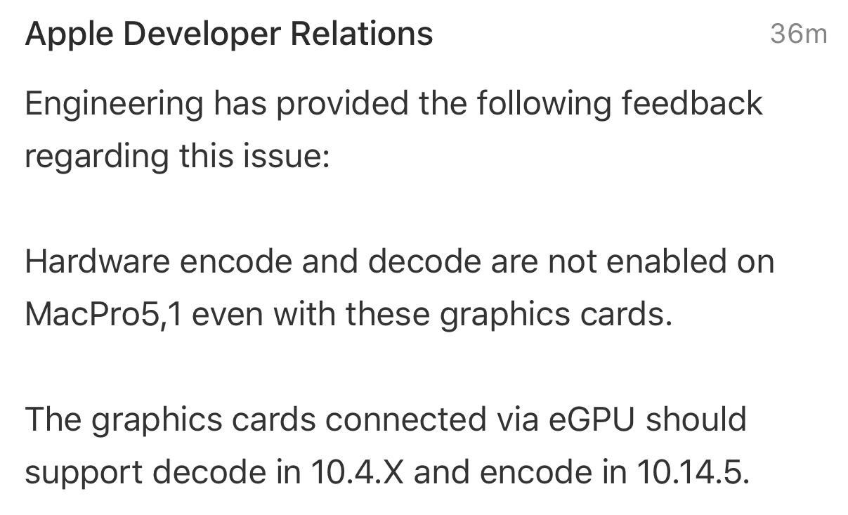

Just get this from Apple
So again, they artificially block 5,1 using GPU video acceleration.
MattyStonie’s screen capture has Intel Power Gadget running, which means, it shouldn’t from a 5,1, but more likely from Hackintosh or eGPU from other Mac.
In this case, everything still as per Apple’s script. Everyone can use video hardware acceleration except genuine classic Mac Pro users.
But the good news is that we know the function is there, just how to activate them.
Maybe overwrite the kext with the 10.14.0 version? The blockage must be inside the kext. The info related to the cMP same as the bootcamp installation for Windows 10 is blocked inside the plist file.

That's pretty disgusting.. you loyal Mac fans who held onto your cheese graters, no hardware encode or decode for you!
Not even if you upgrade to an RX580 like we told you to!
Get with the program and buy a new machine and eGPU that we halfheartedly provide support for

Videoproc still shows no HW decoding support
4K youtube video shows HW decoding support from Chrome (screenshot attached)
What program do you recommend for the Sony vid? (used mpv in the screenshot but seems to use both cpu/gpu?)
https://imgur.com/a/nBpIxIX
