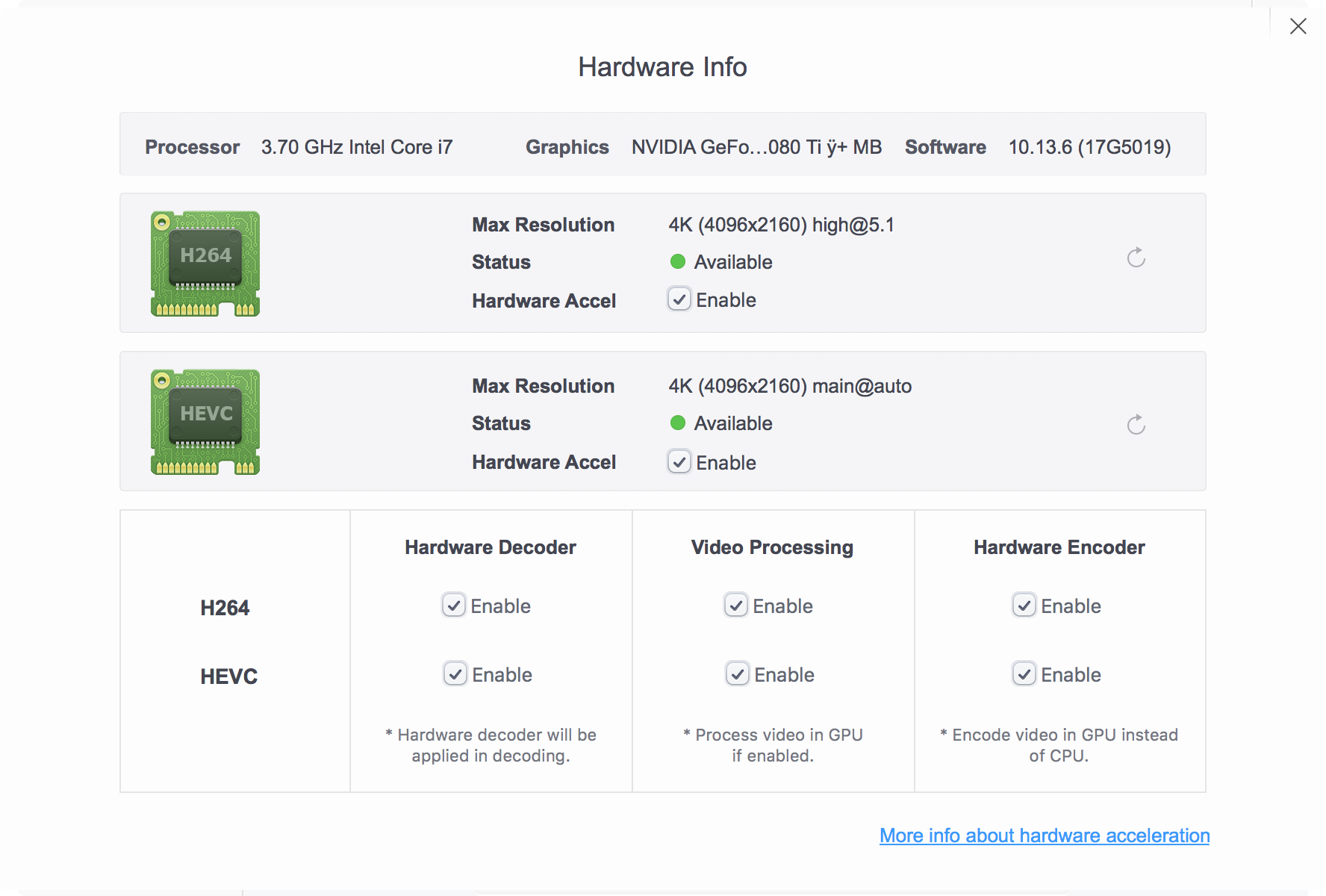

Since I found the guy from pcbeta.com managed to have full HW acceleration on his i5-9400F build with 18E2034 Mojave using iMac19,2 SMBIOS (source). I wanted to find out if it was also applicable for my Xeon build.
(As you can see from the snapshot, he has full HW acceleration, even though he is not aware of it. As he said, "I have no idea what HW acceleration is." in his post.)
My specs,
CPU: Xeon E3-1231 v3
GPU: RX580 Nitro+ 8G
Case 1:10.14.4 18E2034 + MacPro5,1/iMac19,1/iMac19,2
--> neither supports H264 nor HEVC
Case 2:18E2034 + iMacPro1,1 + AppleGVA.framework/AppleGVACore.framework (10.14.5 beta 5)+ AMDxxxxxx.kexts from 10.14.5 beta4
--> Both H264 and HEVC HW acceleration are fully supported. FYI, I was able to export render BruceX 5K in FCPX in the format of HEVC 8bit, while in 10bits, FCPX didn't utilize GPU (I assume a real Mac can also ONLY support SW HEVC 10bit encoding).
Case 3: the same as Case 2, (frameworks and KEXTs) but using MacPro5,1
Case 3_1: the same as above, but inserting MacPro5,1 key with the same property on iMacPro1,1 in AppleGVA.framework and AppleGVACore.framework
Code:
        <key>MacPro5,1</key>
        <dict>
            <key>allowFrameReordering</key>
            <false/>
            <key>hwe</key>
            <true/>
            <key>hwe420</key>
            <true/>
            <key>interlacedOff</key>
            <true/>
            <key>ke1</key>
            <true/>
        </dict>
--> In both cases, only HEVC HW acceleration is fully supported.
Case 4: Using MacPro5,1 (cMP) SMBIOS with iMacPro1,1 board-id: Mac-7BA5B2D9E42DDD94
--> Both H264 and HEVC HW acceleration are fully supported. Although this is easily doable on Hackintosh with a Clover flag, unfortunately, it might be not feasible on cMPs.
FYI, I have no issue in exporting HEVC from Compressor.
My specs,
Code:
        <dict>
            <false/>
            <key>hwe</key>
            <true/>
            <key>hwe420</key>
            <true/>
            <true/>
            <key>ke1</key>
            <true/>
        </dict>
Case 4: Using MacPro5,1 (cMP) SMBIOS, replacing iMacPro1,1 board-id: Mac-7BA5B2D9E42DDD94
Thanks for all the tests. May I know where you get that screen capture from? I read through your source link (just 2 pages), can't find that screen capture about hardware accel is working. (UPDATE: I just found that I have no permission to see the attachment because I am not a registered member, most likely that's why I can't see it).
And that RX580 on the screen capture may have nothing to do about the hardware accel. Of course, I hope that I am wrong. However, that screen capture means little at this moment.
e.g. On my Hackintosh, the hardware accel actually from the UHD630, but on that page, it shows 1080Ti as the graphic card. And there is no SMBIOS / board-id in the screen capture.
Of course, in your case, must come from the RX580, but you are using the iMac Pro info to achieve that, not iMac.
Anyway, it's good to know more about how the ident affect hardware accel. If I understand correctly, your case 4 proved that only board-id matters. As long as the board-id is Mac-7BA5B2D9E42DDD94, no other modification is required to get full hardware accel from the RX580. This is a very useful finding. But also sad you proved that all functions are already there inside the macOS, but just Apple artificially block cMP users to use it.
Also, may be we can start with your case 3_1. If we can make HEVC hardware accel work, still better than nothing. No H264 encoding still a very big deal on cMP, but lack of HEVC decode can be more trouble. H264 encoding eventually will be done, just a matter of time. But cannot play HEVC in real time means the video is not playable, and no alternative solution.
Not sure if OpenCore will do less (hopefully no) damage to the cMP's firmware. If that works, then we may still have a chance to ident our cMP at iMac Pro 1,1 to utilise hardware accel (without risking to brick the logic board).
