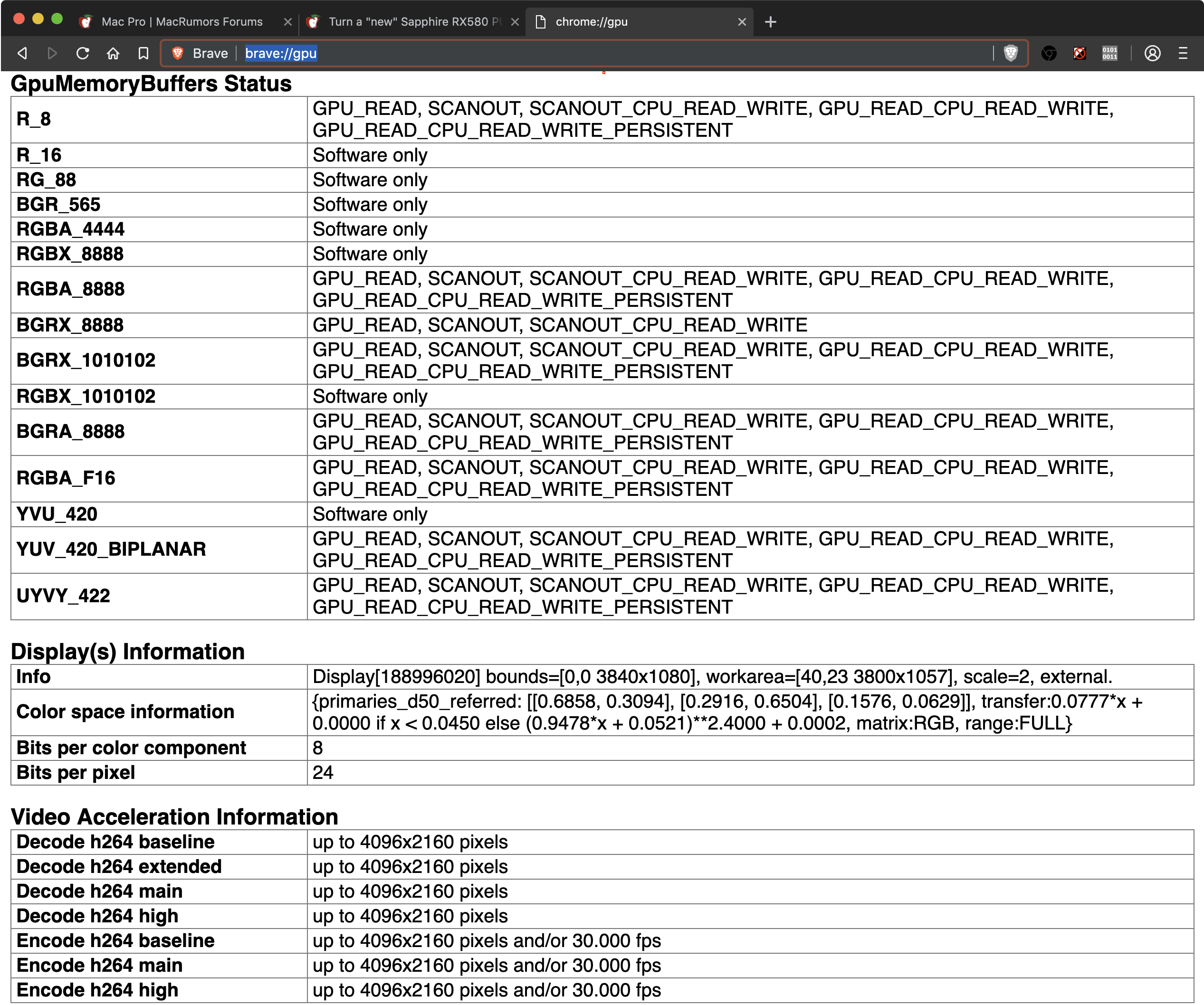

chrome://gpu/ and you will see what works and what not if you run Chrome
Interesting. brave://gpu/ also works
This is indeed eye-opening. Thanks.
[doublepost=1556906274][/doublepost]
Thanks you guys for those bleeding edge info. This is the first time I heard about this Brave browser thing. Do really treasure the breath of talents in this high quality community.

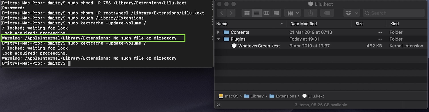

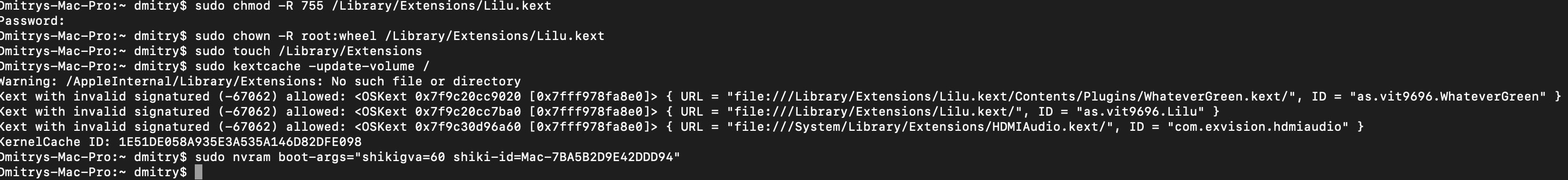

Command "sudo kextcache -update-volume /" doesn't work for me, it says:
/ locked; waiting for lock.
Lock acquired; proceeding.
Warning: /AppleInternal/Library/Extensions: No such file or directory
After it i entered "sudo nvram boot-args="shikigva=60 shiki-id=Mac-7BA5B2D9E42DDD94"", rebooted but nothing changed. Videoproc still shows nothing, Video Acceleration Information in chrome://gpu/ is blank.
Did i miss something?

Don't worry about that terminal return, that's not the problem.
You missed "step 5"
Thanks, it worked.
I put Plugins folder with WhateverGreen INSIDE Contents folder.
I entered all Terminal commands again (there were several "kext with invalid signatured" messages)

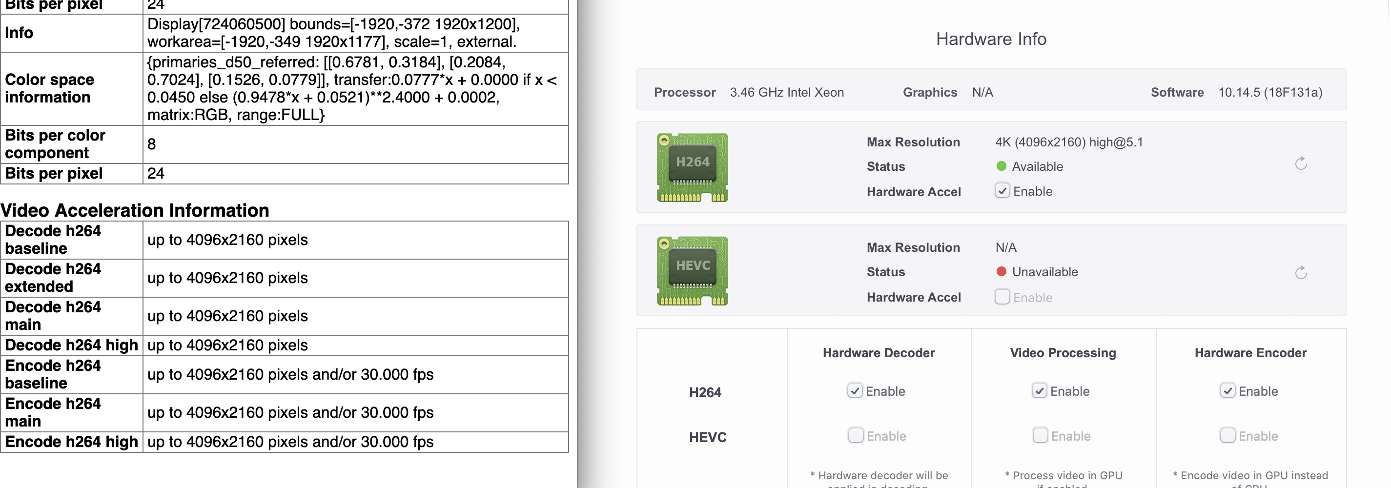

After reboot H264 HW works, but not HEVC
