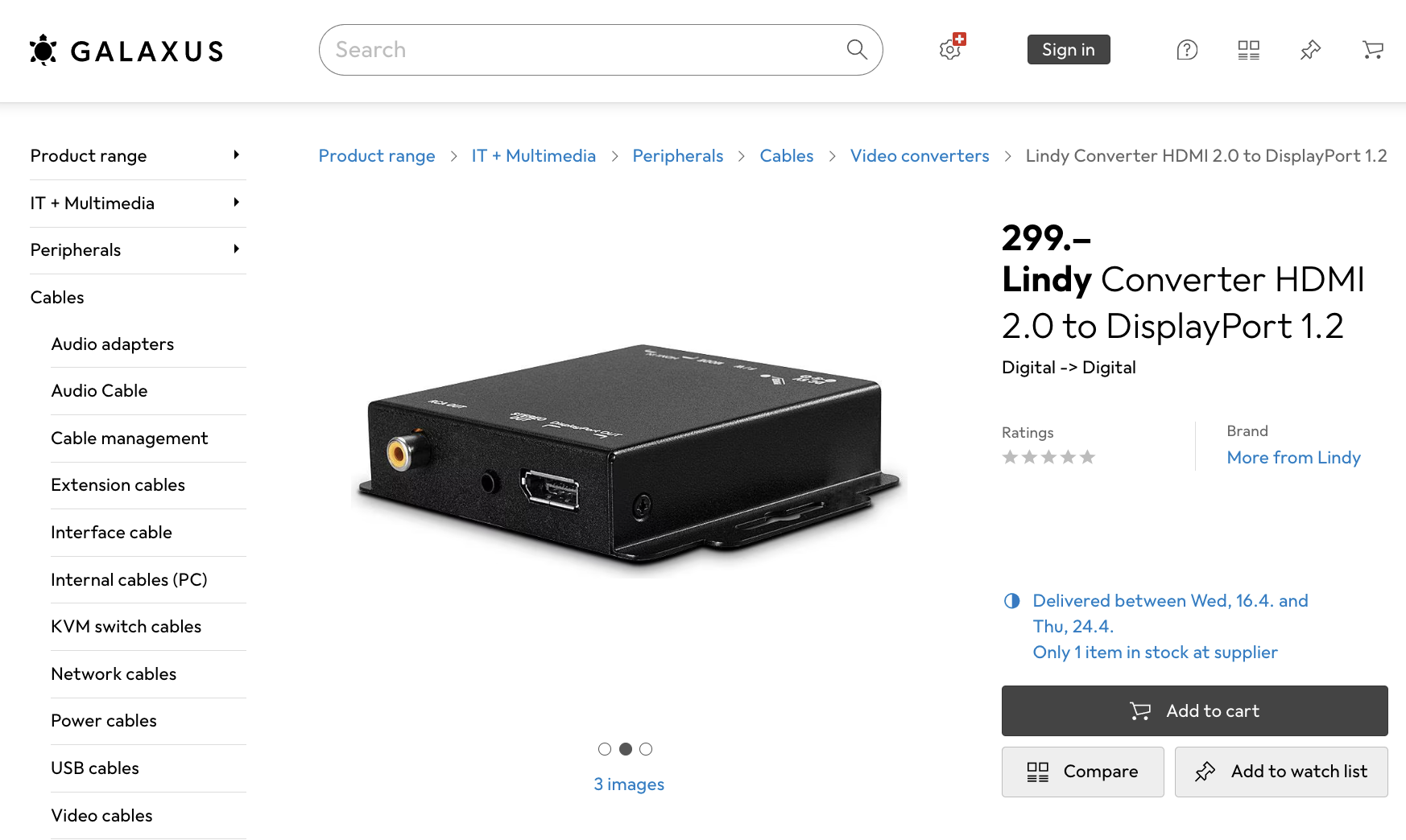

Any update on this topic? I’d love to get 4K & HDR from my PS5 Pro to the XDR display, but it seems that would need a HDMI 2.1 to DP 1.4 converter.
Since all the HDMI -> Displayport 1.2 converter products posted here are "out of stock".
I found this one (works): https://www.galaxus.ch/en/s1/produc...-12-digital-digital-video-converters-11219794

Is there one of these things that is DisplayPort 1.4 so we can have HDR?
