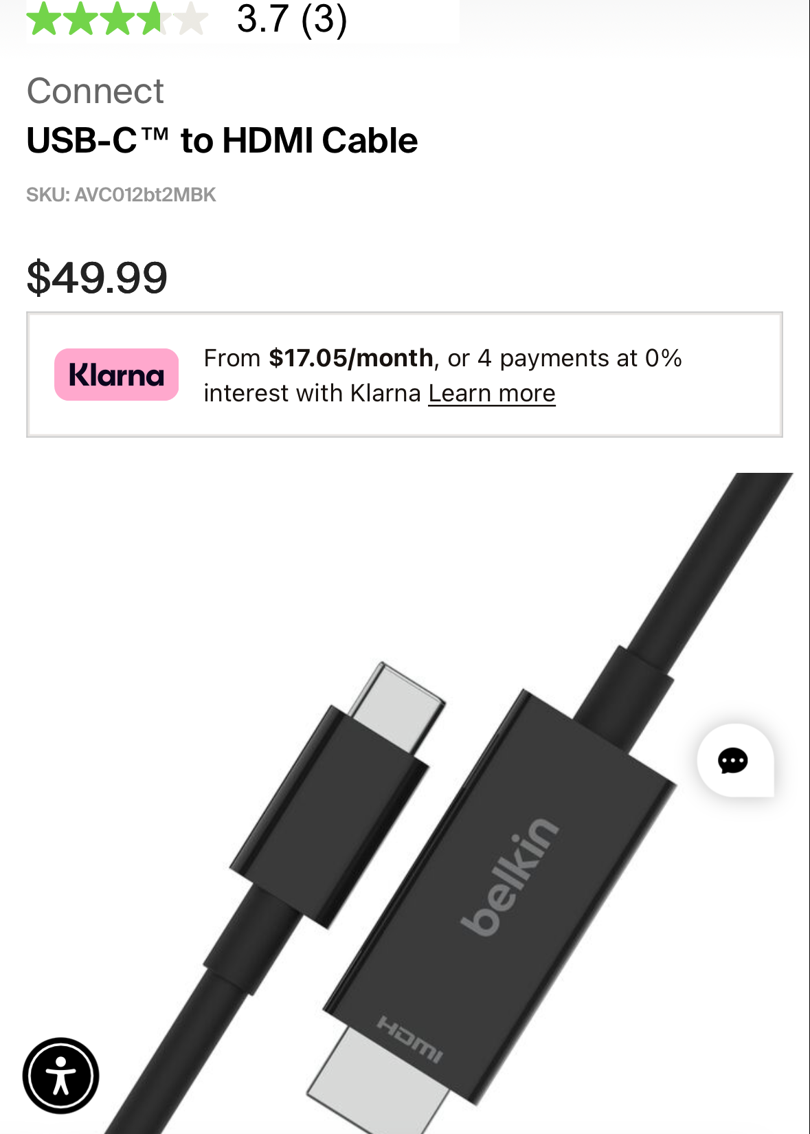

I'm giving it another shot and just ordered the Belkin Charge and Sync Cable that's supposed to work with the PS5 in combination with an HDMI/DP converter. Fingers crossed...
And it works! Only in 1080p though, the screen flickers when using 1440p. HDR looks fantastic!
One small step ..., small success on the road to victory🎥
To make sure, you have what exact config?
- Belkin charge and sync (as seen below)
- What else?
- What else?
My setup:
PS 5 Pro - HDMI/DP adapter - Belkin VR cable (https://www.vopmart.com/belkin-char...X7w9QAFwvJXcHDin0UHTKH14rhpWs19HNCjTigOMn890t) - XDR
These are the two HDMI/DP adapters I tried:
The DeLock 64213 (https://www.delock.com/produkt/64213/merkmale.html?f=s) and the StarTech 148B (https://www.startech.com/en-at/display-video-adapters/148b-hdmi-dp-8k). The StarTech seems to use a newer version (U3) of the Lontium LT6711GX than the DeLock, though both work exactly the same with the XDR.
