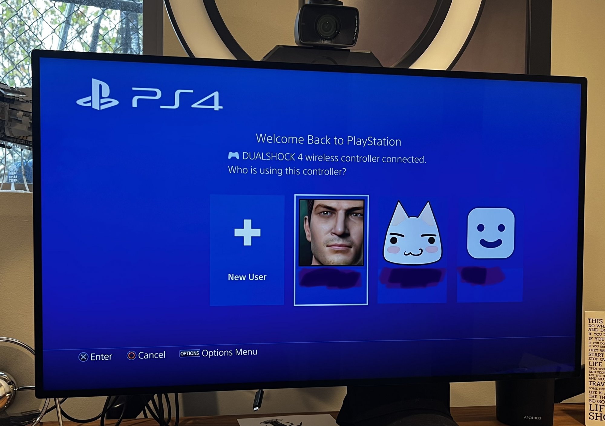

I have successfully been able to do this with my PS4 Pro, it should also work for the PS5 I hope, I’ll test that soon. (Edit: it also works for the PS5)
I used these to make it happen with the EDID set to green (4K 60hz).
1 GoFanco Pro-HD2DP HDMI2.0 to DP1.2 converter
2 Bi-Directional DisplayPort to USB C Cable
I've added this Thunderbolt 4 extension cable as well so I'm not having to get back behind the XDR display every time I want to swap inputs from my PS5 to my MacBook Pro. This should also help avoid wearing out that port for frequent swapping.
In addition, I've connected a stereo cable to the 3.55mm port on the GoFanco converter and connected that to a splitter to isolate the input into my 2019 MacBook Pro so I can pass through the audio to my airplay HomePods from the PS5 when also Quicktime's record audio function to just pass the audio through to speakers as a monitor.
While not the most elegant solution for the audio, it works. I'd like to find a way to use the higher quality SPDIF/Toslink but I haven't tried any of the potential converter options for that yet to get the audio into my laptop. Though it would be easier to connect it directly to a receiver or compatible speakers; I'm focused on using my two HomePods.
