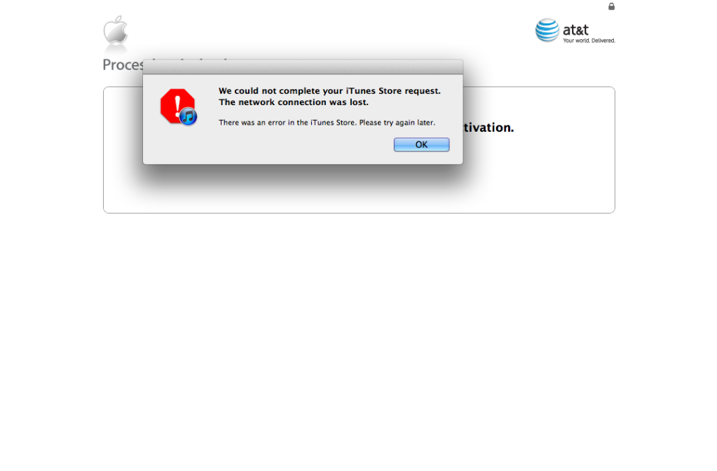

OK, then select the iTunes Store in the left pane and log in to your Apple ID, wait for the store to load and then switch back to your device in the left pane.
Dave
The timeout was iTunes trying to log into the iTunes Store without your ID information. Now you should be past that issue.
So you Apple ID is now listed in the top black bar when you select the iTunes Store in the left pane?
Also, I see two iPhones listed under your Device list in iTunes, you should not have but one connected when attempting activation. The original iPhone should be the only one listed and it should be "iPhone".

Ok i tried plugging this bad boy up to another comp i have, blank screen, im beginning to think its the iphone.
I went to AT&T and said they wont activate it at their store I had to do it using itunes at home or go to an Apple store.
So Im hitting a local Apple store later.
I tried 3 different computers, new sims and nothing.
Seems like mission imposible...

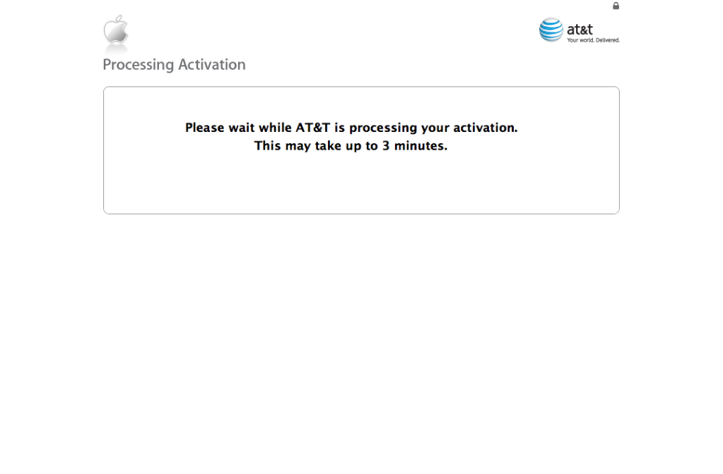

so update from last night
Like I said, the last screen(activation) kept freezing and timing out. It would constantly tell me to unplug and plug it back in and it would still time out. Eventually I'd get no errors and the screen would show up blank. I've tried and used an unactivated sim and a used sim, restoring, re-installing itunes, rebooting. Nothing would activate my phone rendering it useless. So i decided to call up ATT and basically tell them that I had already activated my iphone 2g(which was obvs a lie) and that for some reason the data plan still read 2GB instead of the unlimited 2g I chose when activating it. She told me that she'd be glad to assist me, she put me on hold, got her manager and BOOM, the plan was added. I thanked her and got off the line. Then i put the sim in my iphone 4s and called up again and told them i upgraded and needed to convert the 2g unlimited to the 4s unlimited. Again, they told me theyd be glad to assist me and within 2 min they were done.
I usually dont condone lying, but it worked. 😛
I hope that helps anyone.
