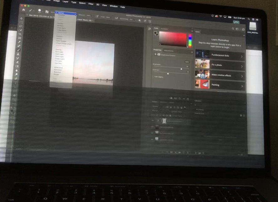

Anyone experienced any screen Flickr with Vega, I’ve only just picked mine up but have noticed screen flickers at random times. I’ve managed to video it a couple of times today. Below is a freeze frame from the video.
I have a monitor set up via hdmi and duet was also running. I will continue to test without the monitors connected.
Yes, there was another VEGA flicker thread. They replaced his unit.
Reactions: MacDonaldTrump
So, I think as far as I can tell, it may only be occurring when connected to HDMI. I could be wrong as it seems very intermittent, I can't seem to replicate it even trying the methods in the other thread you steered me to.
I did find it odd that it did not capture when taking a video screen grab (command/shift/5) it definitely flickered while it was recording but not showing on playback.
I spoke with apple and they suggested I try a smc reset and nvram (it just flickered again writing this) I keep trying to catch it recording on my iPhone.
Just not sure ill be able to reproduce the problem in store to show someone.
No issues with mine. Make sure you have high quality hdmi cable. This link will help you with that.
https://hackintosher.com/blog/bad-hdmi-dp-cable-can-ruin-4k-hackintosh-flickering/

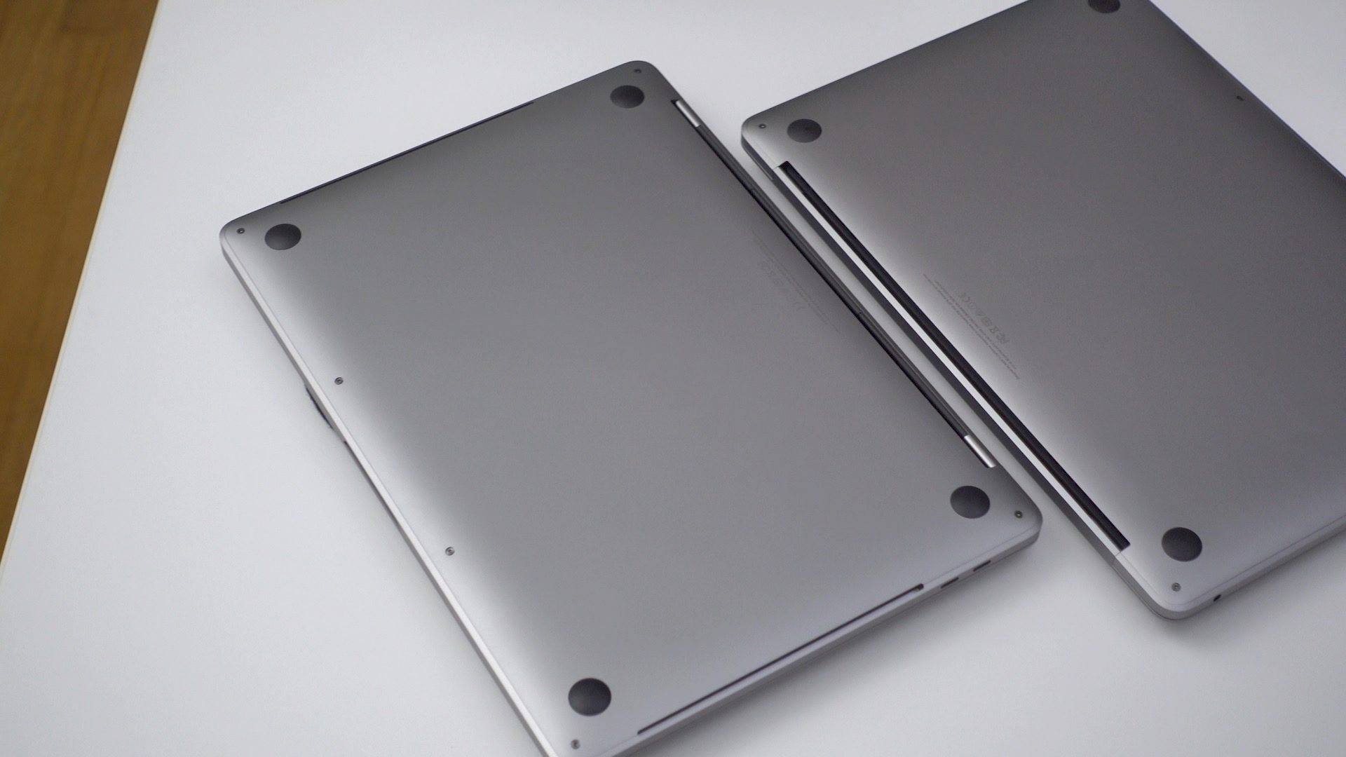

Both of those are false. MacBook pro is designed in such a way that airflow is not obstructed when you close the lid.
https://9to5mac.com/wp-content/uplo...k-pro-vs-macbook-pro.jpg?quality=82&strip=all
there's a gaping hole in the back.
the only thing that might improve the airflow is tilting it upward a little, but airflow is in NO WAY obstructed if you close the lid. There's no air going through the top. There's two vents and the sides and the main vent and the back, and the lid is designed so it directs the air in the right direction whether its closed or opened.

The monitor connected via HDMI is not flickering, it's only the retina that is showing issues. It's a good quality cable.
Okay, yeah, that would be different then. Some have had this issue and got theirs replaced I believe.

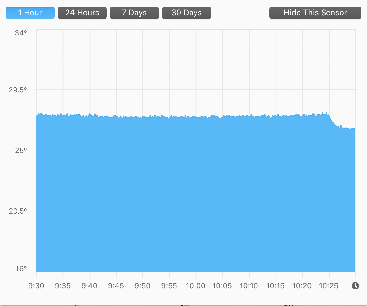

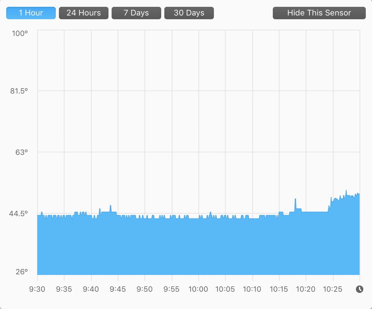

Here are the temperatures
[doublepost=1544449894][/doublepost]The image on the left is the palm rest and the image on the right is the highest temperature CPU
