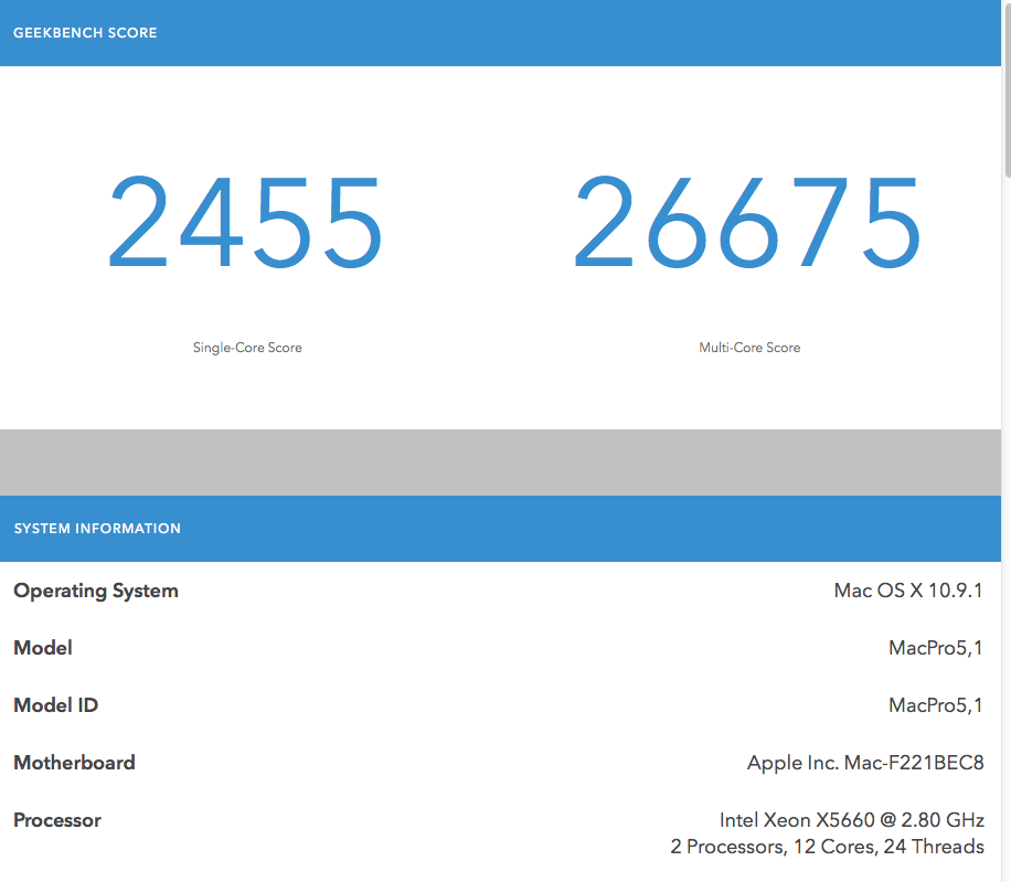

Yippy - did it !!
Upgraded CPU to 2 x 2.8Ghz X5660 and 32Gb RAM
One BIG scary moment when I dropped the CPU onto the socket.... luckily all good though
Thanks to this tread for all the help and advise - BTW I used the washers...
