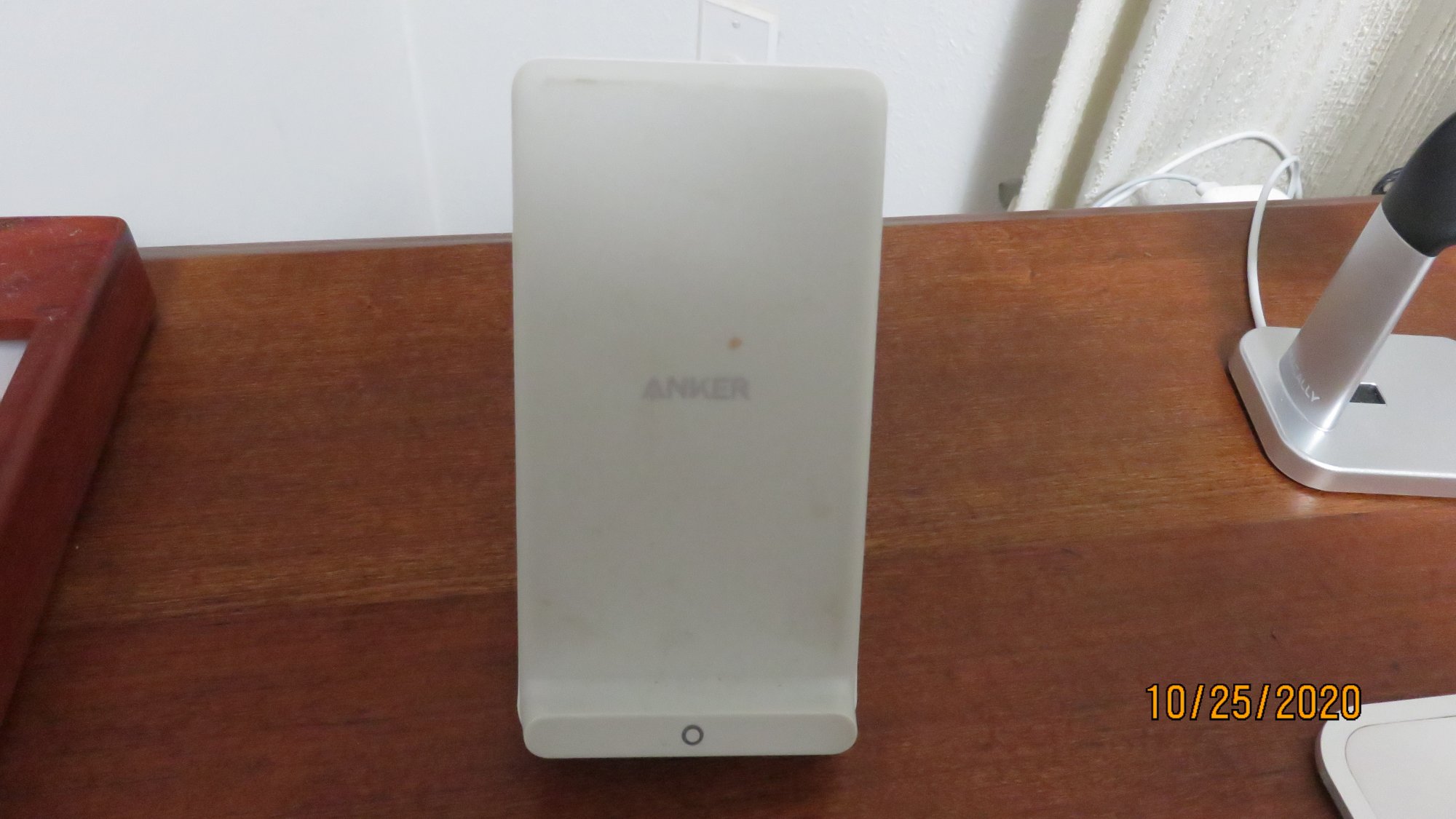

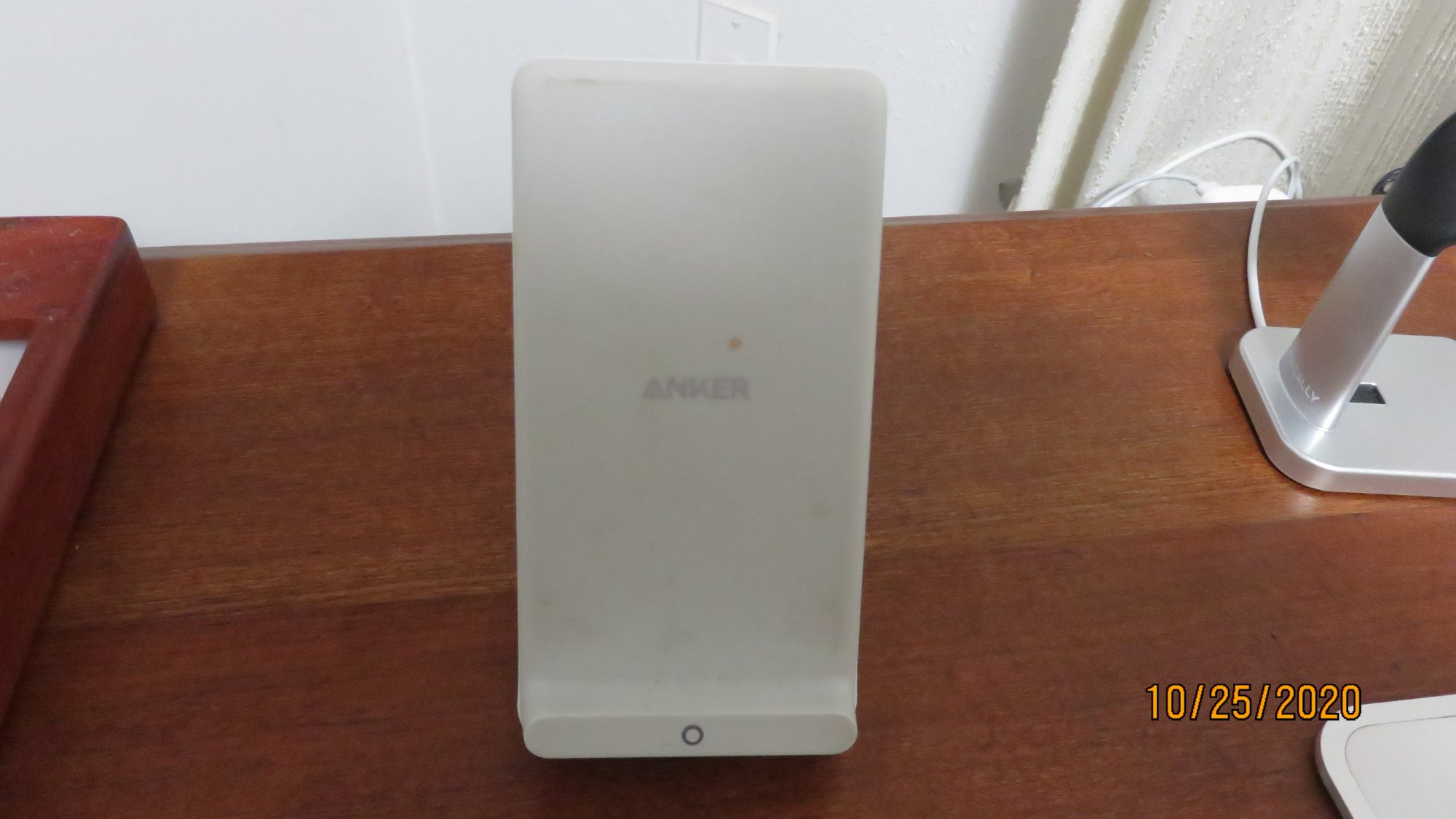

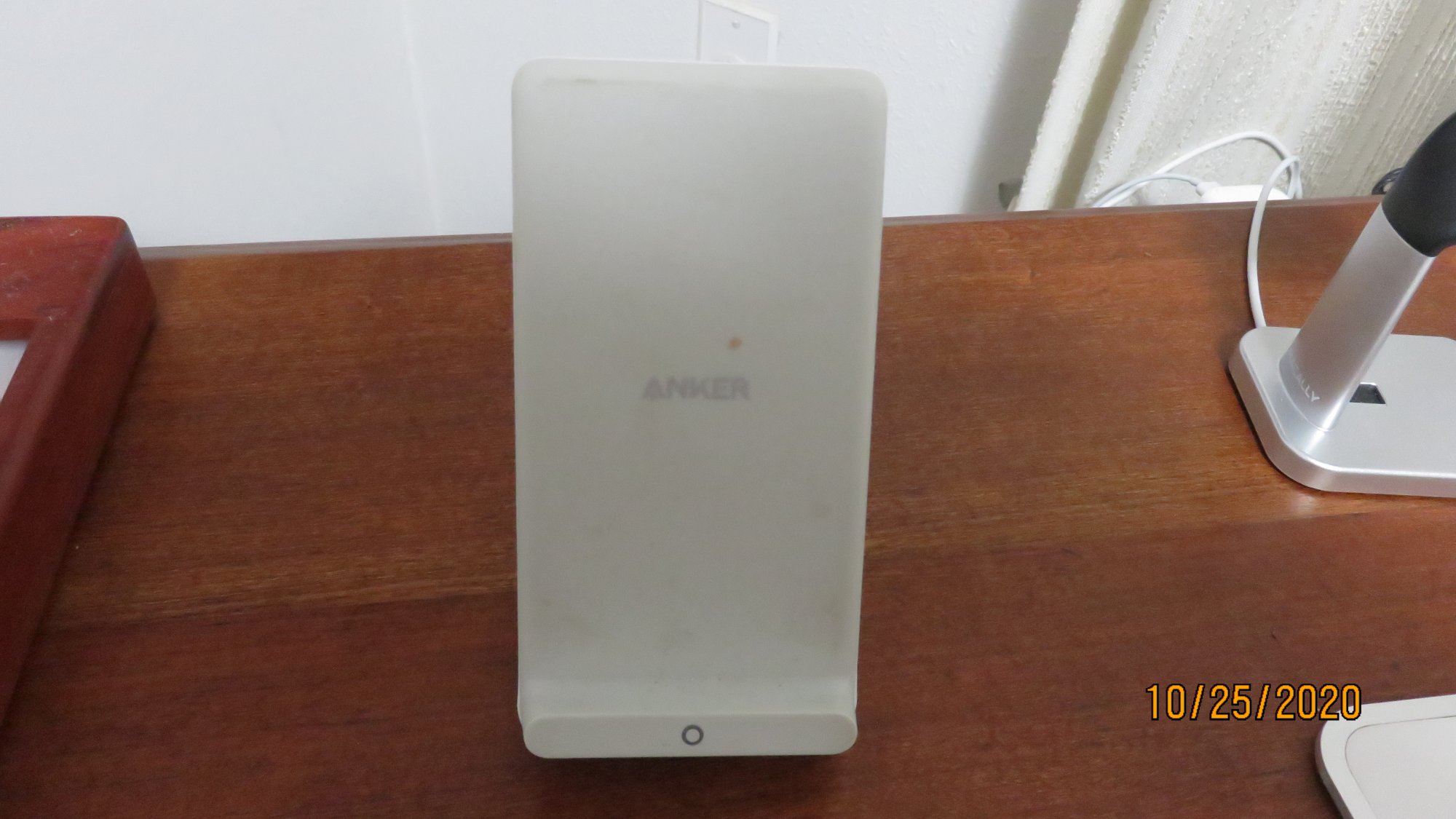

Anyone tried this Anker before Mini is ordered.
Anker PowerWave 7.5 Stand, 7.5W Fast Wireless Charger

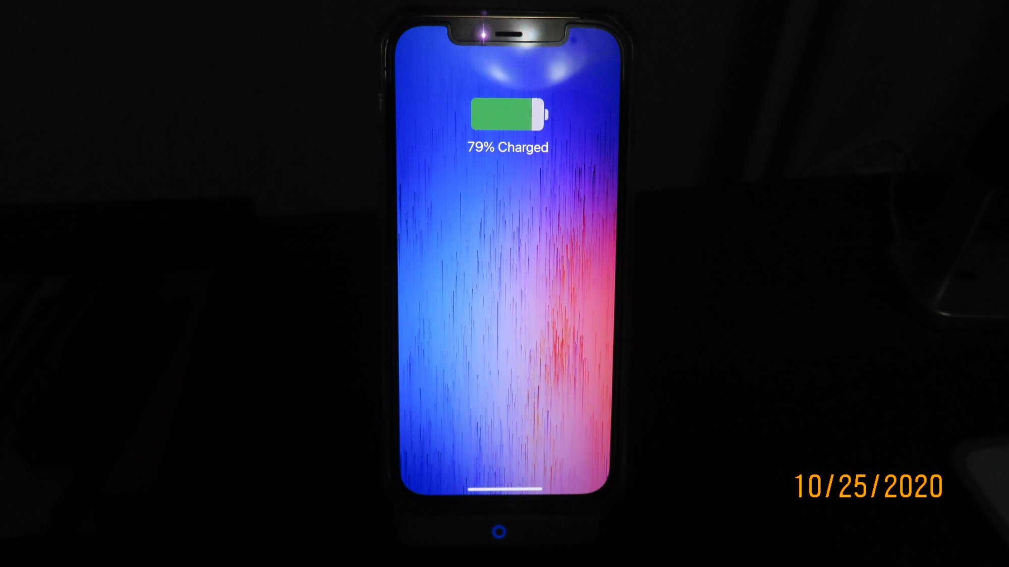

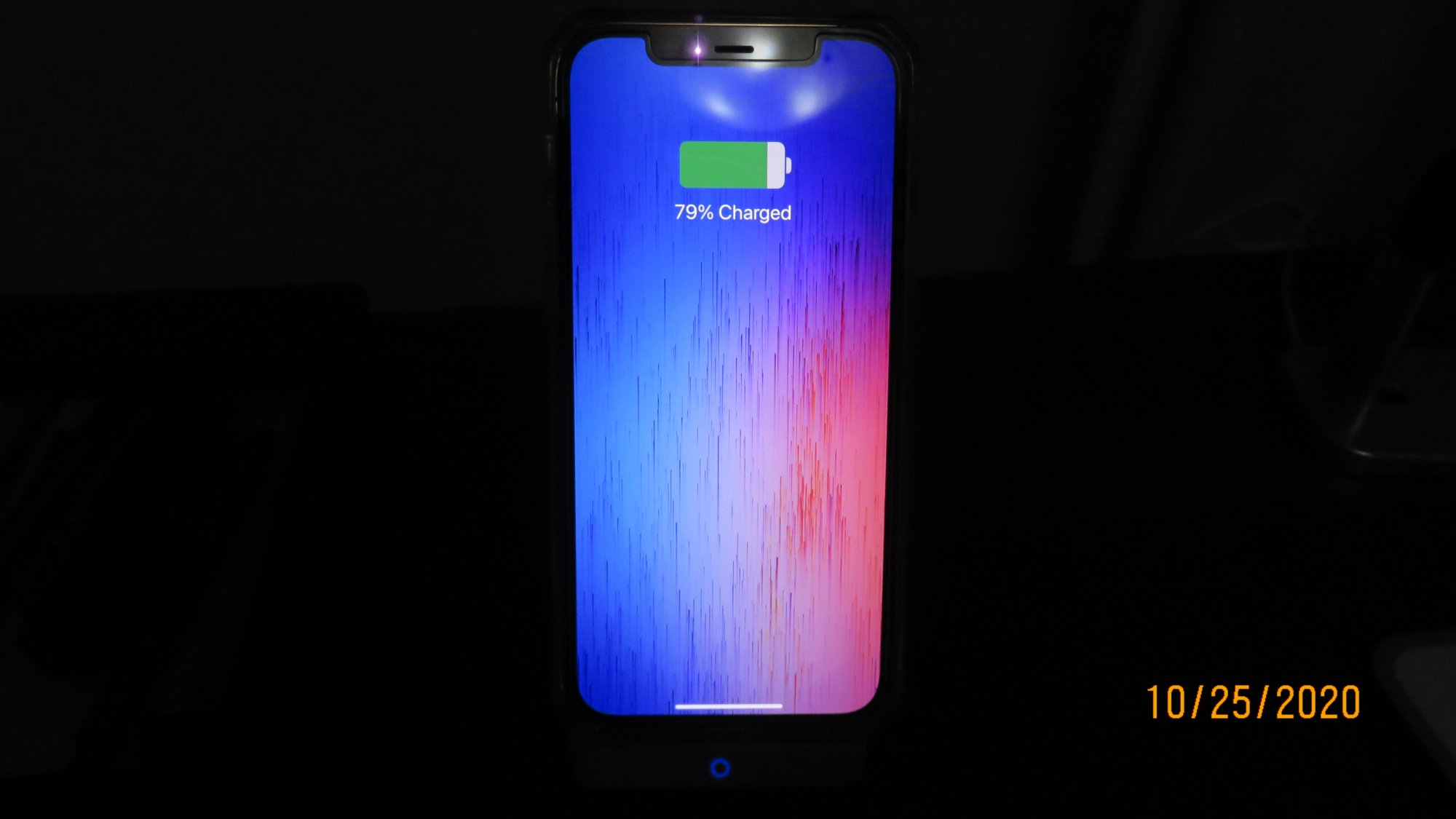

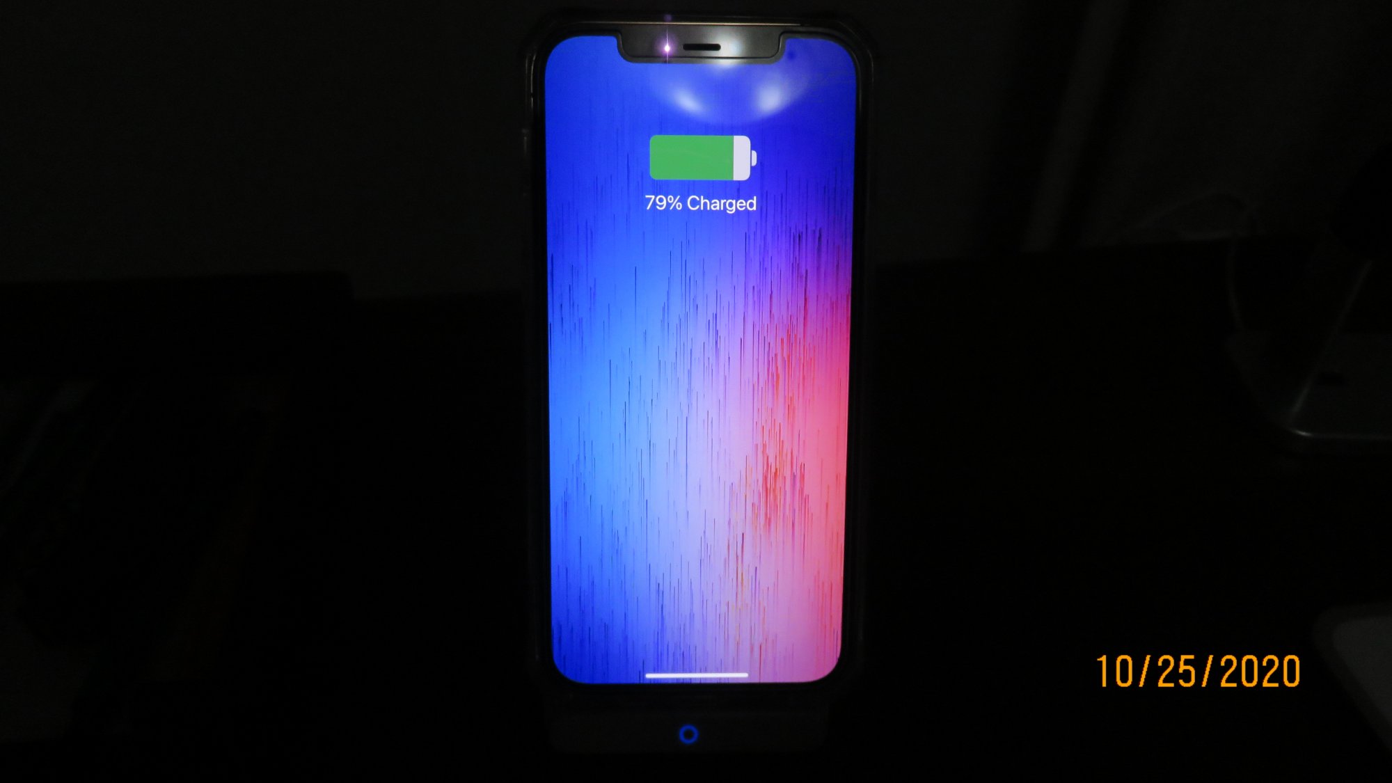

Yeah it works on my 12 I have the black version of this.
It has big coils
